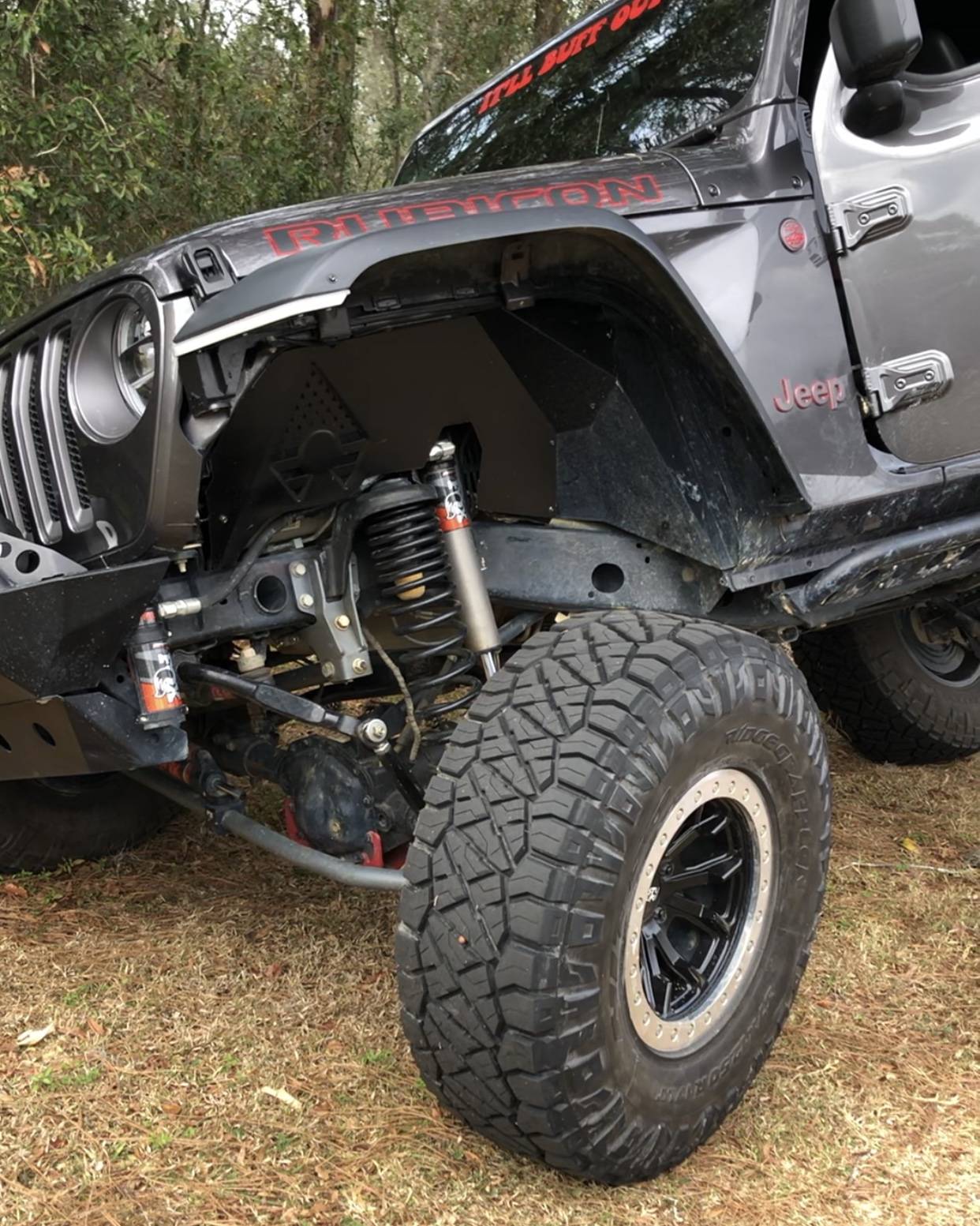

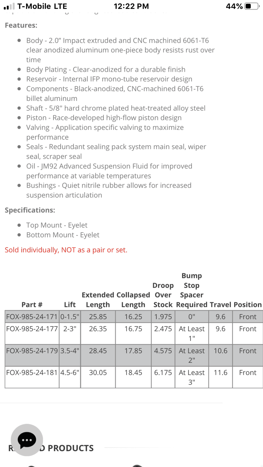

I have been running the 2.0's for about 3k miles and been happy with them. Had no issues with flex or bottoming out as well. Seem to absorb the bumps pretty well. I got mine from 4WP and am running the longer 3-4.5". I would imagine the ones you posted would be about right given your setup. Don't listen to 4WP about length if you go through them. They wanted me to size down from my 2.5" Synergy lift to the 2-3". Synergy recommends the longer ones and I went with what they said since they designed it all to work together of course.So.... thinking this direction to get me over the ride hump. There are some other options coming up next year or so that really peak my interest to make a full change. So let's talk the Fox2.0's.
The JKS setup seems to be for their dual rate coils. How would they pair to the RK Triple rate springs? Because I can also change the springs to Teraflex to get a desired result.
