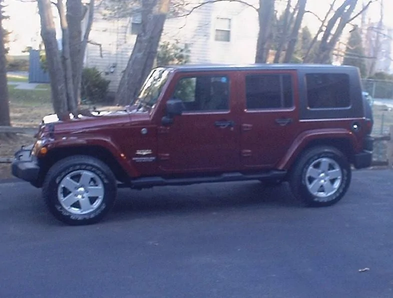

My 2007 1nd 2012 JK's had gutters from windshield to rear od rear window>. So you are partially right. some of that rain gutter was of course on the top not just the panel area. The 2018 JLU has rain gutter from windshield to about 4" from end of HT.
If I can attach a pick I will...doubtful, Computer illiterate!!
Go Jeep!!!
