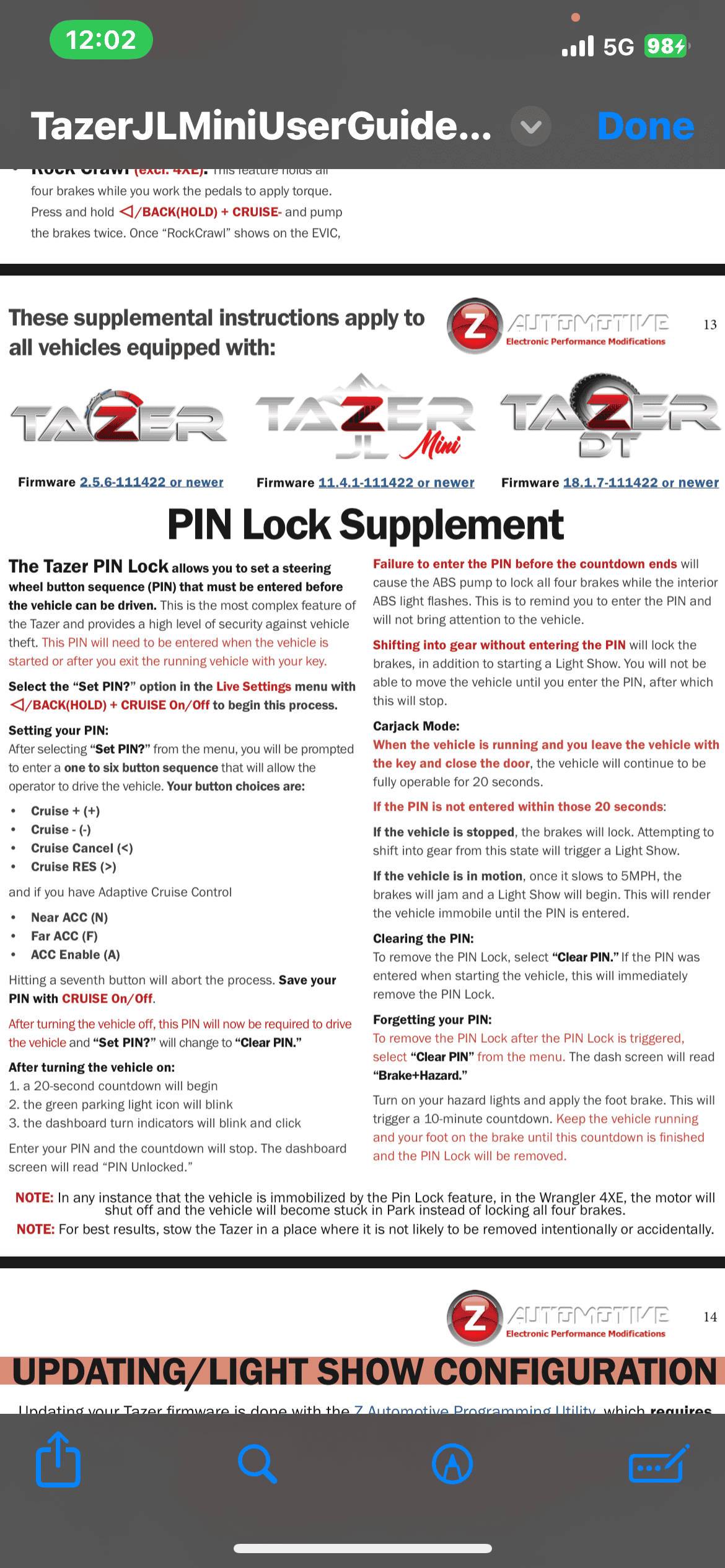

The tazer code not being entered means the Jeep ain’t going but about two feet before all 4 brakes lock up. Ask me how I know lol. And I think they are trying to implement a fuel pedal kill into the code. So no code the fuel pedal doesn’t work either.
I keep my keys in a small box next to my door. It blocks the signals. Basically a small faraday cage. Got it on Amazon for pretty cheap. Came with two small bags that do the same thing. If they can’t scan for the code then that takes the easy way out of spoofing the key. But they can still use a laptop to plug it or the obd2 port. But won’t do much good if the wheels keep locking up. And if the code isn’t inputted in time the brakes lock and won’t unlock at all until system is reset.
That will deter a lot of thieves, but it won't stop someone that knows what a Tazer is.
I guess that's one reason to not use the Tazer extension cable?
