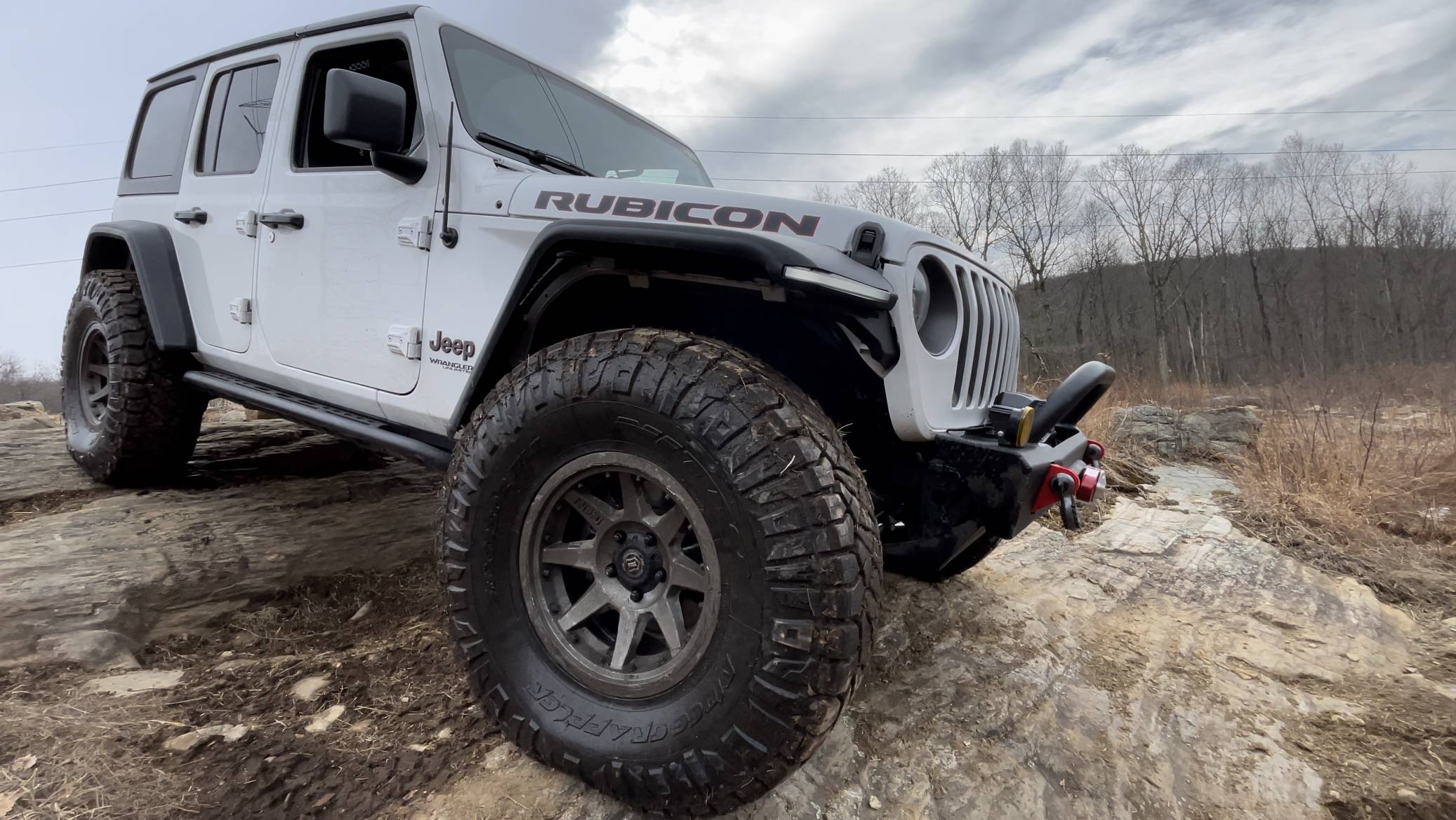

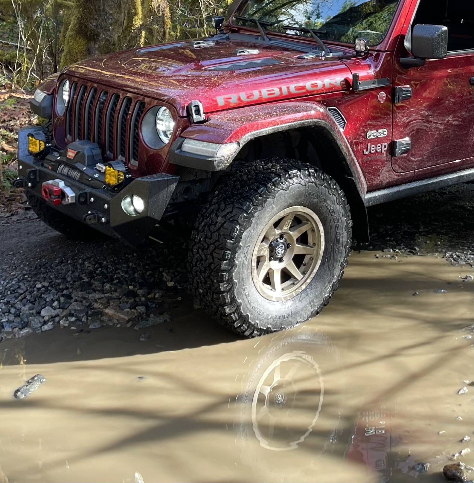

I have the ICON Rebound PROs and they provide much the same benefit as pure beadlocks and ARE DOT compliant/legal. I air down to around 12 PSI when off road and have had two friends knock off a bead when out wheeling. One was at night after a very long day and was a huge hassle to deal with - he has since gone to true beadlocks. I did not want a none DOT wheel and is why I jumped on the ICONs.
Ive got the Rebound Pros as well and they have been great. Ive gone down to 8-10 with no issues.
