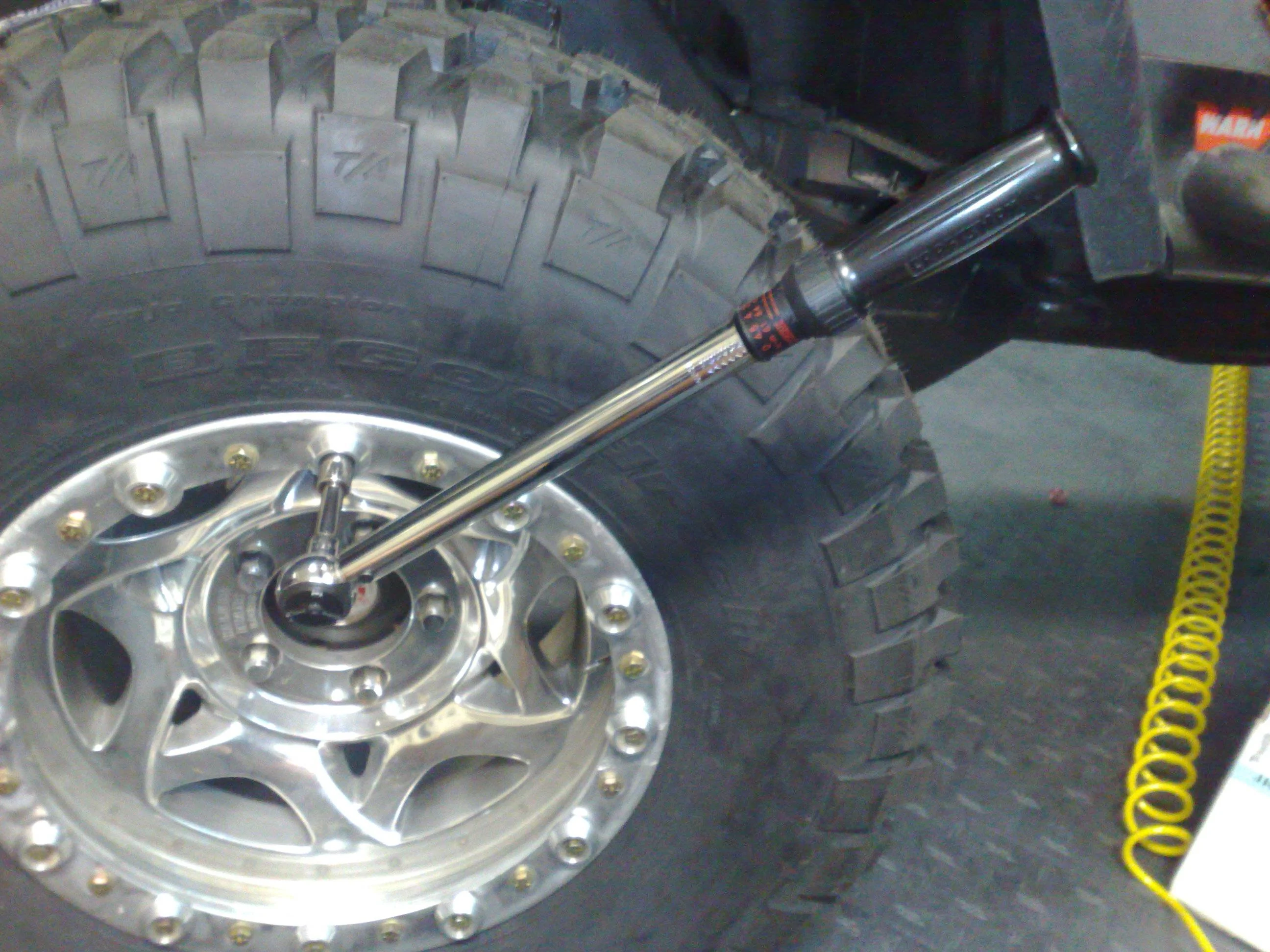

Ran BLs for 8 years, not a problem, never peeled a tire even running 3-5 psi on 7++ trails.
Yes some maintenance, you need a torque wrench and about an afternoon to maintain them once a year.
SOME tire sellers will NOT work on BLs. So to beat that I only ask the to put the tire onto the rim, only and I will do the rest which installing the BL Ring and torquing down.
There are a LOT of tricks to turn in what can be a day long job into a couple of hours for 5 tires. IF you are not handy with a Torque wrench this may not be your calling.
Based upon you intended use, I would tell you that you DO NOT need them.
These are Walker Evans Bead Locks: Roger Walker Evans is an American former professional off road racing driver and member of the Off-road Motorsports Hall of Fame. He was also a driver and owner in the NASCAR Craftsman Truck Series.
https://walkerevansracing.com/
I know Walker, one helluva great guy and a racer. These are the wheels he designed for his off road racing (Baja 1000 etc) and I saw them on his truck and ask to sell me some. He said they only for his company. I said you are missing a MAJOR Jeep market. REALLY?? Yea you are. I got a set and the rest is history.
Jeep Wrangler JL Do you really need beadlocks? 21102008129
Jeep Wrangler JL Do you really need beadlocks? 21102008130
