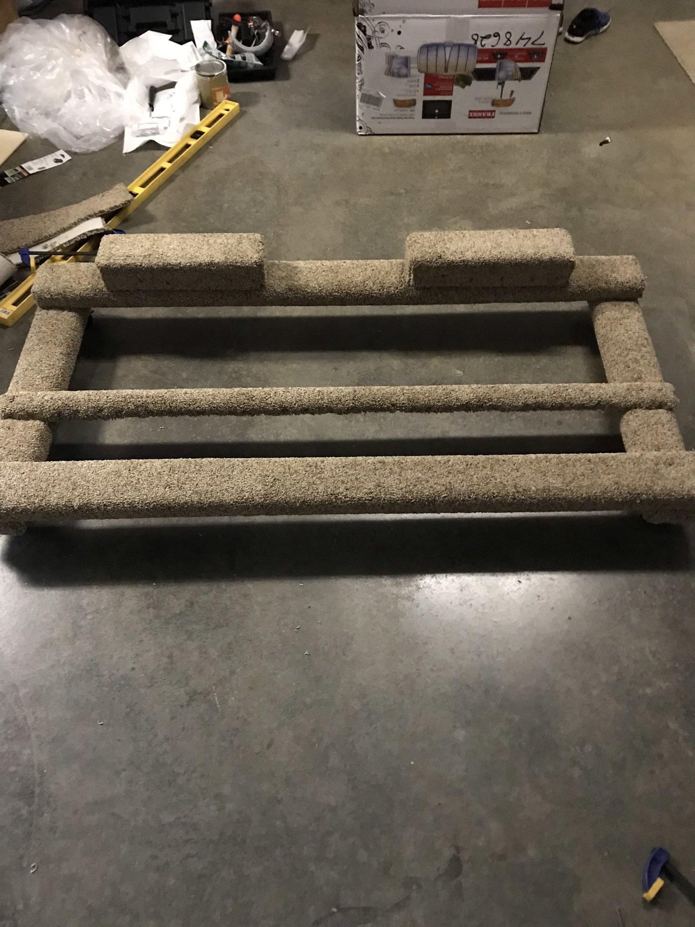

Just wanted to show the completed cart in action. Works great! Only problem is, I learned on Sat that my wife is not capable of helping me take the top off. So me be installing a hoist. If I do I’ll have a cart available for someone

Do you have the double stack 2x4 in the back, The 15" ones? The pictures look like it may be a single height 2x4. Just curious as I look at angle of hardtop on the cart.

It’s two 15” stacked. I copied the build exactly. I’m amazed at how sturdy the top is on the cart. It doesn’t wobble at all

The only hard thing of the build was trying to wrap that thick ass Berber carpet around the 2 x 4’s. Has some left from re-carpeting the house, padded it well, but damn it was a bitch
I thought about using almost the same carpet I have in my basement too, extra pieces... but buying the cheap carpet at Home Depot made it much much easier, cut the carpet with scissors, and air-stapler.
