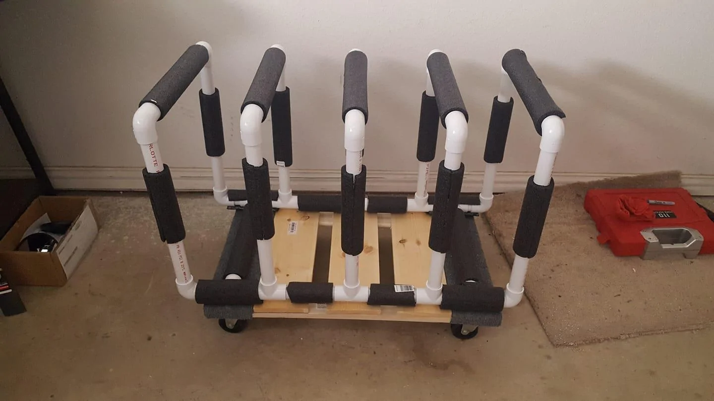

Finished this today. 6.5" spacing between posts and 18" tall, doors from my Rubicon fit perfectly. About $75 total including the dolly from Harbor Freight. Maybe two hours build time and totally worth it.

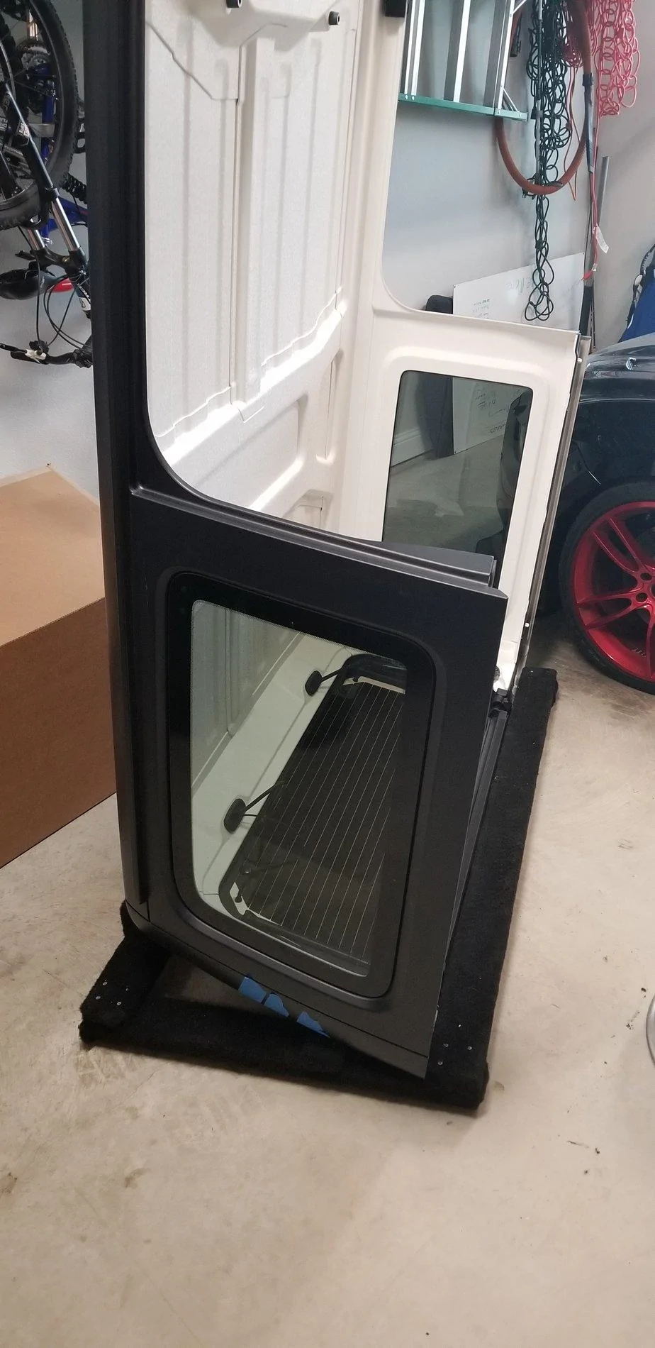

I was premature in my building of these... My wife is unable to easily help me get the top off... Now i need to engineer something else in the garage.

The red is 6”:like: Also helps to put painters tape on the glass to help hold it in place as you set it down.

It’s so the top sits vertically with a slight slant. There’s the middle piece to help support the wiper blade on the windshield.
The picture is from Yote’s thread.
Very nice

My son and I build one of these today based off the plans. Just made it a bit wider between uprights (about 6.5 inches). Now we need a nice day to fully test it out. It's a rainy weekend in Georgia.

OK I see its that foam for the pipes in the plumbing deportment like at home depot. cant o it come off since its not tape together ?

Thanks guys for the plans and pictures. I combined what you guys did with a craft project my daughter found to stain pvc pipe. I stained all of the connectors red to match the red accents on the Jeep. I probably wouldn’t have paid for the petroleum dye just to do this, but since I already had it...
So how did you dye the plastic? And thats a lot of electrical tape isn't it ?

Is that the black foam in the plumbing department like at Depot that has the slit down it ?
