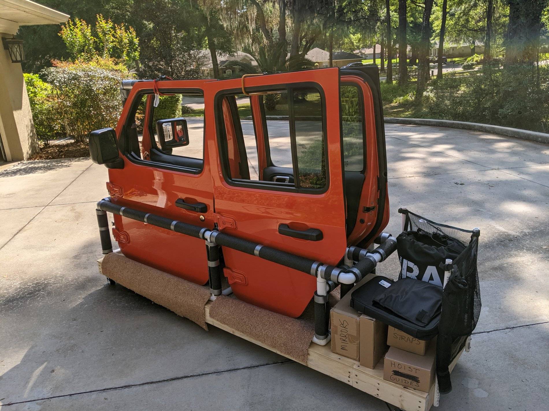

The result is this:

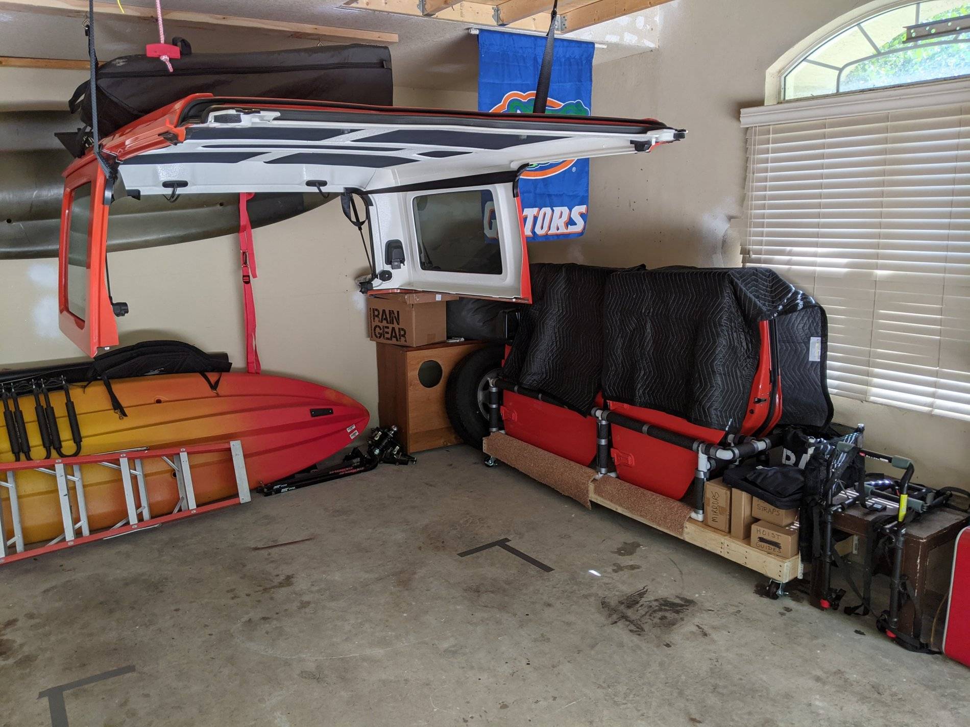

When the doors are stored, I throw some cheap $5 Harbor Freight moving blankets over them to keep the cats from treating it like a jungle gym:

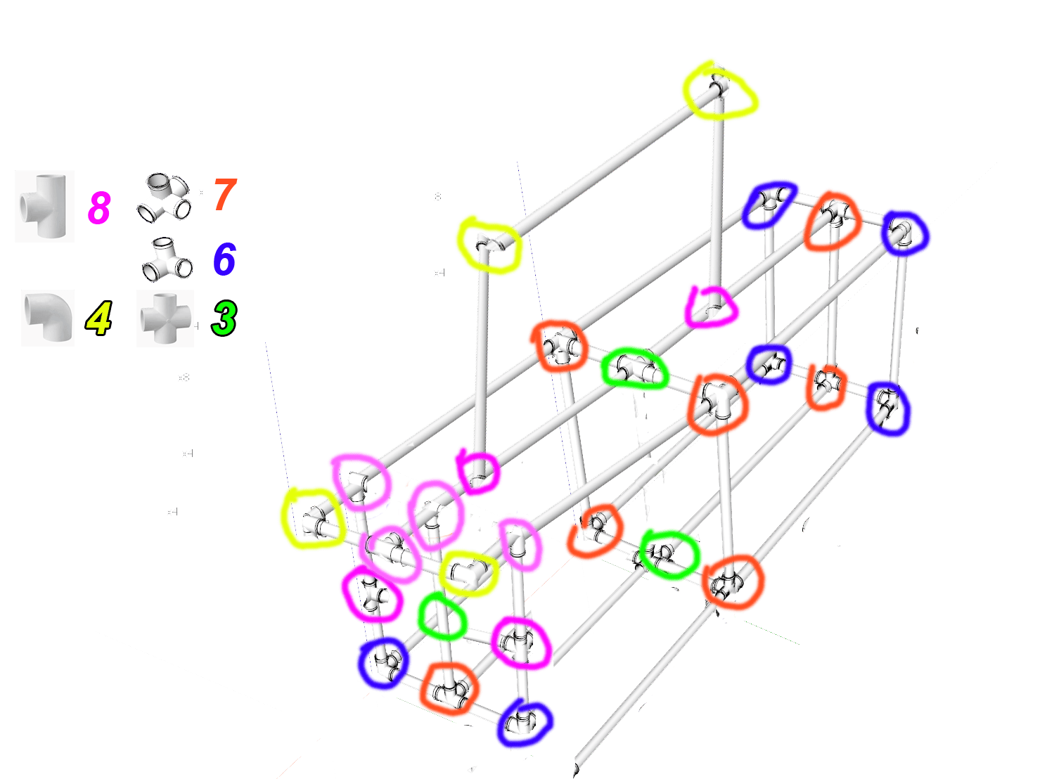

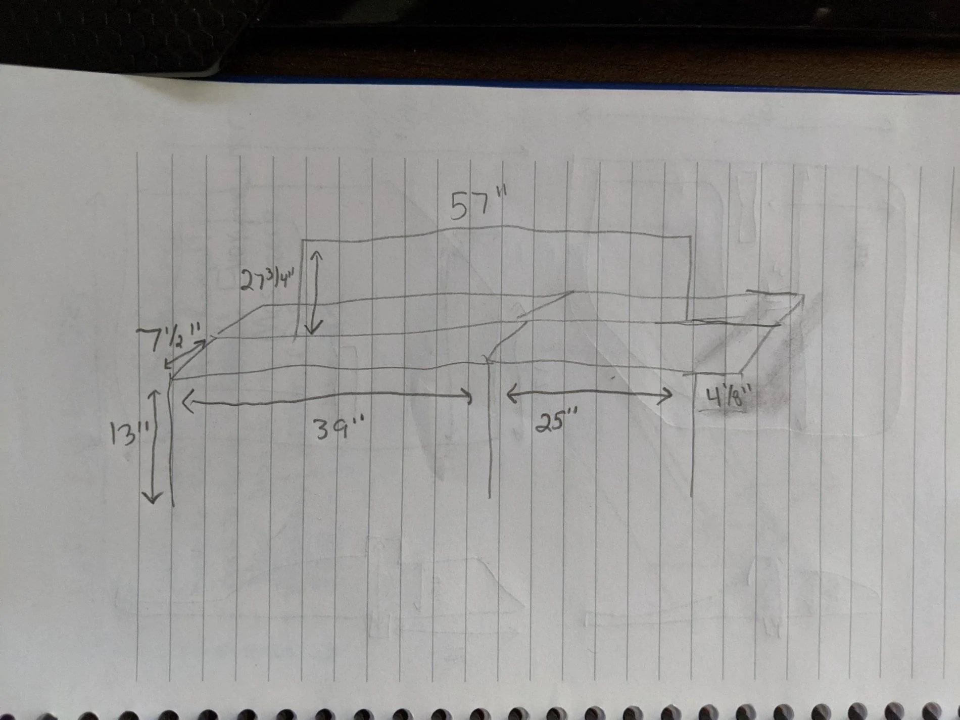

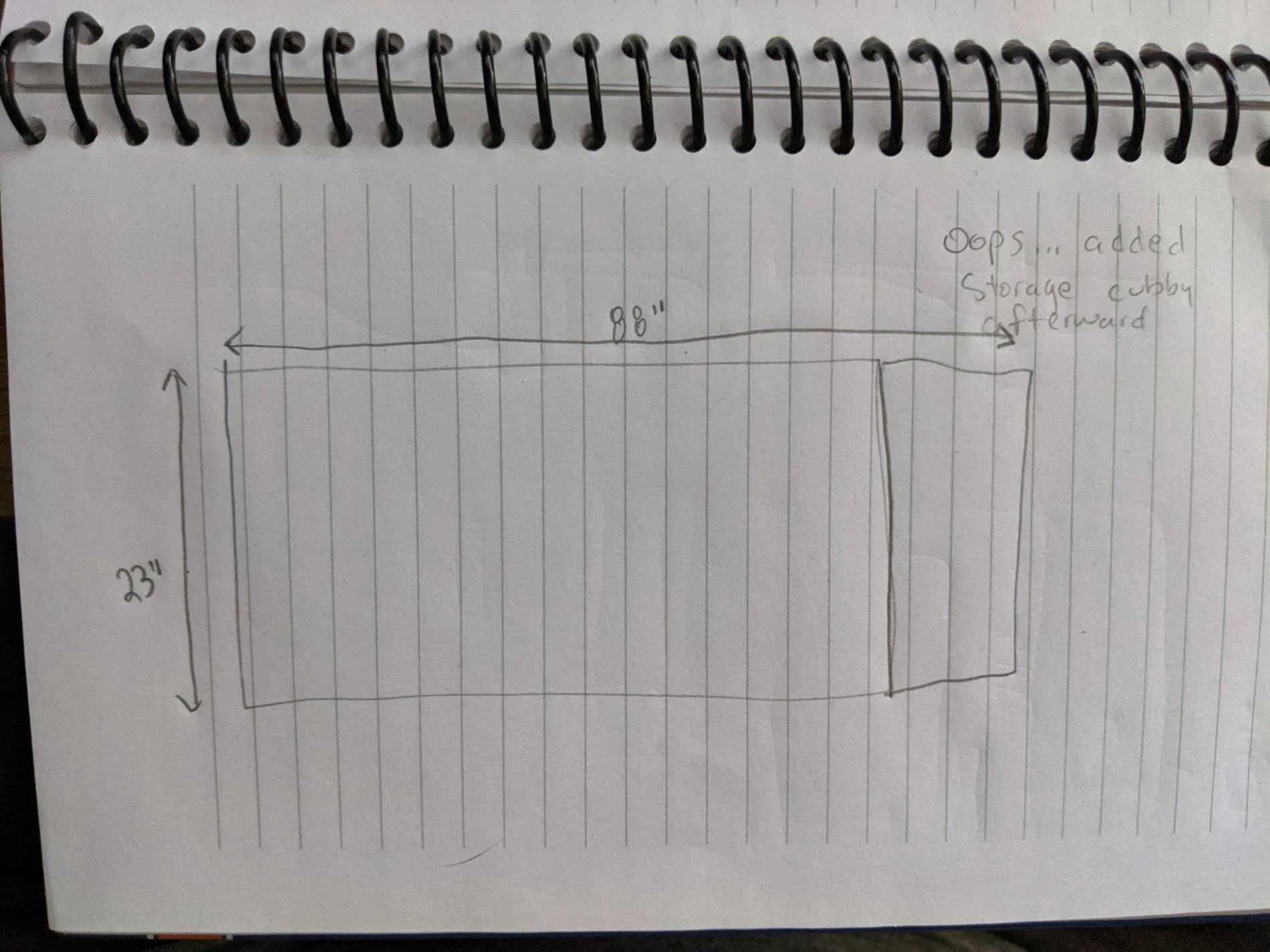

Here are the measurements/plans. I (roughly) adapted another poster's plans to convert his 2-door cart to a four door version. Sorry for the cruddy photoshopping.

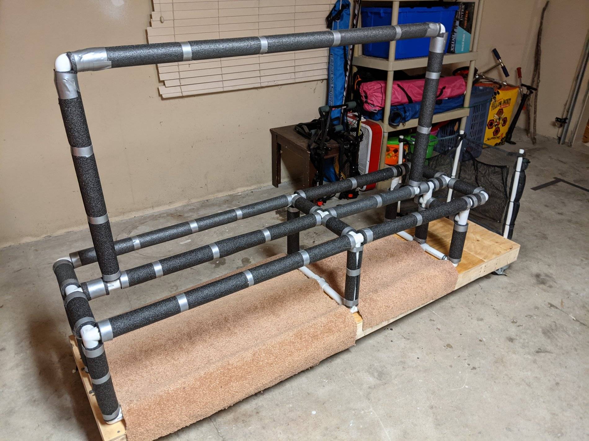

  • I used 1 inch CPVC pipe, pre-fit it all together, then cemented it together when I was satisfied with the dimensions.
  • I was able to get all of the pipe, elbows and tees from Lowe's, except for the four-way elbow tees, which I had to get from Amazon.
  • I wrapped it all in PVC pipe insulation, which I duct-taped down (and added a little cement underneath).
  • Please note that the top "rail" of PVC is not weight-bearing. It's just a guide to loosely bungee the doors to. The PVC slots do most of the work.
Then I cut up some 2x4s and 1/2 inch plywood, covered the plywood with carpet remnant I had lying around in the attic and added some 3" rubber caster wheels from Lowe's with brakes.

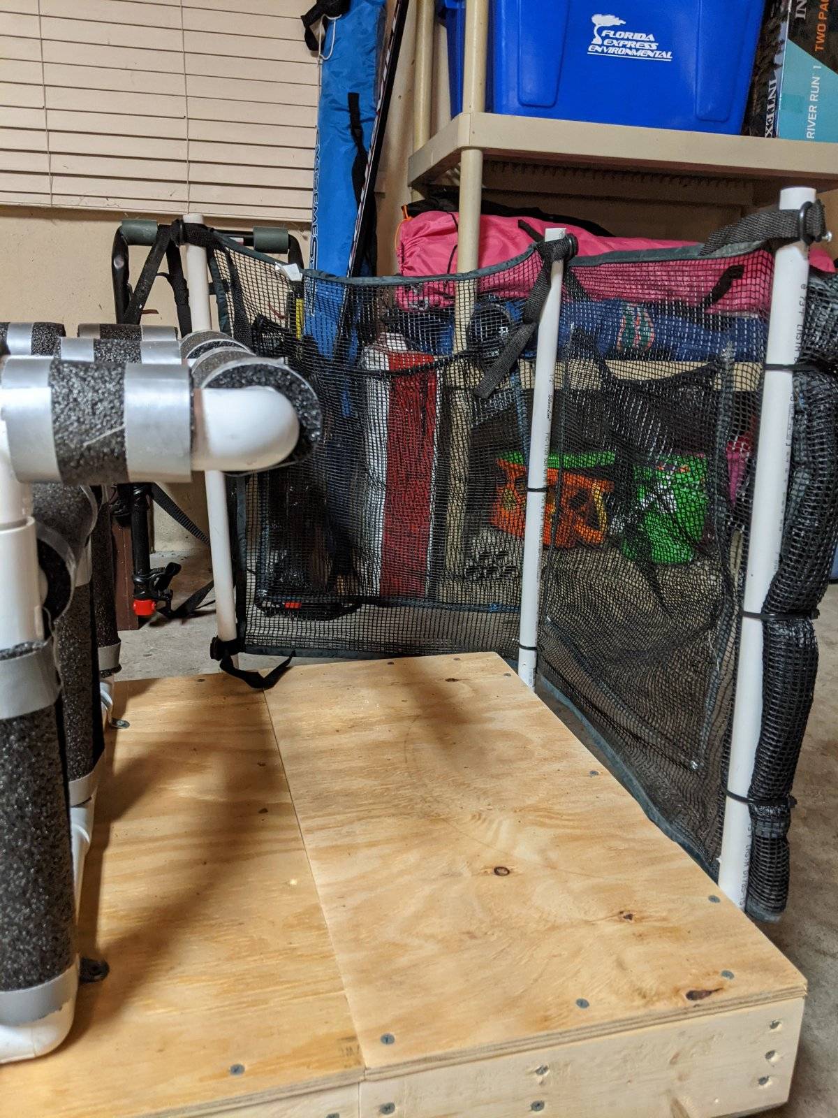

To keep boxes from sliding off the storage cubby on the side, I added three pieces of 1/4 inch PVC pipe and zip-tied on some leftover cargo netting that I had from... who knows where? Found it in a heap in the shed :P Again, this isn't a load-bearing setup, just guides to keep the storage contents from sliding off the cart.
All-in, it was probably about $130-150 in materials... primarily owing to the ridiculous lumber prices in the pandemic. There are probably less-complex/expensive ways to do this, but I'm really happy with the stability and protection.

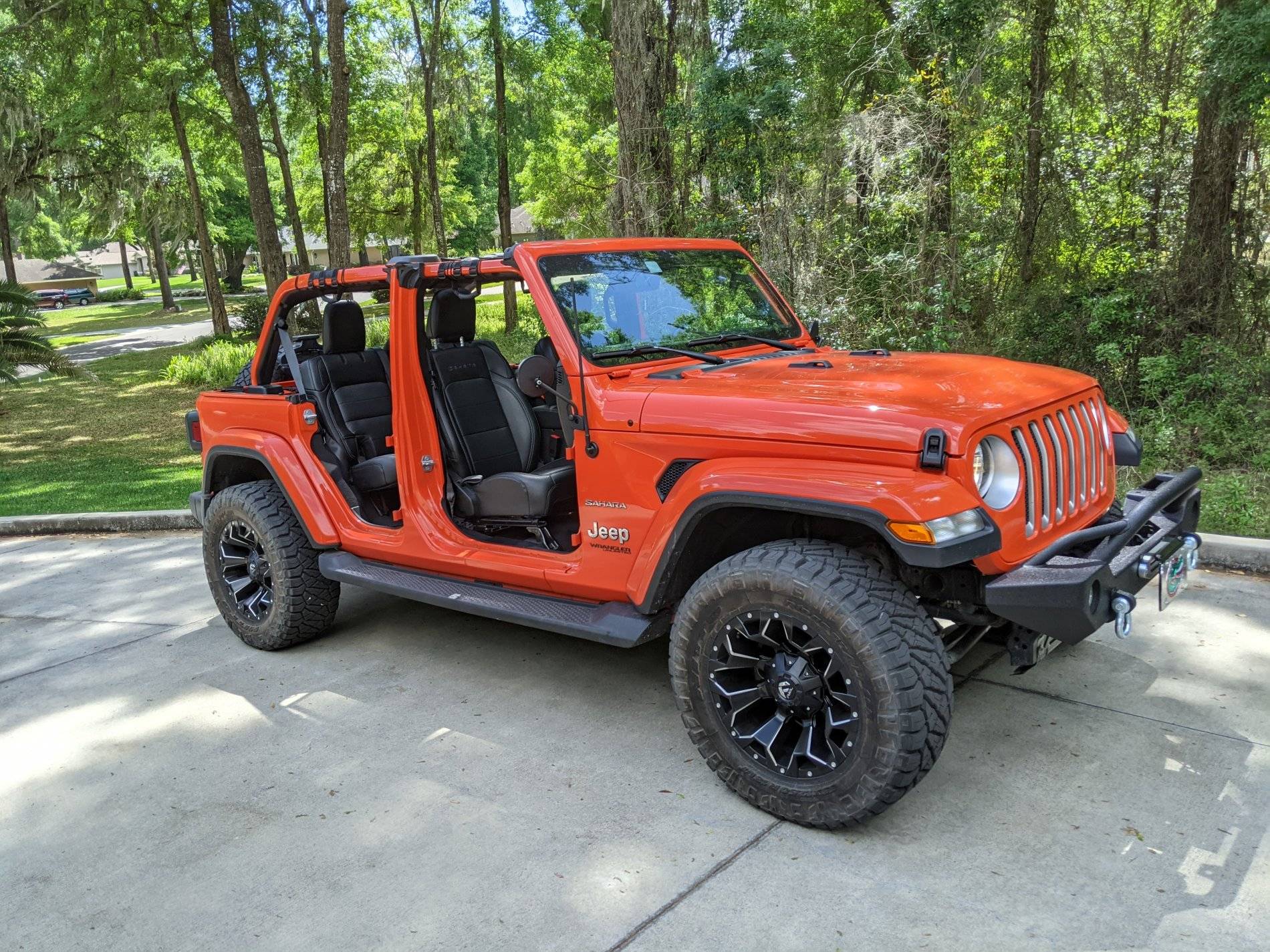

Also, bonus pic, because my JL is gorgeous naked (albeit dirty b/c she just went down dirt roads to the springs with three boys in tow):
