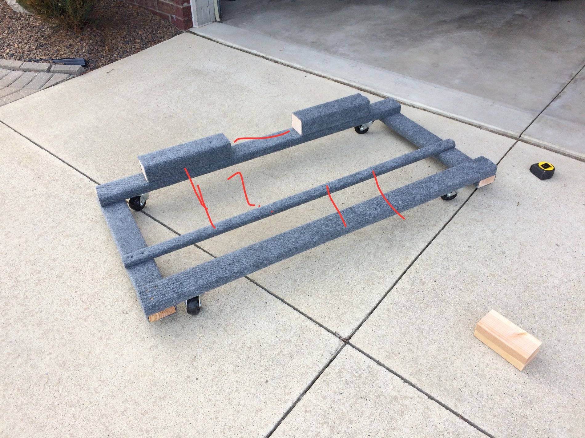

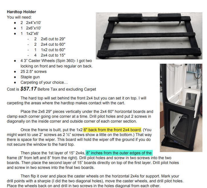

Did these dimensions work for everyone? The 2.5” sections make this so tight none of them fit. Would need to go 3.5” on those.
I recommend adding an inch to the sections. My doors fit, but pretty tight. I got the leather interior though. My buddy's doors fit just fine, he as cloth interior. We compared doors, they looks very similar, but Jeeps with a cloth interior do have slightly narrower doors.
