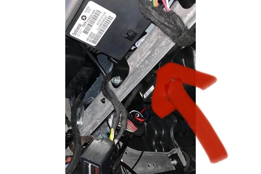

I cannot disconnect the wires on the SGW to install my Ecri device. They have added a bracket to make it more difficult, and it’s hard to get at the bracket. Any advice? Thanks!

Some have had good success using a curved dental pick..
Mine were pretty snug but once I got them out several years back I took some high grit polish paper and taped it to a lapping plate and then carefully rubbed the ribbed side of the connectors on the paper in a circular motion just doing a few laps then checking the fit and after 3-4 times the connectors pop in/out very easily so now I don’t even struggle but thinking now if i get the Ecri bypass it will be easier compared to the 12+8 cable I’m currently using.

Will, I was upside-down, with the panel off and after an appropriate number of beers, pressing on the backside with my index finger as hard as I could and pulling on the wire harness with my other hand. I couldn’t budge the damn thing. I had more room in my Sport to work it, and removed them without much problems, but this is ridiculous! After a few beers today, I will try again. ?

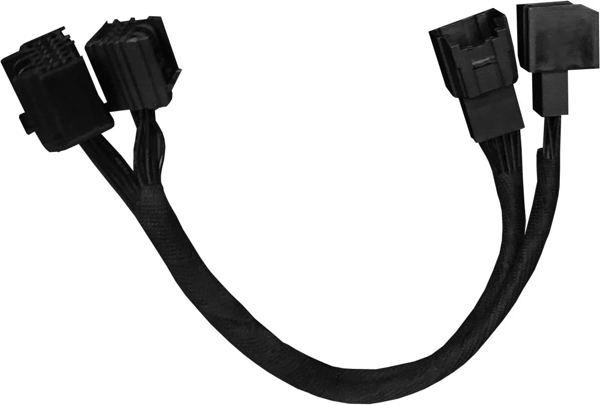

Will, you will need the Ecri device as well as the security bypass module in your link. Total is about $149, full price from the Ecri site. The bypass module link shows $25; I paid $49.

My plan was to use the Ecri bypass module with either my Veepeak or OBDLINK MX reader that plugs into my OBDII port along with my JSCAN app, I was thinking that the Ecri bypass module just bypassed the SGW so one could use any OBDII BT module or does the Ecri bypass module only work with their matched device ?

For those reading this thread .... for those interested.. I have fooled with / used the ECRI Bypass Module mentioned in this thread.
It works aok / gives the necessary bypass.
I have tried it with a cable attached, OBDll Scanner and a couple of different OBDll Bluetooth Scanners. Also tried it with the original Tazer JL unit .... No problems noted, using the ECRI Bypass Module.
The ECRI Bypass Module was purchased by a guy I know. A while back, he wanted an inexpensive bypass module so I told him about the ECRI offering and he bought one. He leaves it connected full-time and no problems doing that... (I did not expect any)
I set up his JT with JSCAN, using an ECRI Bypass Module and a VEEPEAK Bluetooth Scanner Tool.

Got my ECRI bypass in last night and tried it with my Veepeak and OBDLINK Max along with JSCAN and zero issues so no more cables for me and I will leave it plugged in all the time and I got a 20% discount from the maker after chatting with them and all they asked for was feedback on compatibility, I even have it daisy chained with my SSS module and still no issues so those looking for a cheaper alternative to other bypass modules you should have no issues.
