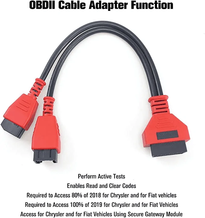

does the SGW Extension Cable work with the 12+8 Autel Chrysler cable:
Jeep Wrangler JL Disconnecting Security Gateway Module 2021 Rubicon 1675093458336
Also, (I may be an idiot here) won't you have to plug this SGW extension cable back into those hard to reach SGW inputs after you disconnect my OBD II iCar bluetooth device? TIA
- Frustrated with bleeding fingers & knuckles
Barney392
Sep 19, 2022
256
318
High Desert So Cal / Lake Havasu, AZ
2022 392
The first time you disconnect the SGW connectors will be difficult. After that connect the extension cables (leaving them connected) and you will be able to easily disconnect and reconnect cables without any problems and without removing the cover around the steering. Easy peasy. No need to get to the SGW with the extension installed.
Yes, the SGW Extension Cable works with the 12+8 Autel Chrysler cable:

OH - So the OEM SGW cables don't have to be connected to ports/inputs at all times then? Just leave them dangling (I'll tuck them away) waiting for my OBD II iCar bluetooth device (will probably get a Tazer at some point) to be connected then? TIA!!
Barney392
Sep 19, 2022
256
318
2022 392
You need to plug the OEM SGW cables into the extension cable after the extensions are installed into the SGW. They work like a simple extension cord. Everything will be connected as they were originally except with the extensions installed inline.
