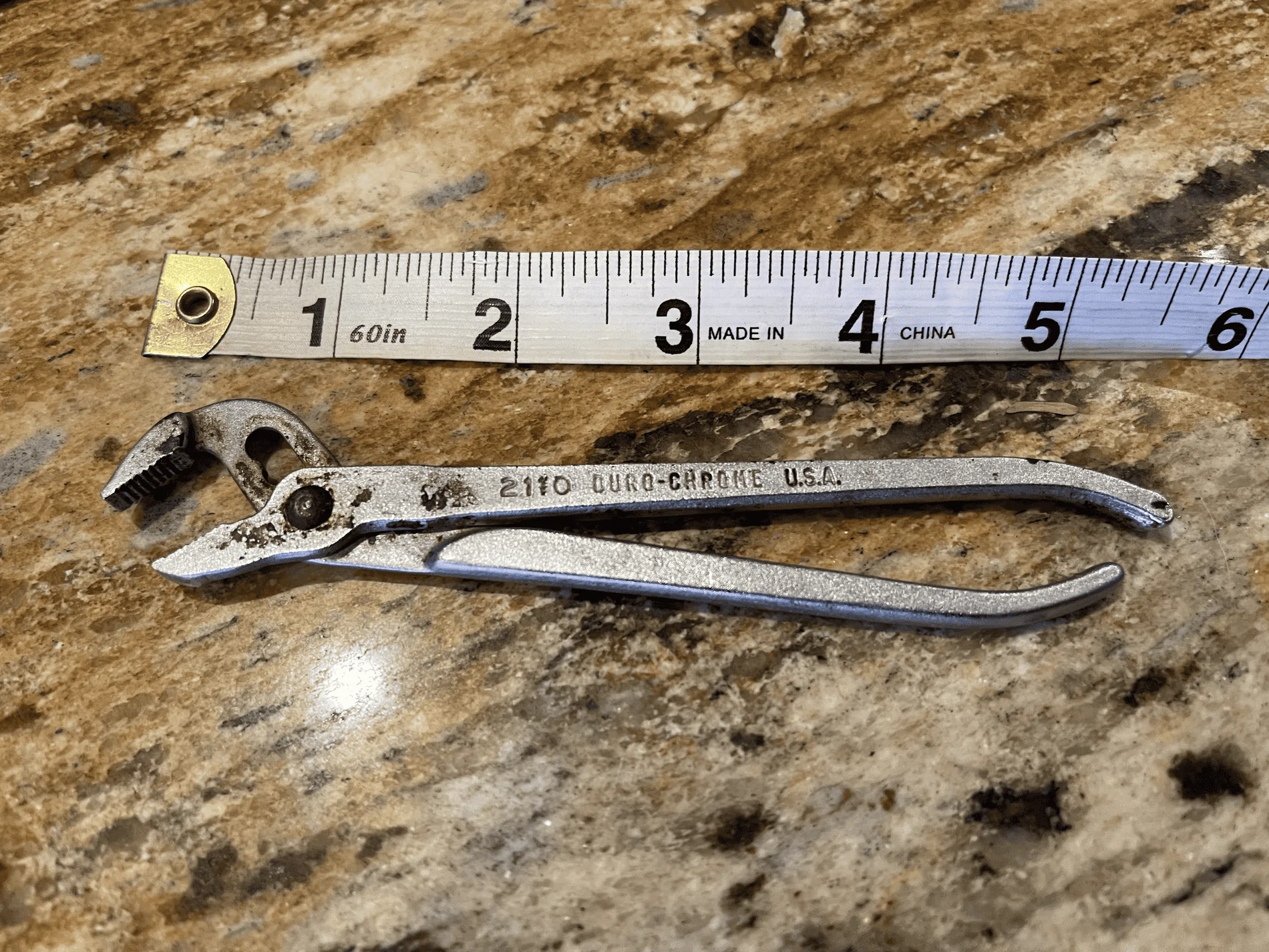

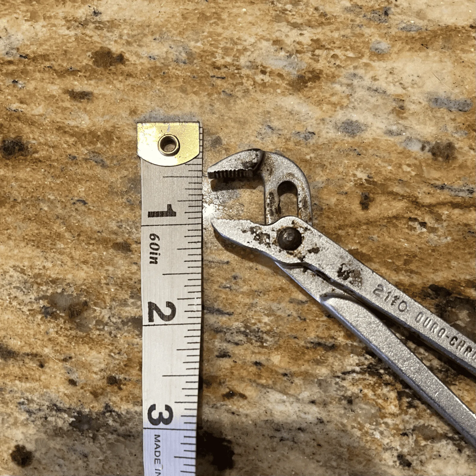

These little pliers made removing the two cables remarkably easy...
That said, I will probably go ahead and buy the SGW Extension Cable so I don't have to go back under the dash to unplug.
@dblankenbaker
Tools like that are best avoided.. Chance of damaging the male connector or the female. I know a local guy that damaged the male..
$ well spent to buy the SGW harness.... Install that and be done with it so to speak
