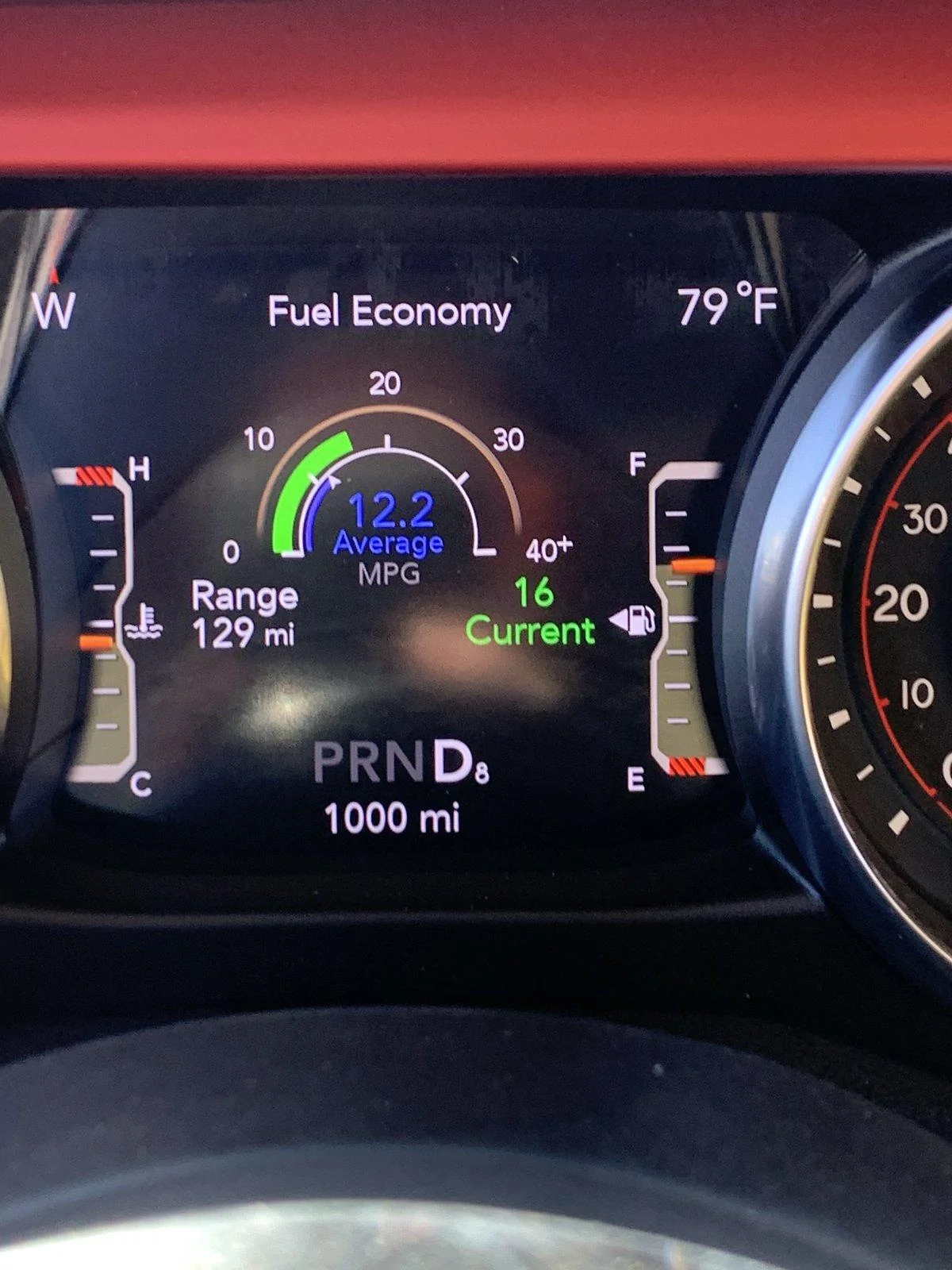

Yeah mine said this at 800 miles pulling a small RV

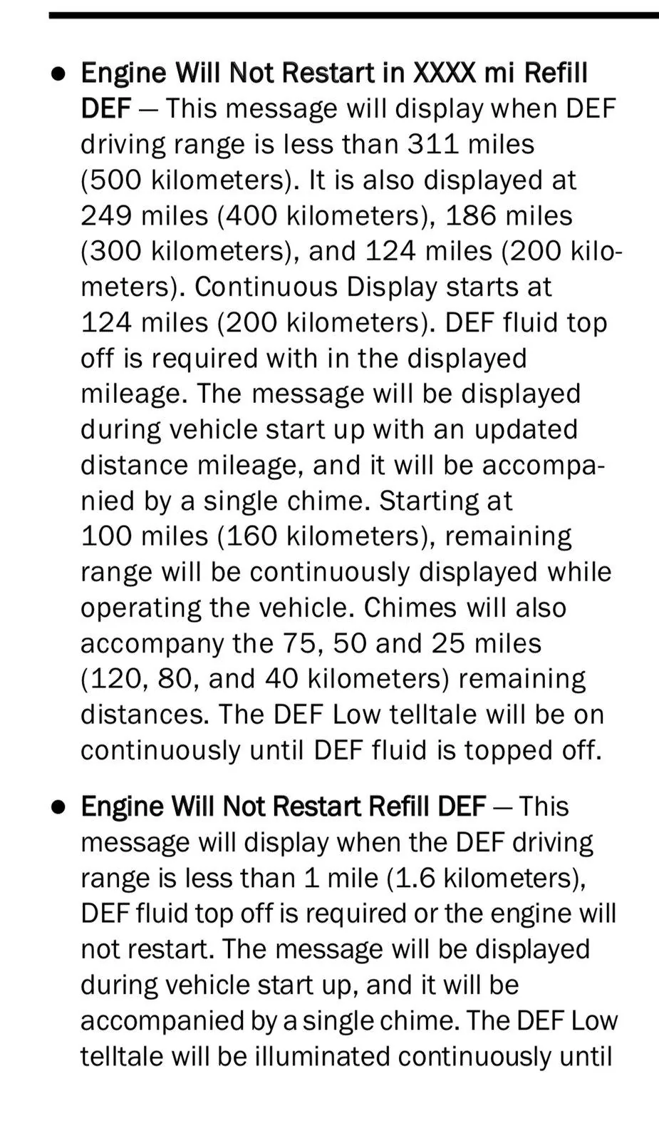

Something tells me neither you nor anyone else around here has the balls to test your hypothesis when both the warning message and the supplement manual petty clearly state it’s not going to turn on. I do look forward to the day both the EPA and a major manufacturer are sued over these ridiculous DEF software requirements which are bound to hurt someone sooner or later.

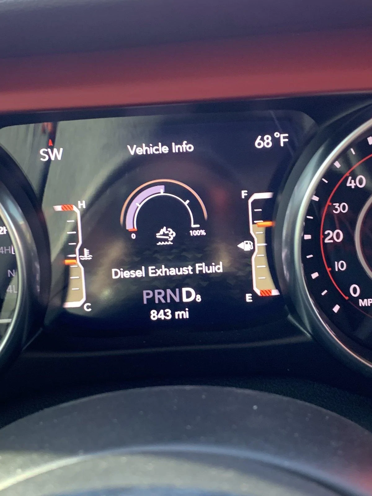

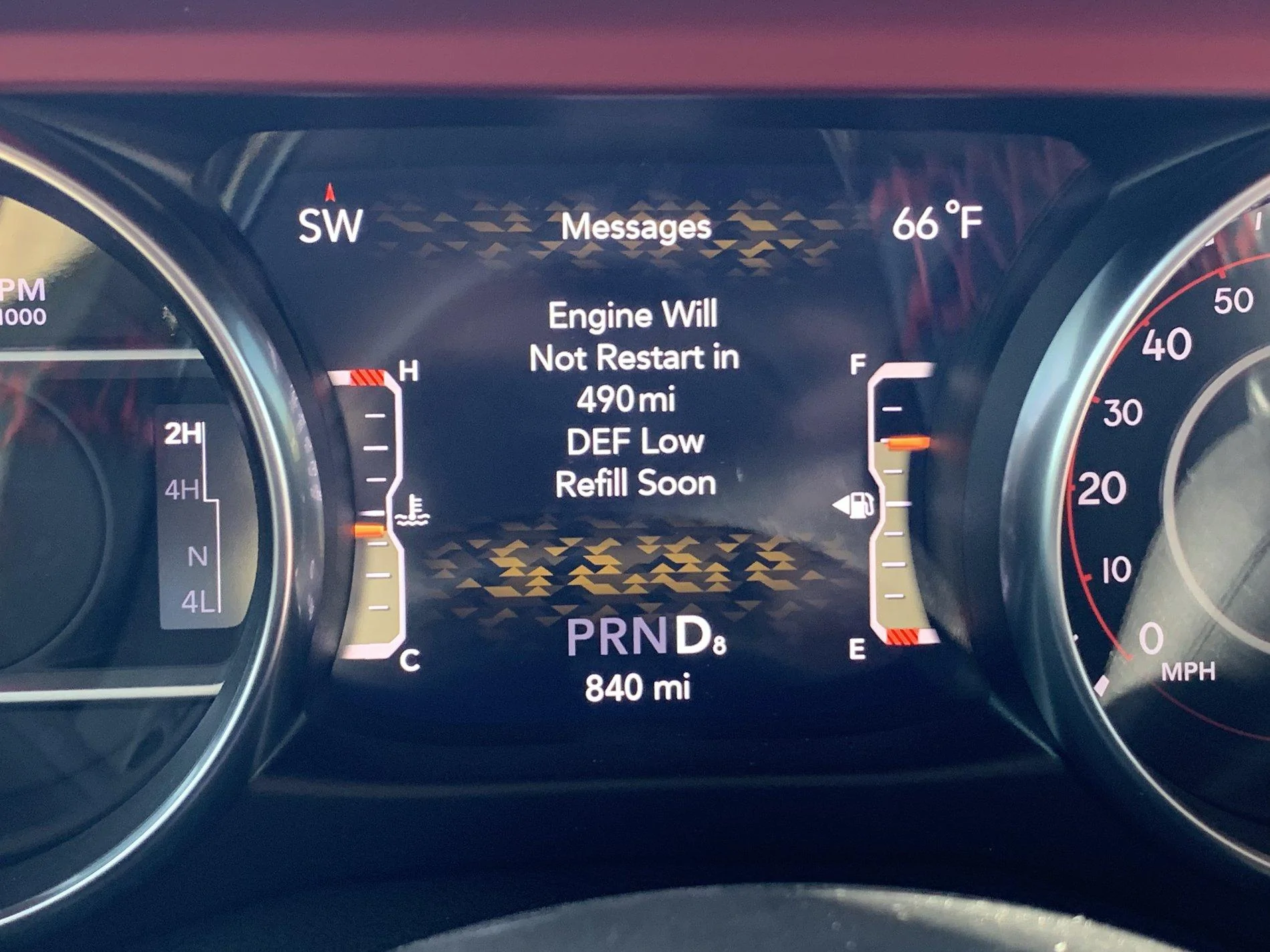

So yeah I’m not sure if it was full or not the gauge said it was when I picked it up the fuel was full and def was full the warning came on around 800 miles it said in 480 miles engine won’t restart but it never changed from that 480 even though we drove another 100 plug miles. When I got home it held a 2.5 gallon bottle so idk what’s going on we love this diesel so much more than our 3.6 I’m not even up set about it but it definitely needs to be addressed. And the mileage sux 11.8 average hand calculation pulling 1900 lbs I didn’t buy it for mpg’s I bought it for torque.

Sounds like the emissions controller and DEF tank sensor are not communicating for some reason. Will be interesting to see if your towing fuel mpg improves as the engine reaches peak compression through the break-in...and how that number compares to a 3.6 JLUR towing the same load.

I'll do it. I'll just time it right where we'll be near home. When it gets down around 100 miles I'll take it for a spin. And bring it on back to the house to coincide with the 0 miles of DEF left. If it doesn't shut down or do something funky, I'll drive it around some more and see what it's limp mode is like. These are good things to know anyhow.

We were not discussing what happens in the last mile it is prior to that the vehicle will go into Limp mode just the same as their big brother Ram counter part, in fact every Diesel consumer Truck does this. Before you get to that FATAL last mile you will be limited to 5 mph, and the fact it will not start is only if you shut it off 1st.
Anyone that goes to that extreme has no business owning a Diesel Vehicle.
