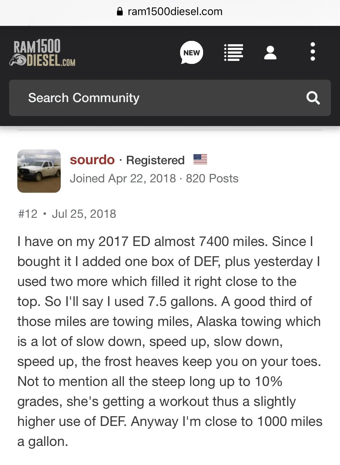

JLURD
Nov 30, 2017
1,634
2,334
Alaska
2018 Compass Latitude 6MT, 2020 JLUR 3.0
That’s near a worst case scenario for the gen2 3.0 on a Ram 1500 and still using 3-4x less than @Buttercup 3.0. The typical experience with those Rams is 1400-1500mpg for DEF...5x less than what @Buttercup 3.0 is seeing towing a lightweight trailer.

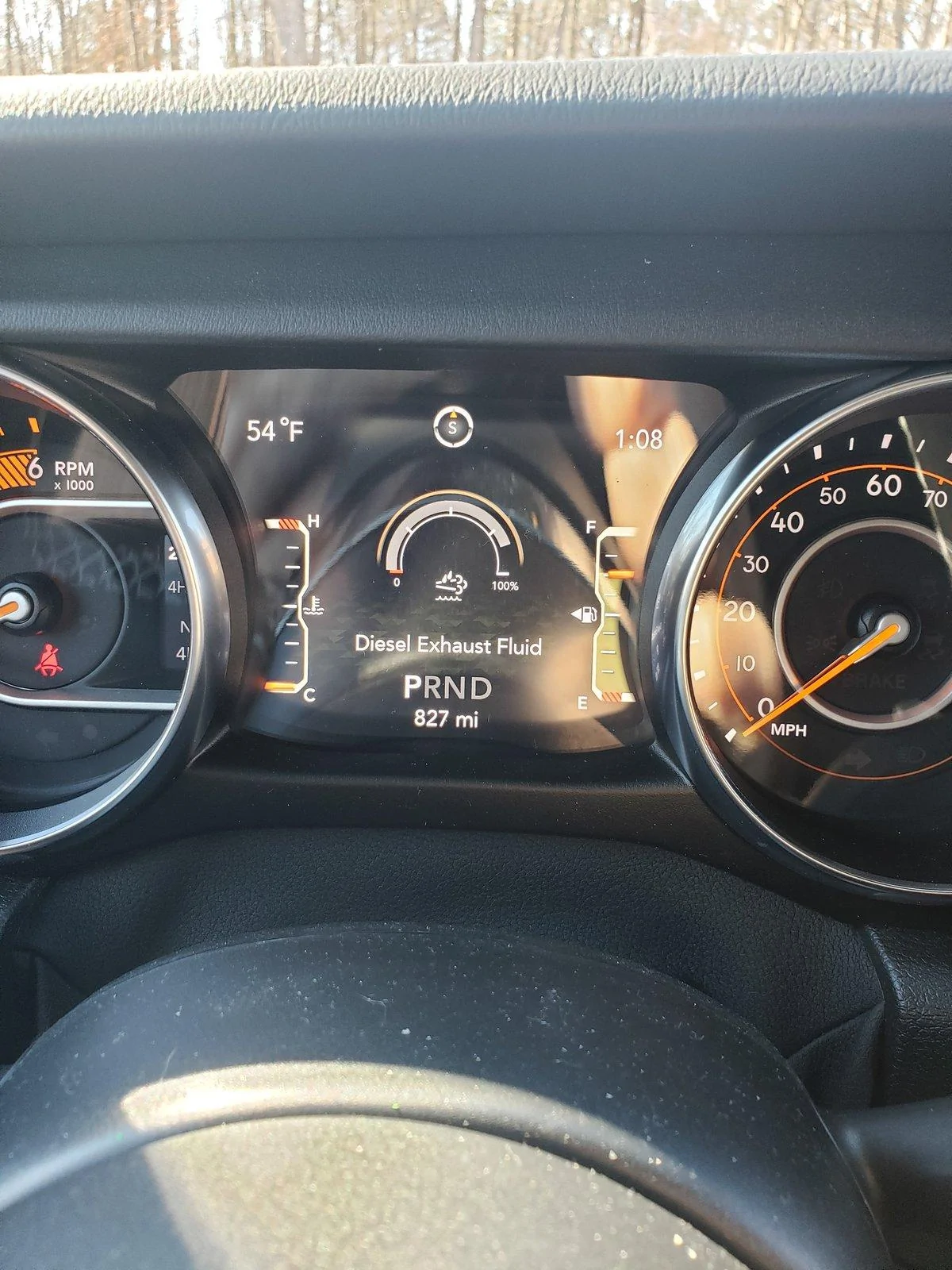

Nihkole
Nichole
Nov 30, 2017
182
338
Richmond, Virginia
2020 Jeep JL 3.0 Diesel, 2000 Chevrolet Camaro
Here's mine taken earlier today. Mostly driving around a pretty suburban area and occasional highway.

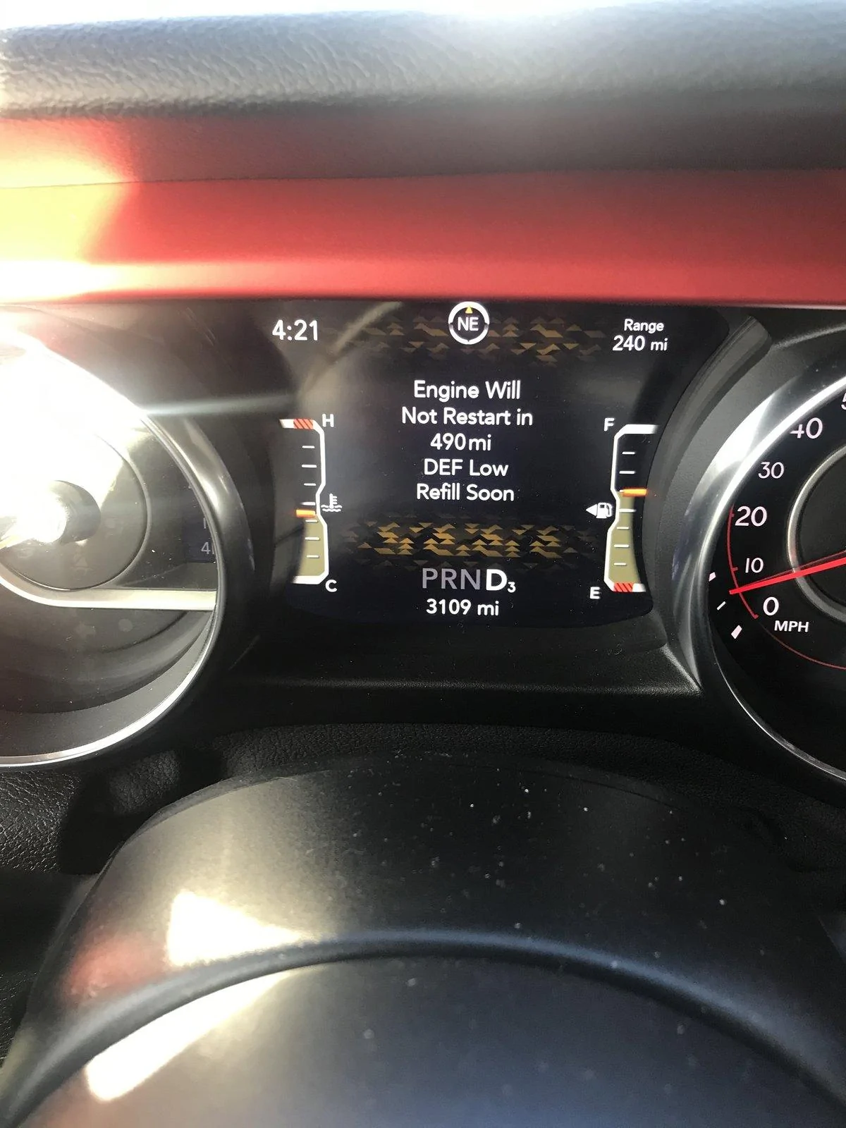

SheddMan
SheddMan
Sep 30, 2019
104
Flowery Branch, GA
2020 Jeep Wrangler Unlimited Rubicon
My warning message popped up today. So you will get a warning 500 miles before the engine will not restart. These miles were not very accurate. Mine dropped about 40 miles in approx 10 miles travelled. I had already purchased some DEF so I’ll be filling up tonight.
Jeep Wrangler JL DEF Usage 8D904C95-061F-4D97-89DB-72BAA3D4D4B4
JLURD
Nov 30, 2017
1,634
2,334
Alaska
I do wonder if they weren’t full from factory but showed full on the meter like a fuel tank will for the first hundred miles give or take after a fill up. Still wouldn’t account for a 65% reduction in DEF range. @Nihkole looks to be on track for a 60-65% reduction too. @Buttercup 3.0 hit an 87% range reduction with light towing. So far that makes zero delivered rigs on track to come anywhere close to 10,000.
