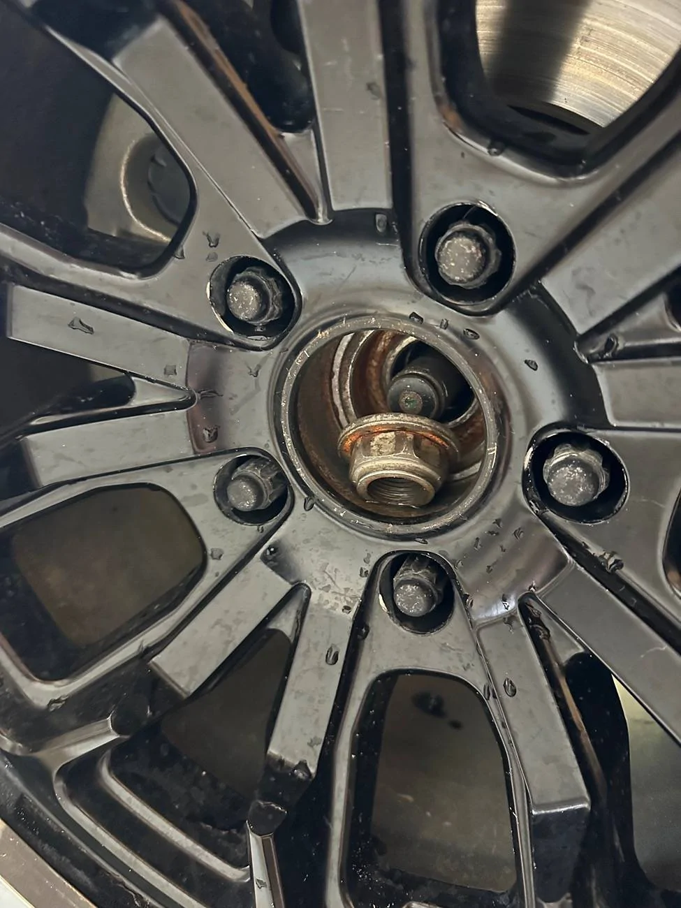

Got a free couple hours Sunday morning so went wheeled a little….We’ve had a lot of rain lately, so our 2-3 rated trails turn into 8-9s because it’s like wheeling on a bar of soap…lockers, 4lo, doesn’t matter, some spots are winch only if you want to, but there’s usually a go around… I always clean and do a post wheeling inspection, grease and WD 40 if necessary….When I pulled center caps to grease RCVs, I found this…:facepalm: .. I have no idea how long it’s been loose but I never felt or heard anything from it….
Jeep Wrangler JL Crystal Rubi build… IMG_0803
I know the unit bearing is pressed together pretty good, but I still figured it would have separated… That is until I watched this..Those are some pretty hard smacks with the sledgehammer…… I see how it’s possible now to not have it come apart, but I know I was on borrowed time…… I put loctite on them and torqued them to 150 ft lbs. I’m probably going to stake the nut as well, but I’m looking for other options to lock it down….
The 3 bolts that hold the unit bearing to the knuckle are pretty tough. They are $50 each from Mopar so not your typical bolt. Plus the unit bearing goes into the steering knuckle bore so no shear loading on the bolts - just keeps it in the bore.
But you basically were just were driving around with 3 12mm wheel studs ;)

I’ve put about 500 miles on her, combination of on and off road. Axle nut still at 150 ft lbs….. healthy dose of Orange loctite and 150 lbs torque seems to be doing the trick…. I have a couple other options if it loosens up again, but for now I’m gonna roll with it…….✌
