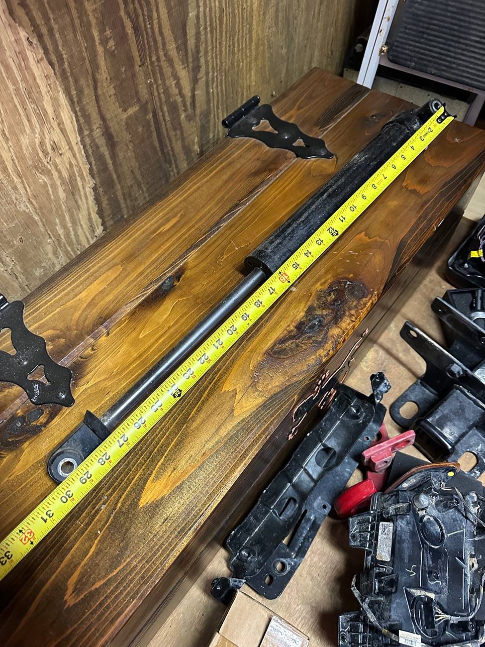

Are the 2.25s long enough for temp use?
hoag4147
Rick
Dec 13, 2019
64
4,450
6,196
Colleyville, TX
2022 JLUR XR
Yeah, not as long, but ok for back ups, fronts are 29.25 extended rears are 30.25…..

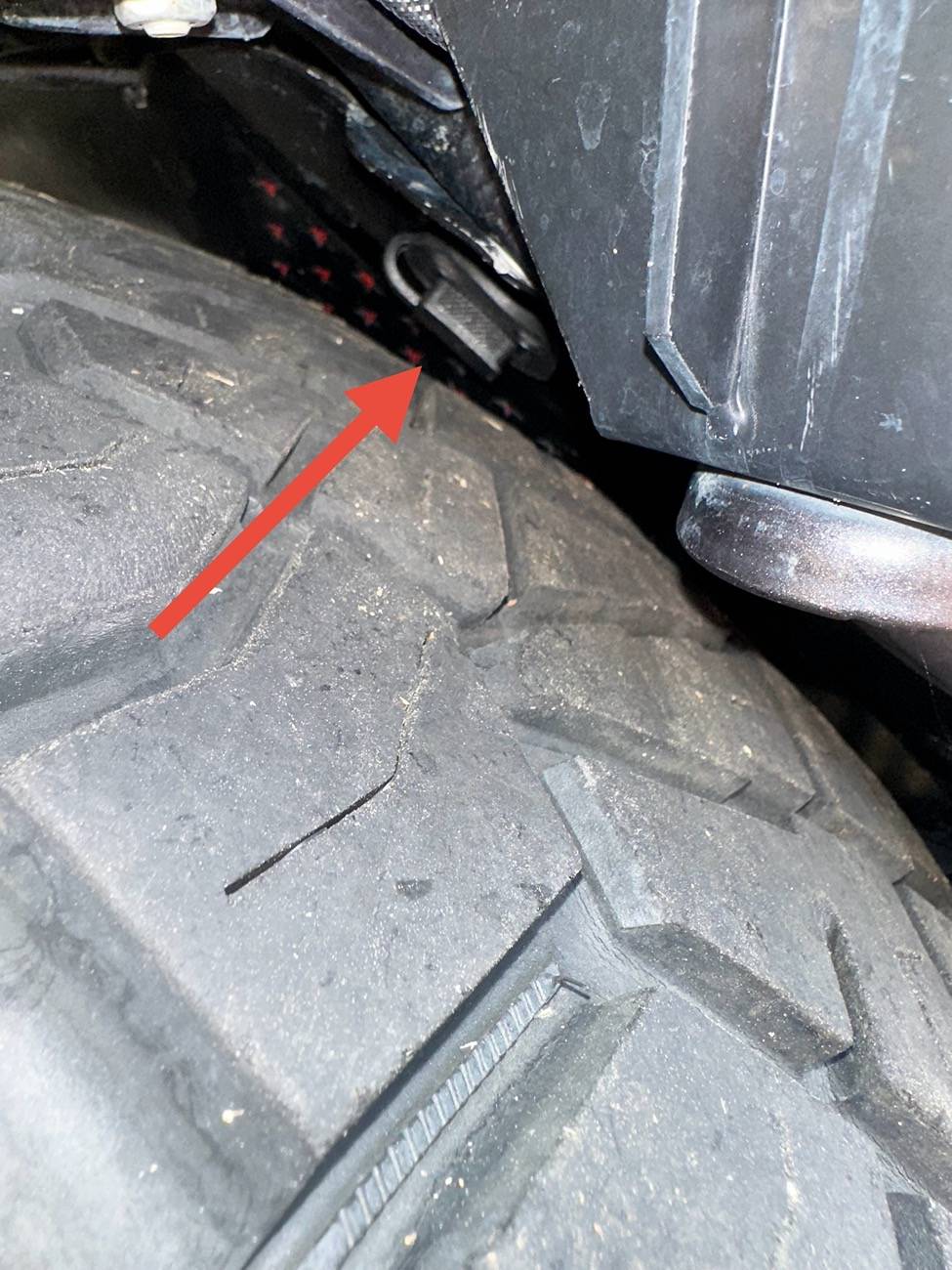

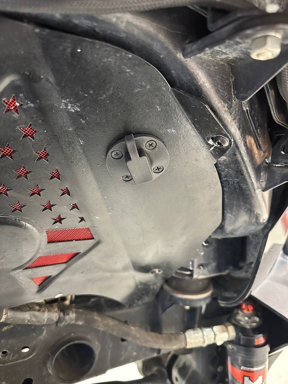

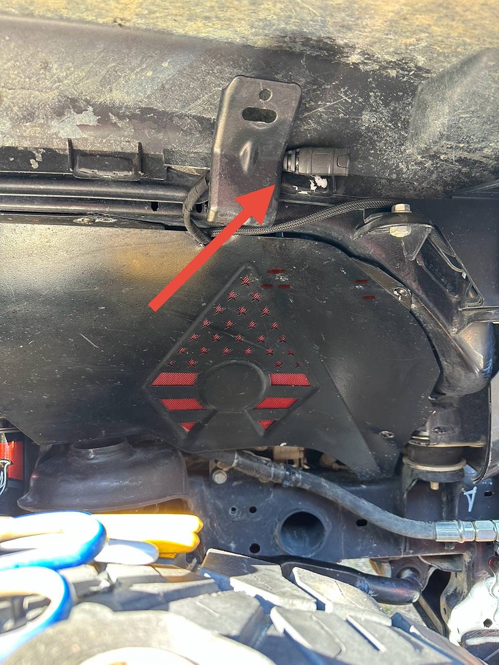

Cleaned up my norco genius 10 external plug today….. didn’t care for having it pinned up under the fender bracket……
Jeep Wrangler JL Crystal Rubi build… IMG_0546
Now it’s here….
Jeep Wrangler JL Crystal Rubi build… IMG_0580
Got it on the ramp turned full lock driver, no issues….
Jeep Wrangler JL Crystal Rubi build… IMG_0587

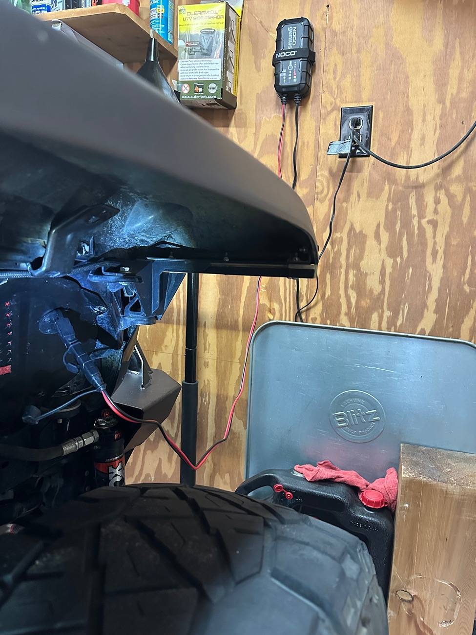

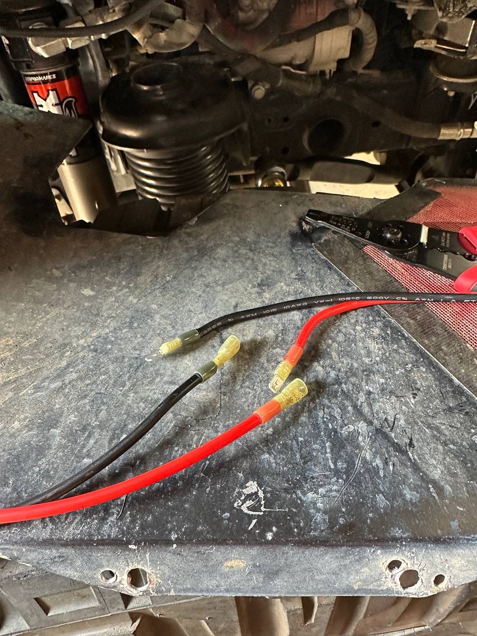

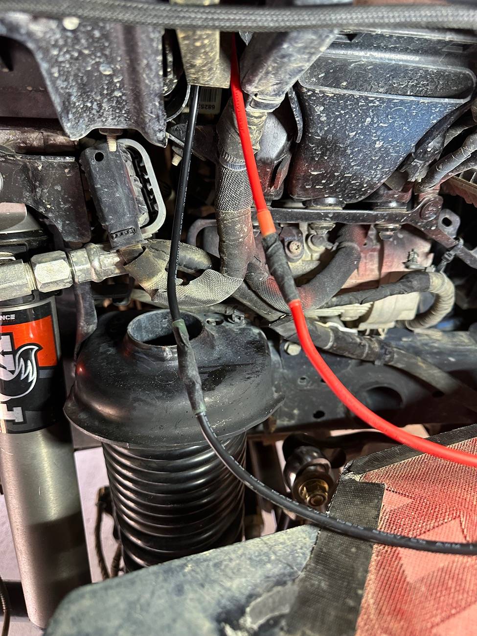

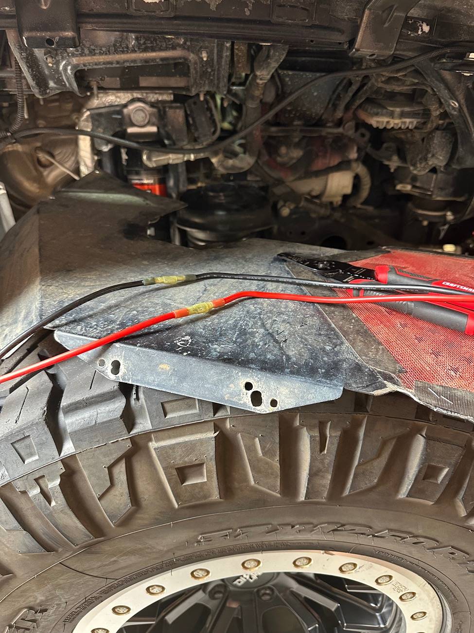

Once again, laziness has prevailed… lol.
I installed a plug on my fender for my Norco 10 so I wouldn’t have to open the hood to hook up, well I don’t want to open the hood and unhook the wires from the battery just to take off my fender either, lol…..so….. I installed a couple quick disconnects, now I just pull the tape and pull them apart…..the wife thinks I’m a genius…🙄….but in reality laziness is just a powerful motivator…..🤣

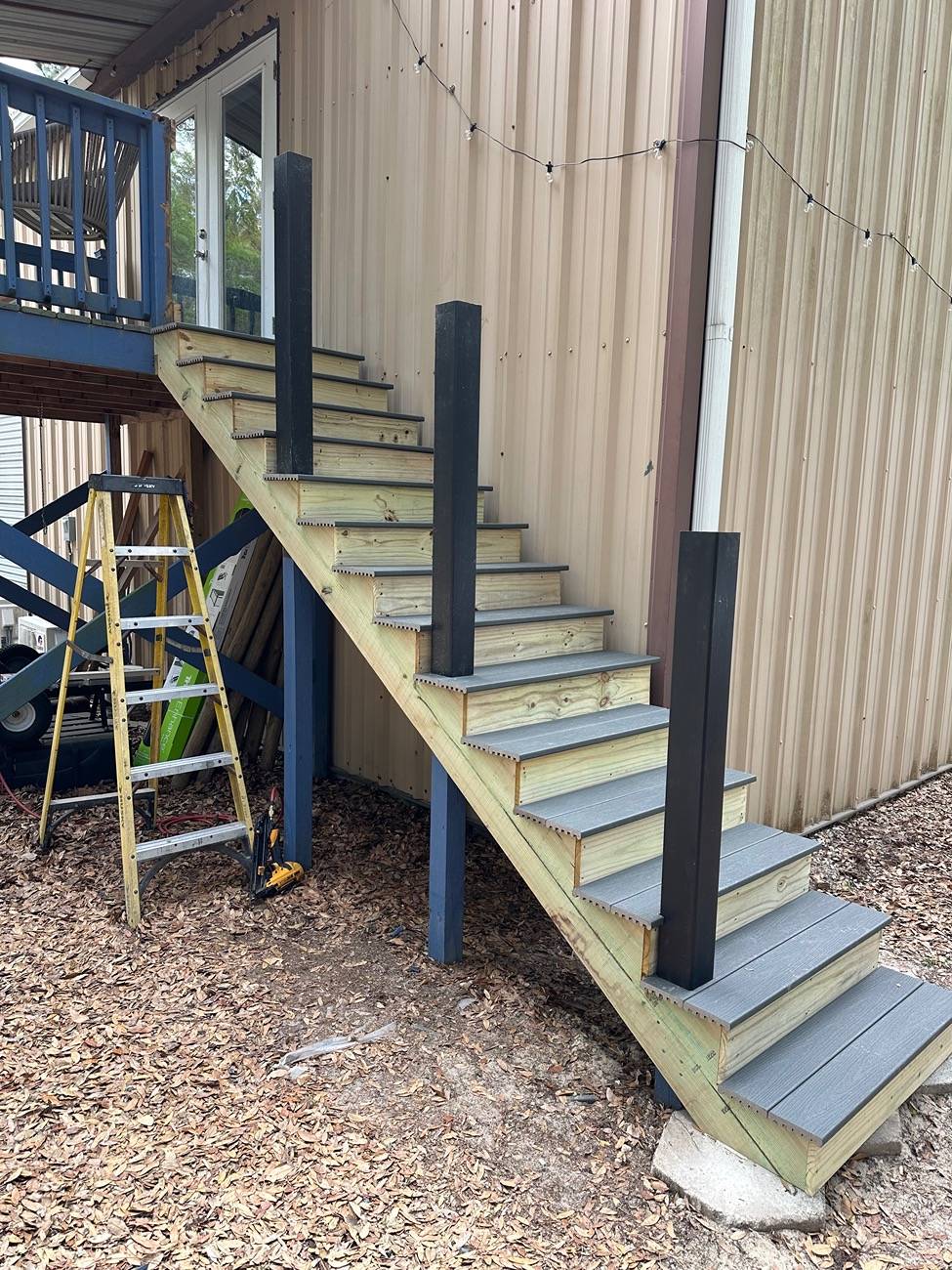

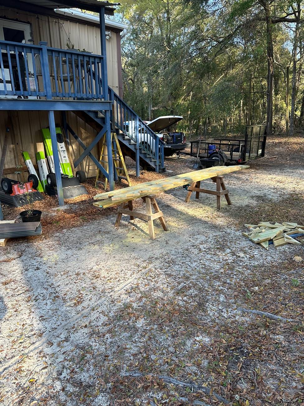

Some pro bono work this weekend…. This is my buddy’s shop. Needed a new set of stairs
Jeep Wrangler JL Crystal Rubi build… IMG_0621
Jeep Wrangler JL Crystal Rubi build… IMG_0622
Jeep Wrangler JL Crystal Rubi build… IMG_0624
Gonna try and finish up the handrails next week….the deck is next, probably in the not so distant future….😂

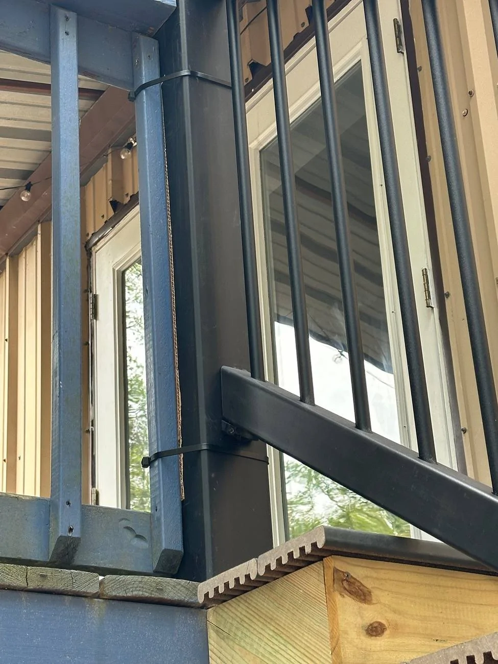

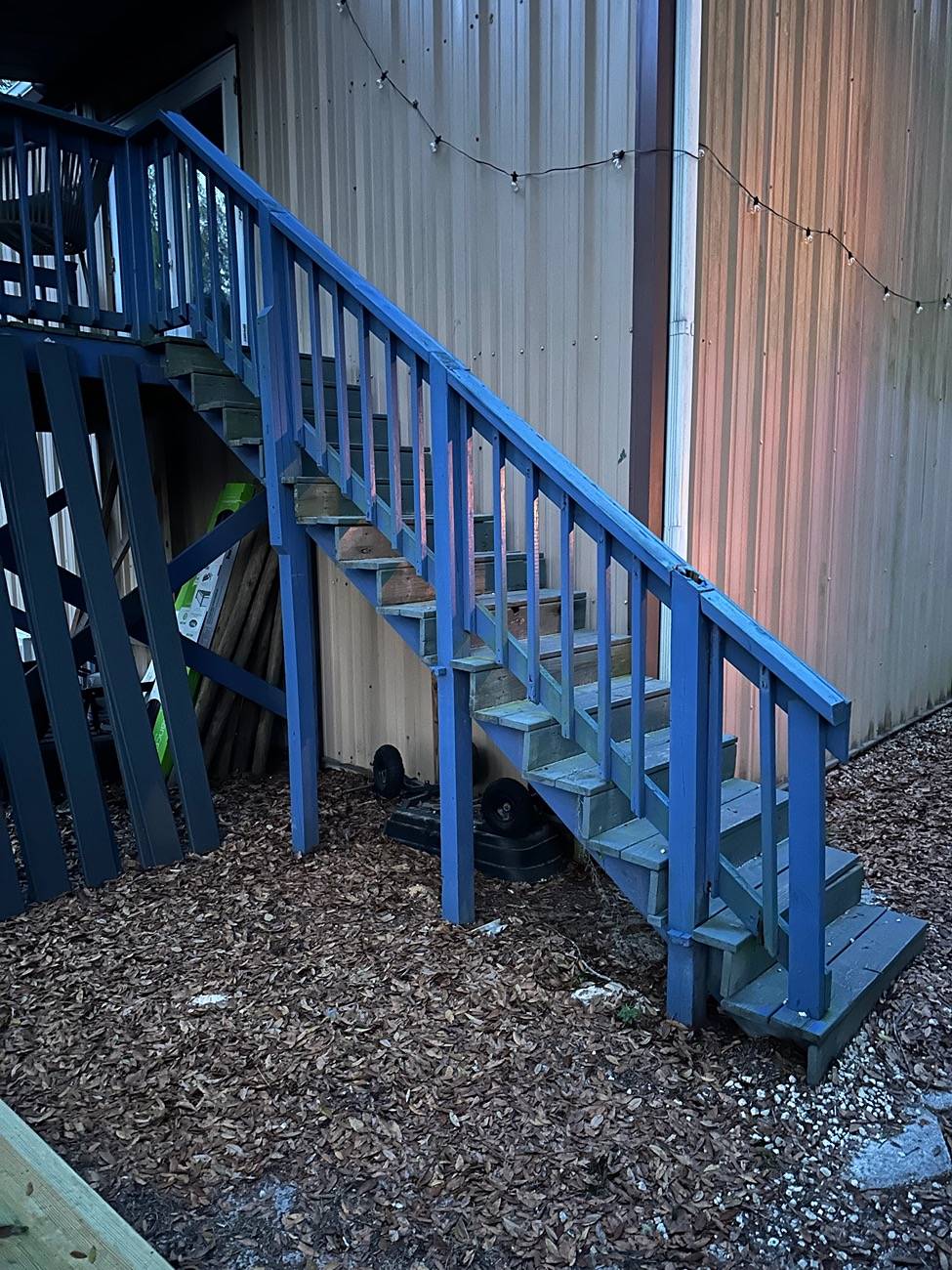

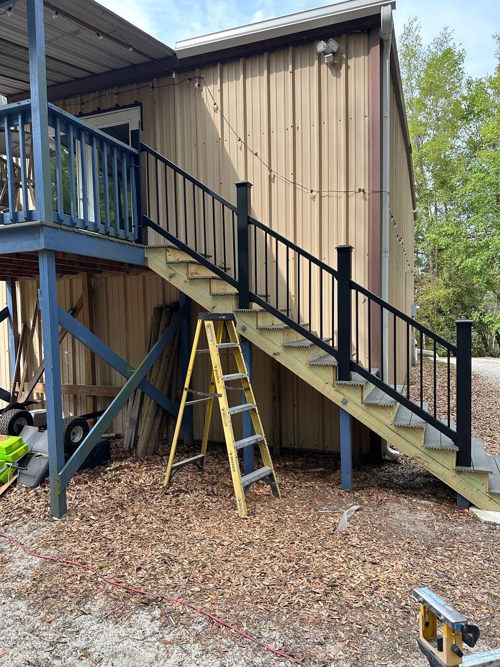

Got the railing done….. at the top I just went straight for now, until he decides to finish the deck…
Jeep Wrangler JL Crystal Rubi build… IMG_0638

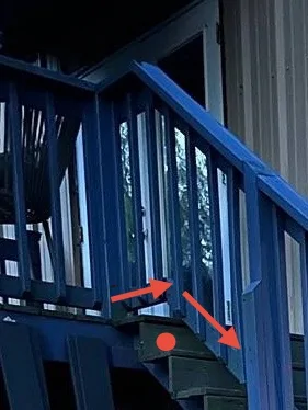

I’ll transition the top stair section so the deck railing and stair railing are at the same elevation……I’ll have to put in a post, can’t easily join stair to straight railing with this particular product like you can with wood…. Pic is how they had it I’ll put in a post where the red dot is…….
Jeep Wrangler JL Crystal Rubi build… IMG_0642
I used a little FL cracker engineering to hold the deck railing in place for now, didn’t want to run screws through the plastic post sleeve that wouldn’t hide later….I used some hurricane zippys, rated for 200 mph winds, and don’t worry, I torqued them to spec….😂
Jeep Wrangler JL Crystal Rubi build… IMG_0639
