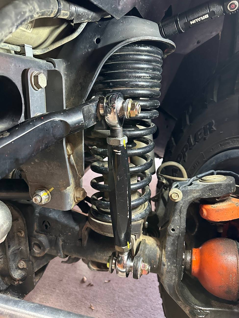

Time to stop being lazy…😂 and drill out my sway bar for 9/16ths bolts… they fit everywhere except the bar itself, it’s 14 mm, so I been just tightening the shit out of the bolts….. but, since I use the disco so much (even on pavement) it works loose after a while….

Nah, it’s not tight anymore, when I put them on I just used the smaller bolts because that’s what fit the bar, I’ve been meaning to clearance the bar for the bigger bolts, you know for 5 years now, :facepalm: …… it’s just to easy to tighten them up and go……😂 ….

All fixed…. the sway bar holes were 12mm and the axle brackets are 1/2”ish…..now, 1/2” shoulder bolts everywhere…..Leftover MC hardware from something, lol…. They were in my junk drawer……. I just hope my rig doesn’t burst into flames 🔥 RK and MC so close together….😂

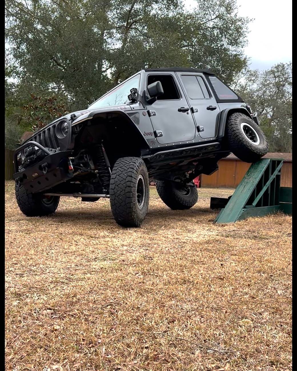

Went and got her weighed the other day…… 5520 lbs with me (200) in it…..That’s not horrible, just a little chubby 🤣….I don’t have any under armor on her yet, just diff skids… l plan on Artec aluminum, full kit is only 86 lbs….
This also gives me some clarity on just how stout my wooden ramp is… I’m not sure how much of the weight is actually on the ramp, but sometimes I don’t get on there perfectly and it still doesn’t budge……💪….case in point here….…😬
