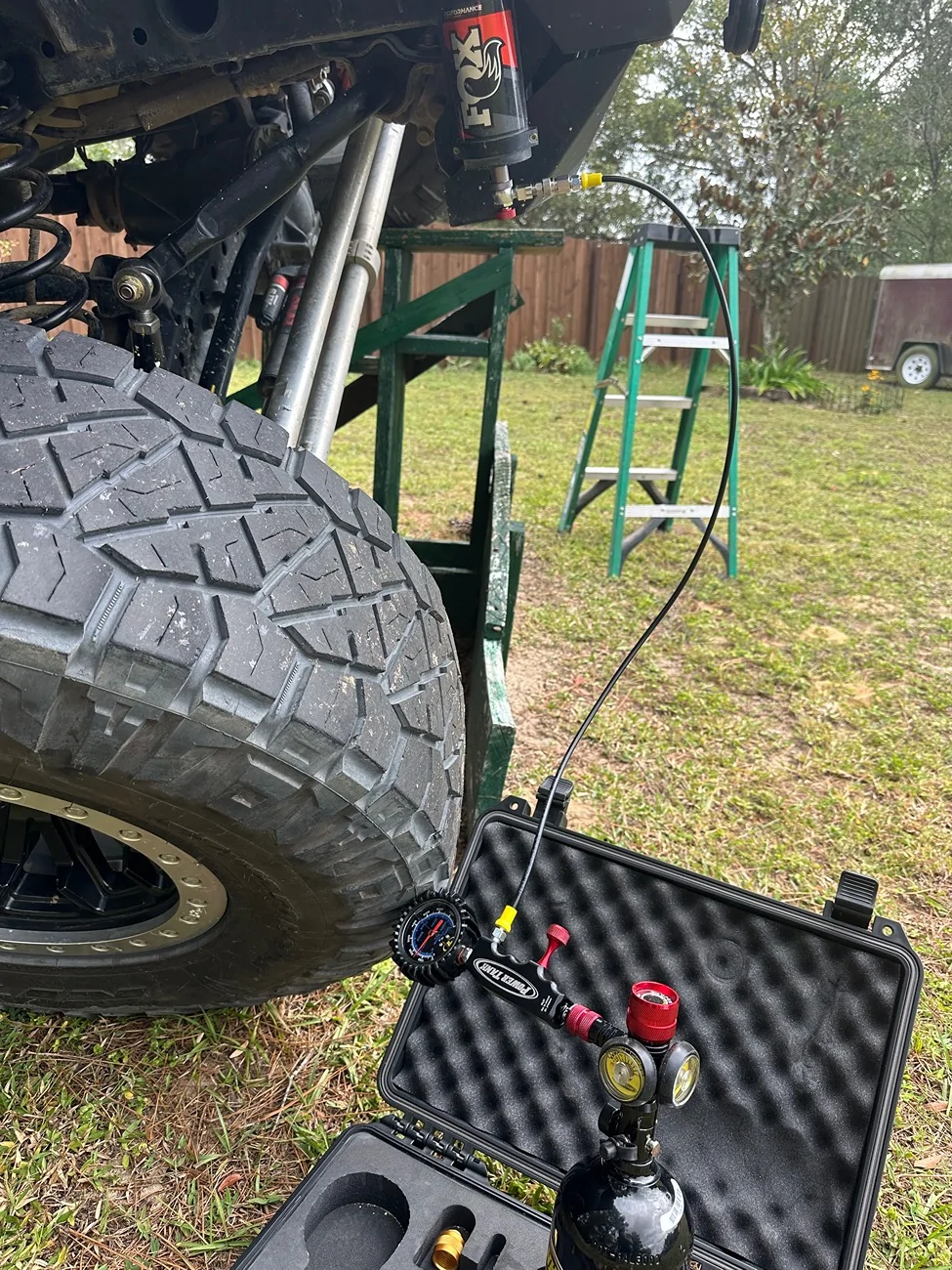

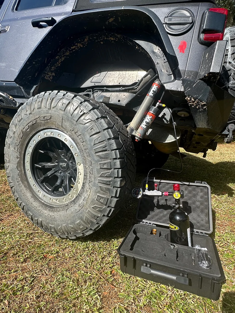

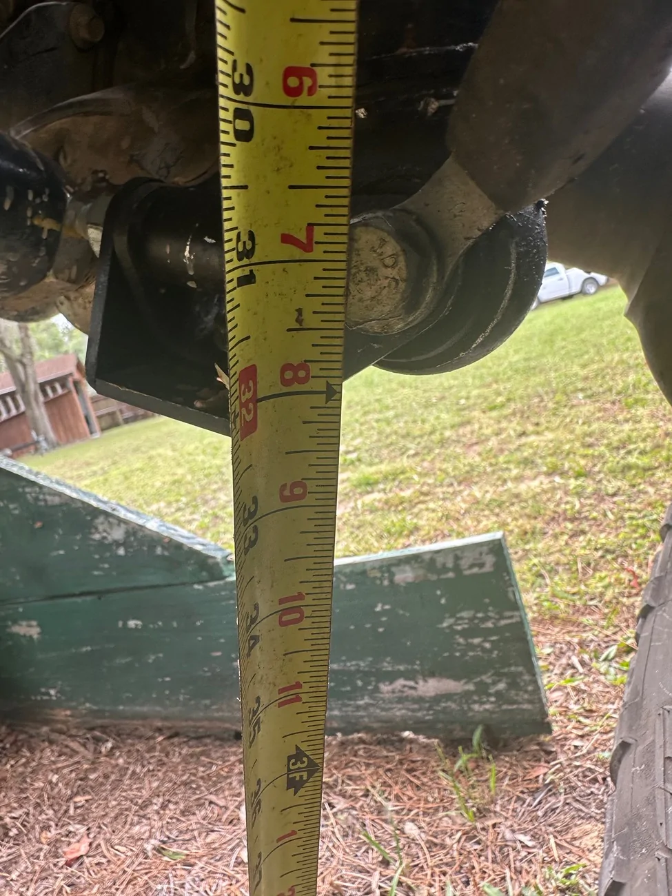

Used my head ( not a an everyday occurrence 🤣) and used my ramp to adjust/fill my shocks with nitrogen….. The rule for my shocks ( Fox Elite DSCs ) is 200 psi , but I’m trying 150 psi since my rig isn’t overly heavy and I’m not running the Baja…… If I notice any issues I’ll take them up to 200….
I know a couple guys running 150 without any issues….Pics are of one side, I won’t bore you to tears showing both sides being done….🤣

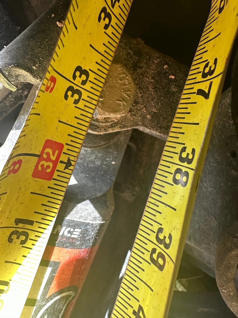

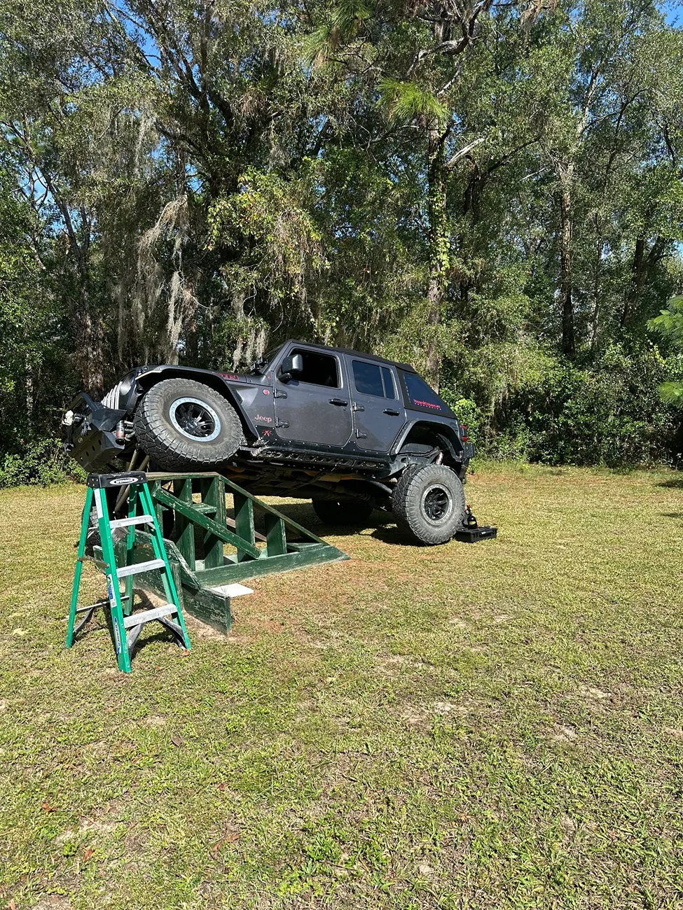

I measured (center to center of bolts) to make sure I was fully extended…I have to take it to my buddies house to use his lift, or put it on 12 ton stands and take the wheels off to get full droop…. Neither scenario sounded good (being lazy today….😂)… By the way, if you’re in the need, this Power Tank Shock Boss is worth every penny IMO…..

It’s freaking awesome….. I could of pieced together something for cheaper, but the thumb screws ( not needing to use wrenches)
paired with quick disconnects on the hoses, is so sweet… To me it was worth every penny…..

Not a true test yet, but a test drive it felt a little less harsh, but not really an OMG moment that I was expecting….. headed out this weekend on/off road so I’ll report back after…..there’s no ill effects on the shocks as far as I can tell so far….
