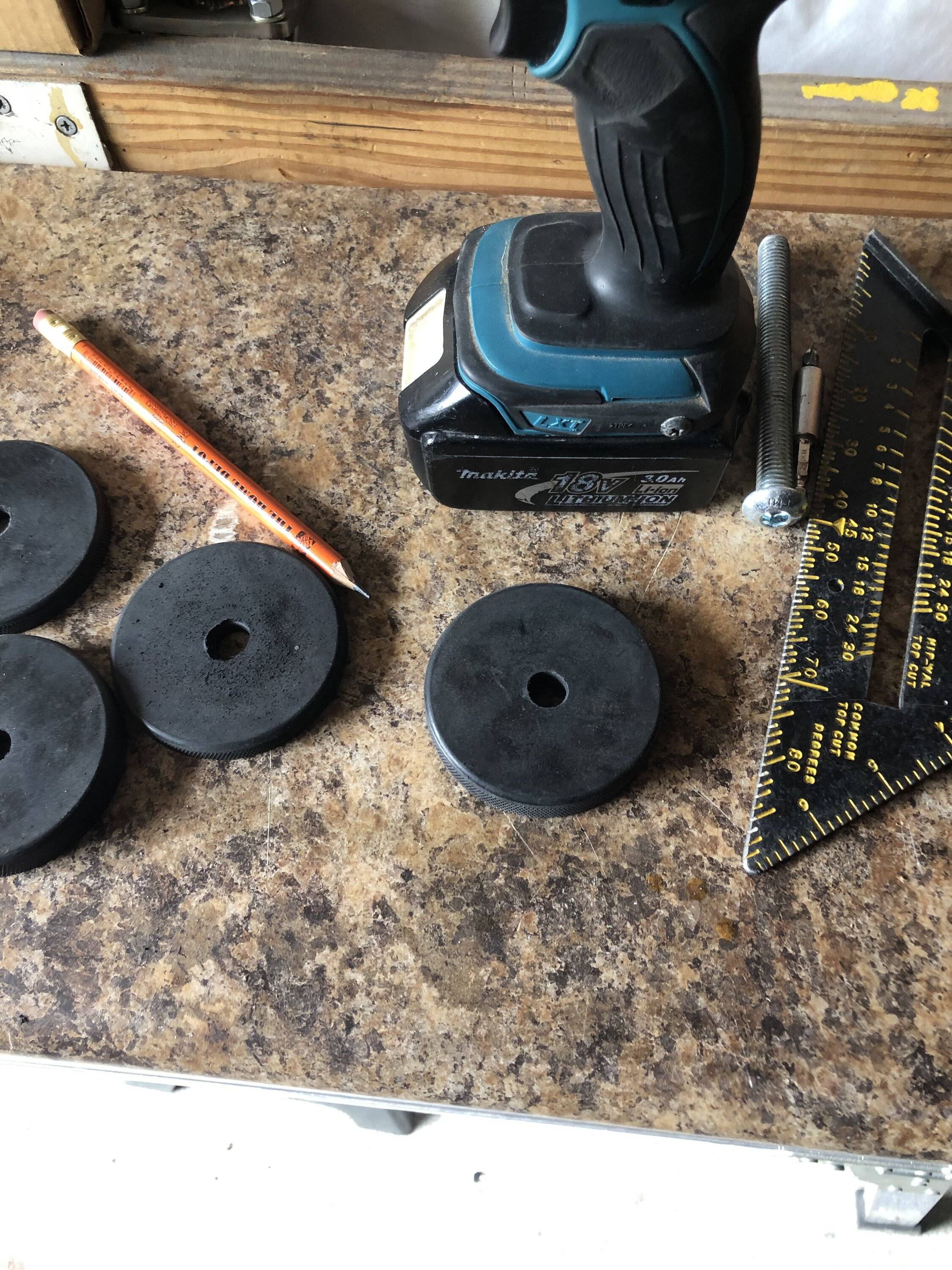

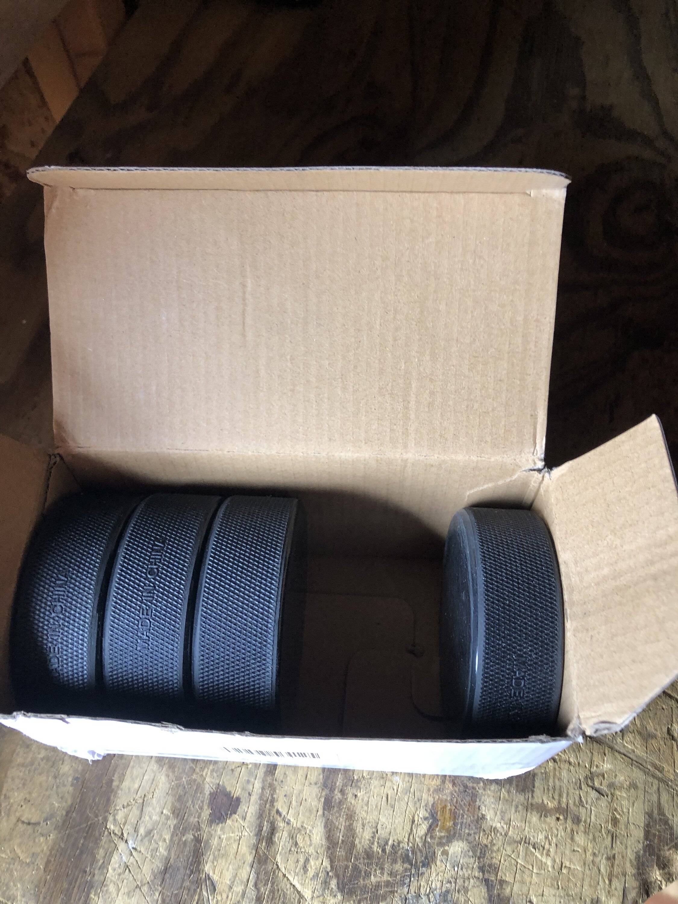

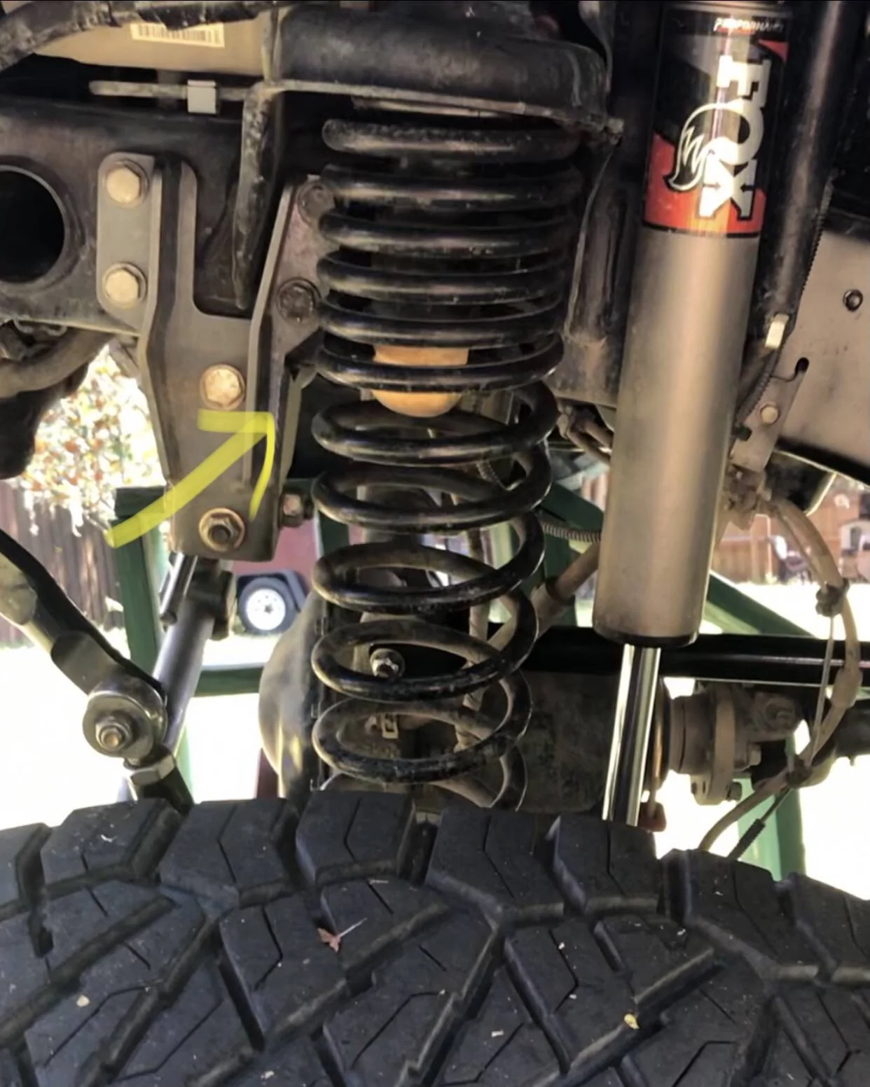

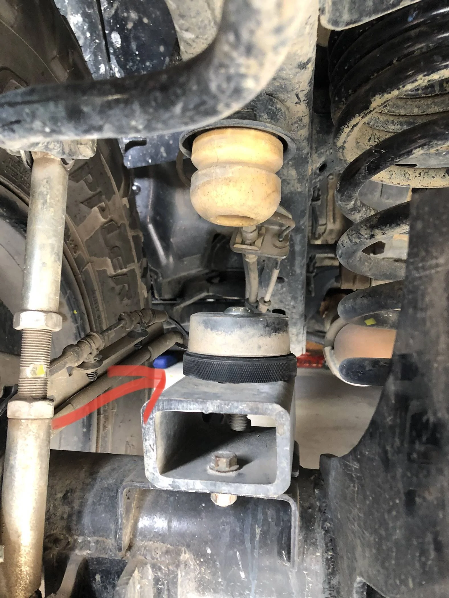

Well after a couple years using a 3/4” nut for a 1/2” bump stop puck, I decided to do it right….it’s not that it doesn’t work, that’s actually why it’s taken this long to change them, lol……
Jeep Wrangler JL Crystal Rubi build… D76D6566-55C4-42D9-AB96-5B6171936025

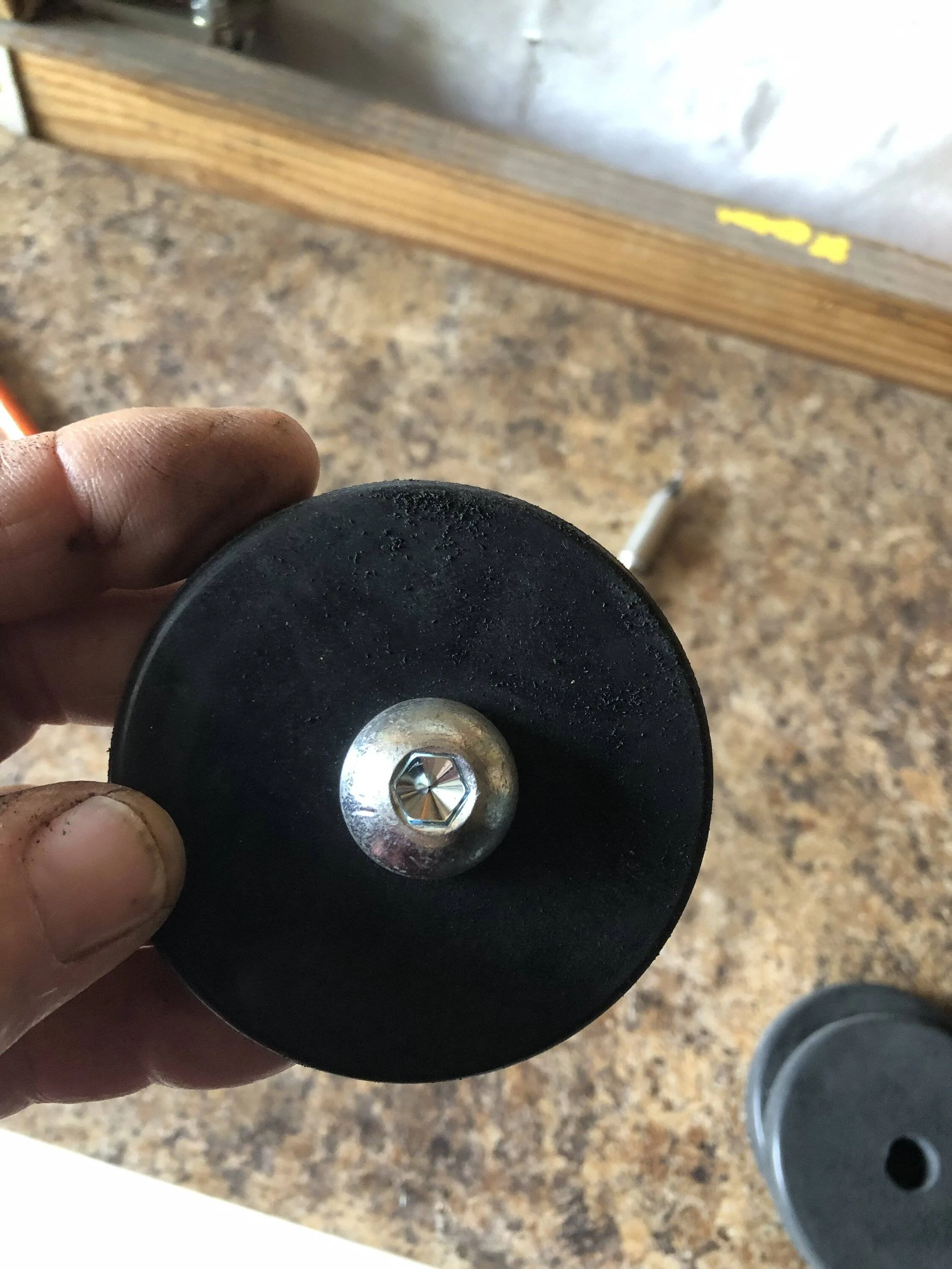

I was gonna buy some 1/2” pucks but since I only need 2, I was having a hard time justifying the 70.00 for a kit…( couldn’t find where I could buy just 2) So I bought a 6 pk of hockey pucks for $14.00 off the Amazon…
Jeep Wrangler JL Crystal Rubi build… 268ABDC9-CCF4-4593-86C3-A80803E7AE2F

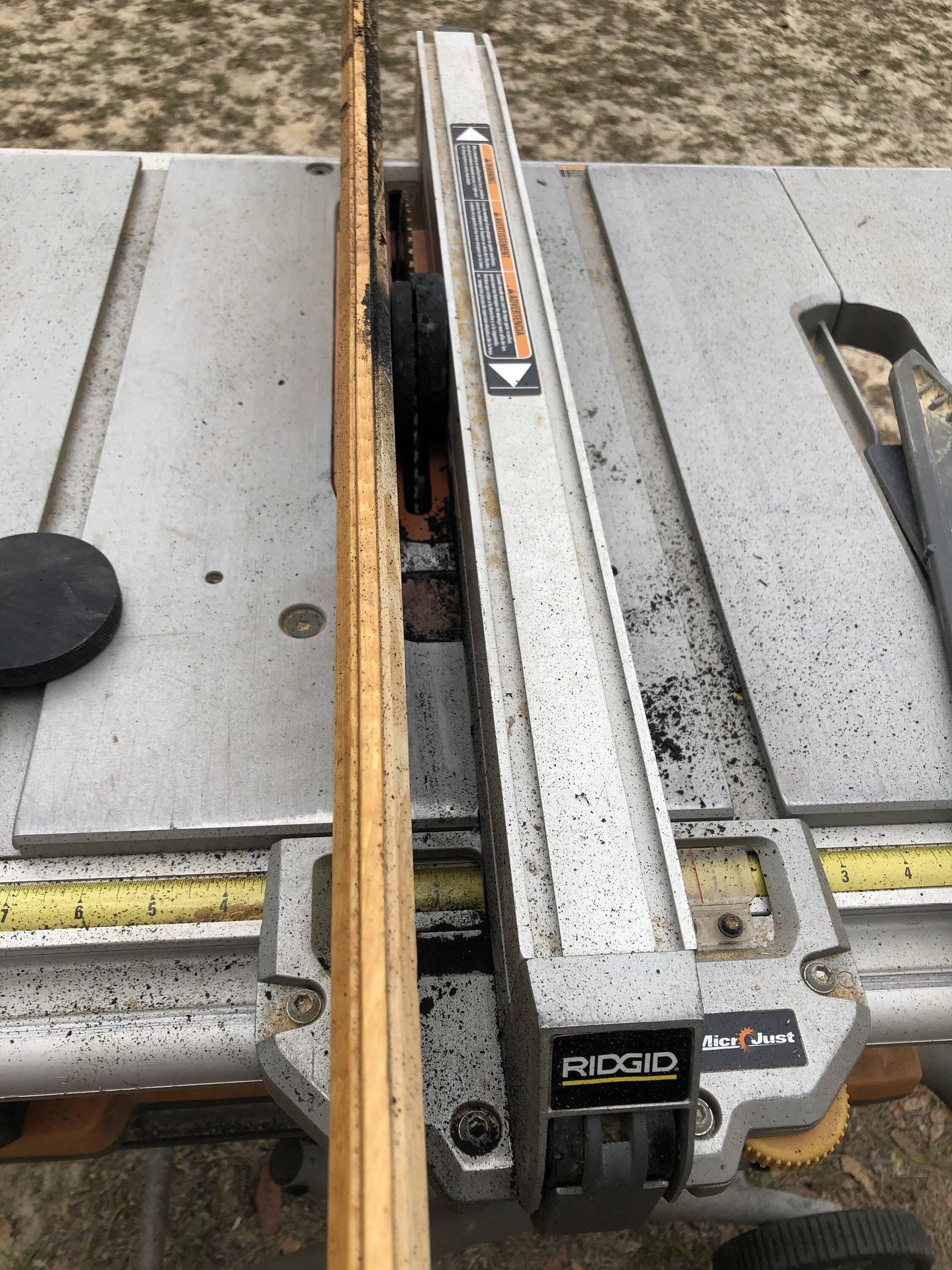

I ran a couple of them through the table saw, drilled a 5/8” hole in them….. two 1/2” bump pucks for $2.30 each and 30 minutes of my time…….:)
Jeep Wrangler JL Crystal Rubi build… 53557DA2-05A7-4721-AD5D-B3354E6FFE6F
Jeep Wrangler JL Crystal Rubi build… 065CD589-9730-415A-98EB-D06BC5D597B8
Jeep Wrangler JL Crystal Rubi build… 29431E99-8F4B-47A6-9865-DB77DB4B358B
Jeep Wrangler JL Crystal Rubi build… 97580AC7-45AB-41BA-9827-197A0FB87766

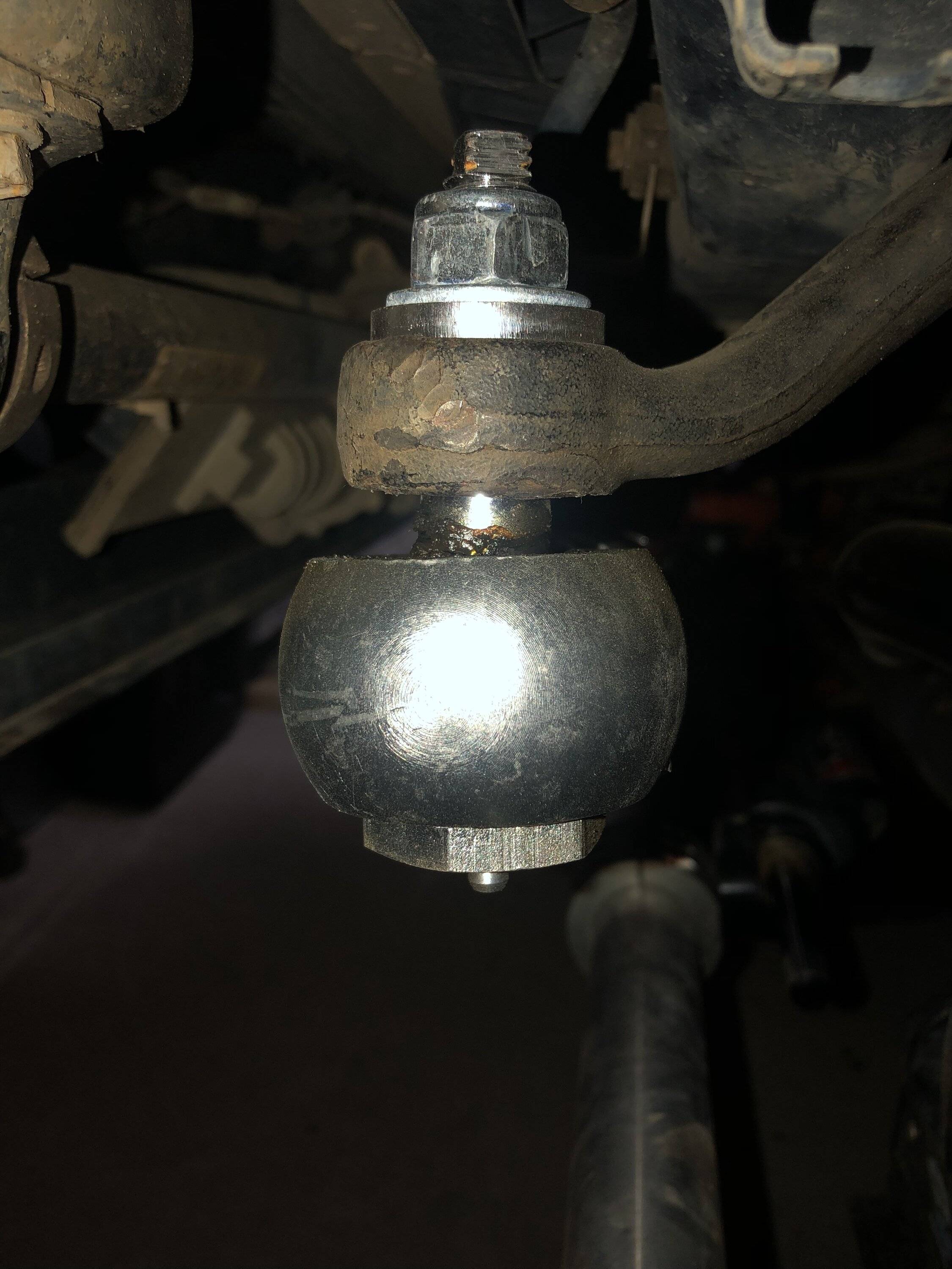

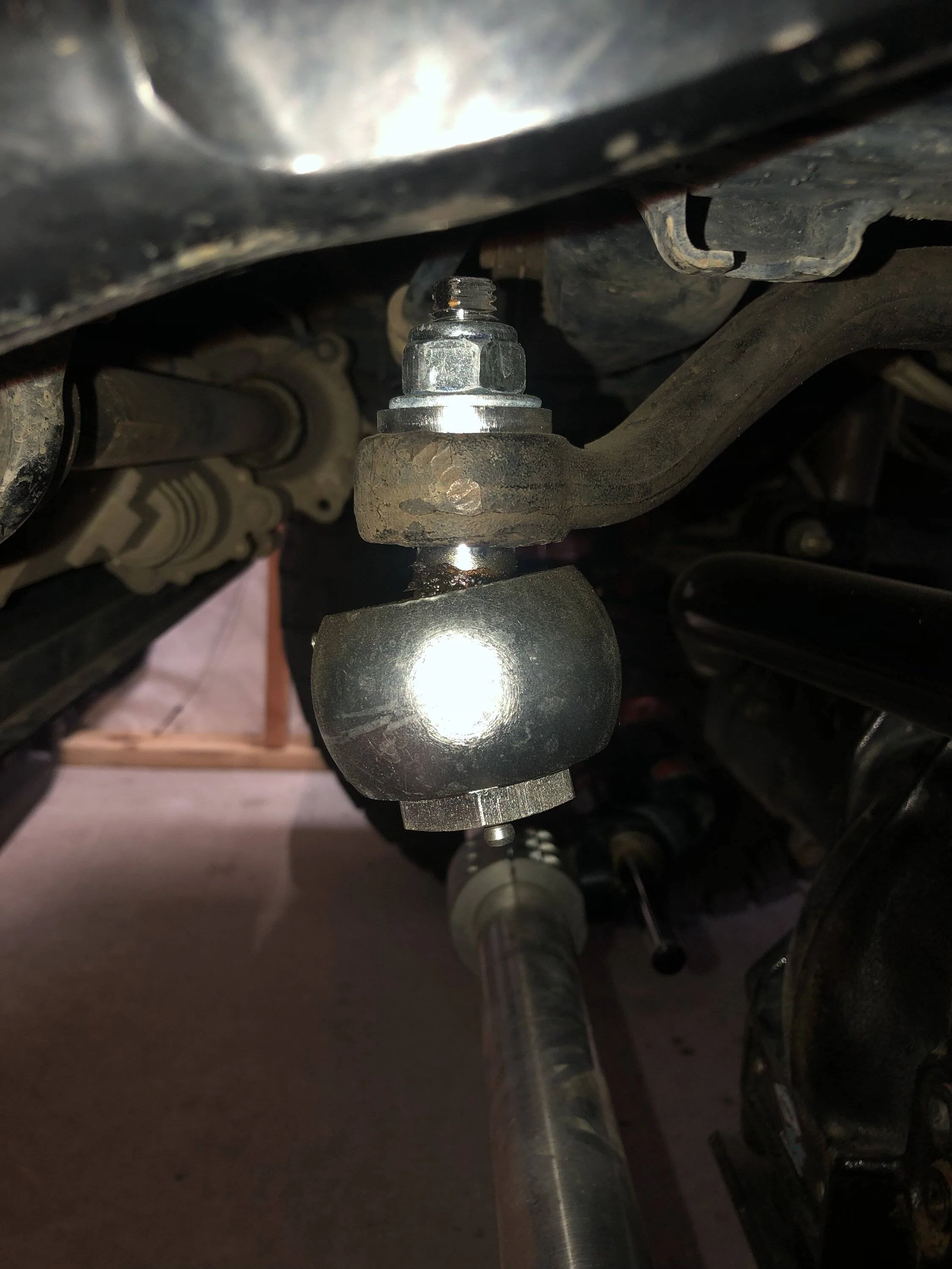

I made myself an anti flop bushing for my RK Pro X drag link…… It has anti flop mechanisms built into the joints but they allow -/+ 15 degrees of movement for long travel mid arm kits…. Since I don’t have the same axle movement with the long arms I don’t need that 15 degrees. But this bushing is soft enough it will smush for most of that misalignment if I need it…….
mid arm…..
Jeep Wrangler JL Crystal Rubi build… F30B75E0-C215-4C54-B301-F46764E833E4
long arm
Jeep Wrangler JL Crystal Rubi build… 69A41789-DDD2-480E-8D3B-247568442E97
I took (4) 1/8” rubber washers, cut them, glued them together toothed so I could put them on without taking the drag link off, then glued the teeth together when I got it on…… I’ll make up a nicer one if this continues to work, so far it’s working great…..
Just want to mention that the way it was flipped over is normal, that’s as far as it will go, and it never presented any problems….it’s designed to work perfectly as is….. it’s just one of those ocd things for me, since the long arm kit allows it, why not take advantage of it…….It’s a small thing, but if I can keep the little bastard in my head happy, then I’m happy……..?
Jeep Wrangler JL Crystal Rubi build… 866997F6-B73E-4DB7-A793-12DC58B6366F
