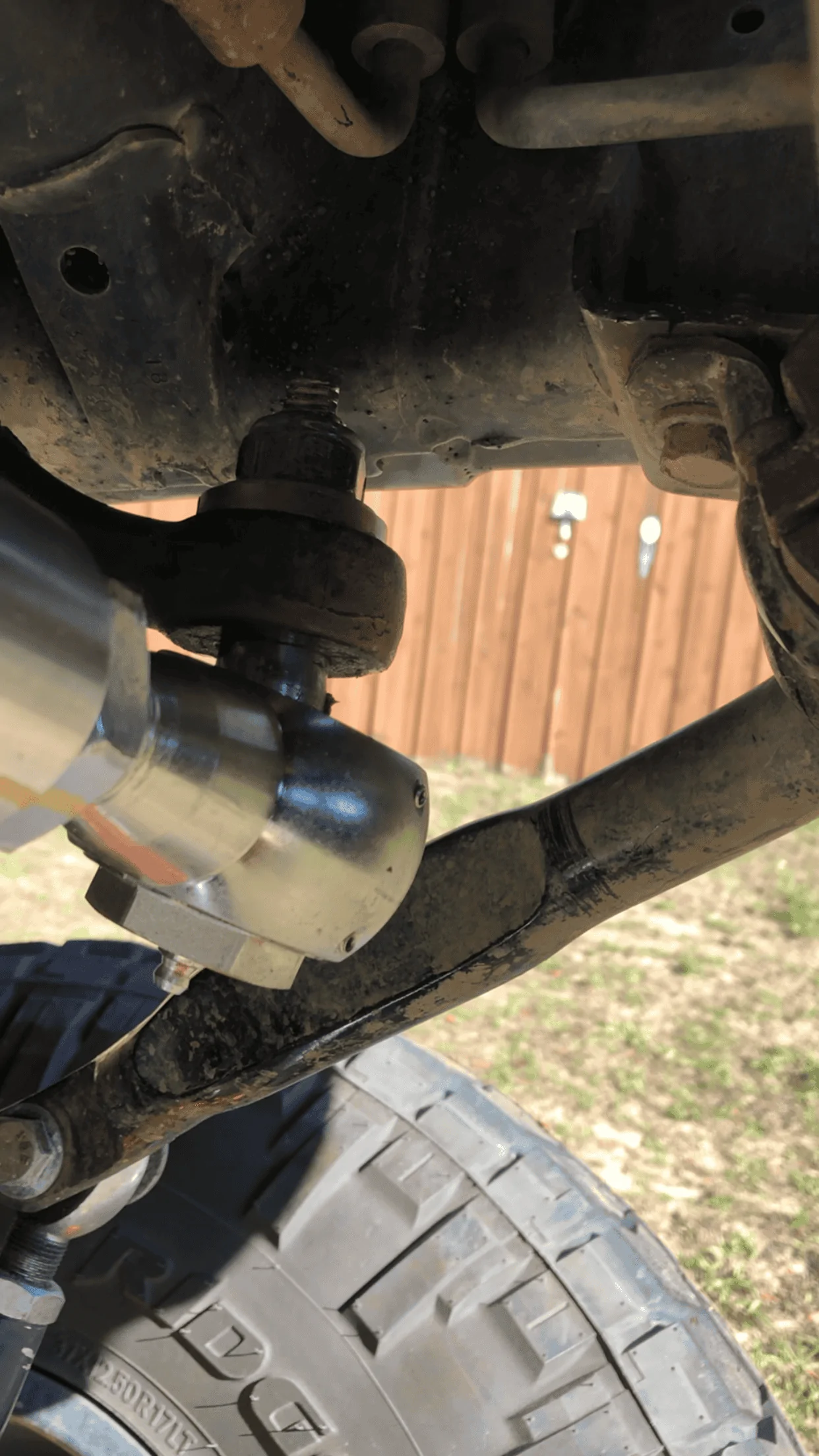

That’s my guess, but I did hear from him while he was at ejs…..we’ll see if I hear anything this week… Not a big deal, I just want guys to be able to run these bars if they want to without being disappointed to have to work at making them work like they should……they’ve got a new bracket to raise steering stabilizer coming out, now if they would offer a bushing for the knuckle side of their drag link so guys aren’t driving around like this…

Well here’s JPs response to my email…….
“We have a small amount of antiwobble in the drag link. +/- 12 degrees. That allows for full axle droop with the axle pulled all the way back on a mid arm. What you are seeing is 100% normal. If not, it can bind and create issues you don’t want to see.

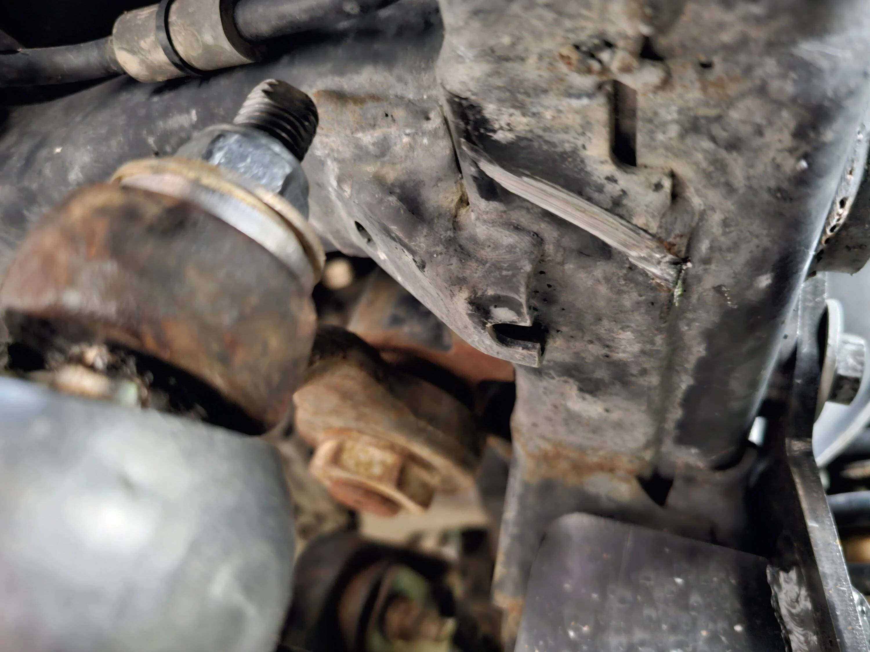

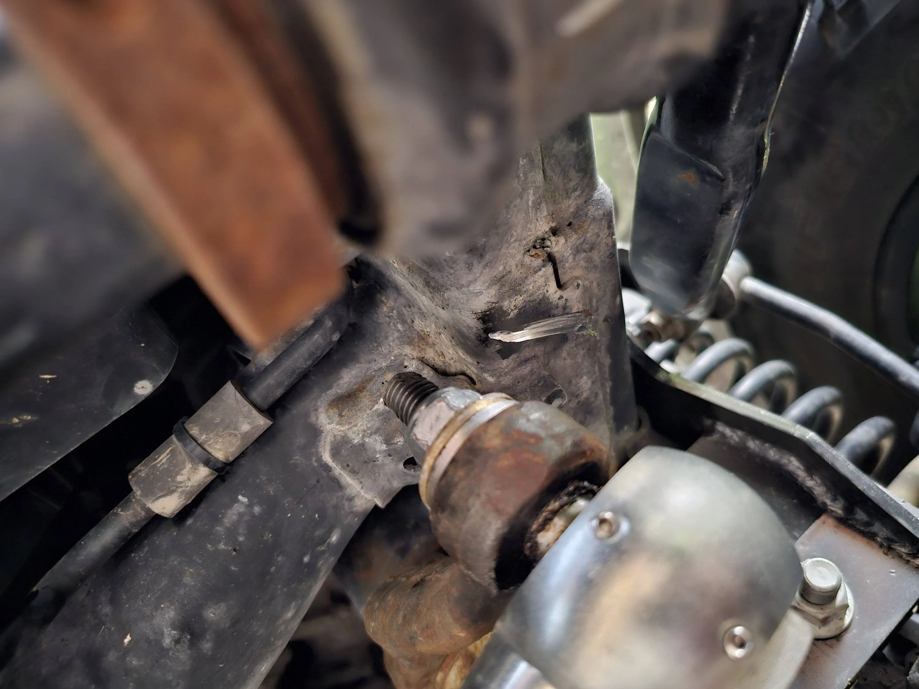

Is anyone else running into clearance issues with the frame?

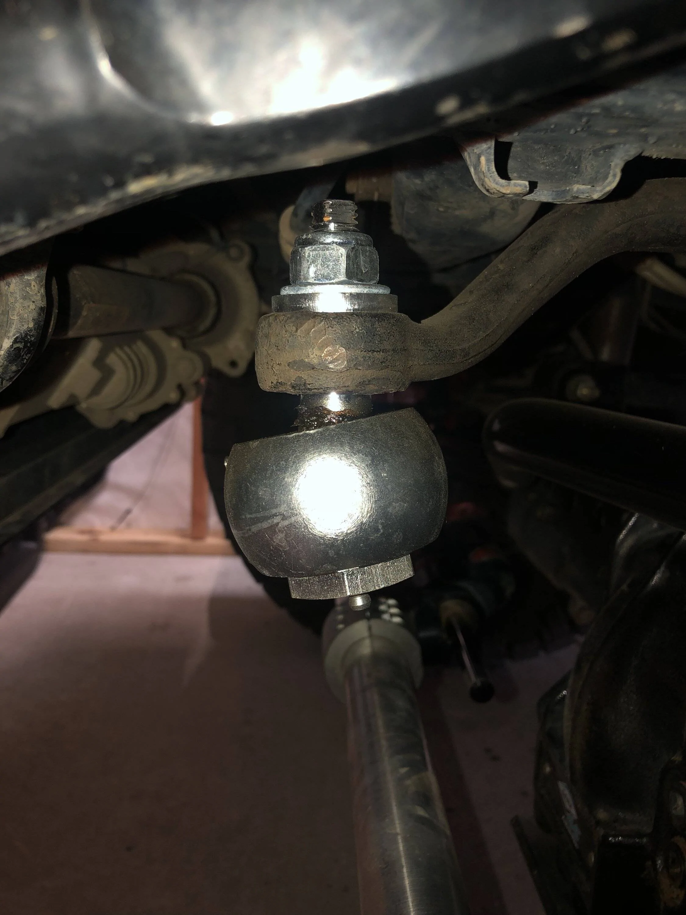

That’s new….lol… I’m not having that issue, and haven’t heard of it till now…. Yours looks like it’s closer to the pitman arm than mine making the bolt higher. Also are you on a 2.5” lift ?

I just had to re-tighten the nut as the frame contact loosened it. Now it really pops when returning from left lock steering. Probably going to have to replace the pitman arm. Or maybe I can sleeve it. Oh,and I'm that crazy bastard running a 2" daystar puck spacer on stock springs.

I don't think lift height will really change anything, as the issue is clearance above the pitman arm, which wouldn't change with taller or shorter springs.

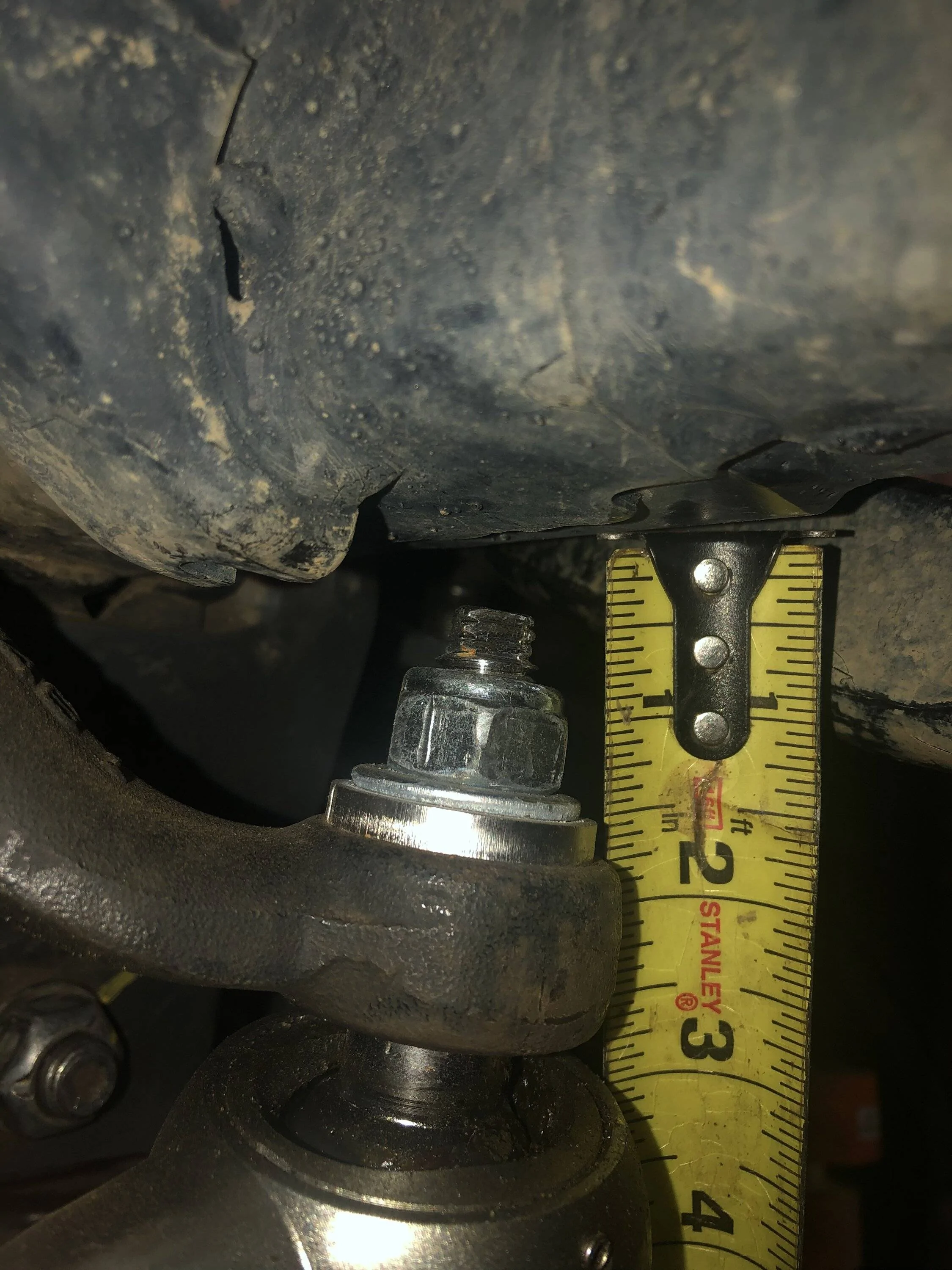

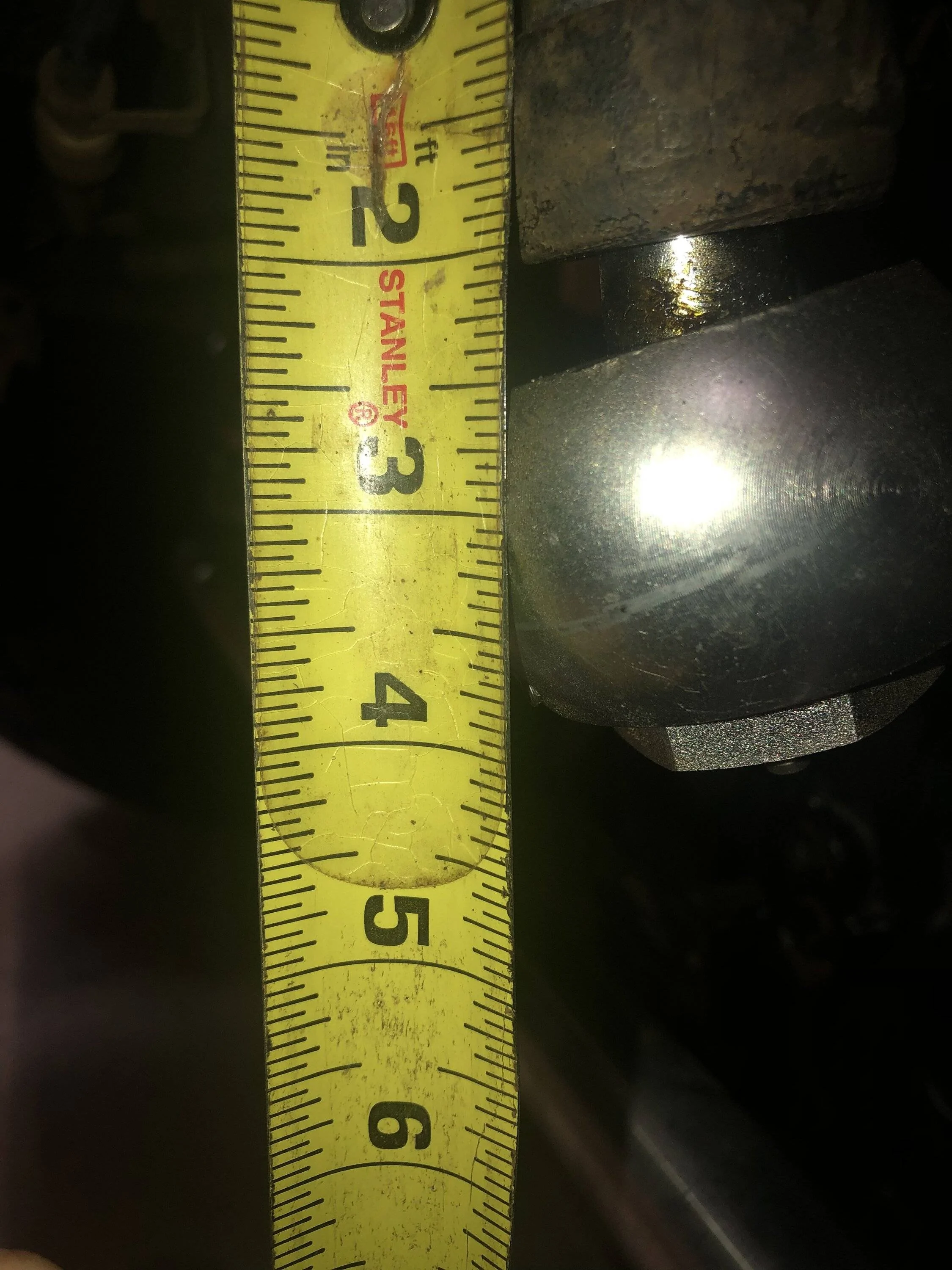

Yeah, that’s right, I’ll get some measurements of how far I’m from the frame, and the gap under the pitman arm for you in the morning
