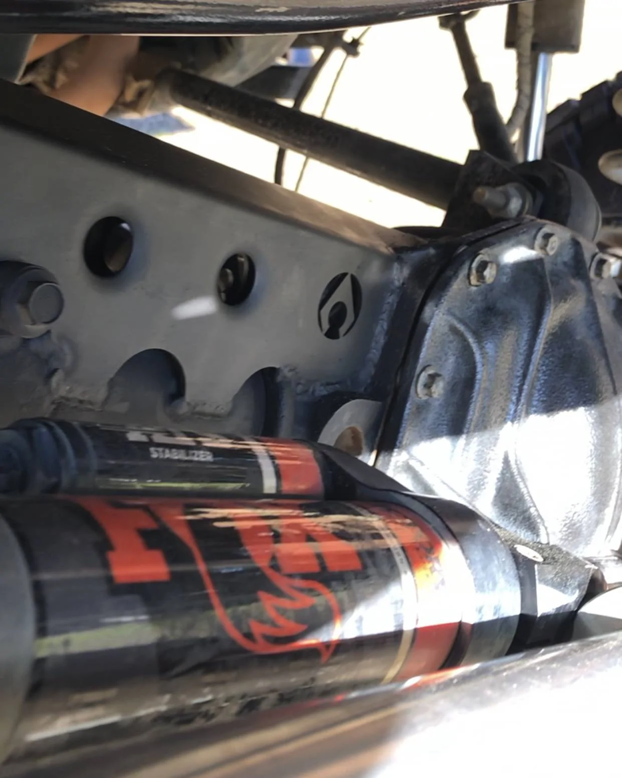

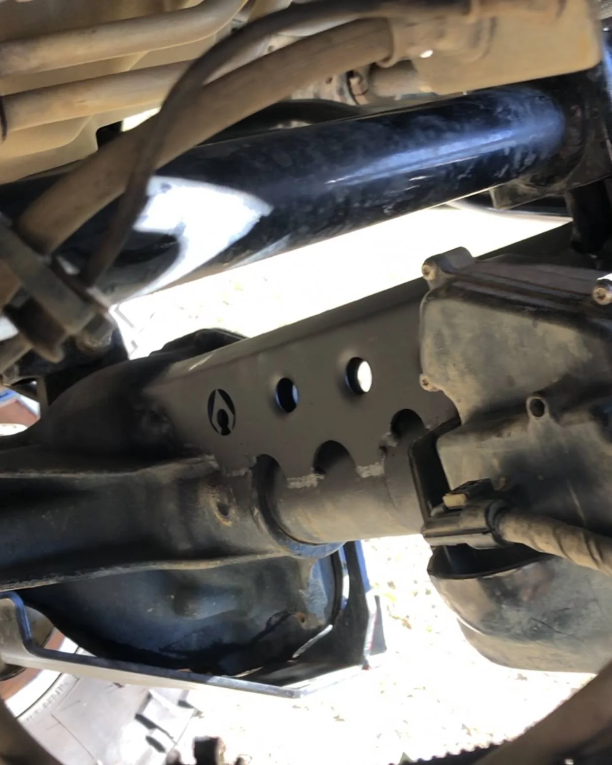

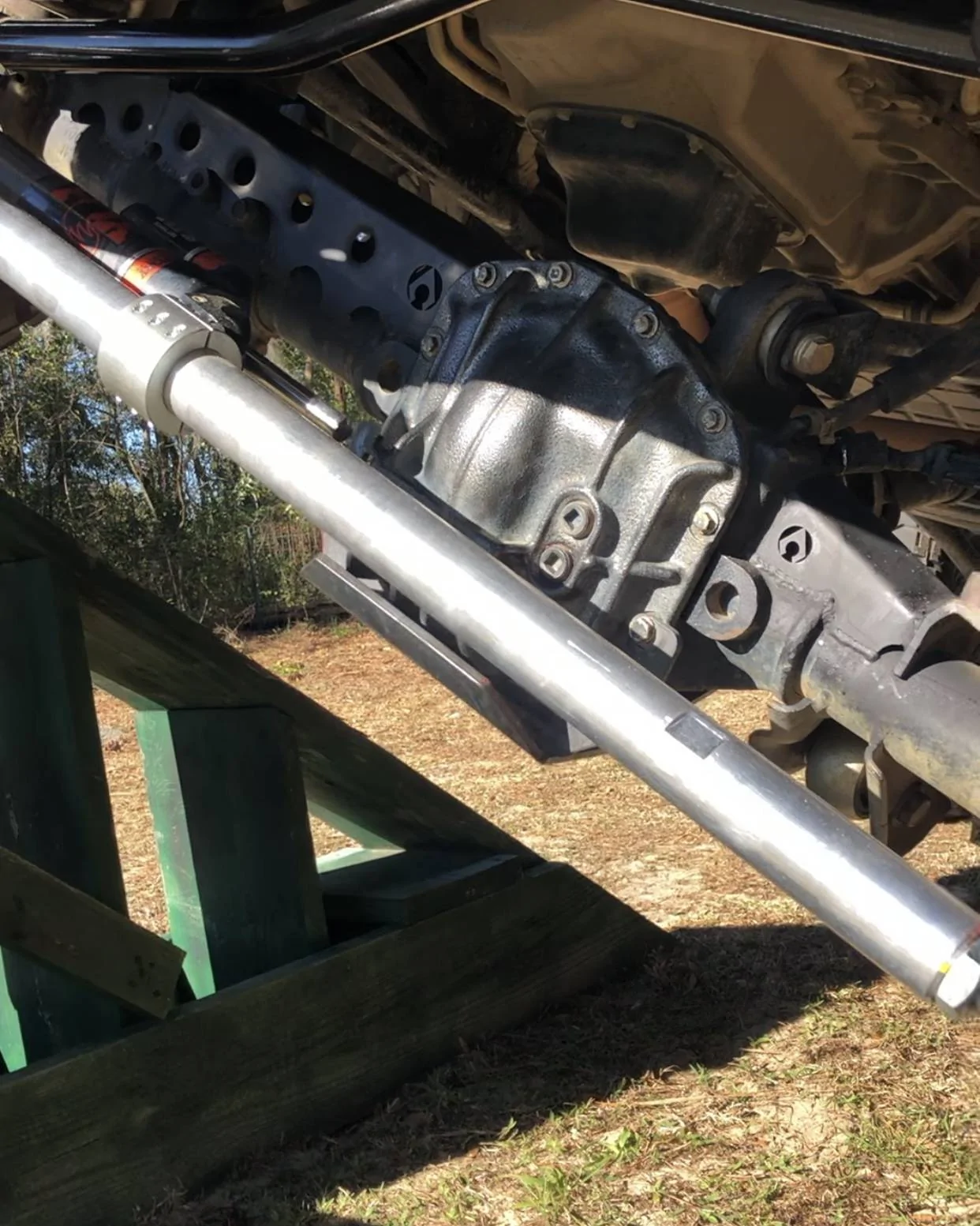

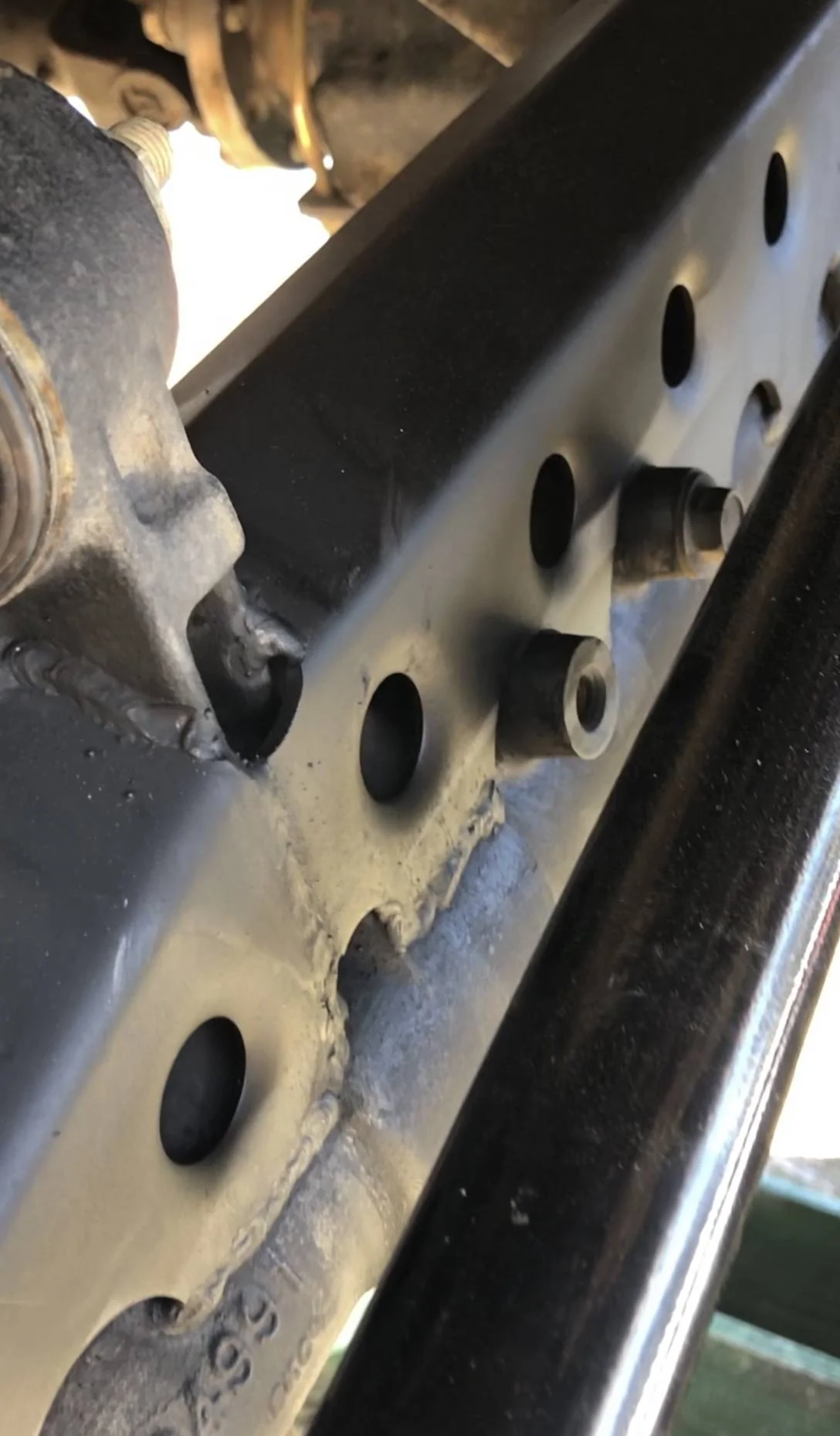

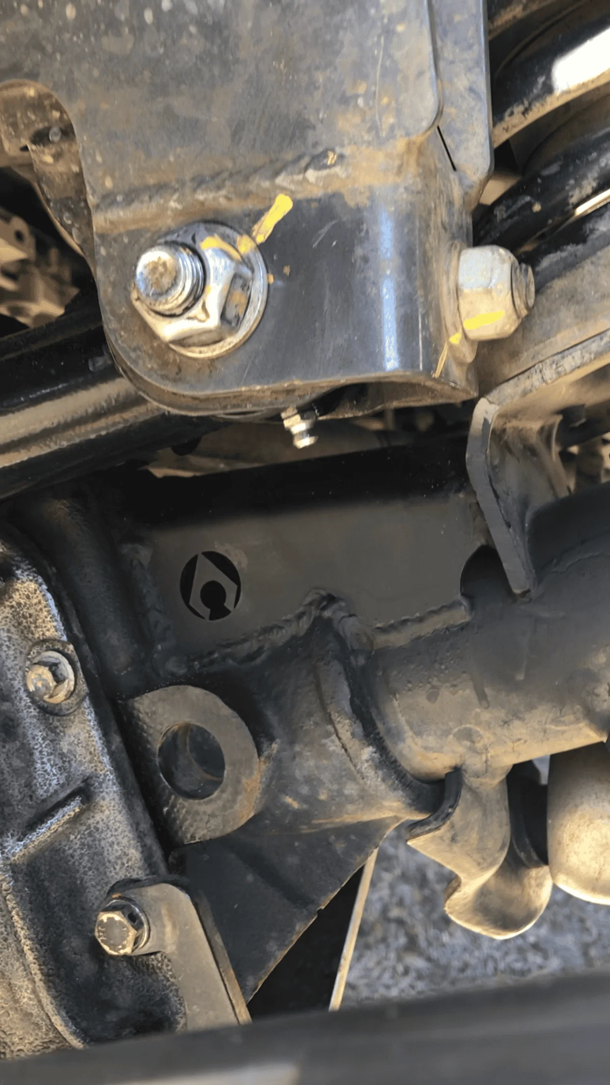

Did clearance test for the Artec truss. I mocked up the truss with cardboard and taped it on the axle to check clearance before I ordered it, but I still wanted to be sure ……. I used this vid as a guide………
I opted to not put the pieces under the spring pads due to my bump stop nut is hard enough to get to as is, with the truss under there, forget about it….lol.

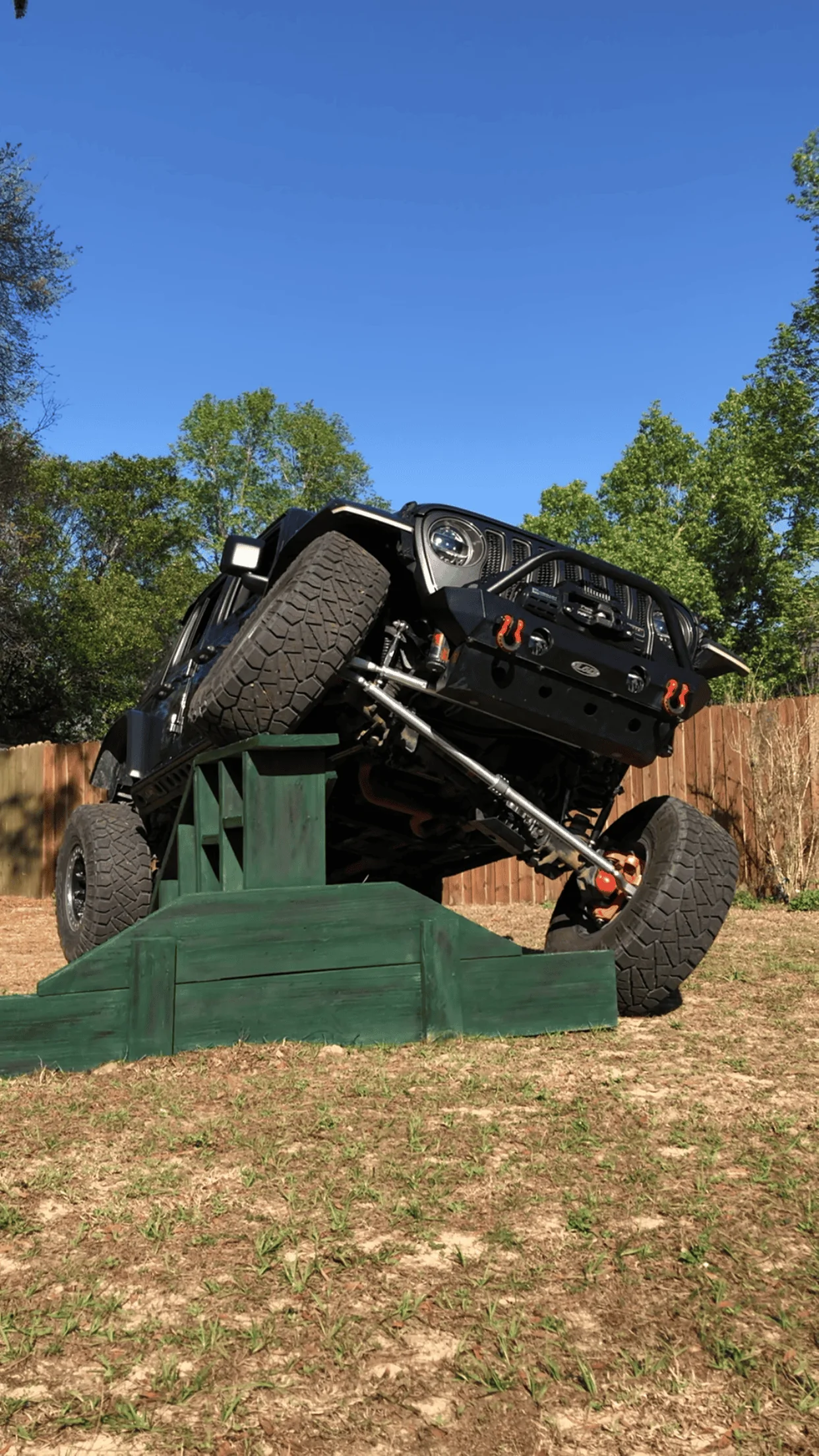

Gave the ramp a fresh coat of paint, it’s gonna need some maintenance soon, Florida weather is the hardest on wood, even marine grade pressure treated, than anywhere I ever lived…..?

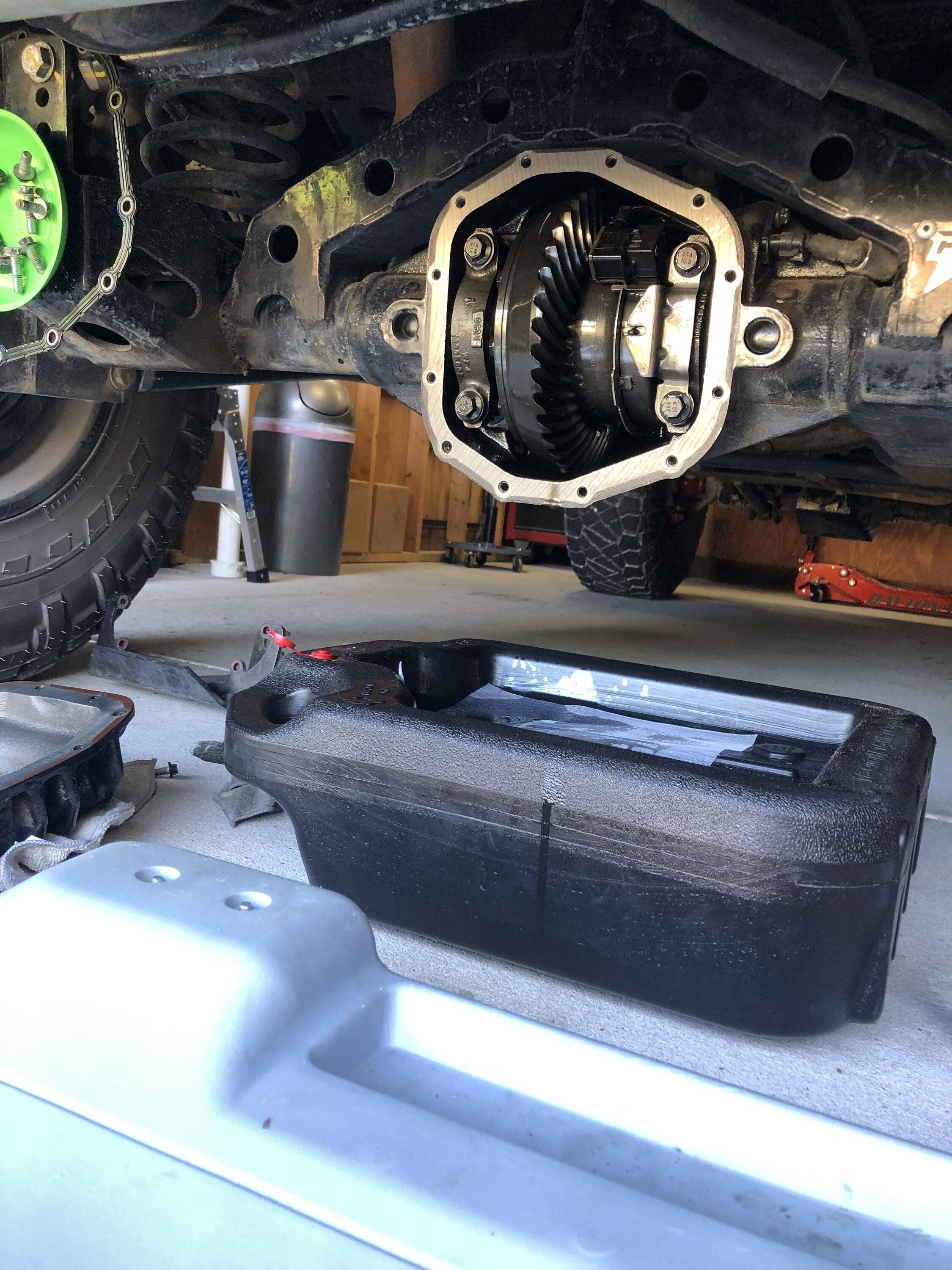

Well I’ve hit 500 miles on my rear gears and only about 30 on the front…I should be around 50-60 on front after this weekend, so I’m gonna change diff oil next weekend…… being out of the break-in period feels like…..

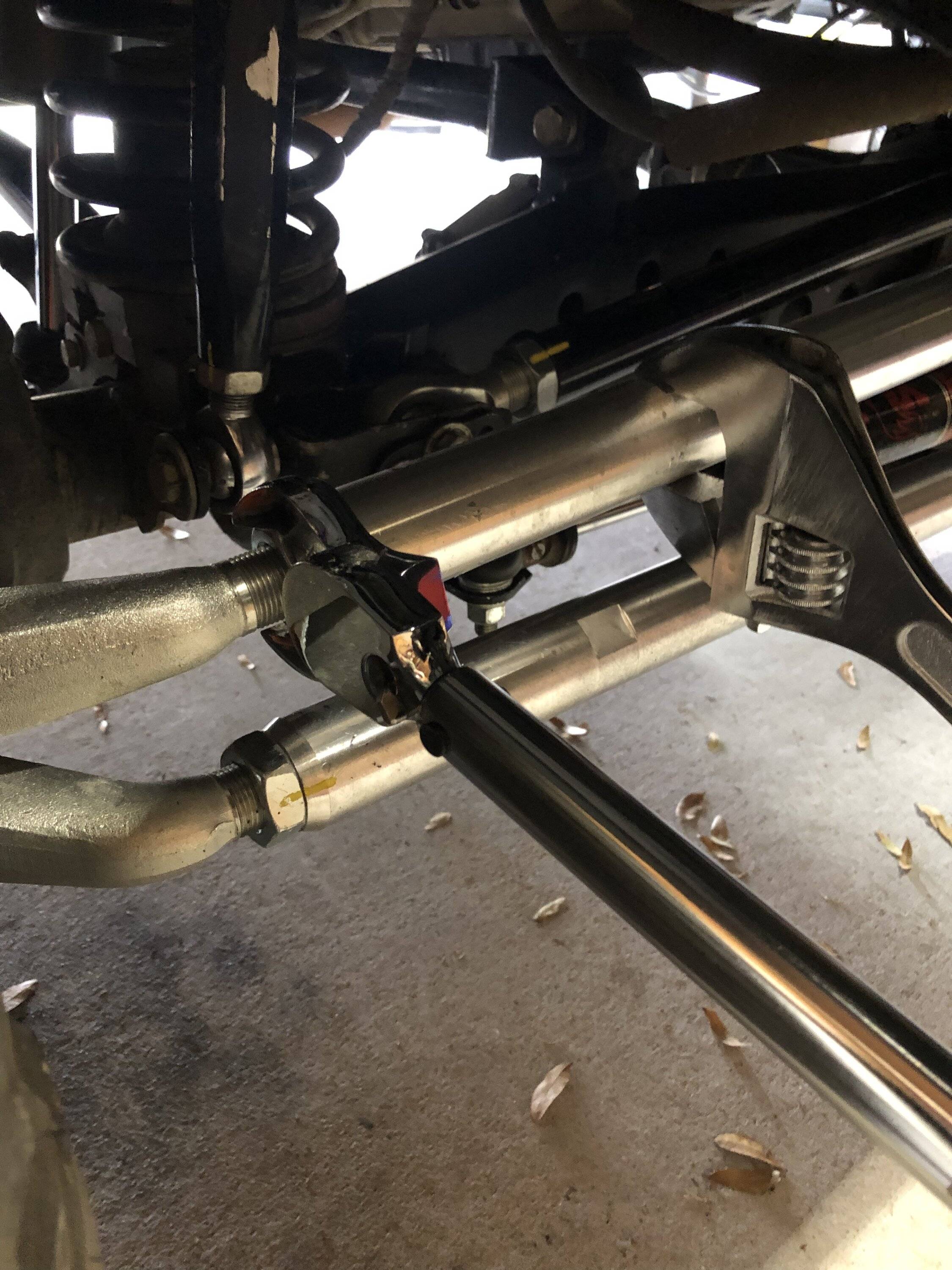

Man, I miss adjusting steering wheel with the 15 mm……?…now it’s a 1-1/2” crow foot, torque wrench, and an 18” crescent wrench… torque to 200 ft lbs …….:facepalm:

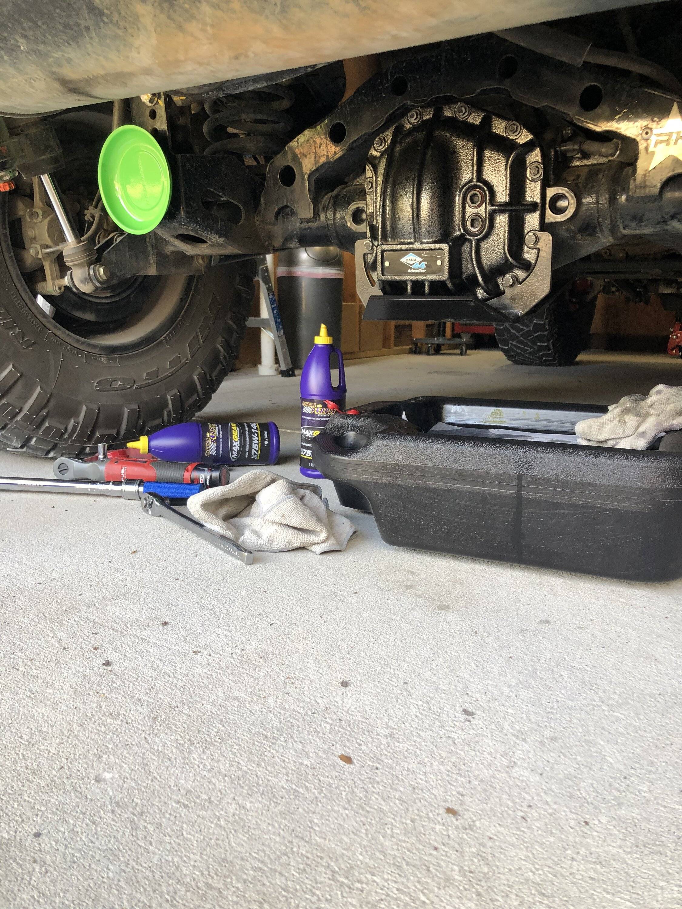

Finally got through the break-in, changed the gear oil today , everything is good….
Love the magnet saucer ??
Yeah, if I don’t do that, the bolts always end up under the creeper wheels, and it stops you in your tracks……:headbang:
Or putting a nice dent in your shoulder not using a creeper ?
