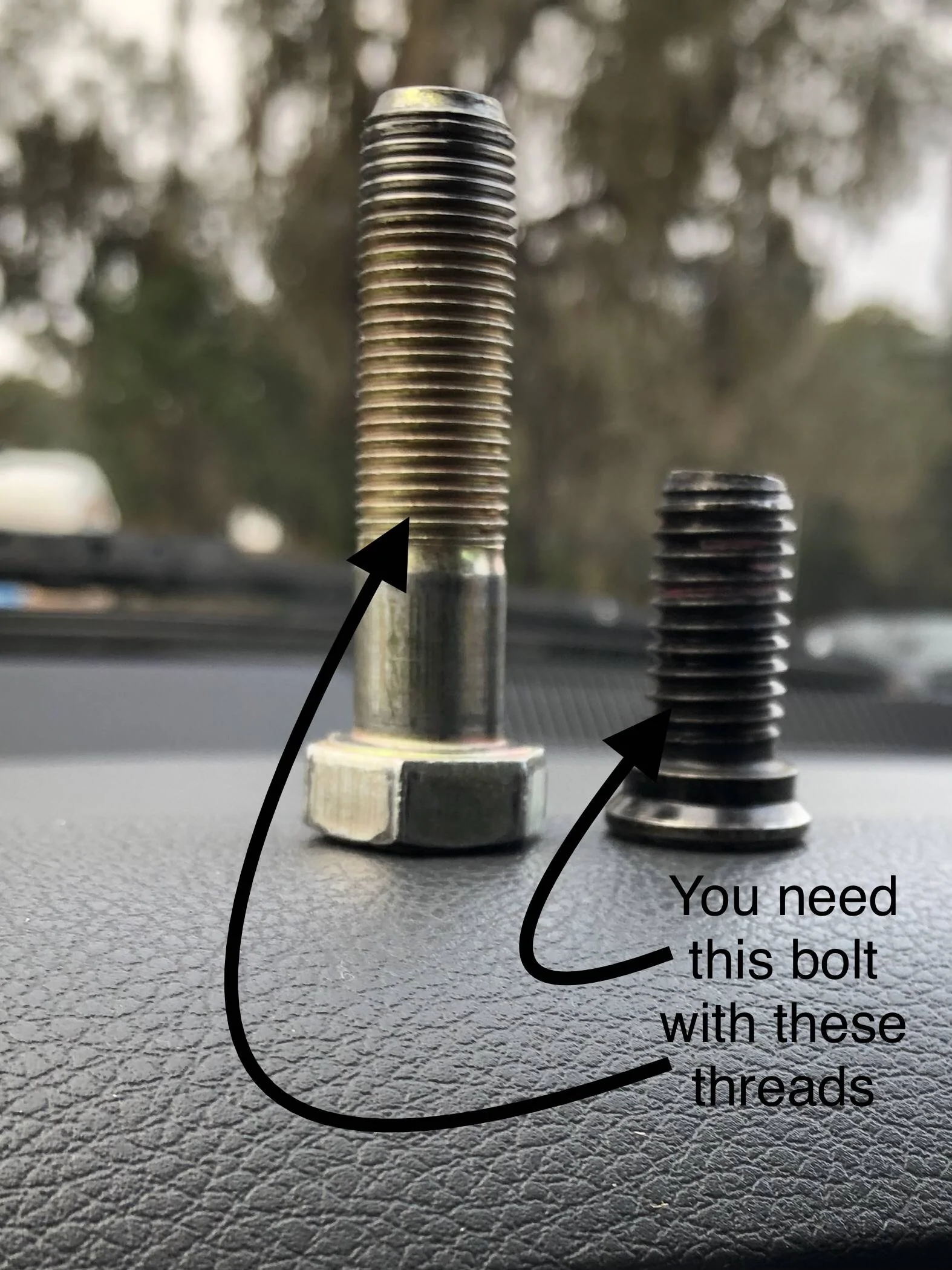

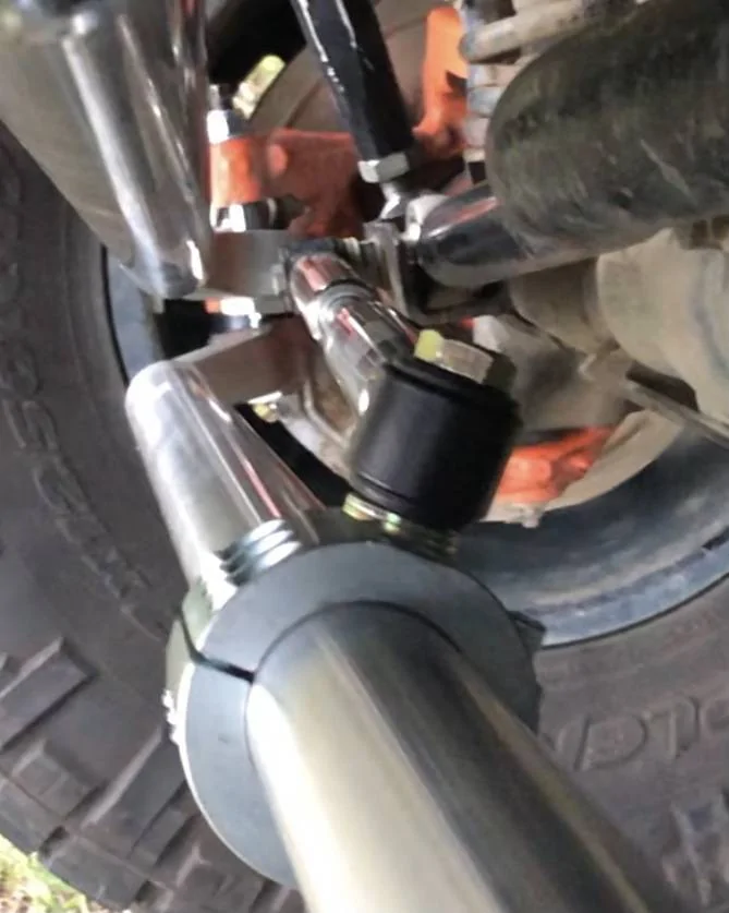

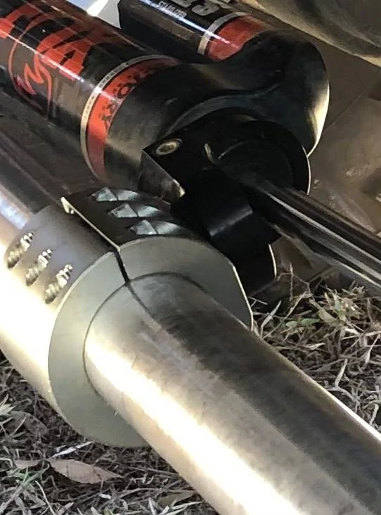

I appreciate your feedback bro, here's hoping RK listens to you and makes the bracket sooner! Last question (for now) does your ATS bolt on the clamp work for the EC?
Sure, no worries, anytime…….I had to get a synergy tie rod clamp because the bars are 1.75” and the Fox clamp doesn’t fit…. So I had to get a flat head bolt with the same threads as the synergy bolt, and the same length as the Fox bolt to use the Fox ATS on the synergy clamp….No biggie……
Jeep Wrangler JL Crystal Rubi build… AF69212F-AF31-439F-B711-791850A9E320
The EC just uses the bolt that comes with the synergy clamp……
