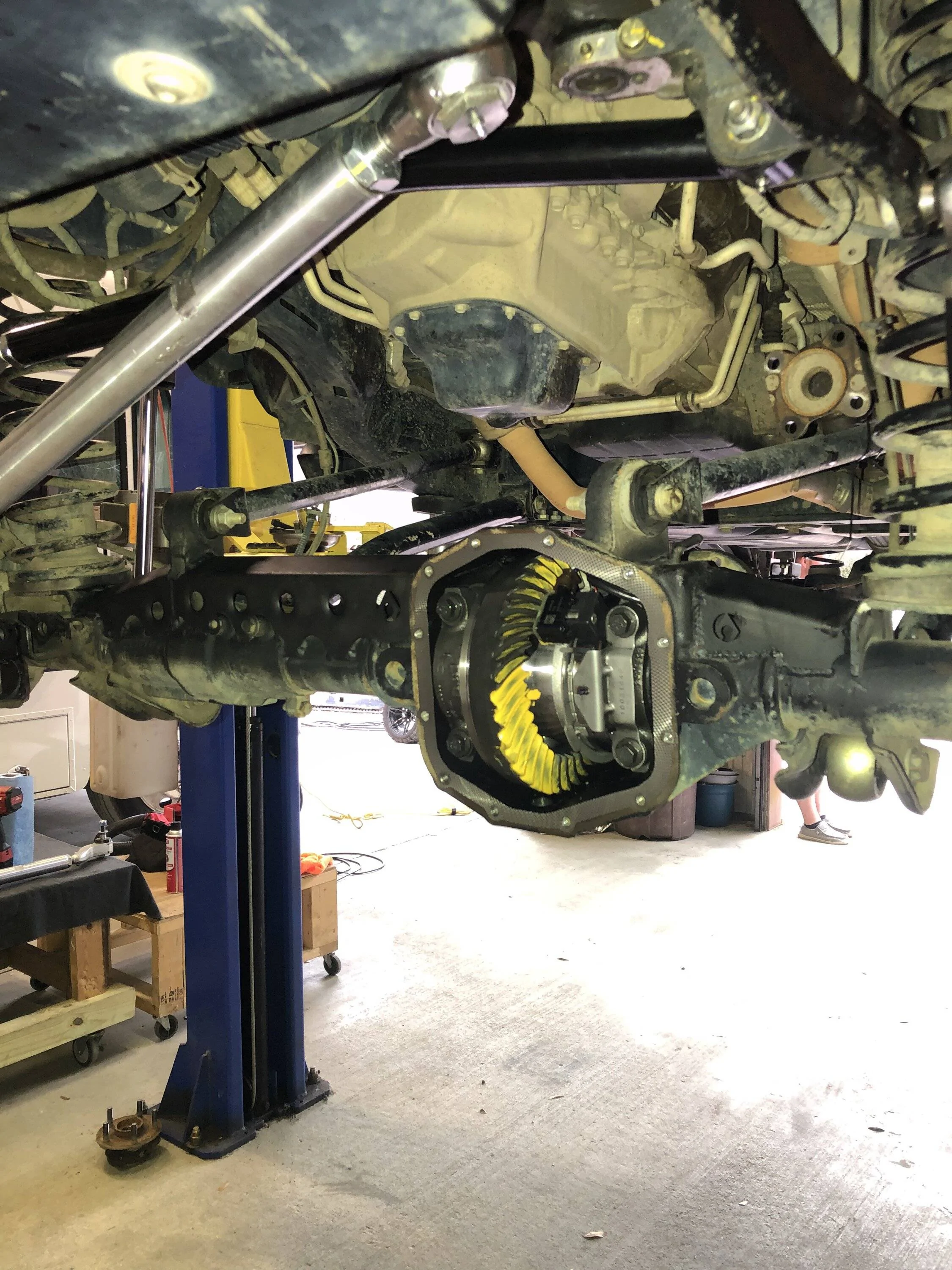

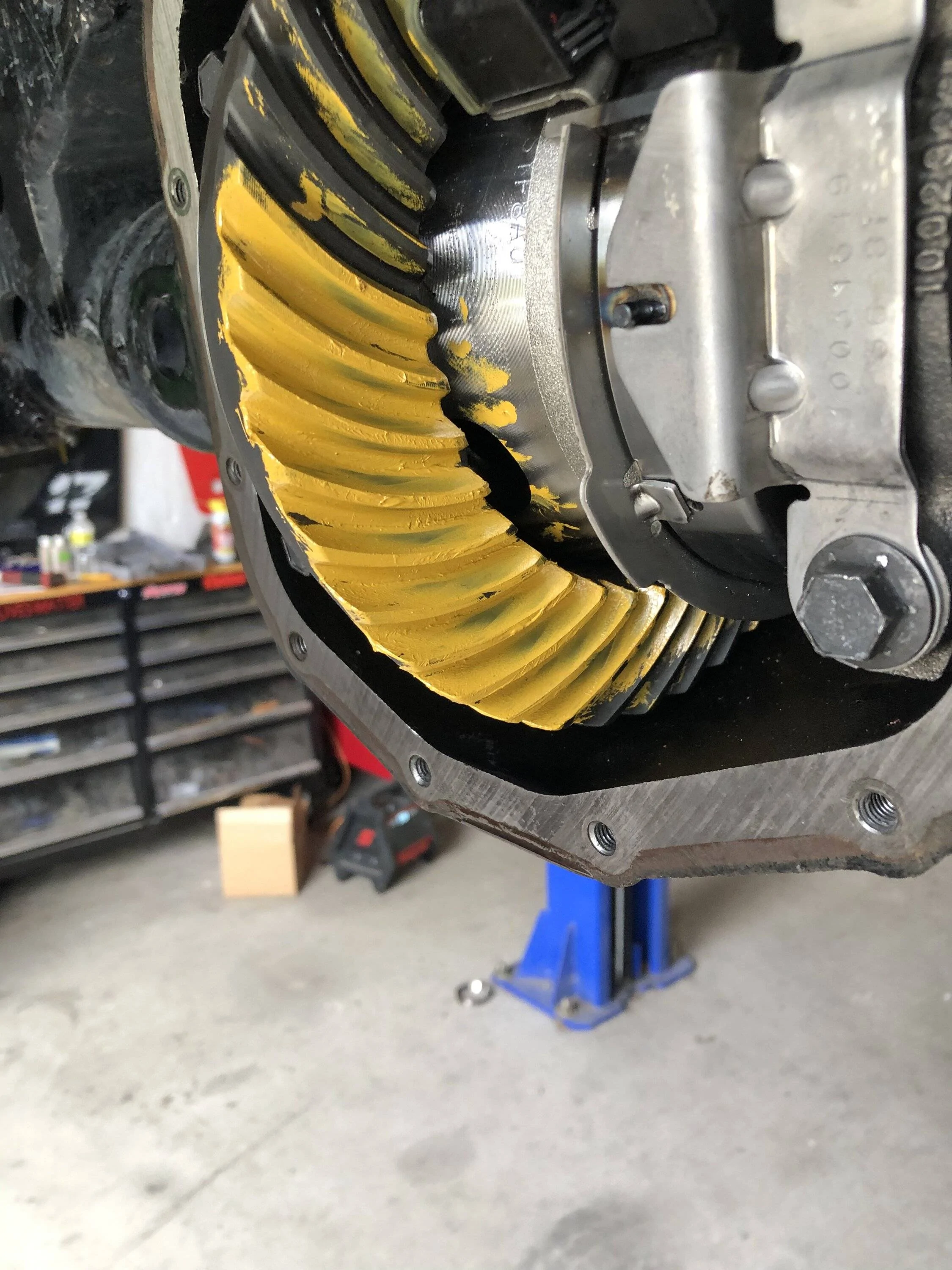

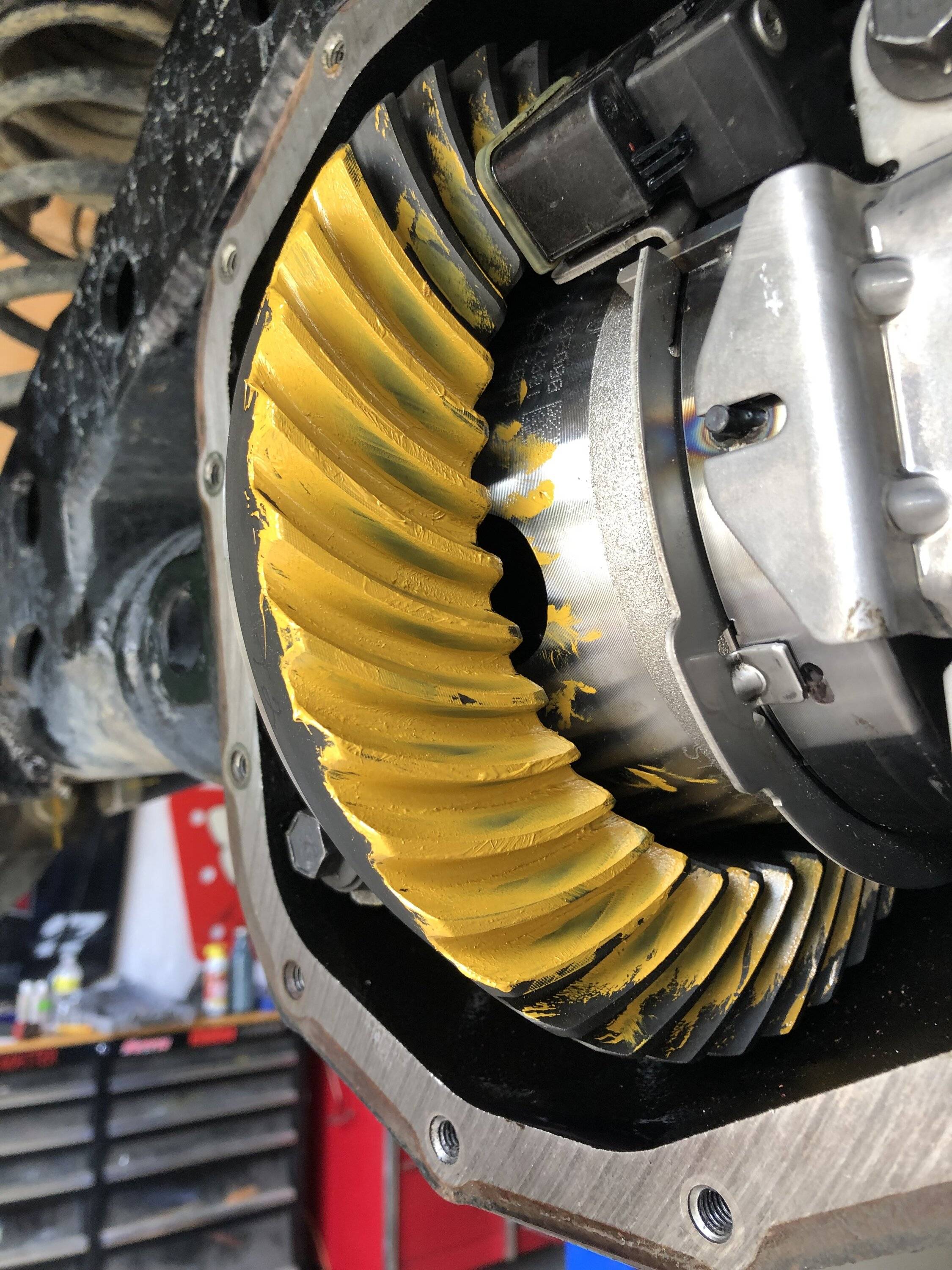

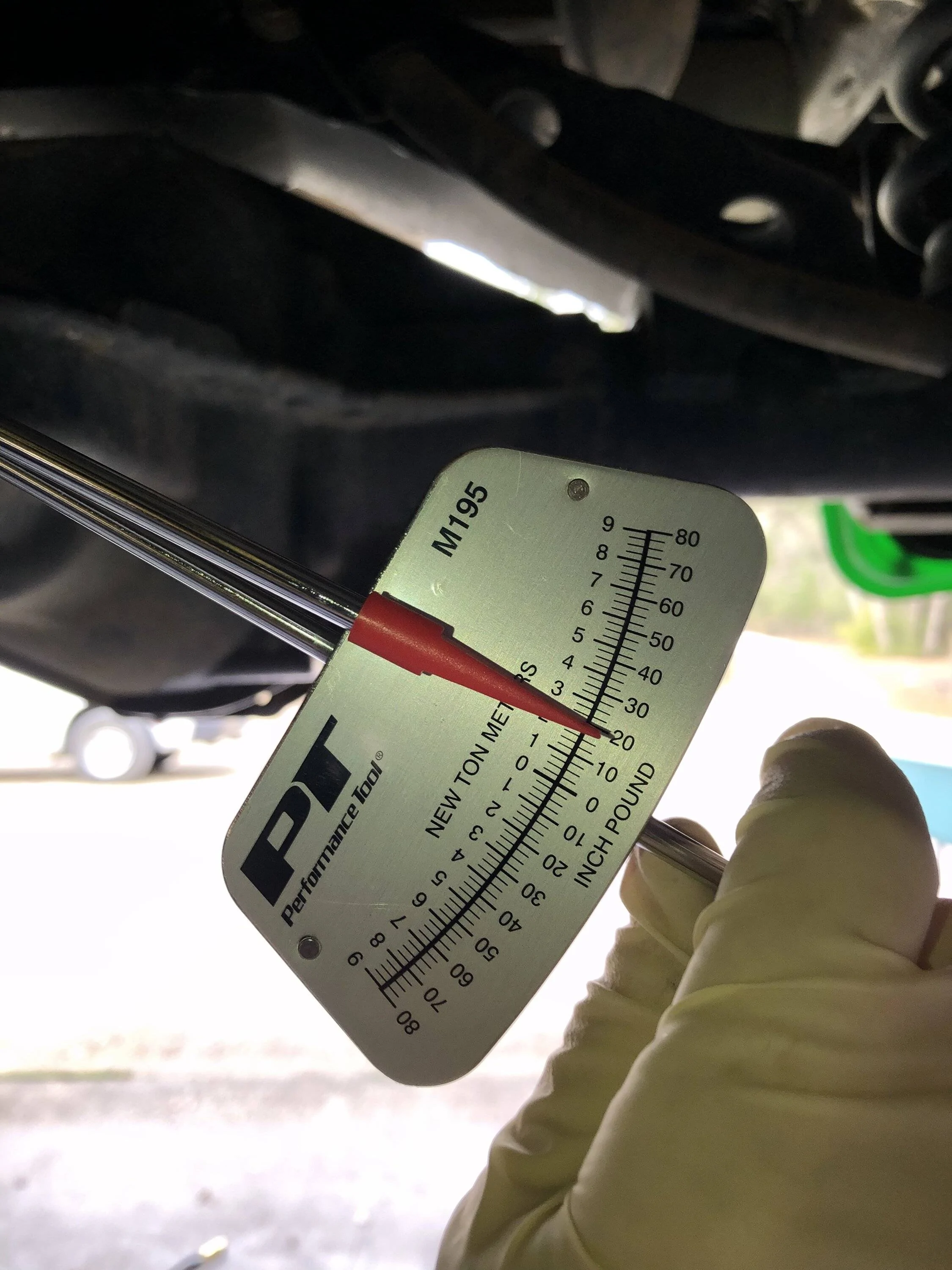

Got the rear gears done, working great, turns out , I “do” have an 8 speed transmission…? …….gonna do front next Saturday …wanna give a shout out to Shawn (@chevymitchell ) for answering a few questions, he was a big help…..thanks brother…..
Here’s some gear porn ……pattern, backlash and torque to rotate, for you wrench monkeys, you know who you are…?‍?

Nice job! Is this your first DIY setting up gears? That's one job I'm still paranoid about although Shawn does take out some of the anxiety.

Thanks brother….Not my first time working on axles, but first time changing gear ratio……

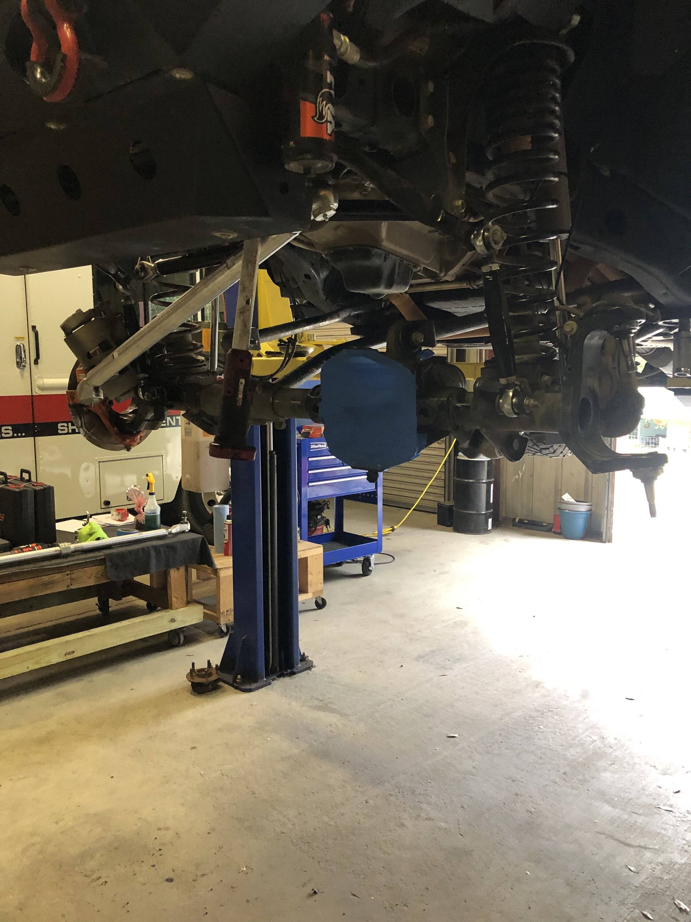

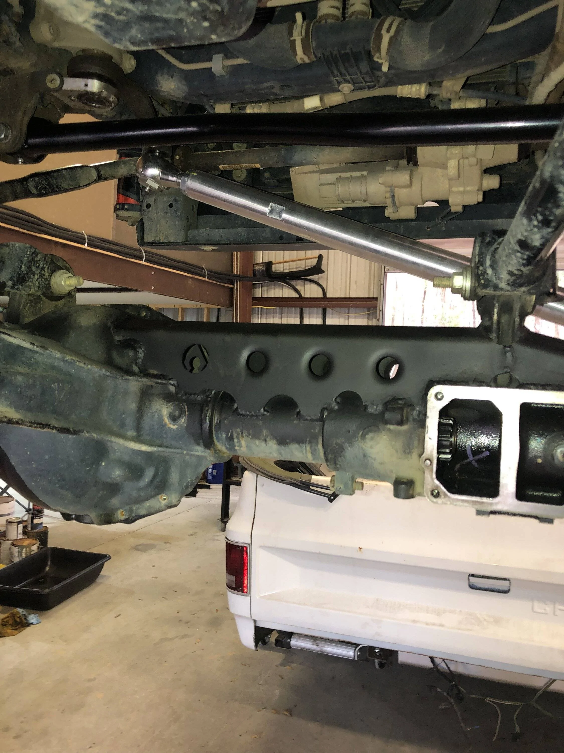

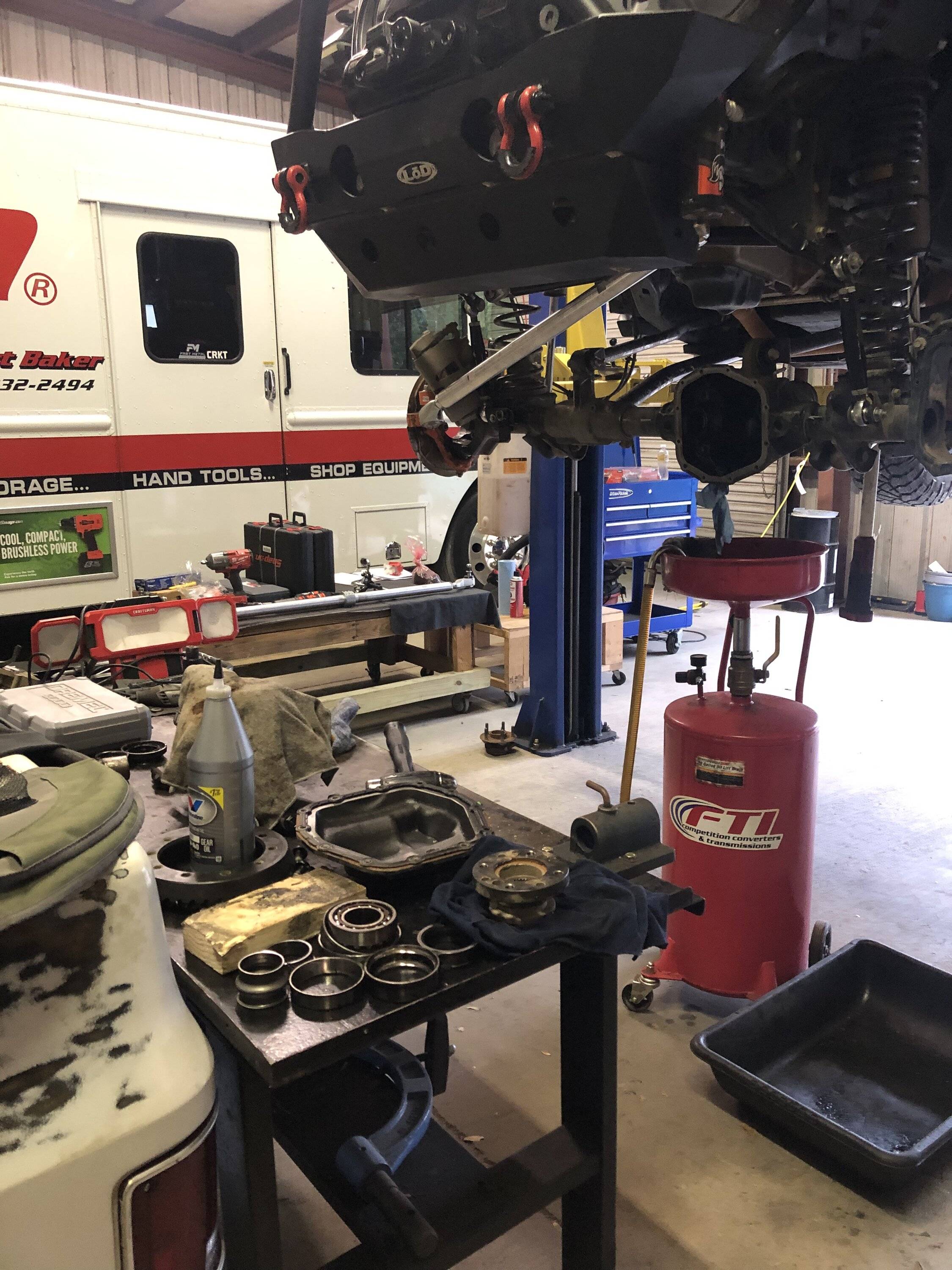

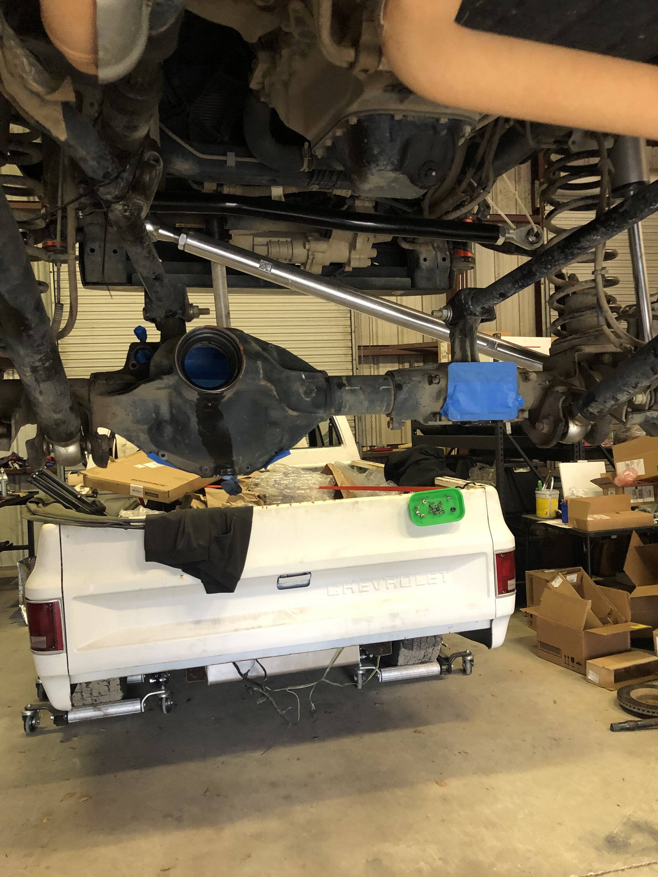

Got my Artec axle trusses on today, along with the front gears….Will finish up tomorrow. When I bought my gears Marcus had Dana gears but only one Dana master install kit, it was for the rear, so I used a Yukon master kit for the front…. Absolutely no issues, actually Yukon supply’s a tube of RTV. So if you’re doing Dana gears and can’t get the master kit, don’t hesitate to use Yukon… I’m not worried about the FAD anymore…..Piece of mind, like when you installed your winch..:)
