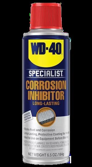

I had the same problem caused by road salt here in New England. Not quite as bad a case but similar. I used some soft wire brushes to clean it up, also soaked the winch line in soapy water and rinsed/dried (there was some powder residue in the line at spots)
Then I used this product heavily on the drum:
Jeep Wrangler JL Corrosion fix - Warn Zeon winch? 1748903488427-xi
I do this every spring and things have been fine for over 2 years now, no new corrosion.
This synthetic line is amazingly resistant to chemicals, see:
https://assets.ctfassets.net/q6qgec...85b10e6d15a/CIS_YA101_Chemical_Resistance.pdf
It laughs at 100% acetone, this anti-corrosion spray is not an issue
