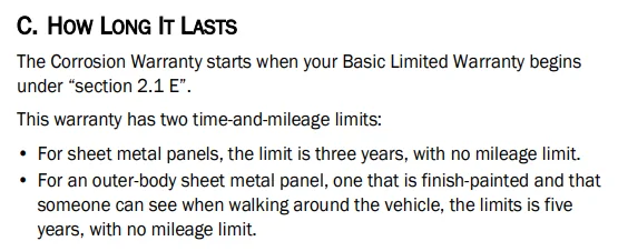

It might be for current year vehicles and not transferable to the past, but in the same argument, they shouldn't change your qualification for the 5 year warranty set in 2022 for the future.

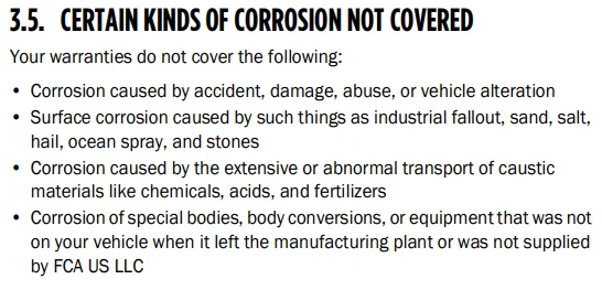

The 2022 warranty (below) describes it as "finish painted and that someone can see when walking around the vehicle" covered for 5 years. The warranty does refer to "sheet metal" so maybe that is where the hinge falls into gray territory. If the corrosion is from a rock chipping the hinge paint and then the metal underneath rusting, that is on you (Section 3.5 below) but if it is obvious that the rust is coming from under the paint with no external influence, I would say that is on them.
Section 2.2
Jeep Wrangler JL JLU Hinge Corrosion Warranty 1779229622187-1q
Section 3.5
Jeep Wrangler JL JLU Hinge Corrosion Warranty 1779229785431-1

Super helpful! It's not from a rock chip.
Where did you pull this doc from? I'm wondering if I should push to have the dealer try to submit for the door hinges and worst Mopar can say is no.

If you register here with your VIN# you can access your vehicle specific warranty information.
https://www.mopar.com/en-us/my-vehicle/vehicle-information.html
Otherwise, here is a link to a PDF version of a 2022 4xe Wrangler. Not your specific trim level but the corrosion information in 2.2 and 3.5 should be applicable to your 2022 Wrangler. https://vehicleinfo.mopar.com/asset...gler_4xe/P140244_22_JL_H_GW_EN_US_DIGITAL.pdf
If they continue to push back on the hinges, I would see if they can compromise and if you buy replacement hinges, they paint them for free when they are painting the other repair items. If you do that, I would get the aftermarket aluminum ones.
