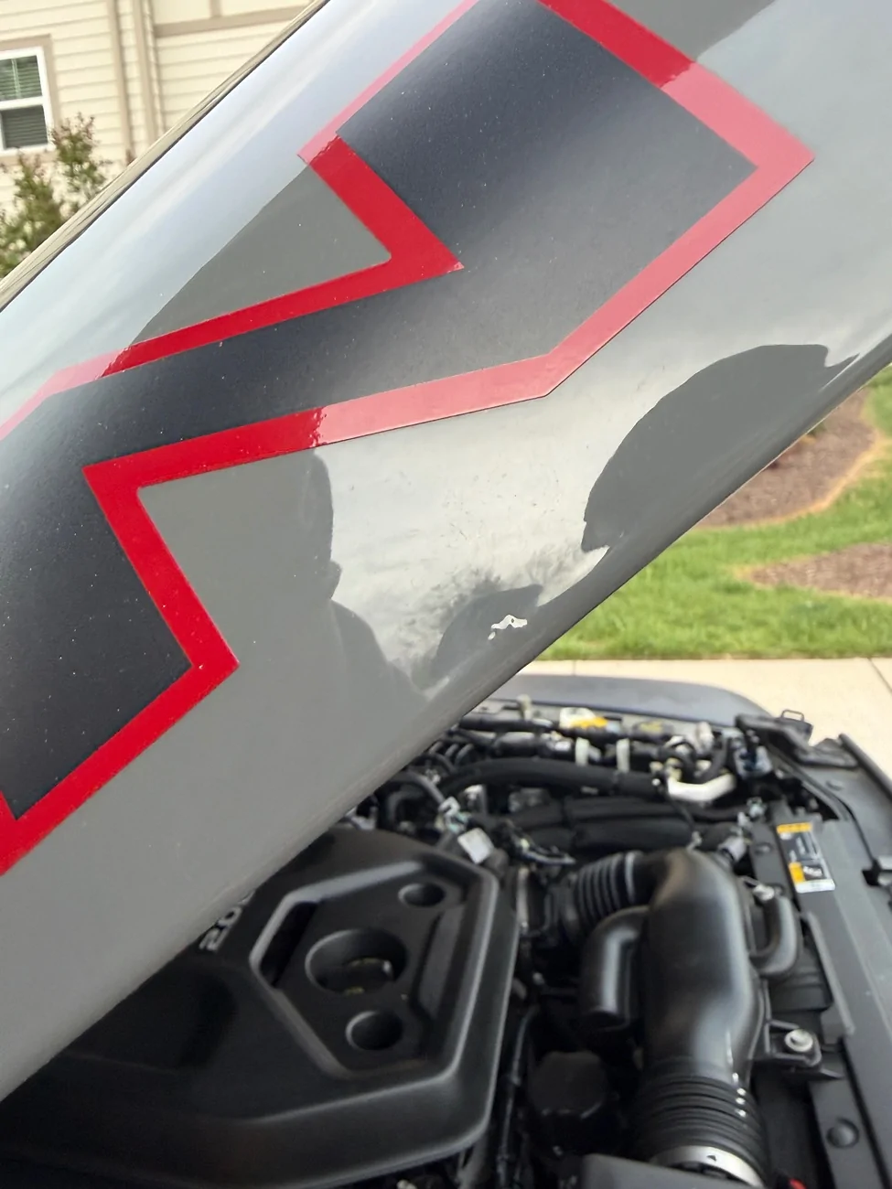

So I take it this is basically guaranteed to happen? 52k on my 21. Only spot I could find is on the hood in the pic below and it’s small. Hinges and doors all look fine, for now.
