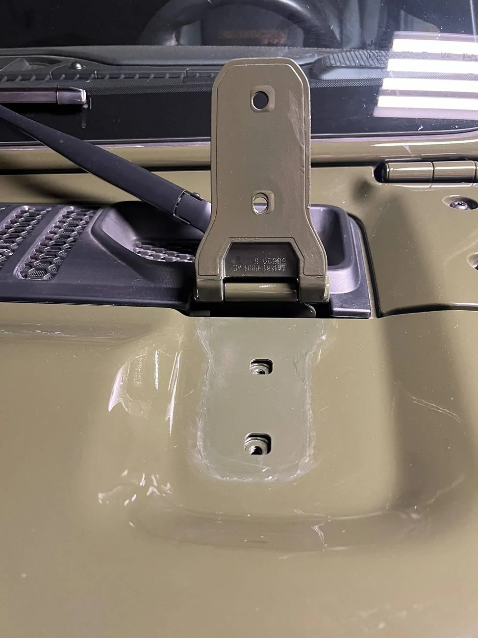

I have a 2023 Willy’s 4XE and don’t see any shims in between the hinges and door skins. What I do see is light grey factory primer in the gaps behind the pins.

It’s a tiny 1-2mm gap around where the outer door hinges make contact with the doors. The hinges were attached to the doors before painting these things on the assembly line causing missing paint.

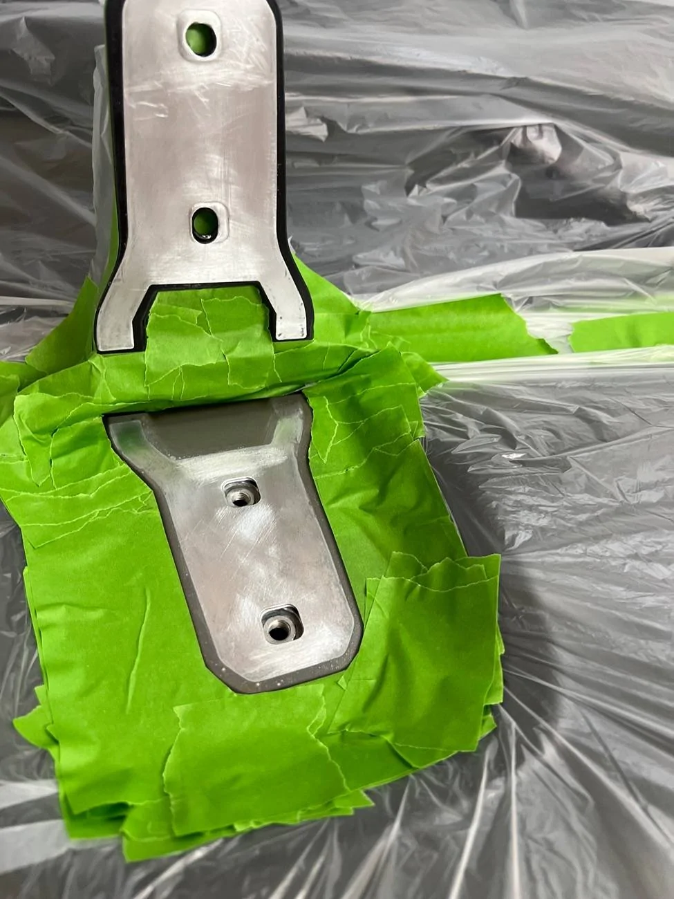

Yes I know this. I thought you had taken your hinge off and describing what was between the hinges and door panels instead of just looking at it from the outside. I’m going to take my hinges off and paint the bare metal underneath.

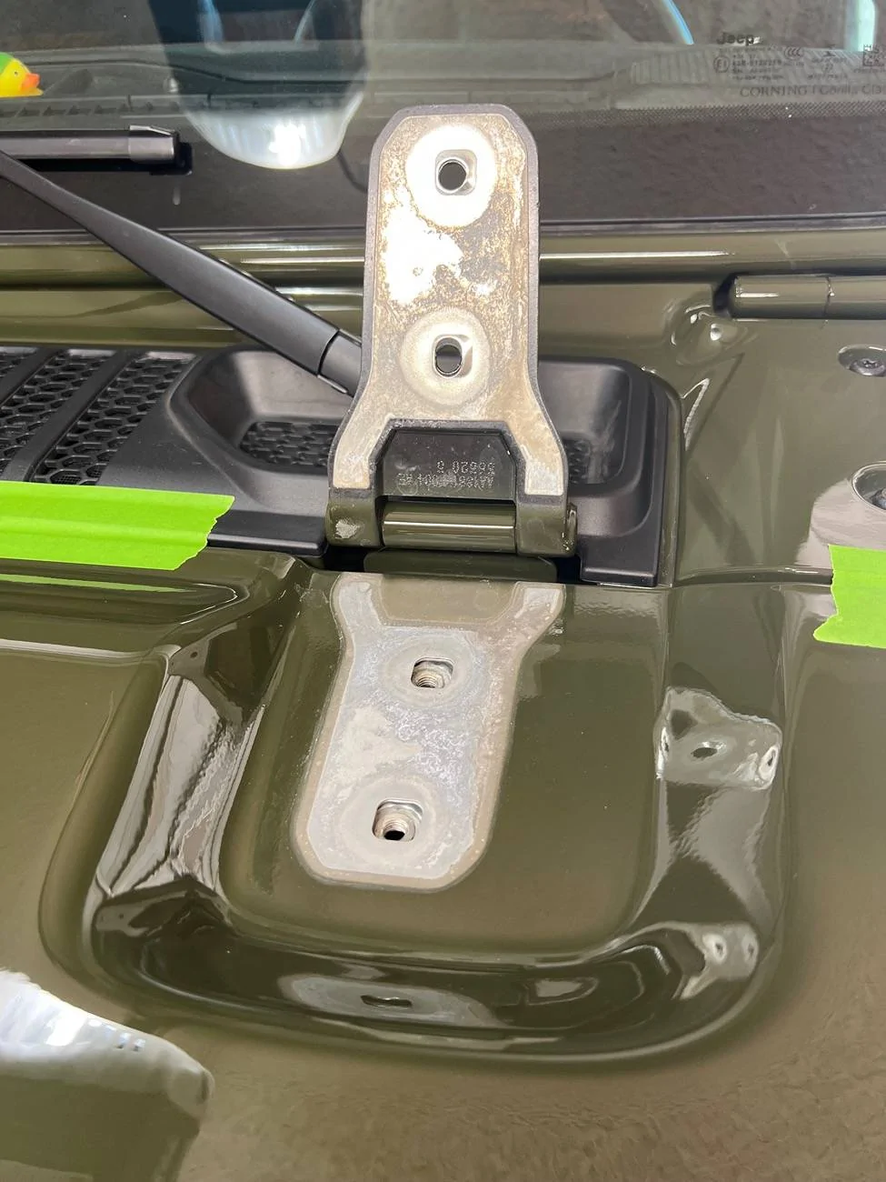

So that first photo shows no sign of primer nor paint?
Yes bare aluminum (the hinge) on bare steel (the 392 hood). Water gets under there easily since the spray paint doesn’t form any type of moisture barrier. That is why you can see so much corrosion. Perfect recipe for a problem in the future.
most jeeps have aluminum hoods so the corrosion would occur between the steel backing plate and the hood itself. In my case the aluminum hinge was corroding.

I performed the same process with my door hinges. On the 2022 the door hinges had a black paint on the inside and the doors bare aluminum. I painted everything and applied a small amount of black RTV ultra around the bolt holes on the door to create a moisture barrier to prevent water from getting inside the door panel. Hopefully this will solve the future corrosion problem.

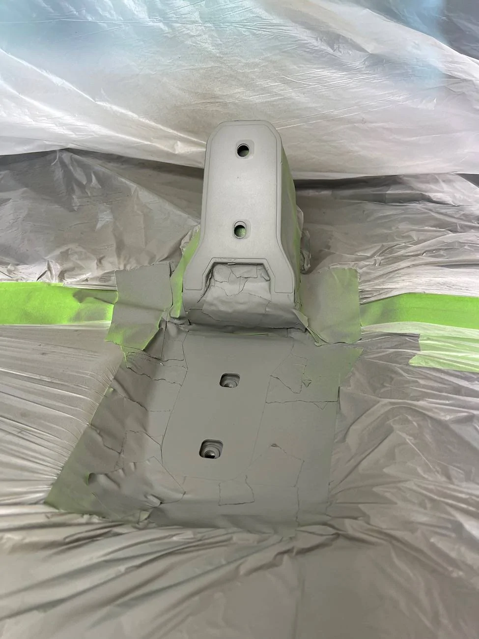

I used self etching primer and a color matched topcoat no issues with adhesion and you can’t tell I did anything.
