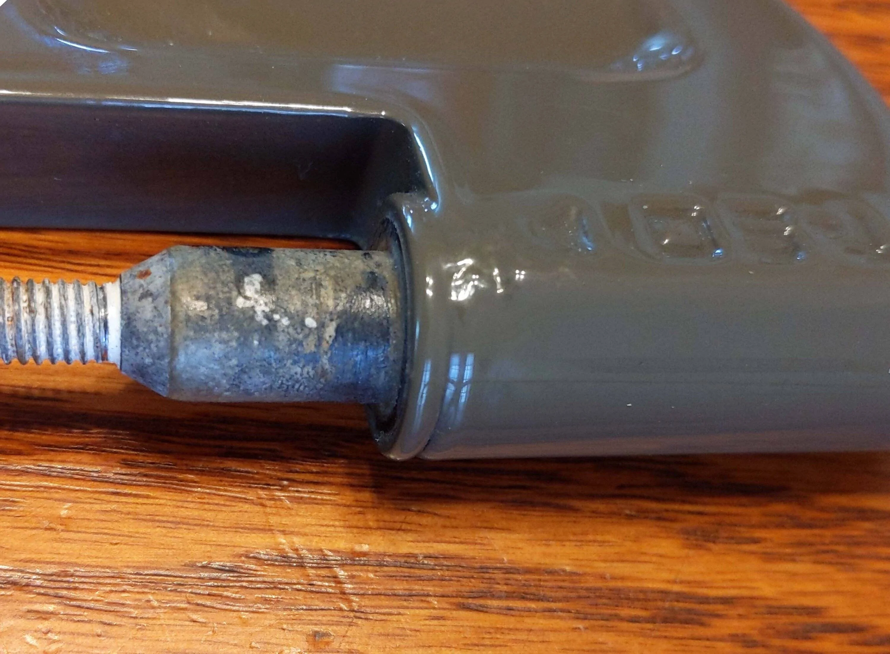

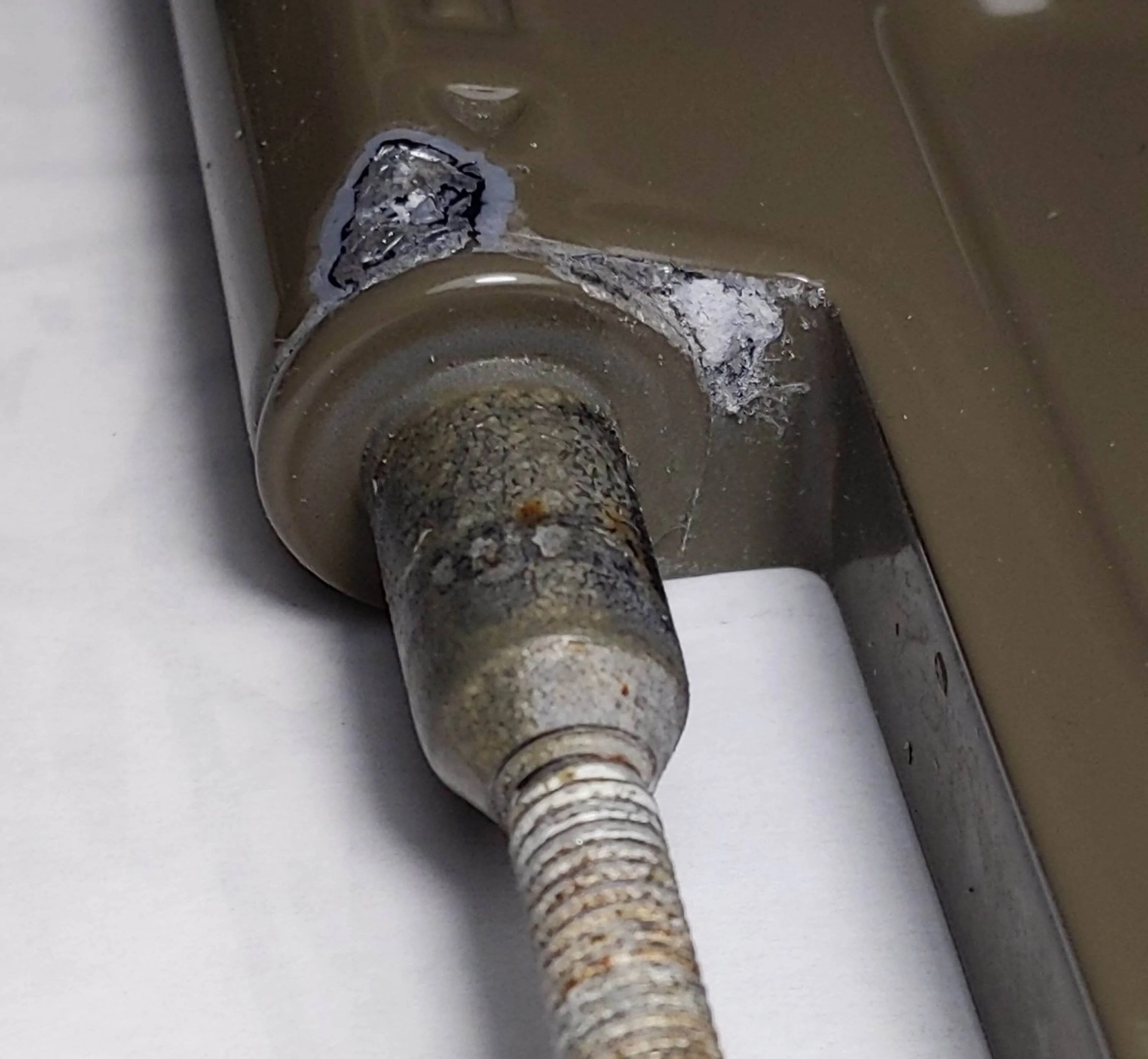

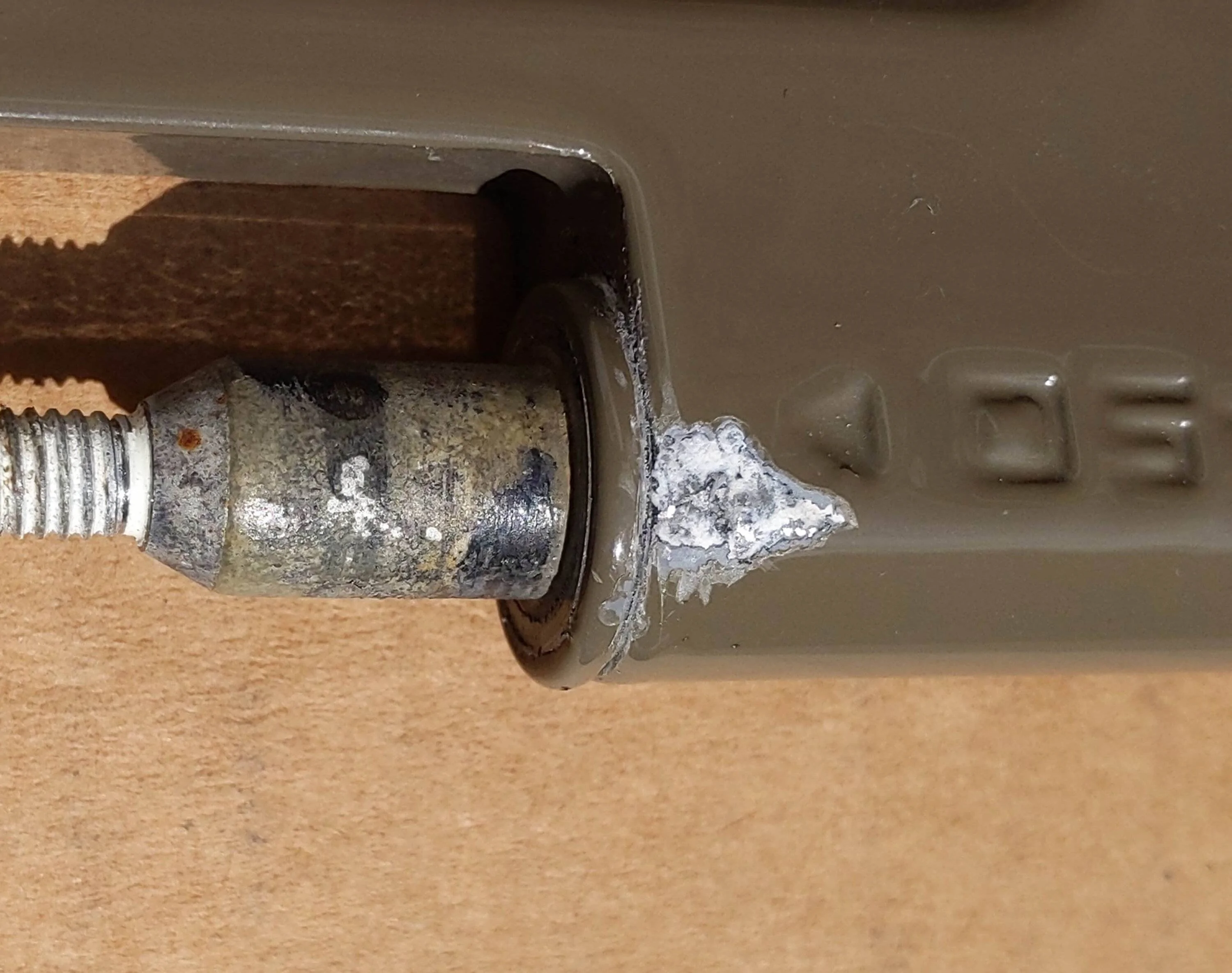

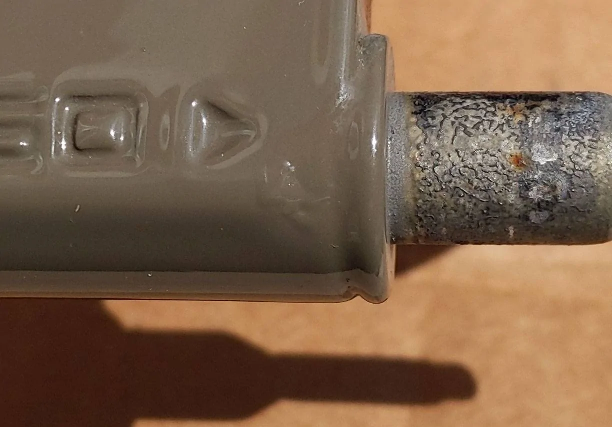

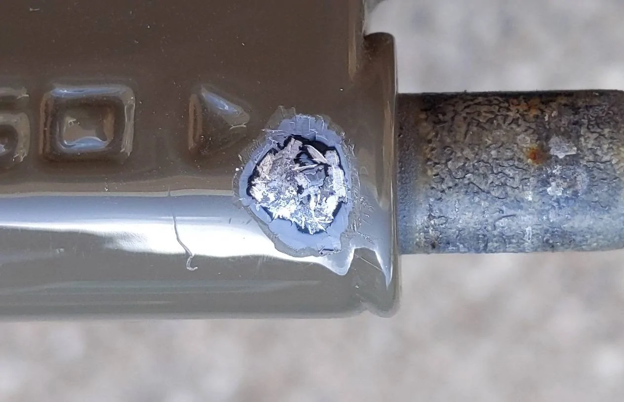

I finally got around to cutting into the blistered paint on the two corroded hinges I'm working with. The paint is tougher than I expected, hard to cut even with a new blade.
I was hoping to find more definitive evidence that the corrosion is originating from the seam between the steel pin flange and the aluminum hinge body, but the evidence wasn't as conclusive as I hoped. The next step is to treat the corrosion and repaint.
Here are some before and after pics to illustrate how much more corrosion there is under the surface than is apparent on the surface.
Jeep Wrangler JL Thoughts on Aluminum Panel (Galvanic?) Corrosion Mitigation hinge 1 pr
Jeep Wrangler JL Thoughts on Aluminum Panel (Galvanic?) Corrosion Mitigation hinge 1 scra
Jeep Wrangler JL Thoughts on Aluminum Panel (Galvanic?) Corrosion Mitigation hinge 2 pr
Jeep Wrangler JL Thoughts on Aluminum Panel (Galvanic?) Corrosion Mitigation hinge 2 scra
Jeep Wrangler JL Thoughts on Aluminum Panel (Galvanic?) Corrosion Mitigation hinge 2 scrape 2
I'm torn between going this route and risking voiding the corrosion warranty and just letting it go and getting it repaired under the warranty in a few years

Second, I have seem many pictures of the paint bubbles, and there seems to be three places where they occur.
1. On the hinge by the steel pin.
2. Where the Door/hinge meet usually on the door but sometimes on the hinge
3. Near the lower most part of the doors and hood.
It seems to be part galvanic corrosion and part poor prep/paint, my best guess.
With regards to the paint bubbles on the hinge by the steel pin, the contact point of different metals is where the pin flange touches the hinge. There does not seem to be any solution to "separate" this contact with a spacer, be it plastic or sacrificial zinc.
The use of the Delrin hinge liner/bushing Kentrol part #70012, separates the hinge steel pin from the part of the hinge that attaches to the frame. What metal is that part of the hinge? I am not seeing corrosion on that part of the hinge on many photos uploaded on this forum. I am guessing that part is made of steel. This plastic hinge liner/bushing, therefore, may not be doing anything as it is separating steel from steel? Also use of zinc plated washer at the bottom of the hinge may be doing the same, separating steel from steel? the only solution to inhibit/delay corrosion in this location may be use of corrosion inhibitors such as Boshield or Ultra Tef-gel on the pin? and also perhaps breaking the paint in the "gap" between the flange and the hinge to let the moisture "out"?
With regards to the steel torx bolt used to affix the hinge to the door, someone suggested usage of a plastic washer under the bolt head to separate from the hinge to reduce galvanic corrosion. And usage of ample Boshield or Tef-Gel on the rest of the bolt as well as the steel nut and nut retainer may also be helpful?
Someone from Germany (I think) said he sprays WD-40 on and around the hinges once a month in attempt to keep moisture away, with success till this point. What is your thought on this?

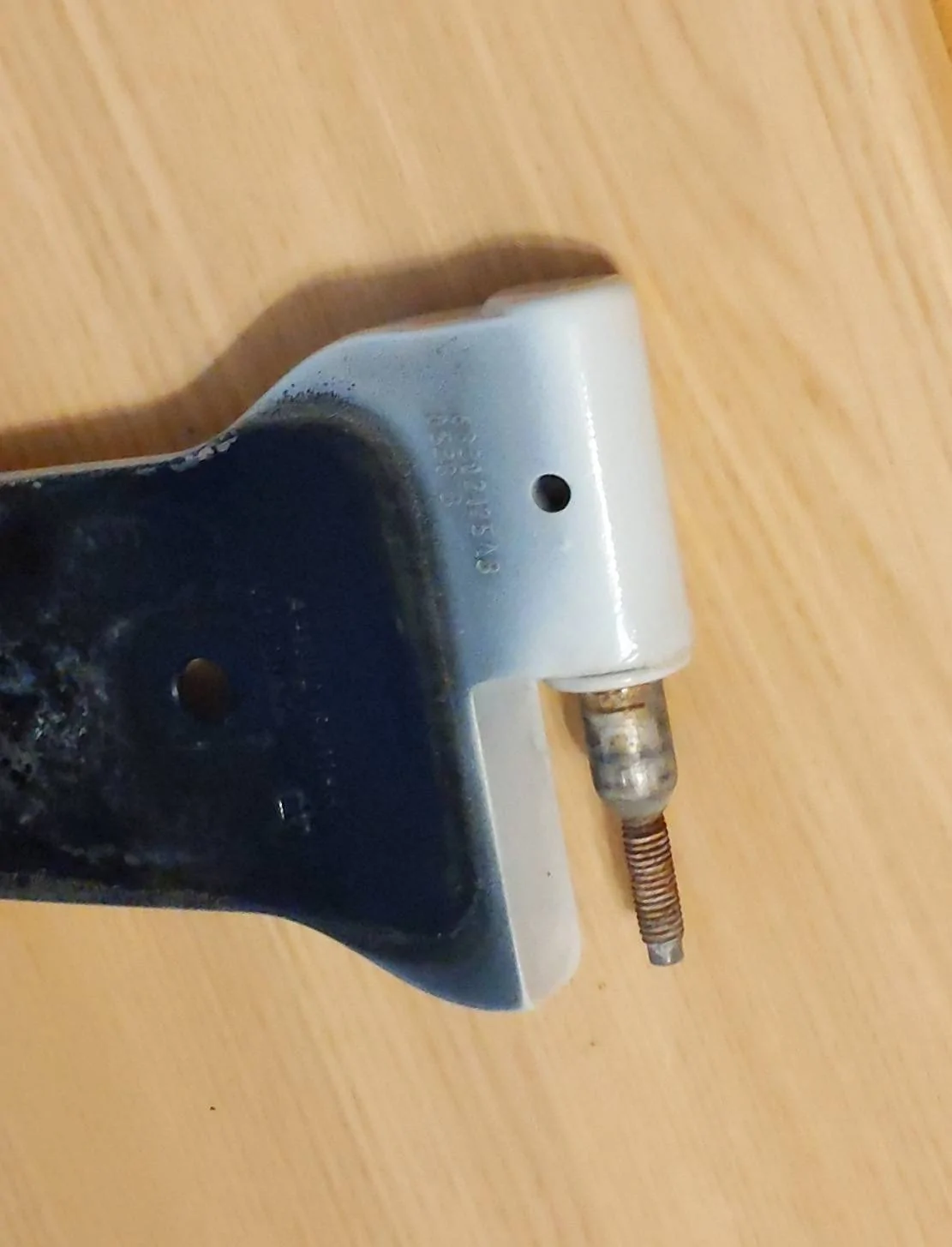

I just got my 5 replaced JL hinges back from the dealer and confirmed that all of them are corroded starting from the pin flange. This is likely due to water seeping into and getting trapped in the gap between the pin flange and the hinge.
Jeep Wrangler JL Thoughts on Aluminum Panel (Galvanic?) Corrosion Mitigation door hinge c
I picked up some needle tipped bottles https://www.amazon.com/dp/B07NKSLFSR?psc=1&ref=ppx_yo2ov_dt_b_product_details to facilitate applying some Boeshield into the gap to prevent water from getting into the gap. I tried removing the paint over the gap to open it up, but that did not go well and I do not believe it is practical.
As to the Delrin hinge liners, at the very least they eliminate the metal pin liners which have become a source of corrosion over time on previous Wranglers. They also electrically isolate the steel hinge pins from the rest of the body, minimizing any galvanic electrical pressure that might result from the accumulated steel exposure. And for those interested, the part of the hinge attached to the frame appears to be aluminum (non magnetic).

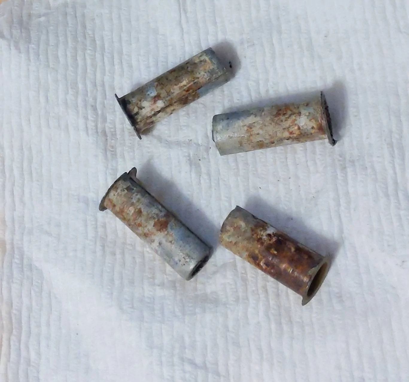

Here's a pic of corroded hinge pin liners from a 2013 JK.
Jeep Wrangler JL Thoughts on Aluminum Panel (Galvanic?) Corrosion Mitigation hinge pin liners
For the zinc plated washers, I now see that they will not act as a sacrificial anode to prevent the aluminum hinge from corroding. They might relieve the galvanic interaction between the steel pin and aluminum hinge by providing a more susceptible galvanic target, but I haven't seen any discussion addressing this theory.
The door hinge Torx bolts have a tapered head, so I'm not sure how well a plastic washer will work. My plan is to use dielectric grease under the bolt heads.
For treating/sealing the hinge gaps that can trap water and promote the surface corrosion that occurs starting from around the hinges, my plan is to seal them with Turtle Wax Pro Flex Wax. I started waxing with it last year and it lasts for months. I'll put enough on the hinges for it to flow into and seal the gaps before I wipe and buff it off. I'll reapply as needed.
I still pondering what would be a good solution for the door and hood edges.
