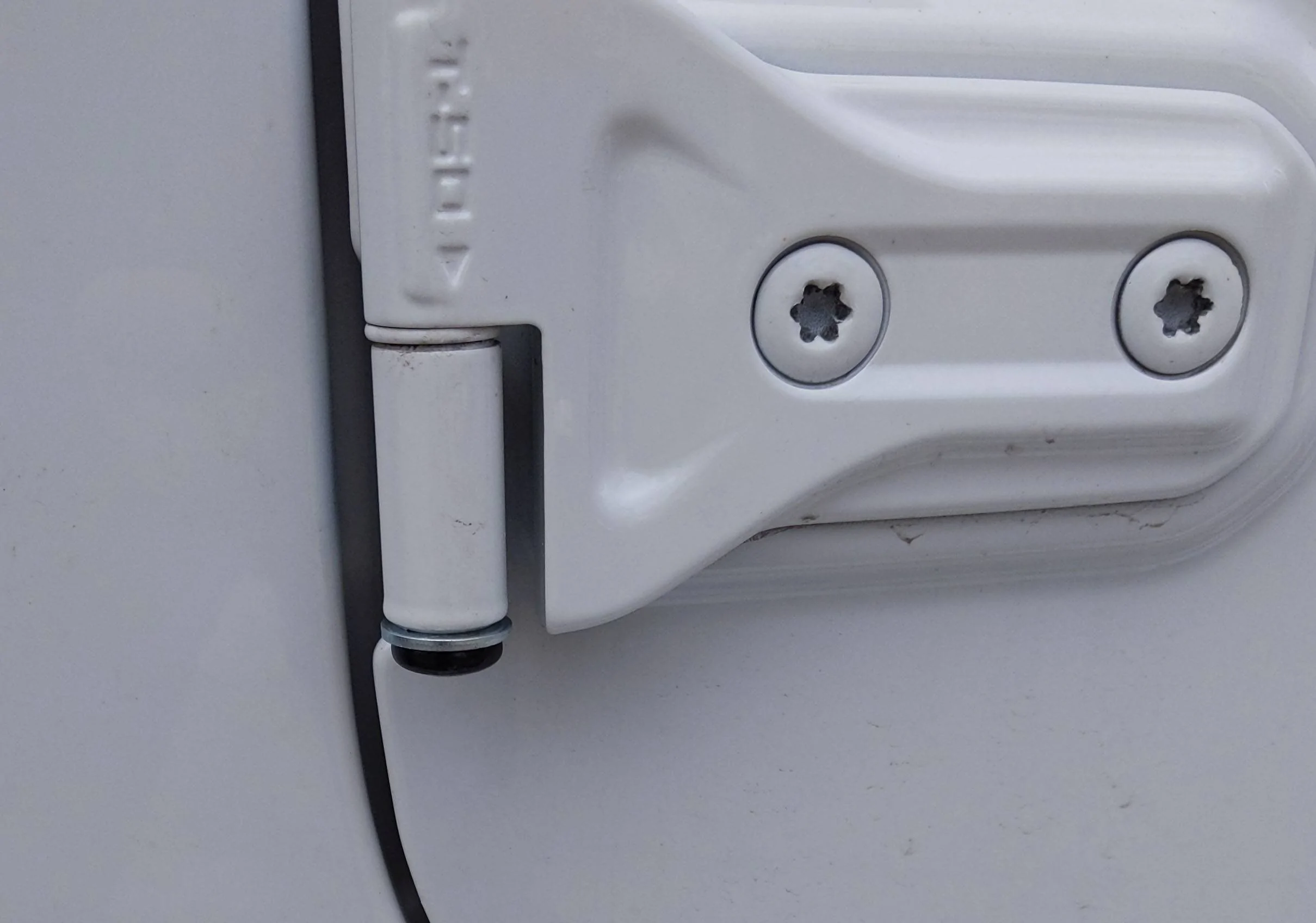

The zinc shim currently being used by FCA as a sacrificial anode will be great when they are available, but as an alternative how about a zinc washer on the door hinge. Time (or opinions) will determine the effectiveness of this.

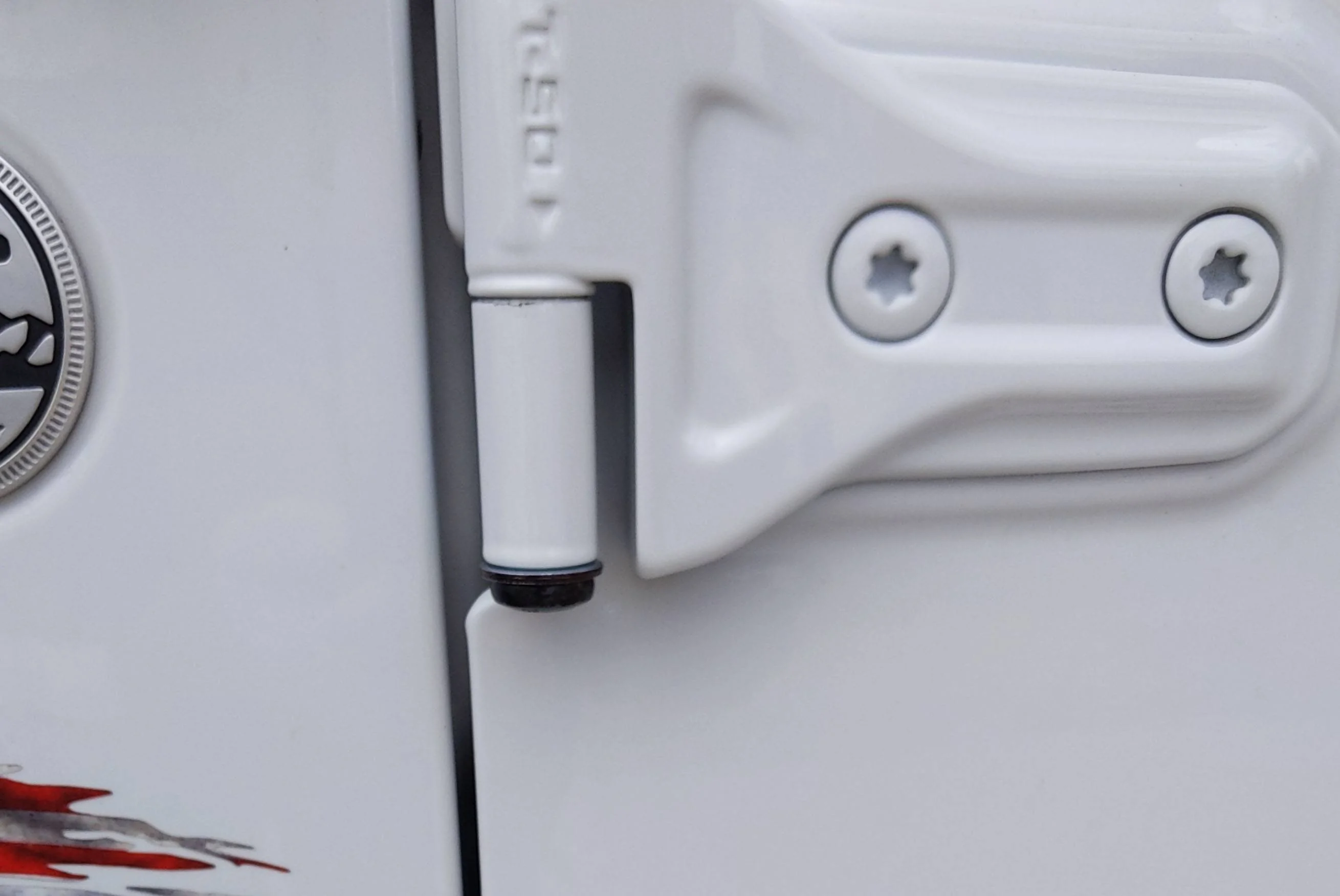

Here's what a m10 washer with a 20mm outside diameter looks like on the door nut.
Jeep Wrangler JL Thoughts on Aluminum Panel (Galvanic?) Corrosion Mitigation hinge washer
Here's one with black permanent marker around the edge so it doesn't show as much.
Jeep Wrangler JL Thoughts on Aluminum Panel (Galvanic?) Corrosion Mitigation hinge washer dark

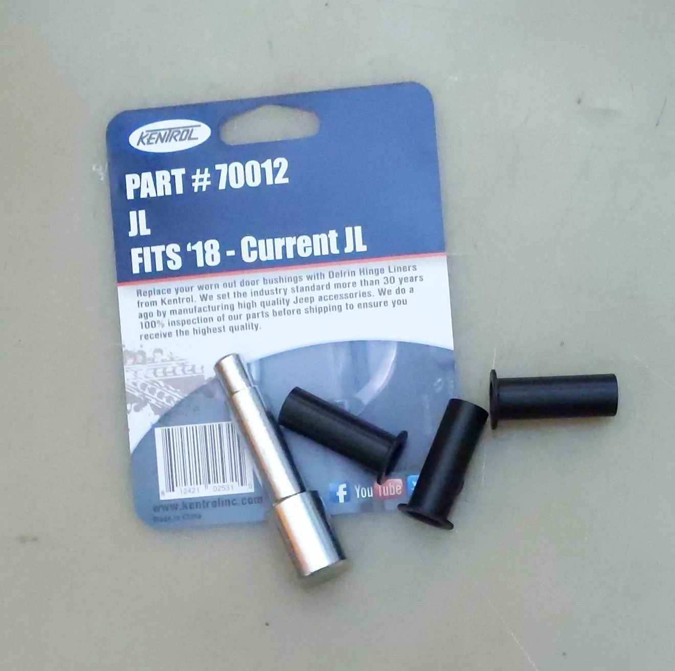

All of my door hinge corrosion has started at the pin, which I attribute to that being the connection to the dissimilar metal in the rest of the Jeep and also to damage done to the paint from opening and closing the door. My plan is use these Delrin hinge liners to replace the metal hinge liners to both electrically separate the hinge from the body and to also provide a more paint friendly surface for the hinge to pivot on.
Jeep Wrangler JL Thoughts on Aluminum Panel (Galvanic?) Corrosion Mitigation hinge liner
And since access to the atmosphere with the presence of moisture or water is also needed for galvanic corrosion, my thought here is to apply strips of paint protection film around the lower edges of the panels to help isolate these corrosion prone areas from moisture and the atmosphere. No pictures of this yet.

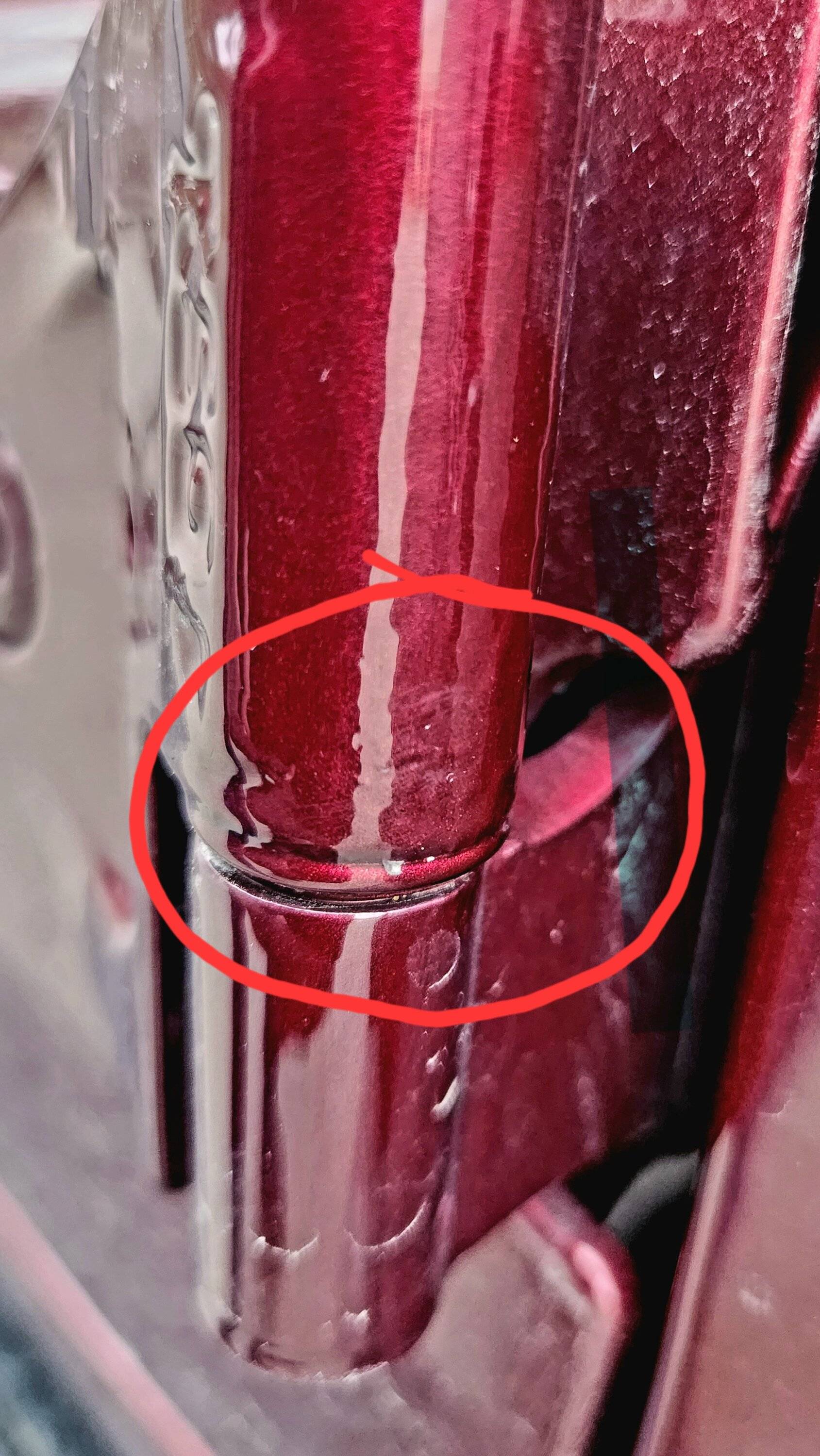

Sadly it appears one of my hinges is in the early stages of corrosion. Oct '21 build, 11.5k miles, garage kept, factory hinge bolts removed and replaced with silver bullet hinge pins early on. Doors have been off 3x and handled with kid gloves.
Disheartening....

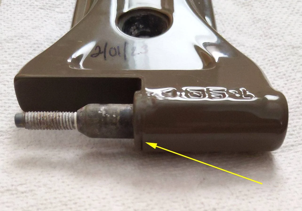

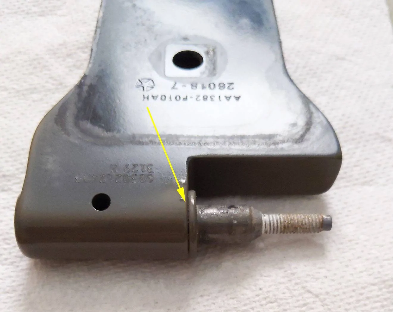

It looks like water gets trapped in the crack under the paint and eventually causes (facilitates) the corrosion. Here's some pics of one of my hinges that shows the corrosion where the paint covers the crack and no corrosion where the crack is open. The first arrow points to where the crack starts getting covered with paint, the second arrow shows no paint and no corrosion in the back.. Boeshield was recommended on the Gladiator thread to seal cracks from moisture.

The back of mine doesn't look as open as yours but I'll have to take the door off to get a better look. Maybe some Boeshield and then a coat of touch up paint on the seam will do the trick.

I would hesitate to apply more paint as it may exacerbate the problem. I've got some Boeshield on order as a preventative and am also going the see what TurtleWax Graphene Flex does on the flat surfaces to prevent the corrosion. And also see how to remove and repair the existing corrosion.
I just figured if the issue is the open seam on the back of the hinge, sealing it with paint like the front of the hinge would prevent moisture from getting in there on the future.

Paint doesn't make a good seam sealer and may trap water instead of blocking it. The bubbling of your paint has probably compromised the surface and may also allow water penetration.
My plan is to cut away the corroded paint and clear the seam, treat the underlying corrosion and repaint without painting over the seam. Then I'll use something to moisture seal the seam.
