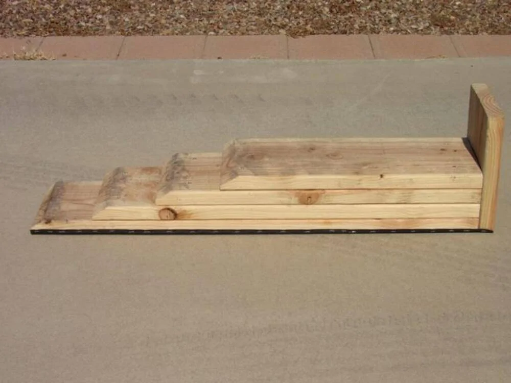

Is there anything you can get it on that could be problematic? Did you just lay on the ground and spray away?
I spray it on everything underneath my Jeep, except the exhaust. I buy a gallon of Fluid Film and use a $20ish undercoating spray gun and my air compressor.
I made some wooden ramps out of scrap lumber, that are 5 layers of 2x10. I can drive up my ramps, set up my spray gun and spray the underneath in less than 30 minutes.
These aren't mine, but you get the idea. Mine have another layer;
Jeep Wrangler JL Undercarriage corrosion spray? 1732574996276-jx
I also use them to work on my motorhome.

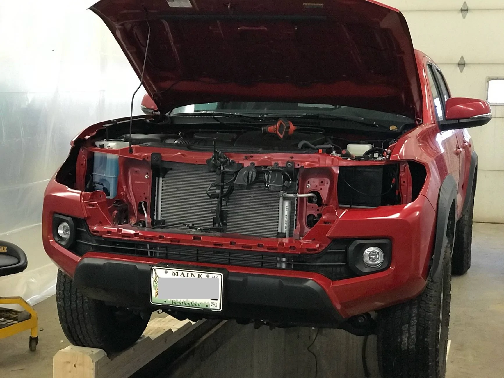

I made some similar ramps, I couldn’t find any ramps on the market that looked trustworthy or rugged enough to hold up an ATV.
