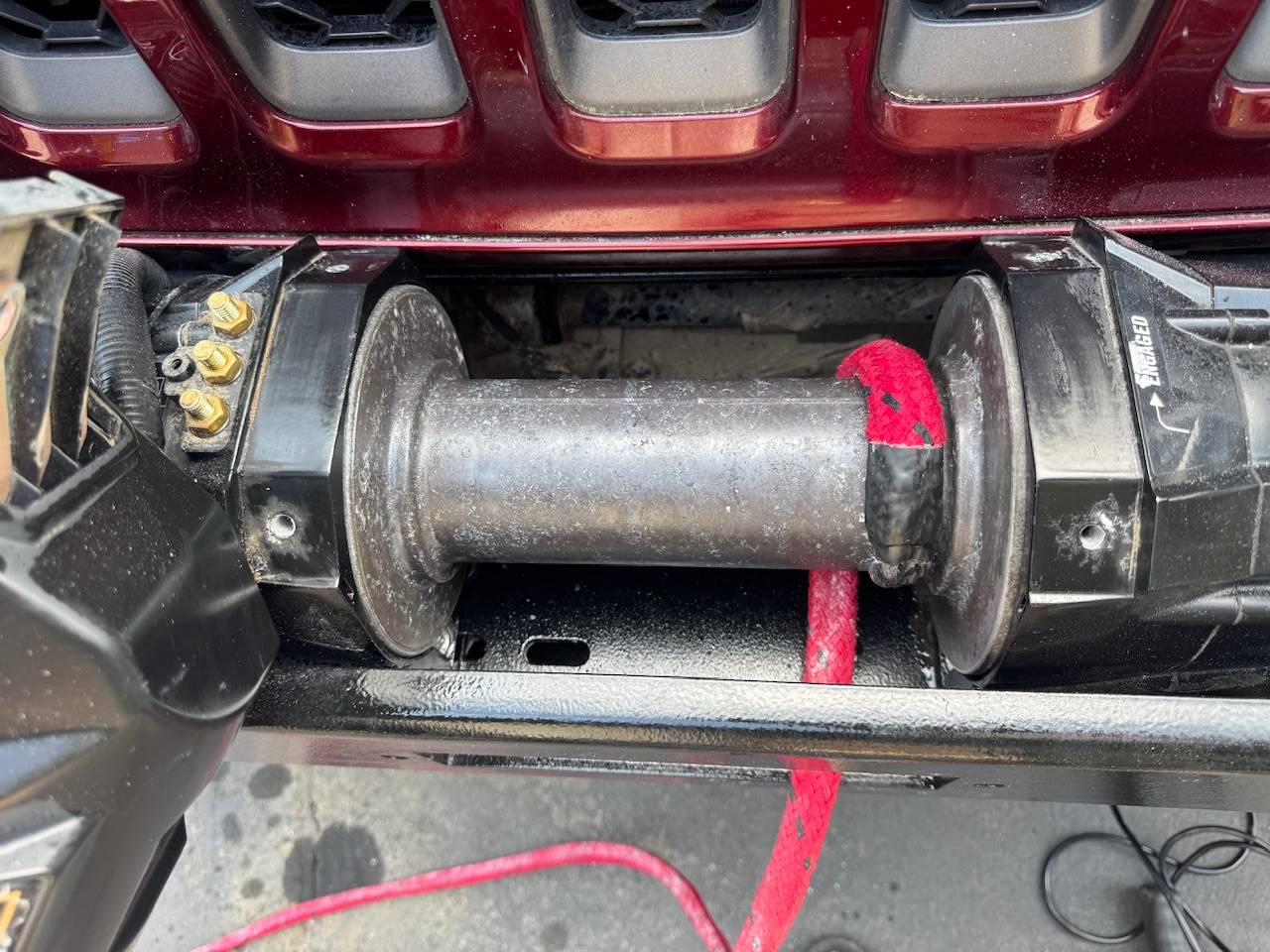

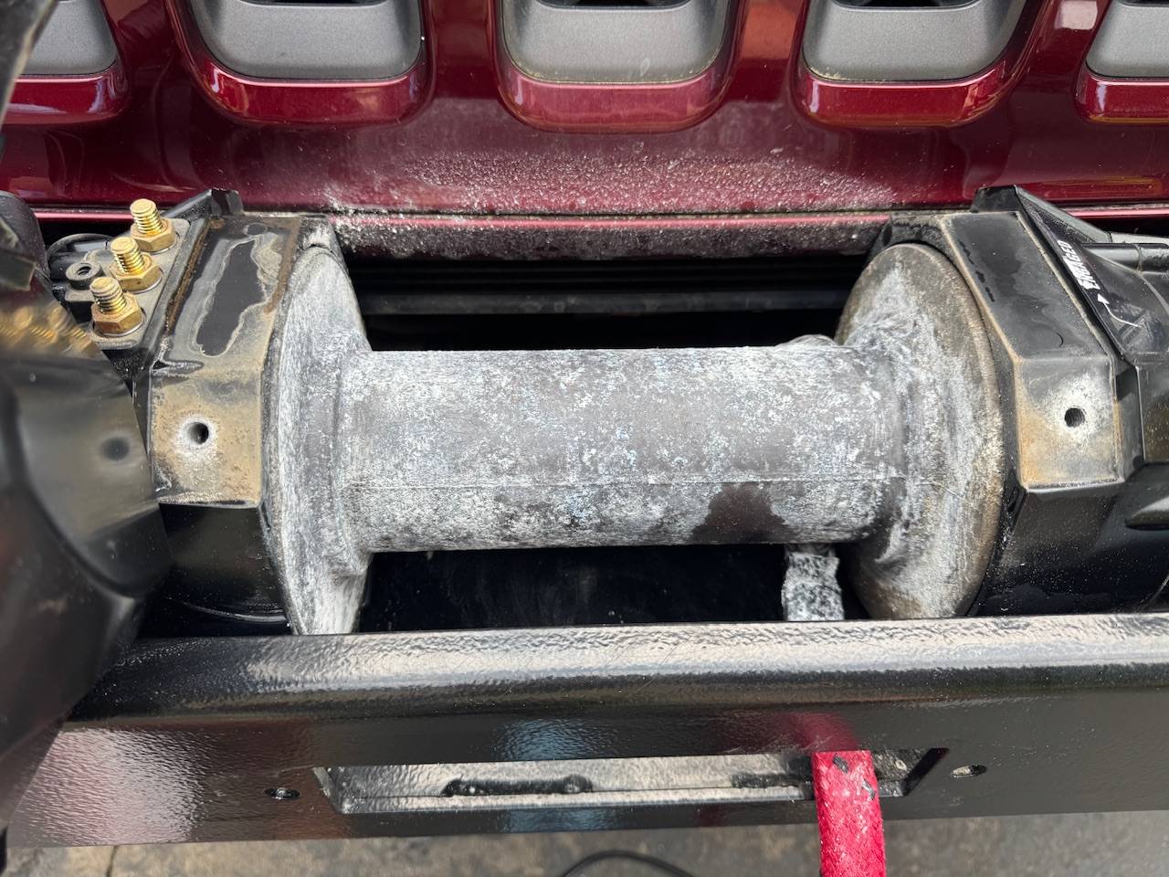

Decided to see if I could get some access… got after it with vinegar and scotchbrite pad… then sprayed some BoeShield T9 on it and wiped it down. It’s not perfect but good enough. I will check back in another year or more.
Before:
Jeep Wrangler JL Corrosion fix - Warn Zeon winch? IMG_2701
After:
Jeep Wrangler JL Corrosion fix - Warn Zeon winch? IMG_2703

Definite improvement! Hopefully the T-9 will help prevent, or at least slow, future oxidation.

Does the t9 put a coating on it at all? I would try to coat it with something to hopefully seal it before spooling it back up.

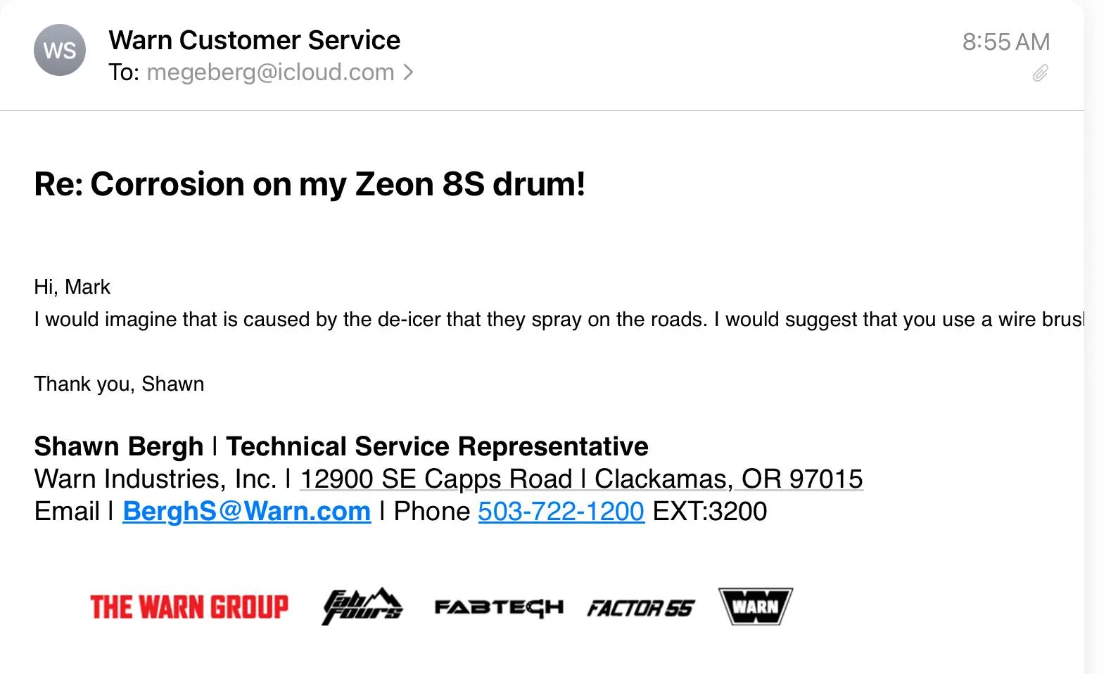

Definitely thick corrosion on the drum. Fairlead seems to have some kind of seal coating and the oxidation is underneath.
Still shocked at the amount. I have an email into Warn.
Here is the reply from Warn CS…
Jeep Wrangler JL Corrosion fix - Warn Zeon winch? IMG_1928
