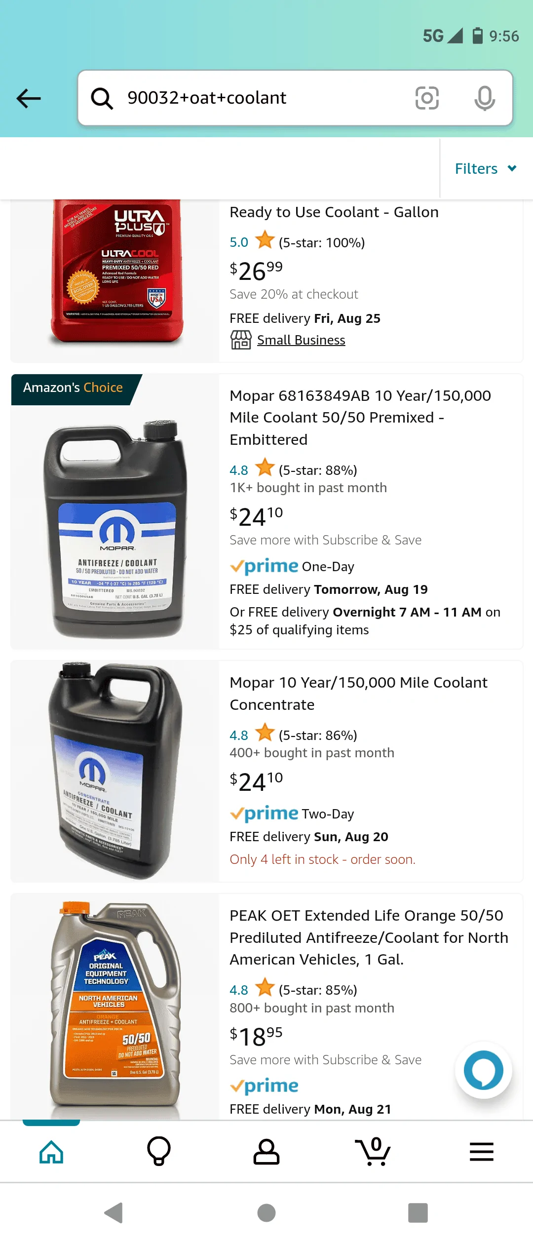

Mopar is currently $25 a gallon. Is there a Zerex or Prestone equivalent out there?
Thanks.

No, manual says to use OAT MS-90032. (Organic Additive Technology:))

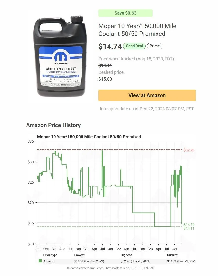

That's unusually high. Could've swore it was only around $15 at Amazon only a few months ago.
Just checked a price tracker and it's still showing their price at $14, when it's currently $24..
https://camelcamelcamel.com/product/B017DP43ZC
Not 100% sure, but was thinking that was the correct premixed coolant for the v6. Edit, if so, Mopar still has it for under $14 (LINK), but not sure what shipping is. Edit, $14 shipping lol, maybe try a dealership since MSRP is only $17?

Think you've gotten rid of your Jeep by now, but in case anyone else needs some, the Mopar MS.90032 50/50 premixed coolant at Amazon has finally dropped back down below $15 (was really overpriced for a long while). Not 100% sure, but afaik, this is the same coolant used for all Jeep engines and for the other coolant reservoirs (eTorque battery, eTorque generator, etc).
Don't really need any myself at the moment, but ordered a jug just to have on hand.
https://www.amazon.com/dp/B017DP43ZC
