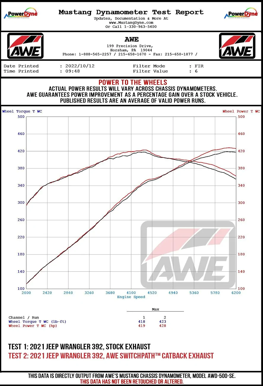

The upside of the catback on the JL is clearance rather than engine performance.
Yep- the Switchpath 9Hp peak wasn’t worth $2400 (BF sale, now $3K) without tucking up so well. Gains above ~3680 RPM, with a flat spot around 4800+-.

Come on now. Who here wouldn't shell out $3K for an awe-inspiring 2% gain? 392 owners are loaded, right?

Well, the big ugly can and the tips hanging down can no longer get damaged and no longer set off my OCD. Yeah, loaded, also over $800 for MMX 88 mm TB and ported intake manifold for 14 Hp. …. The $300 TB alone is good for 12 on an otherwise stock engine… with a tune. These types of upgrades require a tune for max increase, but not CARB approved, so it’s not cost effective for invisible to smog check “no tune required” small upgrades without one.

Shit those are just run to run variance there is nothing on that chart that I would think the exhaust gained you anything lol

I didn’t get it for the small performance gain in higher RPM’s. It was for the fitment, even the tips aren’t below the receiver as adjusted. Sounds better too, at first I missed not having a true quiet mode, it’s about 1/2 way between stock quiet and loud. But I quickly got over it, “quiet” sounds good without being a too loud cop magnet and “loud” only occasionally used…
to annoy Broncos 😉

When designing a system like this, HP is an added bonus, not the goal. We aim to create a killer soundtrack, improve flow, and bring some added benefits where we can. In this situation, improved clearance over factory was a non-negotiable for our customer base.
We share HP numbers via our dyno sheets for transparency so owners know what to expect following the bolt-on addition of our system.
It would be crazy to think a bolt-on part would make a bunch of power on modern vehicles by itself, but it can add to power gains as a supporting mod to a tune. By providing better flow than factory, it becomes a future proof modification for your build.
