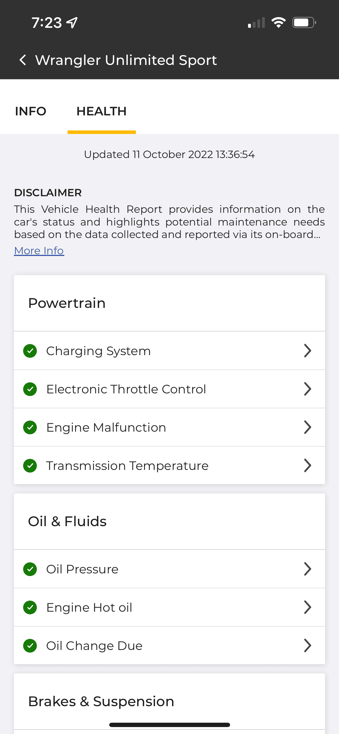

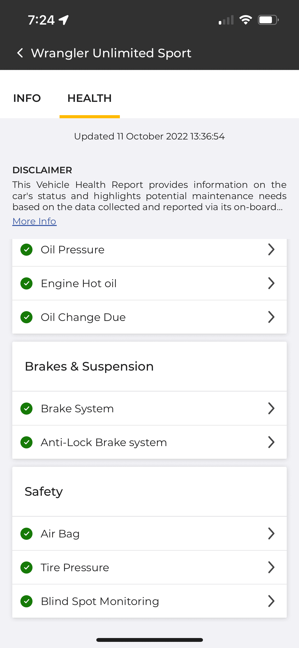

So here's all the codes my Jeep is throwing at me.
Jeep Wrangler JL Cold Air Intake causing error codes E731D601-1955-4C46-83D3-49929589E29F
Jeep Wrangler JL Cold Air Intake causing error codes B21BAECF-6B9B-4FC0-AD95-0D40D4DA36C8

Just got a call that my Jeep is fixed. Said they had to reprogram the main computer. Jeep said it's probably cuz of my 37's. Said if it happens again, I'll have to go down a size. That is total bullshit. We'll see if it happens again & then start fighting.

If you have issues again I'd avoid that dealer. IMO, likely battery or fues/fuse array, given the variety of electrical stuff.

The dealer is actually a best friend of mine. He agrees that Jeep is trying to make excuses and said we'll cross our fingers & hope we don't have to start fighting with them. When I took it in, the service manager said it sounds like a battery & figured it would only take a few hours to get it all checked out. It ended up taking a week. We'll see. The dealer put 35's on it & regeared with 4.56's when I bought it new.

So it happened again except more electrical issues. Took it to the dealer again, they gave me a 2023 car as a loaner as they said they might have it a while trying to diagnose an electrical problem. A few days later, they found a wire had somehow came loose & was rubbing on a pulley & was frayed. They're ordering a new wire & hopefully that'll fix the issue.

Dave, your description of error codes and dashboard warning lights (post #16) does suggest a battery that is reaching the end of its practical service life. Yes, perhaps it's occurring prematurely, given that you have a 2021 Jeep, but such failures can manifest themselves in seemingly unrelated ways.
While the expense can be an annoyance, do consider the idea of replacing one or both batteries as a prophylactic measure. Doing so in my own vehicles has solved issues similar to your own. Granted, I was trying to squeeze the last volt out of my batteries before investing in a quality replacement.
This. ?
A fresh supply of voltage can solve a lot of problems. (I see this all the time on motorcycles with ABS systems that routinely complain if they don't get the voltage they want at start.) I don't see any real commonality with your thrown codes other than sensors, so I would try a new batt.
