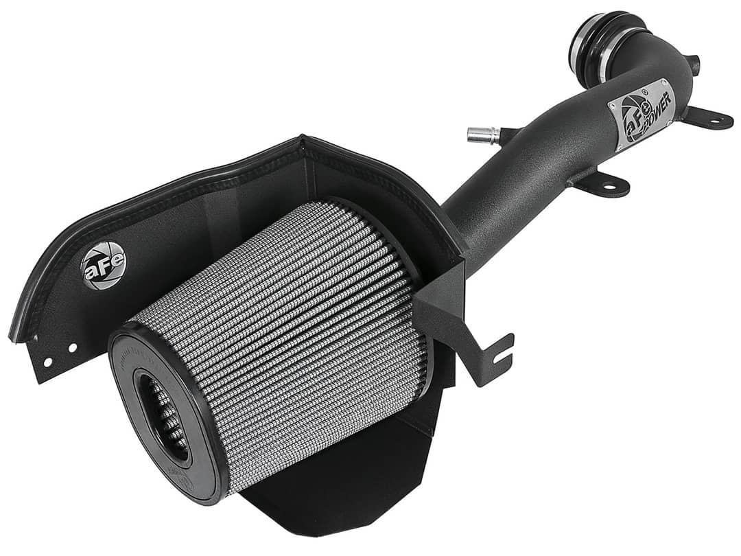

As and update, They reset some stuff on the computer and nothing wrong since. I'm afraid to put the CAI intake back on, but will probably do it in the near future.

I don't know if this has yet been mentioned, but CAIs that use oiled air filters are susceptible to causing a CEL code or two to occur. It's been an occasional talking point in other threads. The usual cure is to substitute a dry filter.
Just passing this on for your consideration.

from my side i went back to the stock CAI. i took out the AFE since, i only use it for desert season. but the last time when i cleaned the filter, i found dust inside the AFE pipe which really concerned my especially my car is still under warranty. i might just do drop in paper filter next time
