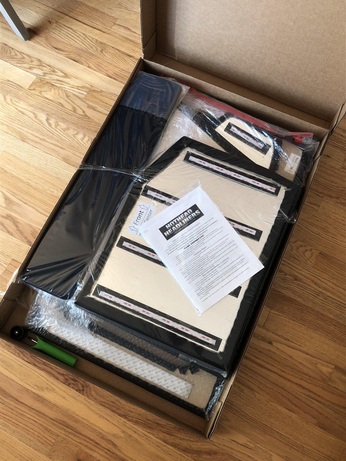

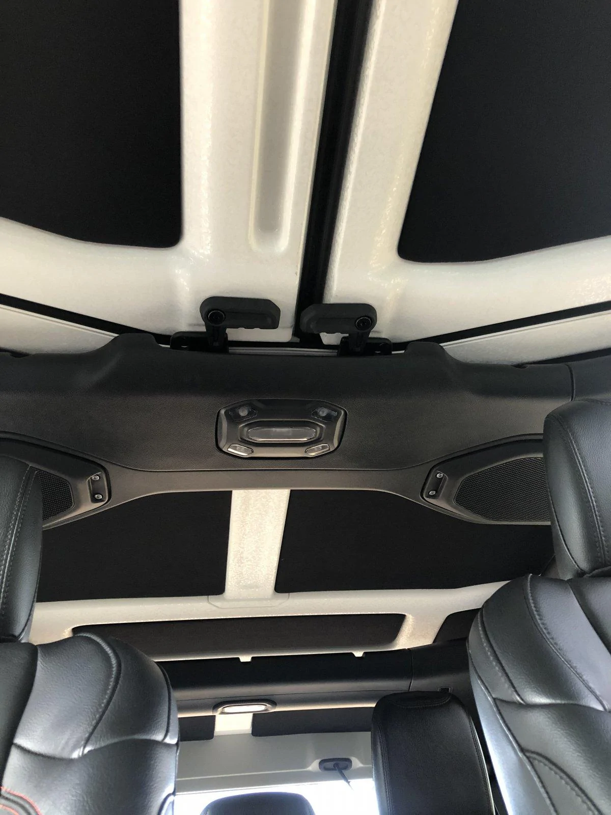

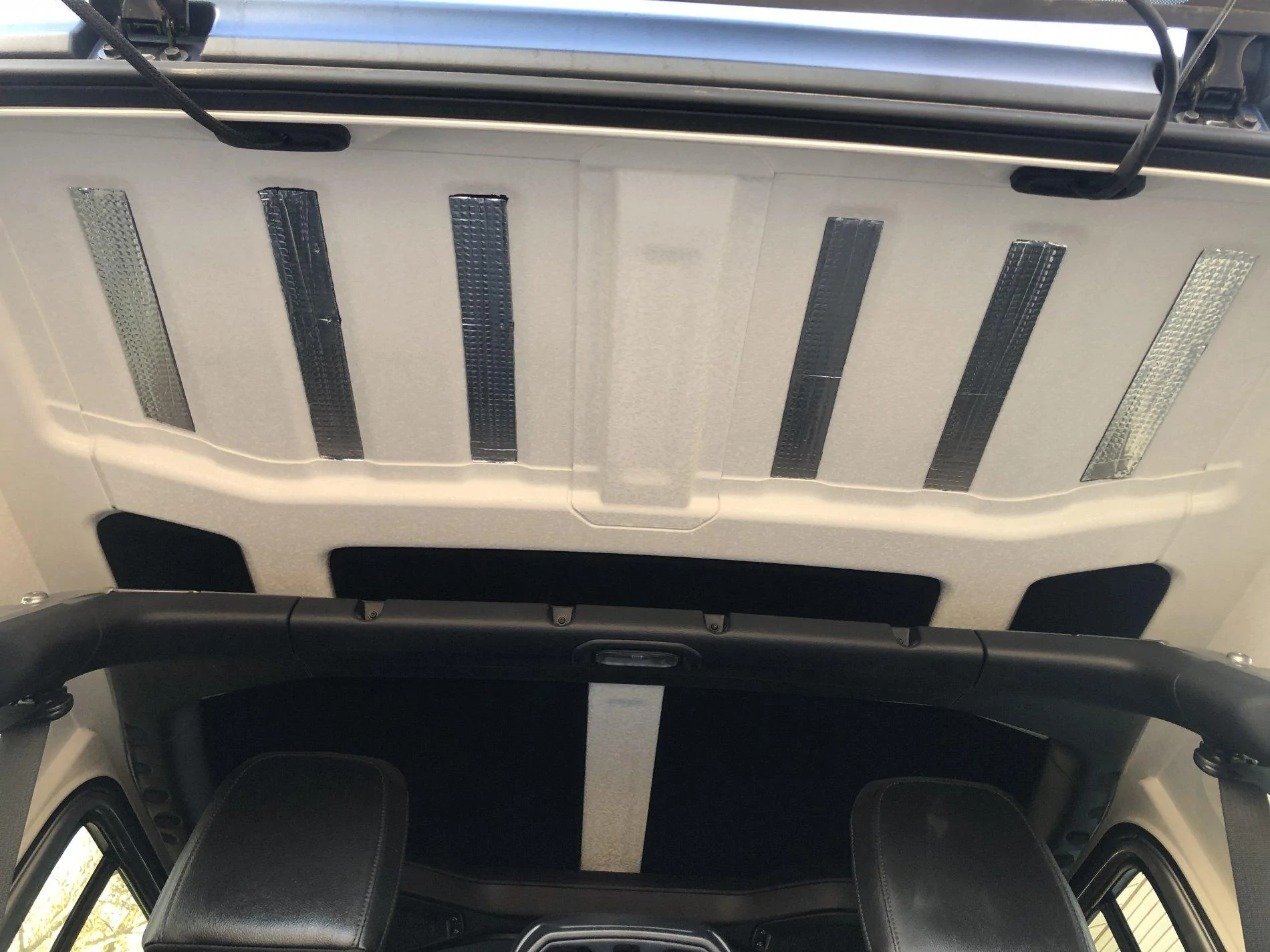

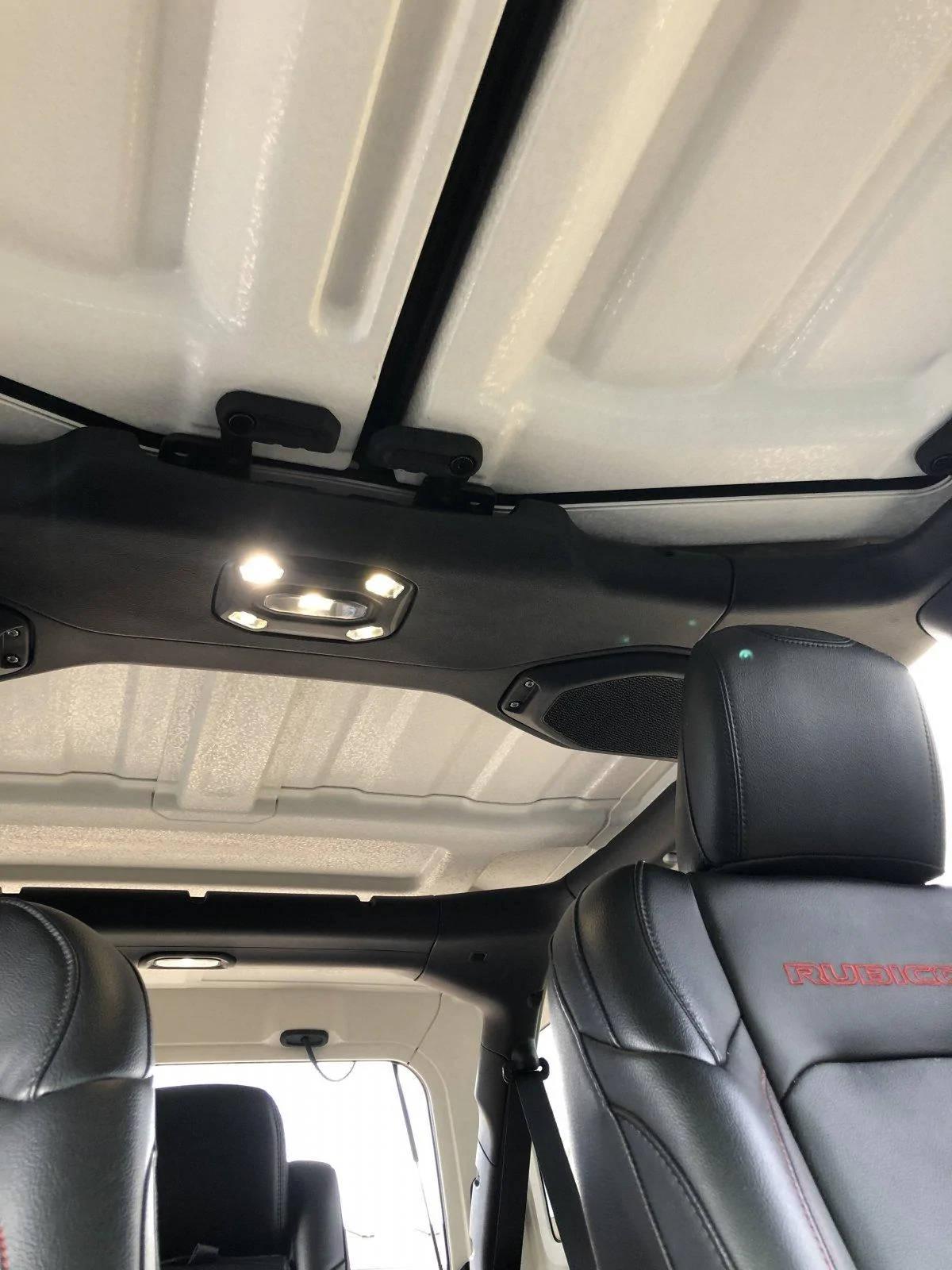

Girlfriend surprised me with a cool birthday present...dunno how she new about hothead headliners but got those and their sound assassin strips. Doesn’t feel like driving around in a fridge anymore, temps in the cab should be easily managed too.

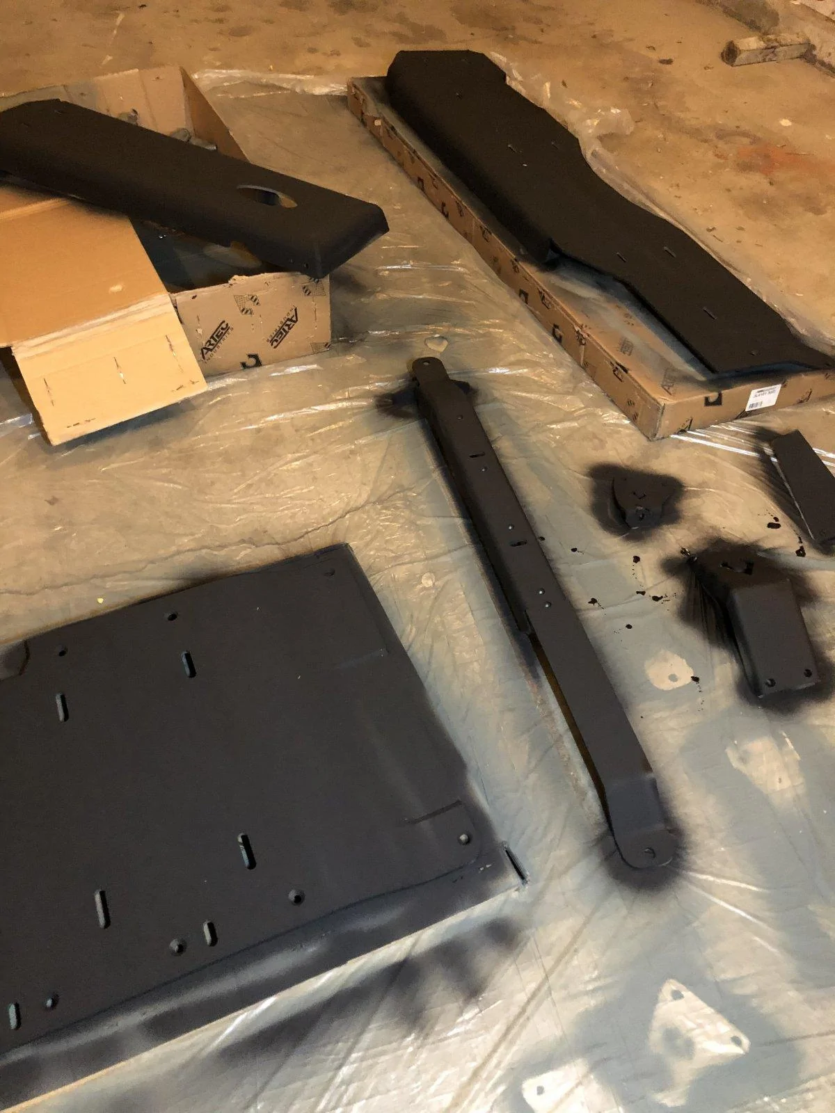

So I did what I do best, made something bright and beautiful look really boring and ugly...

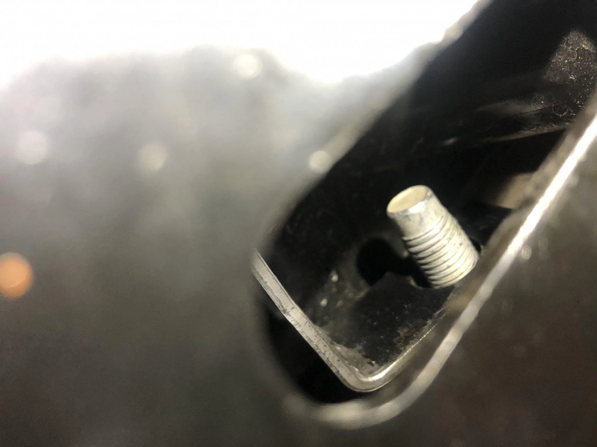

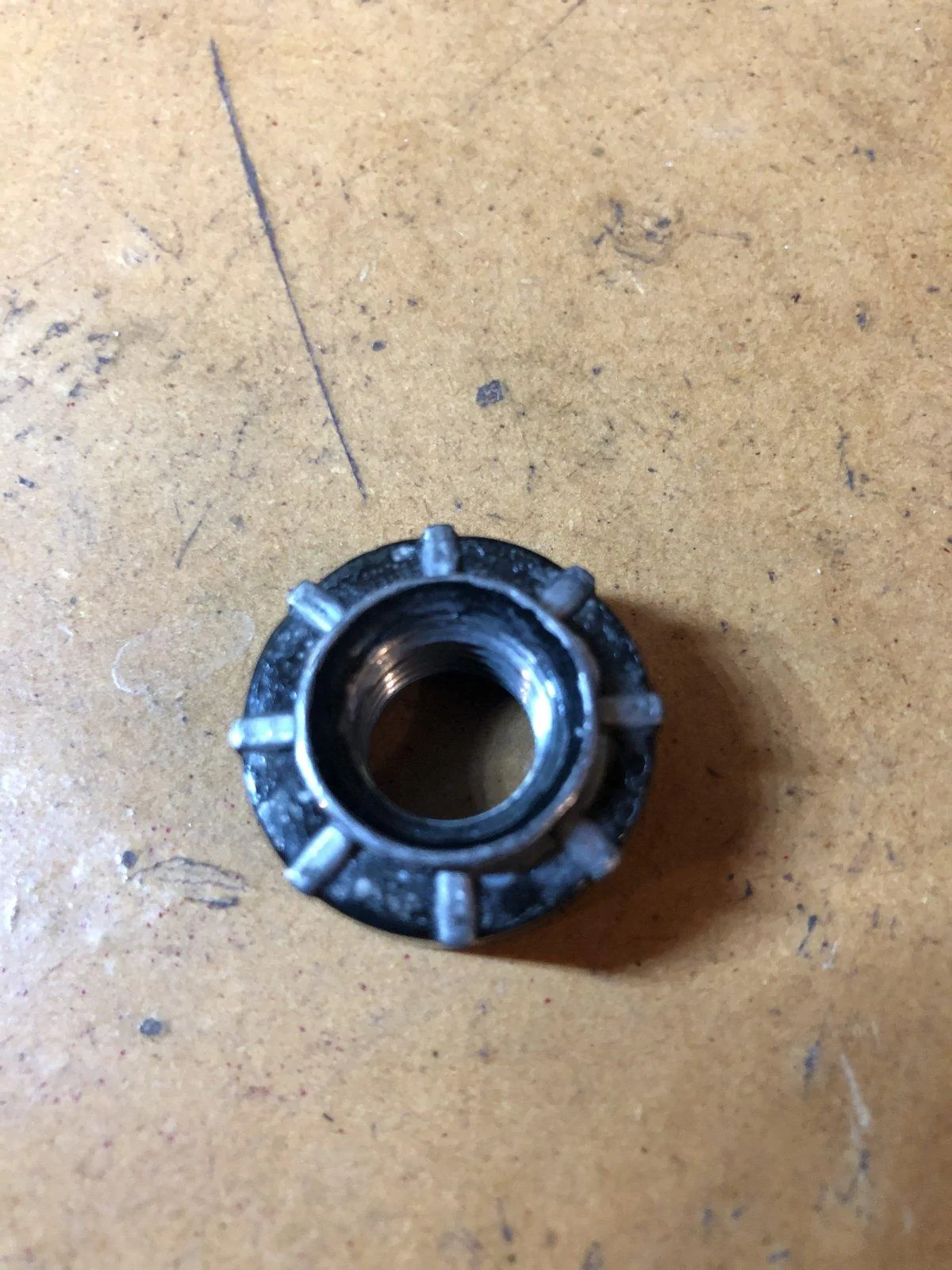

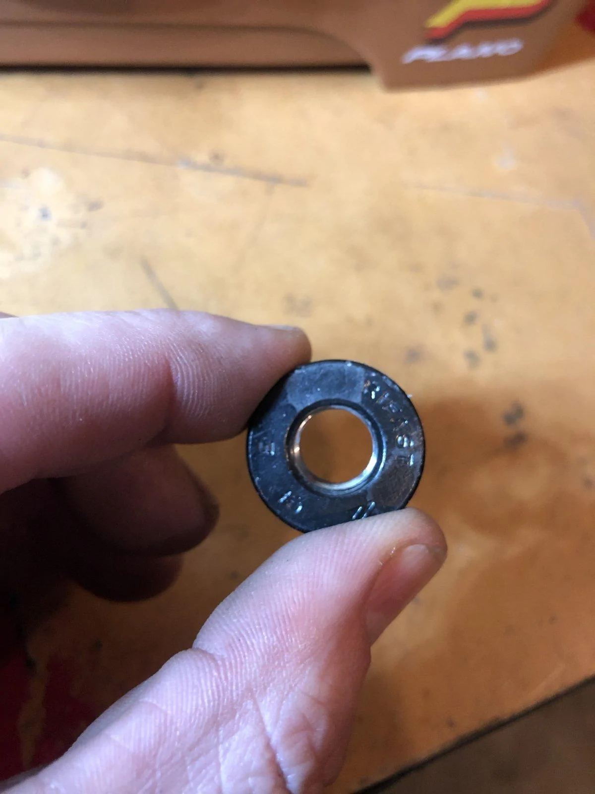

And then proceeded to blow out a factory nutsert that held one of the skid plate bolts to the frame so found some 1/8 stock, drilled a hole, spot welded the nutsert to it, bent it up and fished the nutsert back into the frame to finish the install.
What a great girlfriend. She's definitely a keeper!

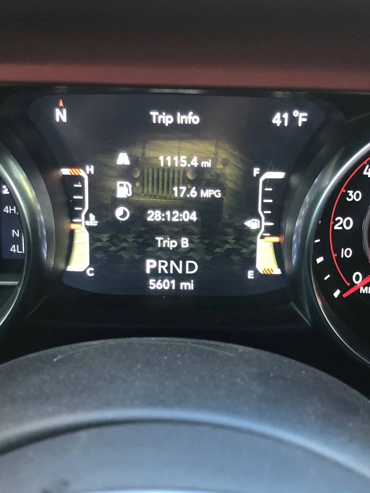

Been a bit since I updated this thread. A good friend of mine came out to visit over Thanksgiving and we decided to head out to Canyonlands NP and explore The Maze area. At the time was still waiting on the spare tire carrier so laid down the spare in the back and drove roundtrip - felt good to not hassle with a tow rig and trailer. I was impressed with the roundtrip MPG considering the 37s, stock 4.10s, and mountainous I-70 route out and back.
Roundtrip data:

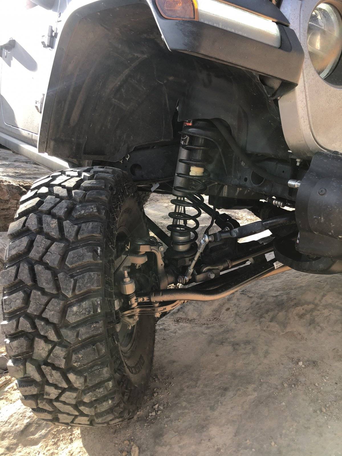

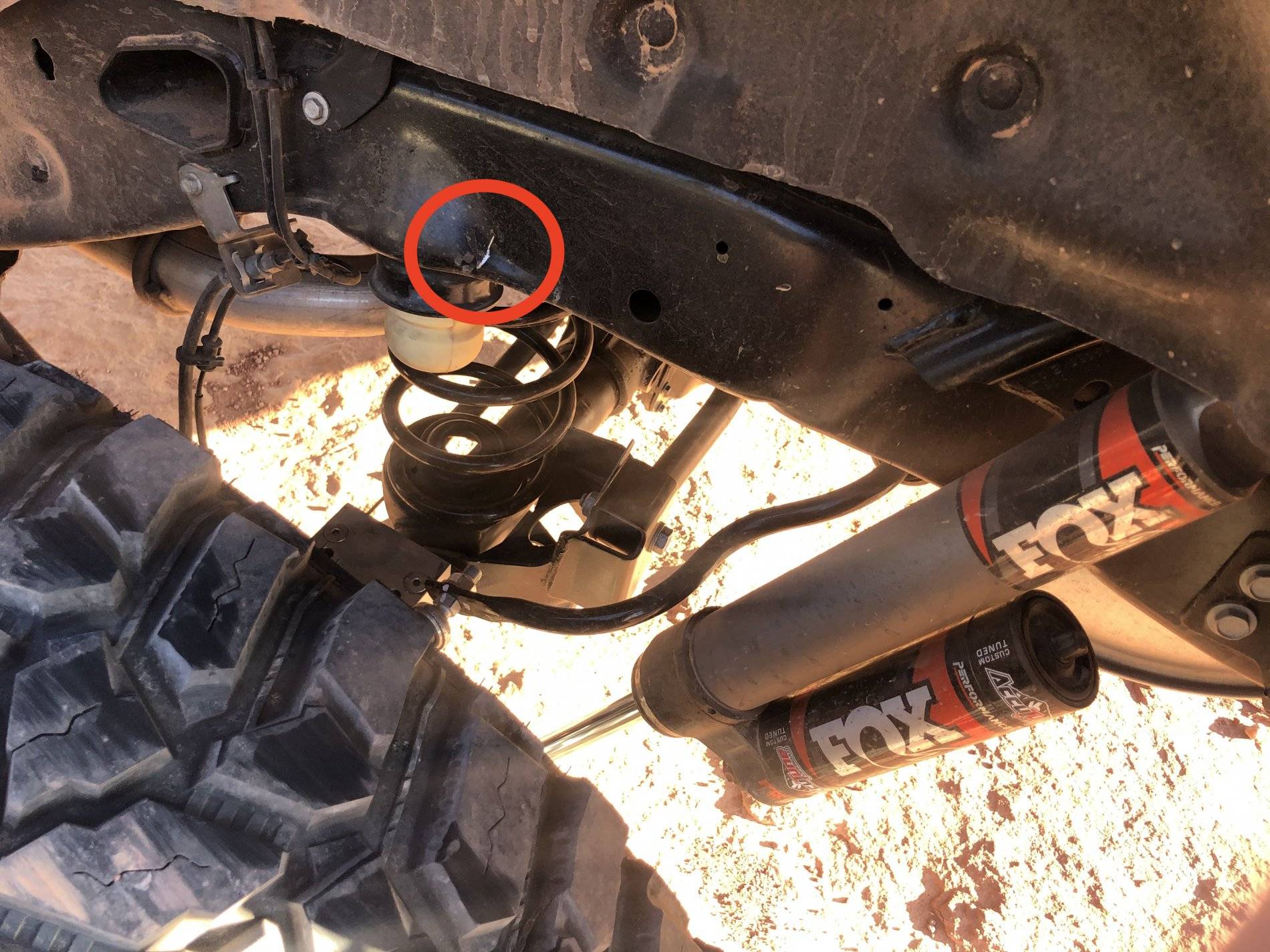

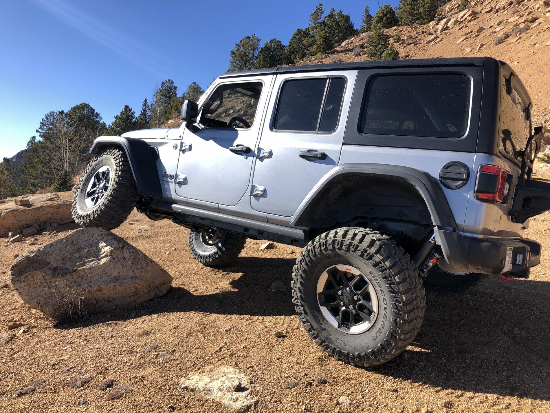

Got to flex out the new lift in a couple spots, not bad for a short arm but did notice some rubbing on the rear frame from the sway bar link hardware, I'll have to address in the future:
Jeep Wrangler JL CO Ketchup Build IMG_2331
Jeep Wrangler JL CO Ketchup Build IMG_2332
Jeep Wrangler JL CO Ketchup Build IMG_2345

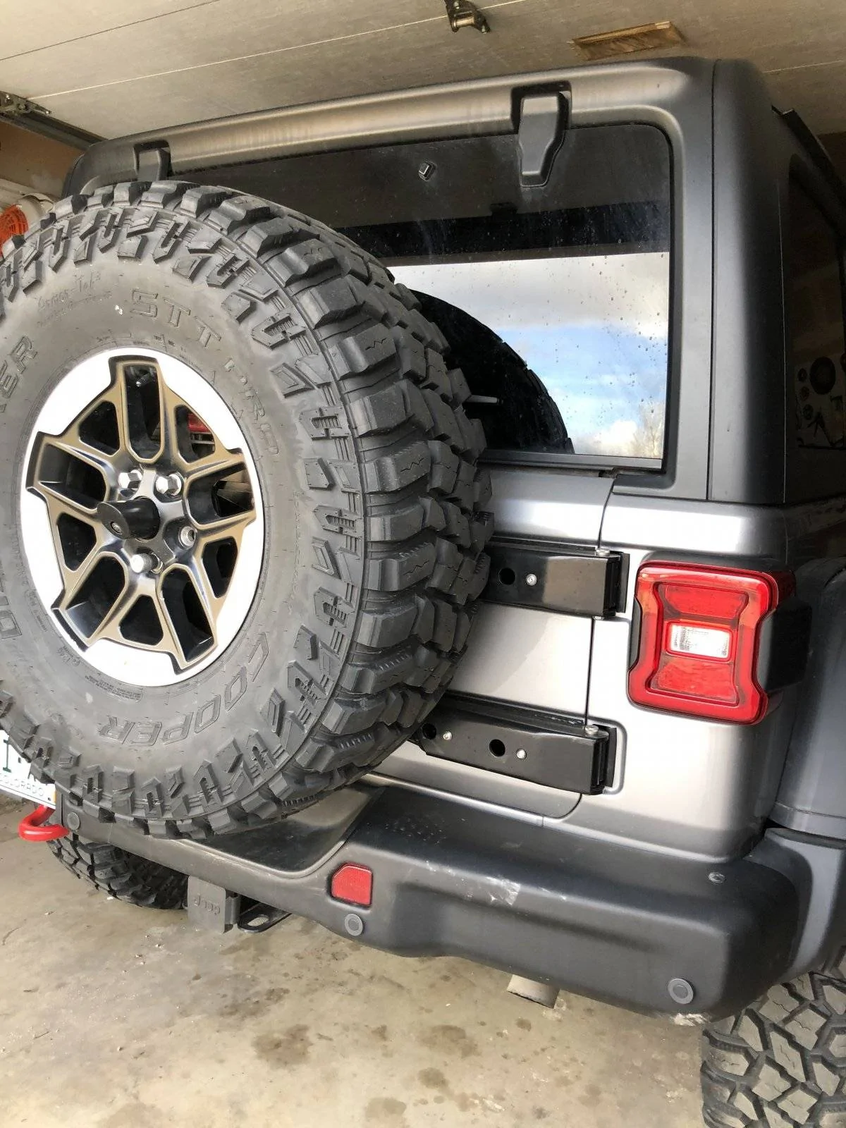

Rusty's Spare Tire Carrier finally came in after I ended up canceling my order through Quadratec and got it straight from @RUSTYS only after 2 weeks, Thank You! The Carrier is solid and it's probably my favorite part on the jeep:
