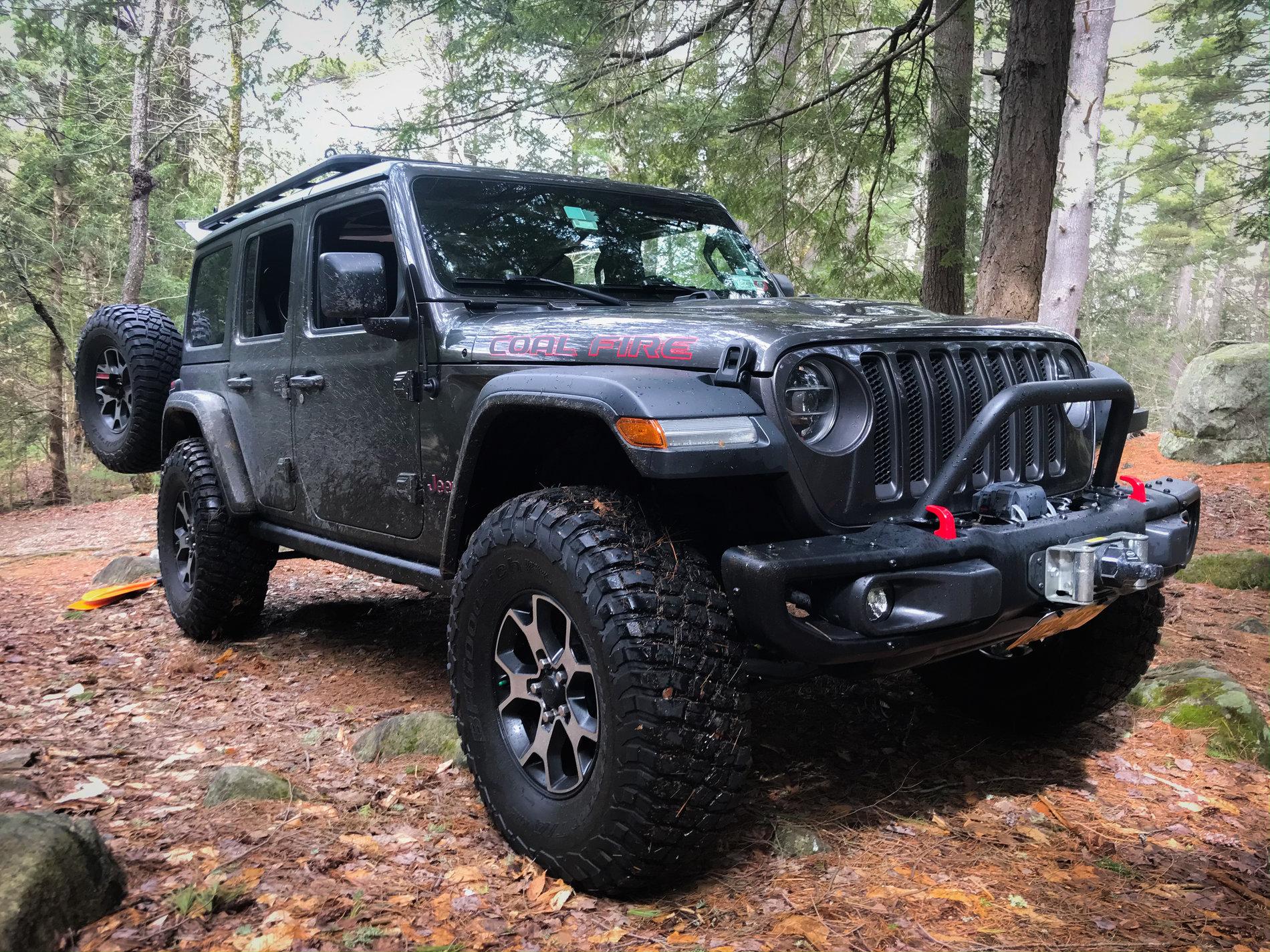

Someone asked me about my set up. Here's my reply after 3 months on the icon stage 8.
I have yet to do serious off roading with it, though I've climbed some obstacles, done some trails with varying terrain, and am thrilled with the performance. Floats down rough trails, especially with the front sway bar disconnected; flexes like crazy both front and back; and the road ride is both tighter (less steering wander), and more comfortable than stock.
The added bonus of the adjustable shocks is worth the extra cash. Being able to change the tuning of the shocks in the back for heavy loads of firewood or four deer's worth of meat and hunting gear by twisting a dial, or having the front dialed tighter for a heavy winch and bumper when the rear is empty makes for a great rig all around.

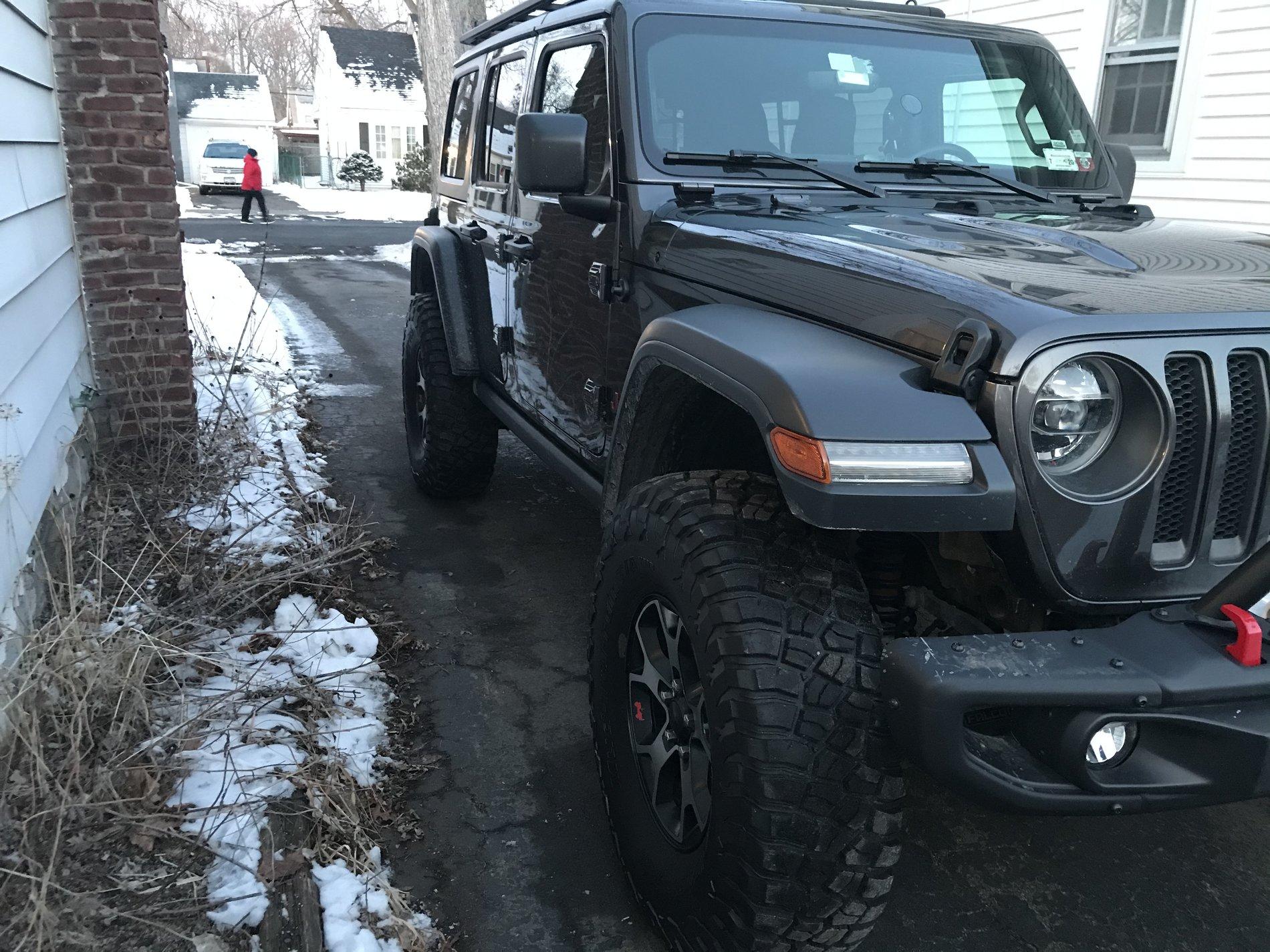

Took off the rubicon stickers, have a custom decal from @pixeldecals , but kinda like the clean hood. We shall see....

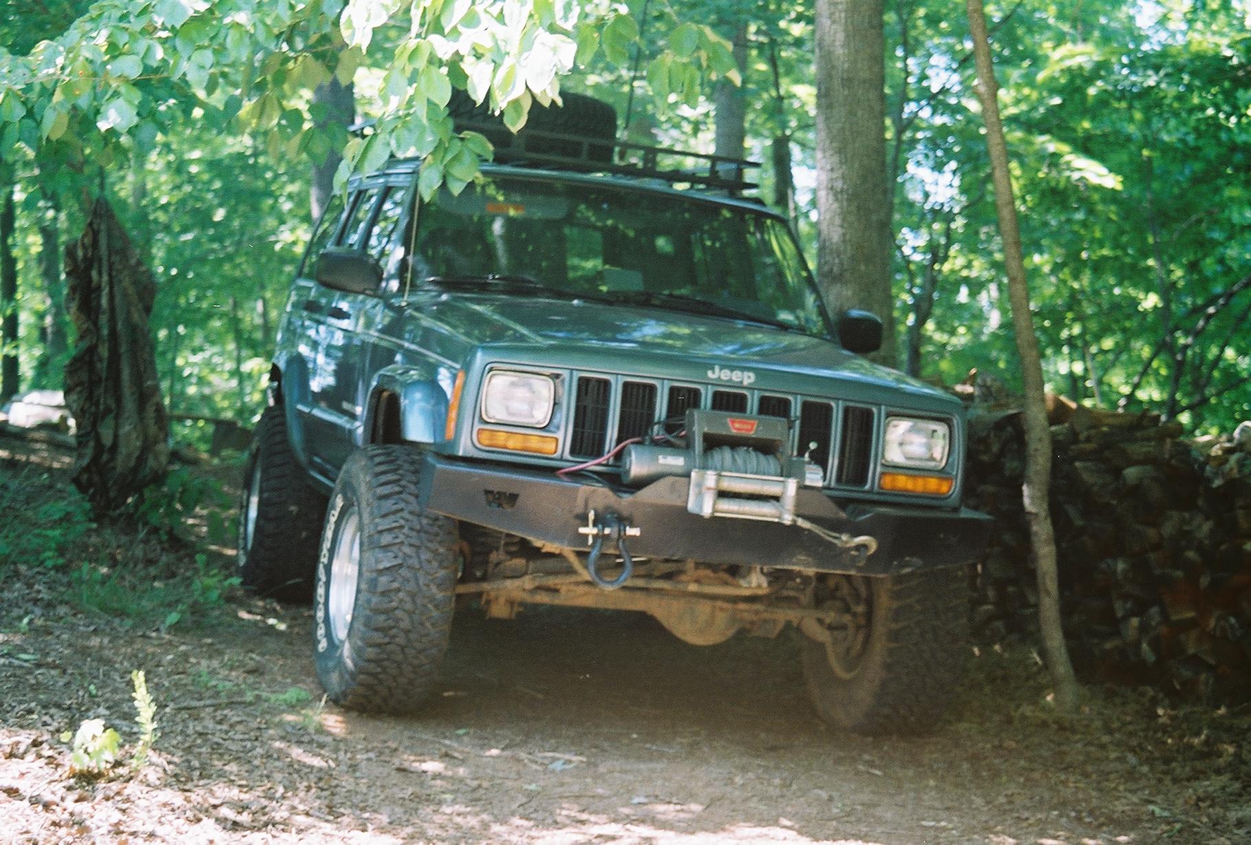

This is my third jeep build. First one was an XJ, started with a spacer lift and slowly added bumper/winch, roof rack, etc. . Took all the stuff except the spacer lift off and bought another XJ and did 4.5 inches of lift and 32's.

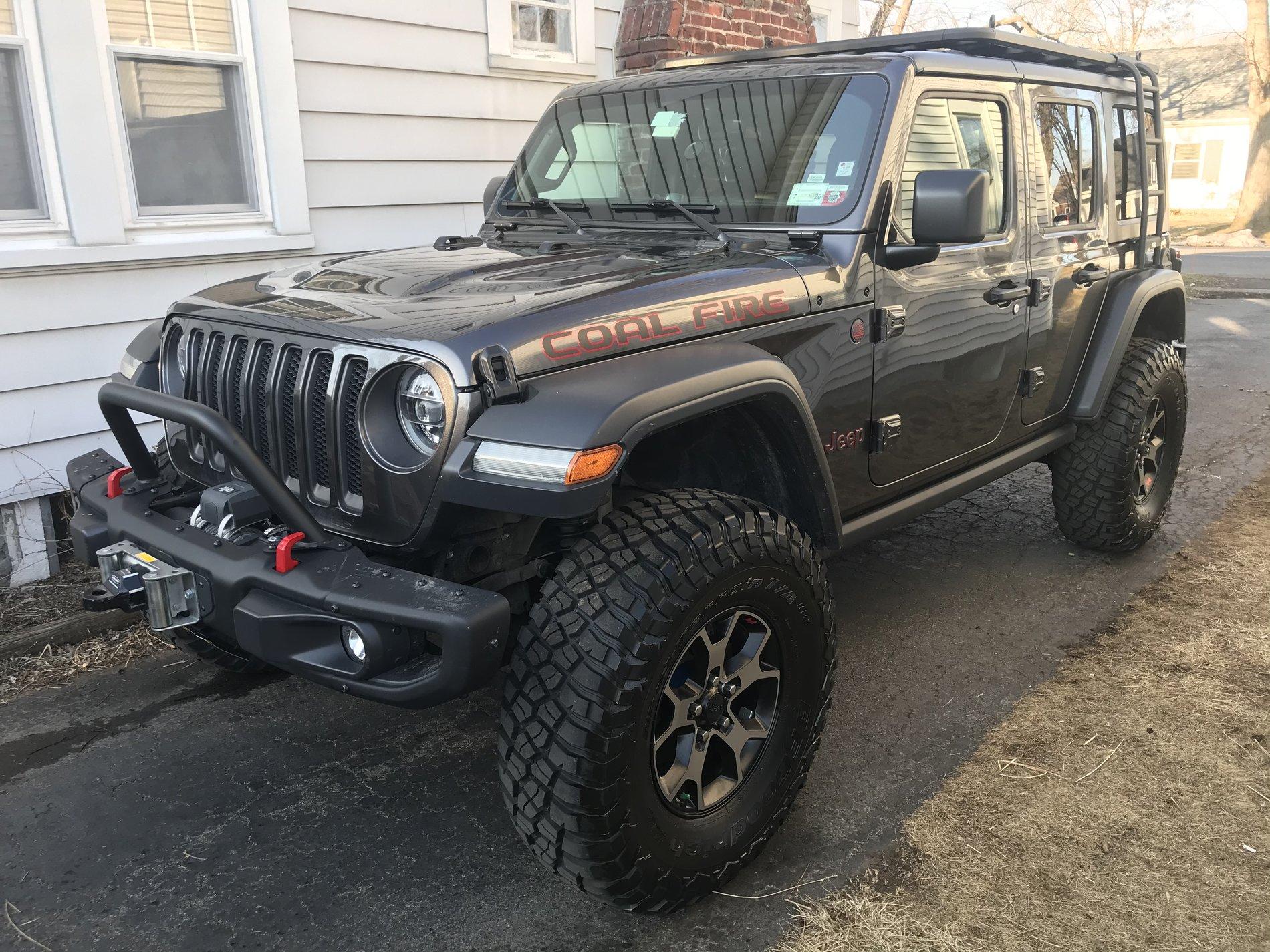

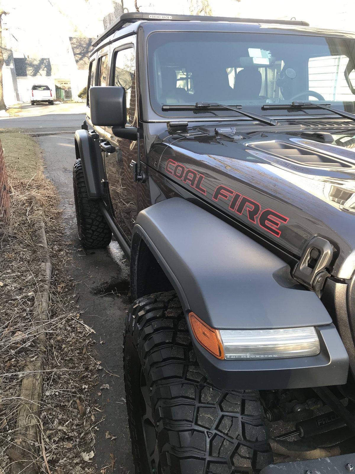

Picked a name for the jeep, @pixeldecals provided a custom decal.

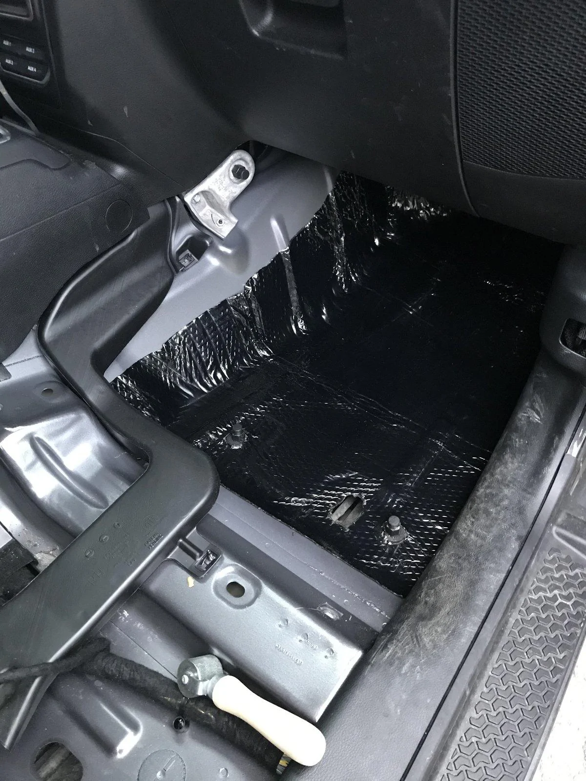

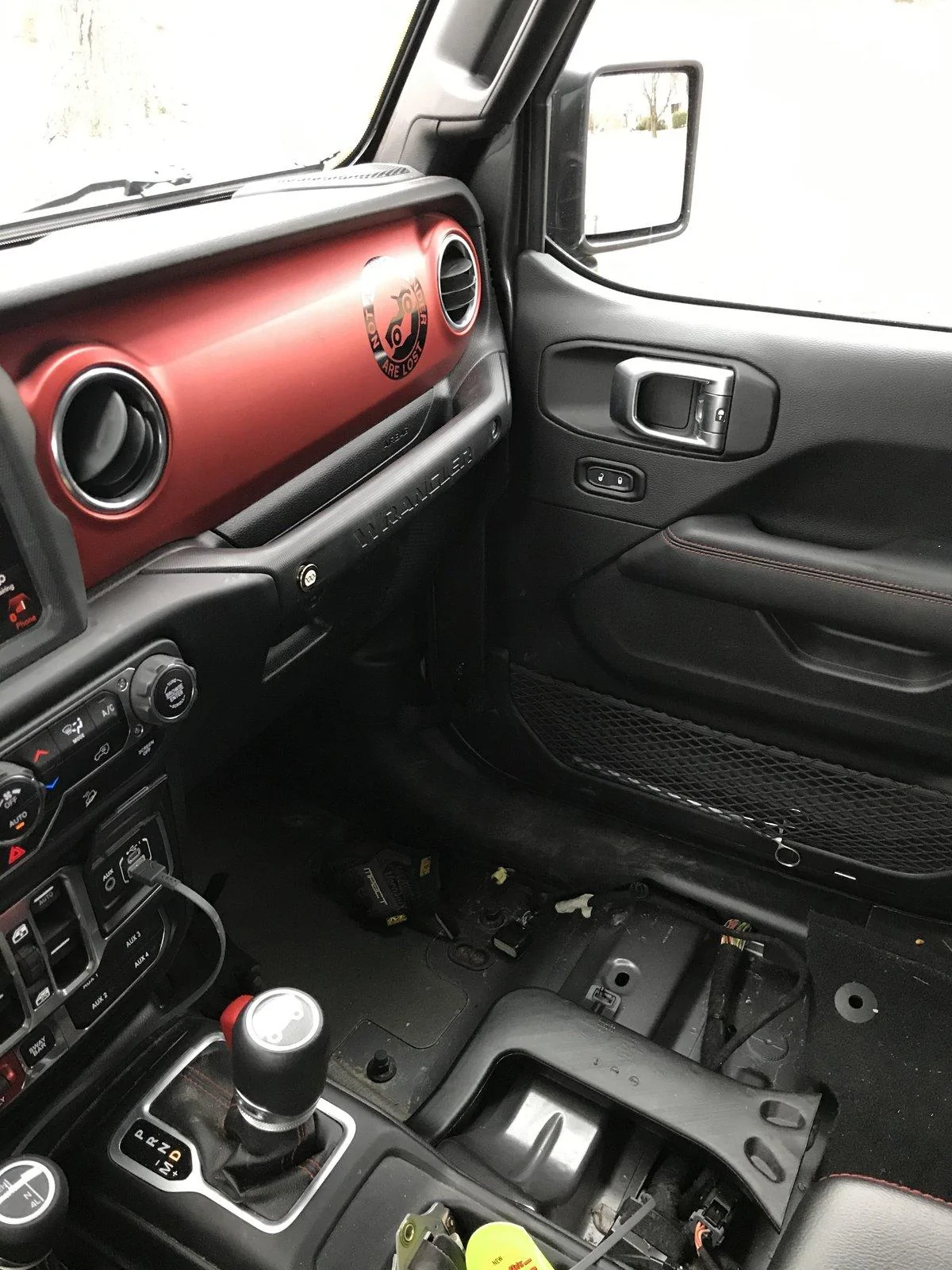

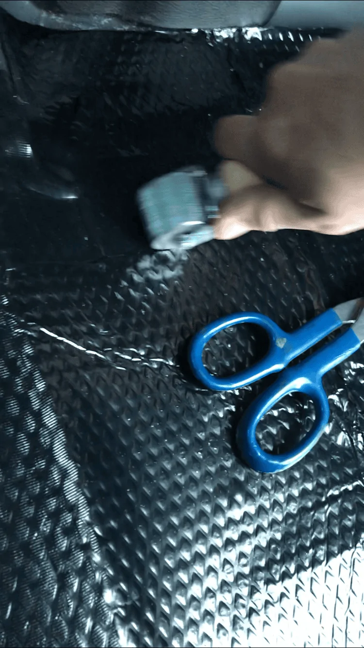

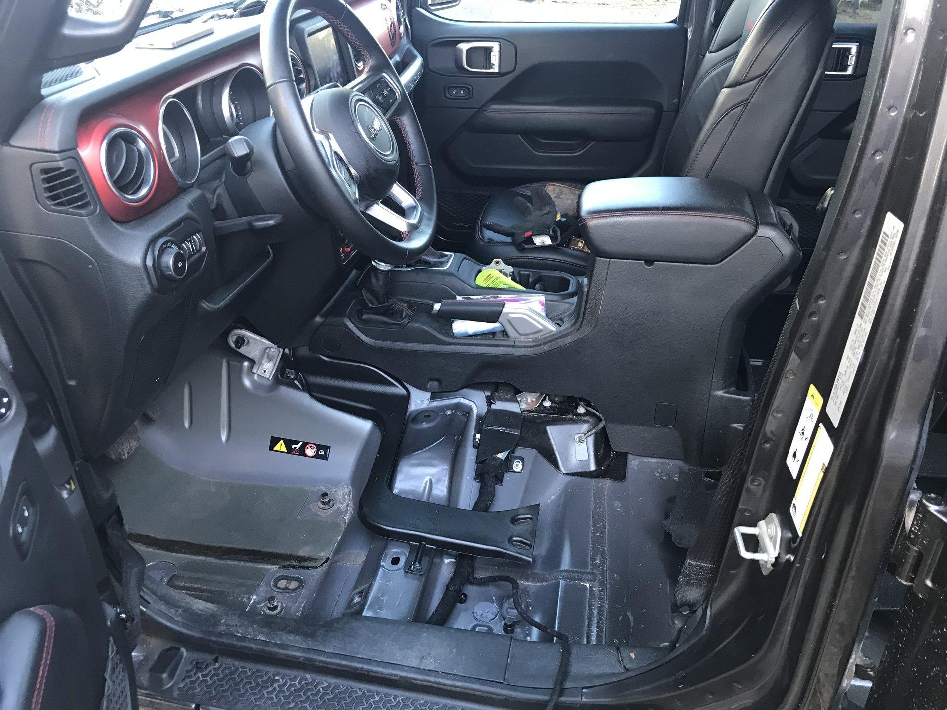

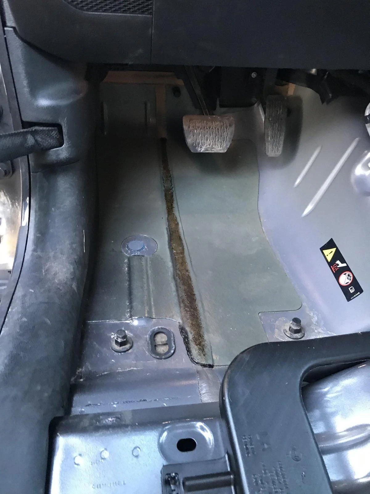

Added some noise canceling lining under the carpet. Photo is part way through the install. Review pending driving around for a bit...

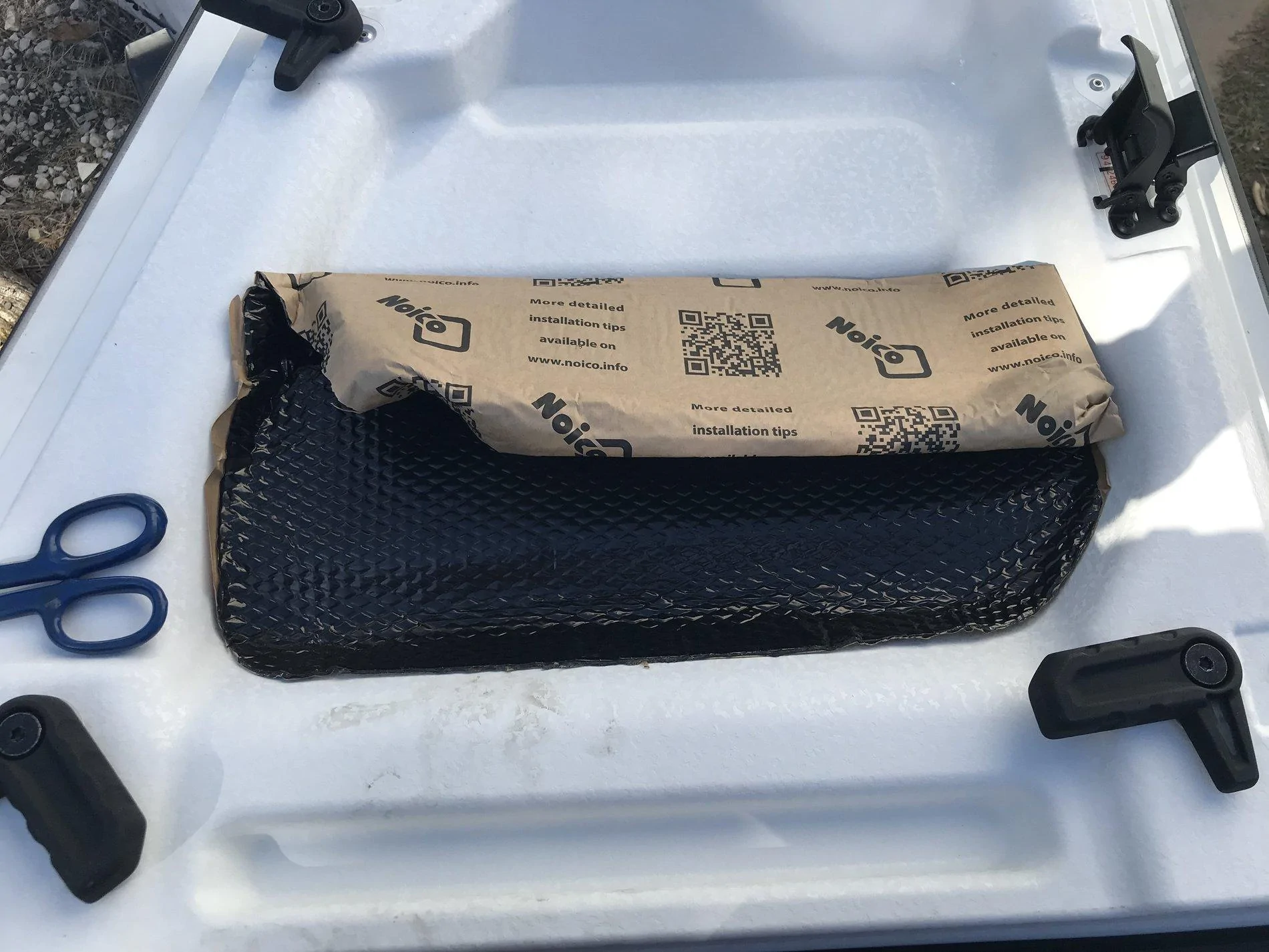

Driver's side done.
Review: Noico makes a good product, this is their 80mil stuff. One package was enough to cover 90% of surfaces under the driver's, passenger's, and rear seat sheet metal. I put a little in the back under the center section just behind the rear seat, but have plans to possibly route some air compressor stuff on the sides at some point, so left all that untouched
Noico Black 80 Mil 36 Sq Ft Car Sound Deadening, butyl automotive deadener restoration mat and Noise dampening insulation https://www.amazon.com/dp/B01BKKZ1AM/ref=cm_sw_r_cp_api_i_NvcBEbKAVJE9A
Takes a little doing, but this stuff is awesome. When I first started driving, I thought the engine wasn't on, then I thought I had a hearing issue. Around town, 45mph or so, markedly quieter. Conversations are easier, music better, feels much more vault like.
However, add a lift, 37 inch km3's, and highway speeds, noise is back :), mostly wind noise and tire drone. But that's expected, As this vehicle has the aerodynamics of a brick with 3 kites and a windmill attached.

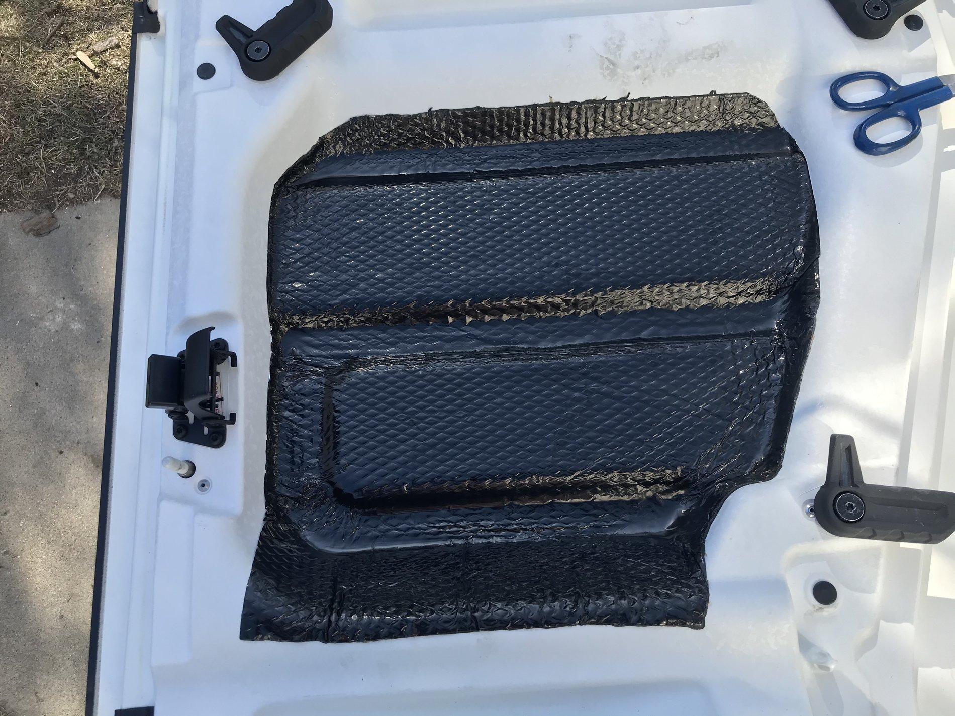

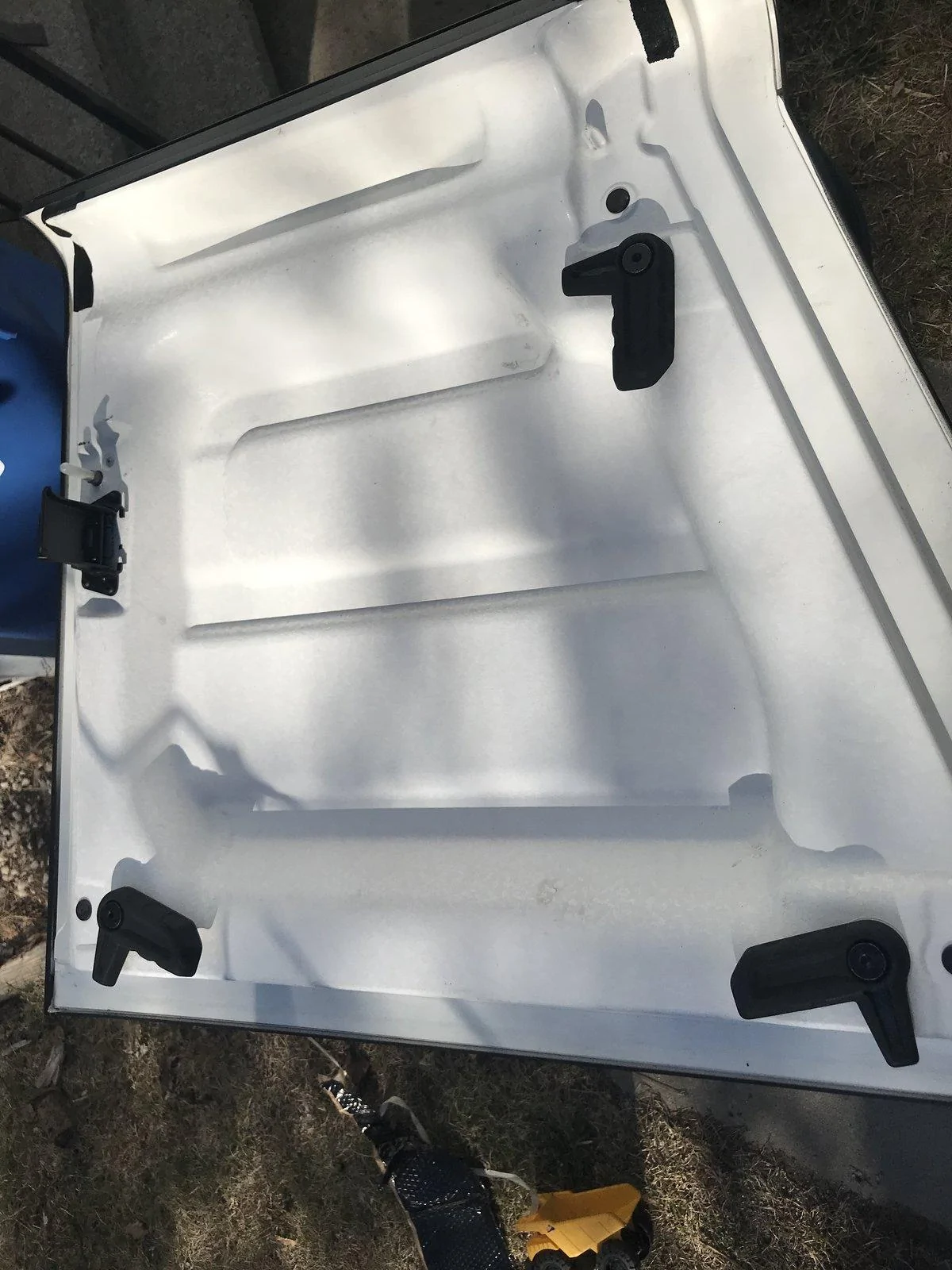

Added a couple pieces of sound deadening to the freedom top panels. Slowly turning coal fire into a Lexus ;)
small gains here. Slightly more insulated, wind noise and rain noise down a bit. Easy to do. Best way is to press a sound insulation piece into the freedom panel, then trim. Once trimmed perfect, then roll it up a bit and slowly peel back the adhesive covering.

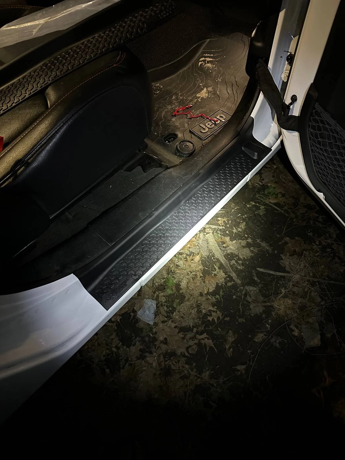

First mod: rugged ridge door sill guards.

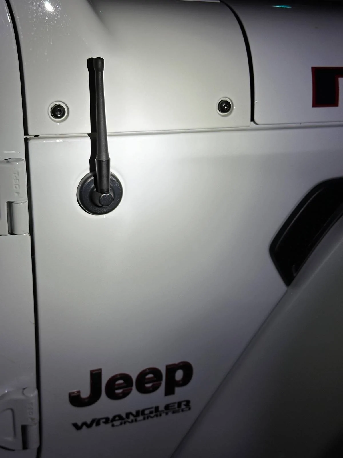

Stubby antennae came in. Was a favorite mood on my last Jeep, no need to worry about the tall one being bent or knocked off.

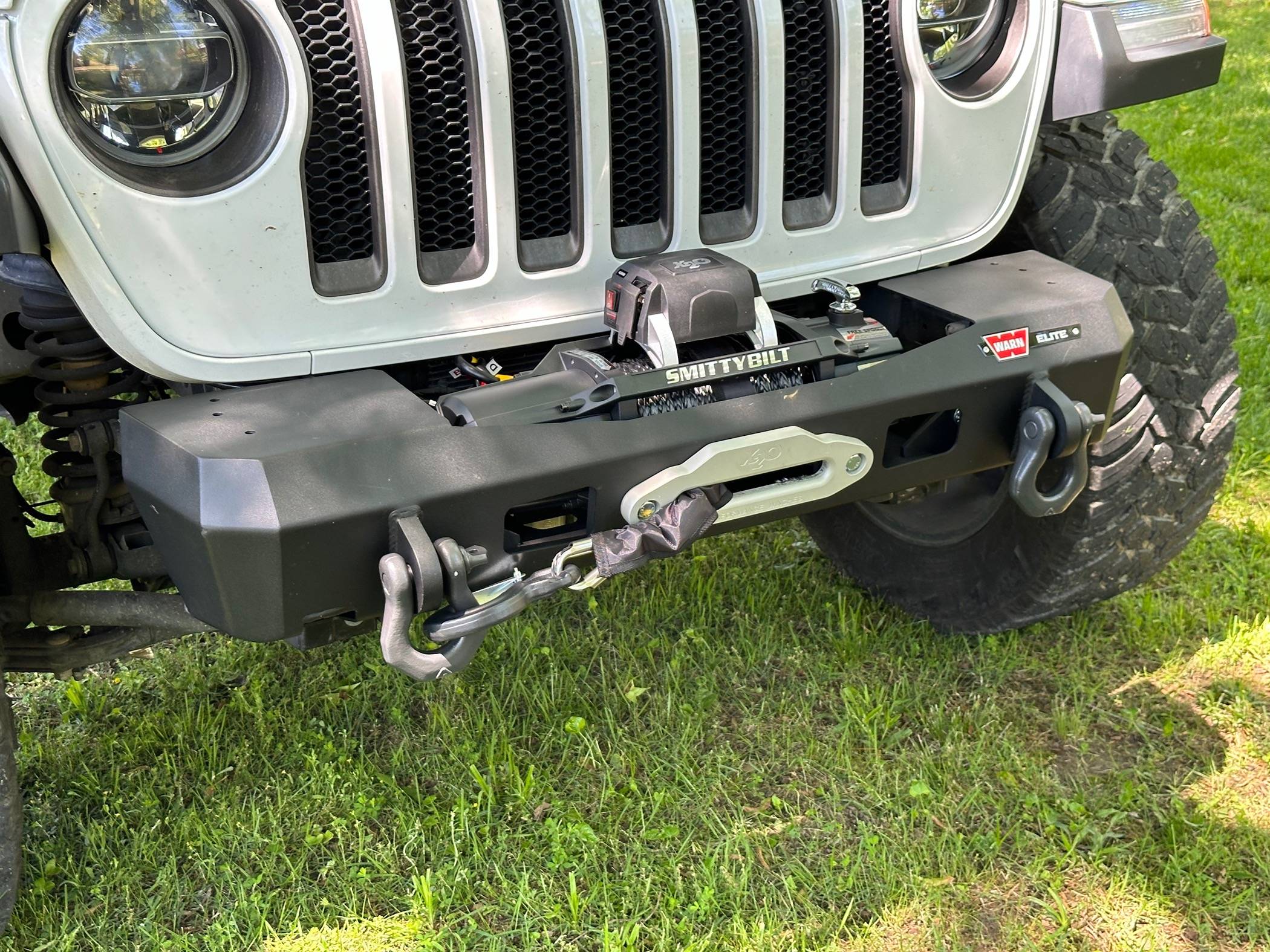

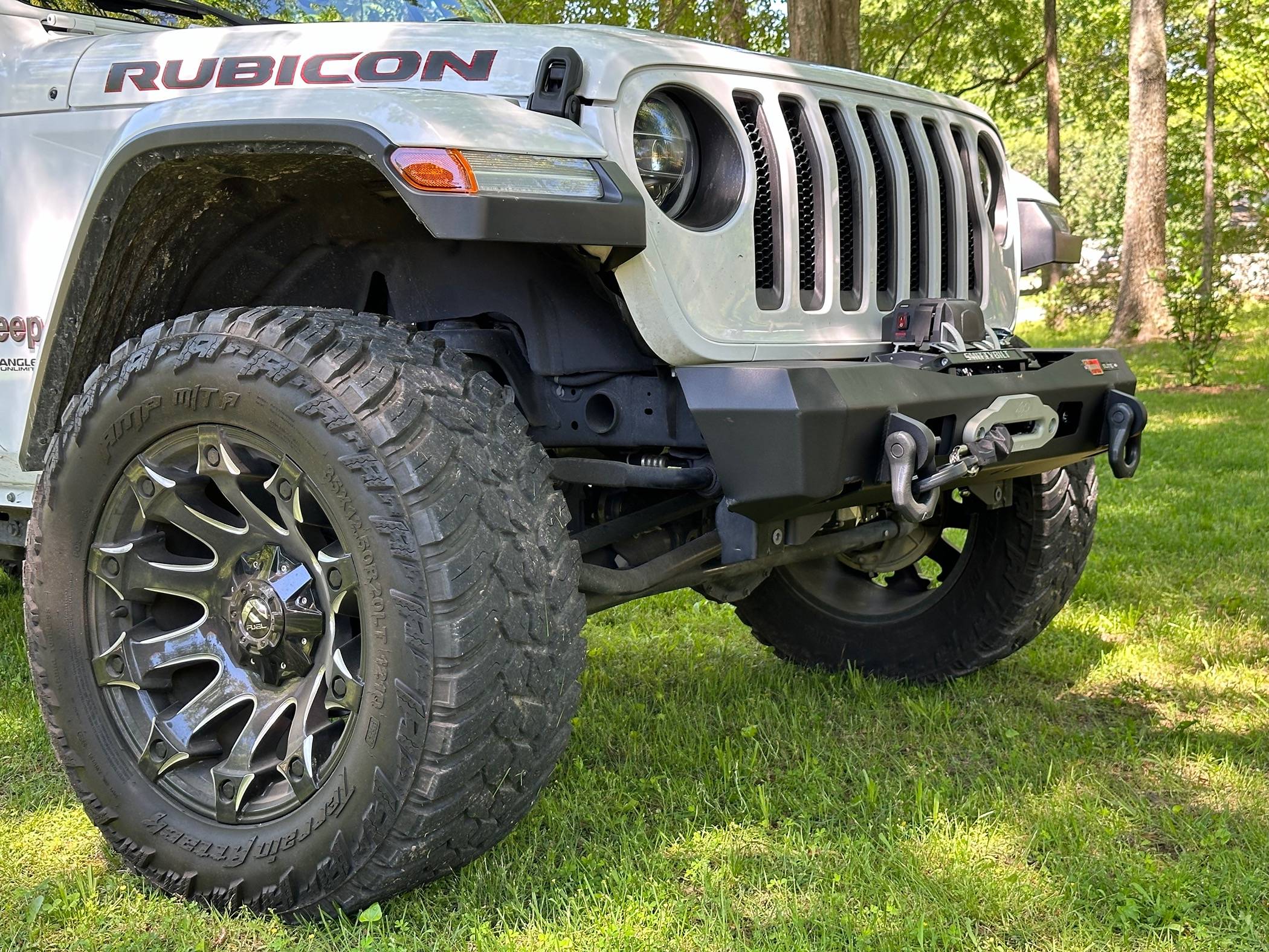

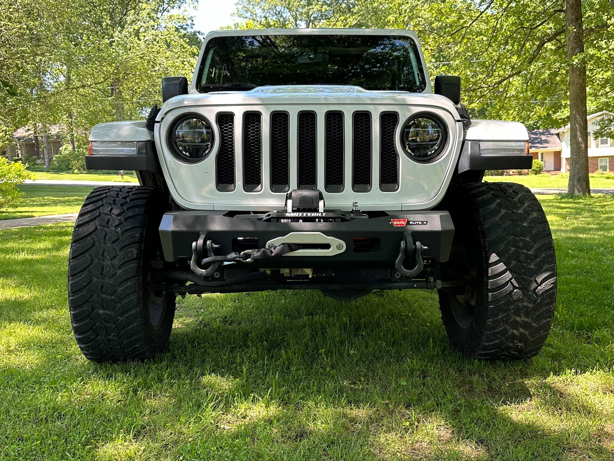

Warn stubby elite bumper added. This is my fourth vehicle with a smittybilt x20 10,000 lb winch. Never had a problem with them, and less than half the cost for a similar warn winch.
