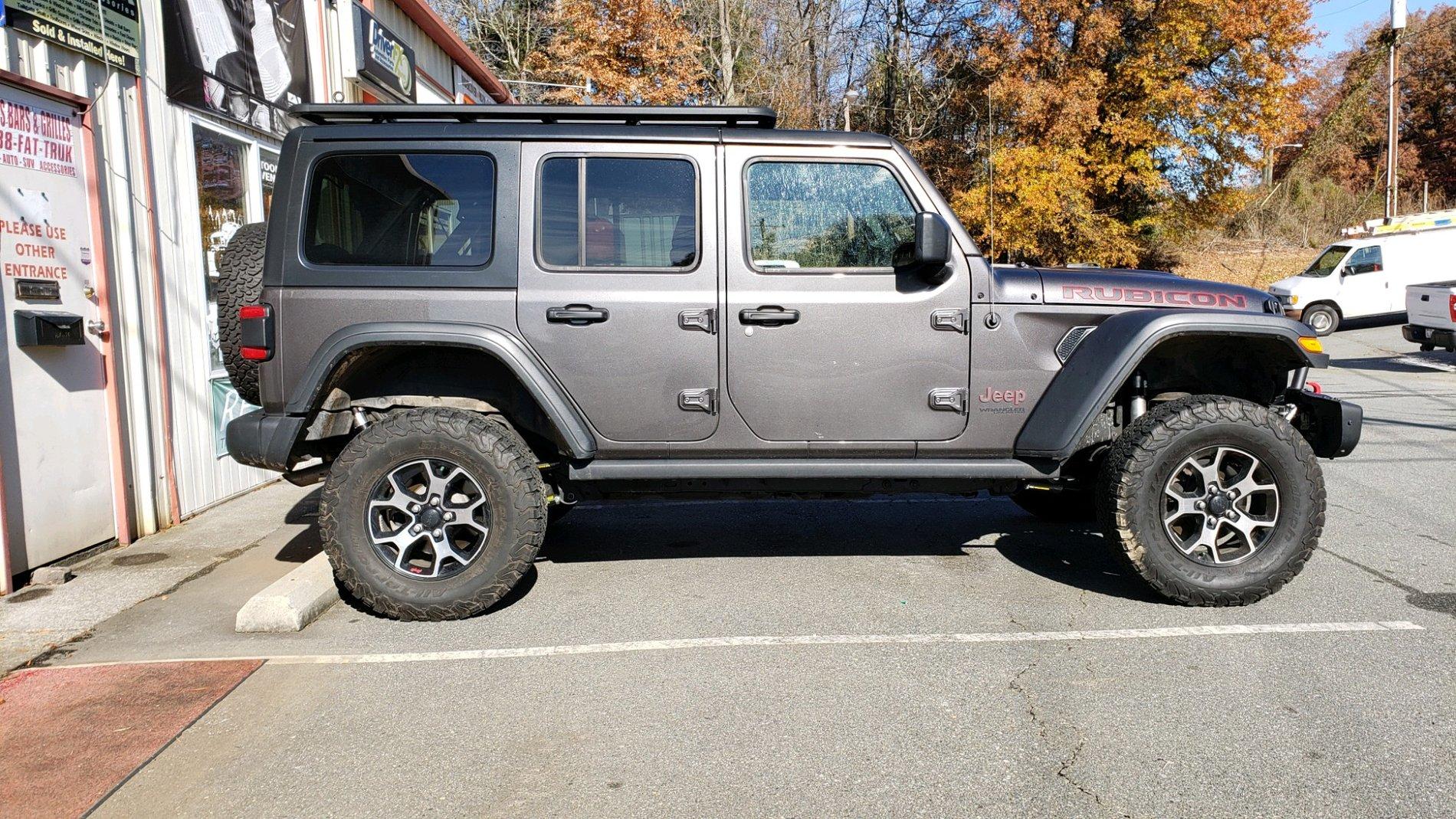

Pre tires

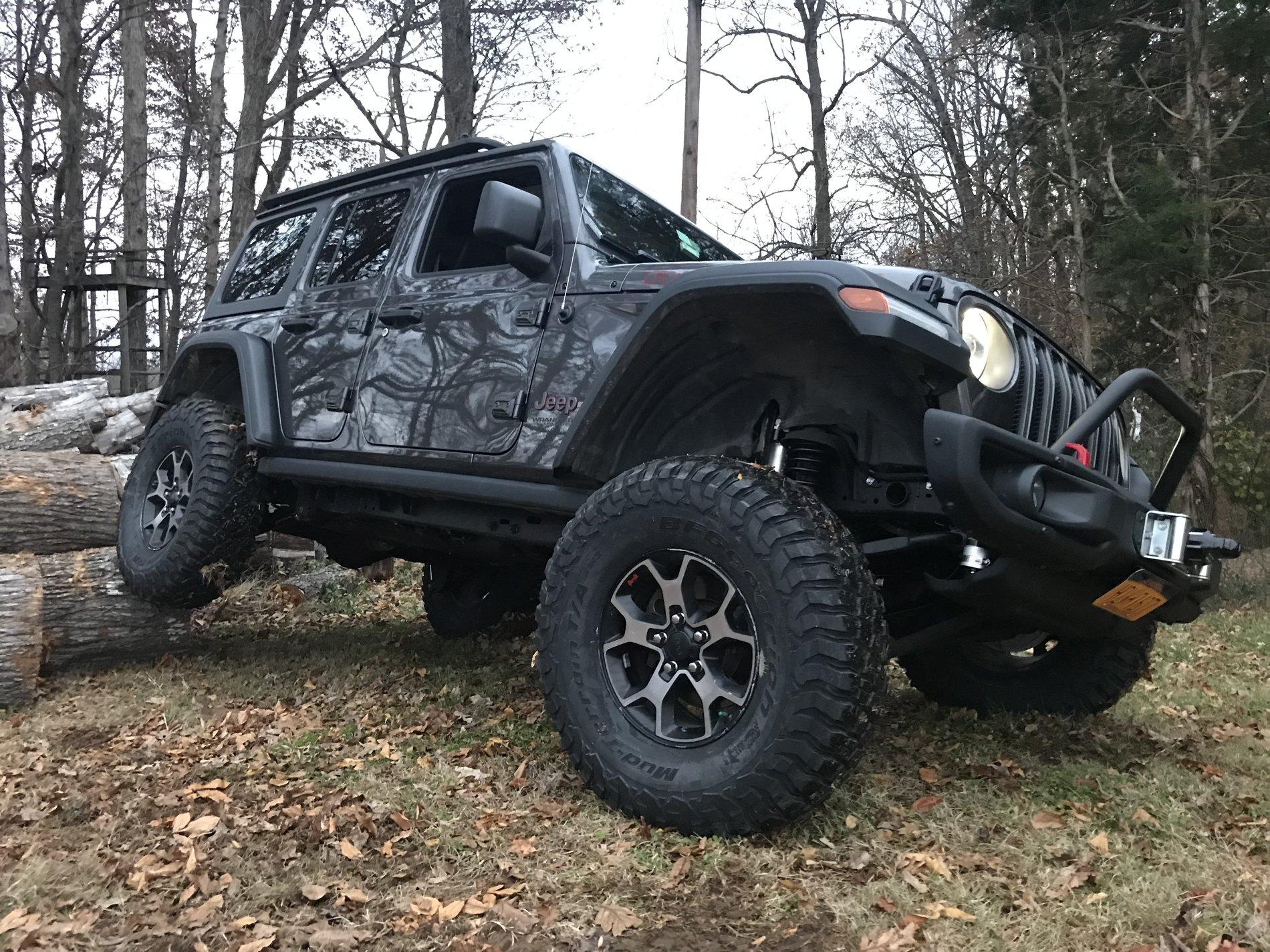

Post tires with a little flex

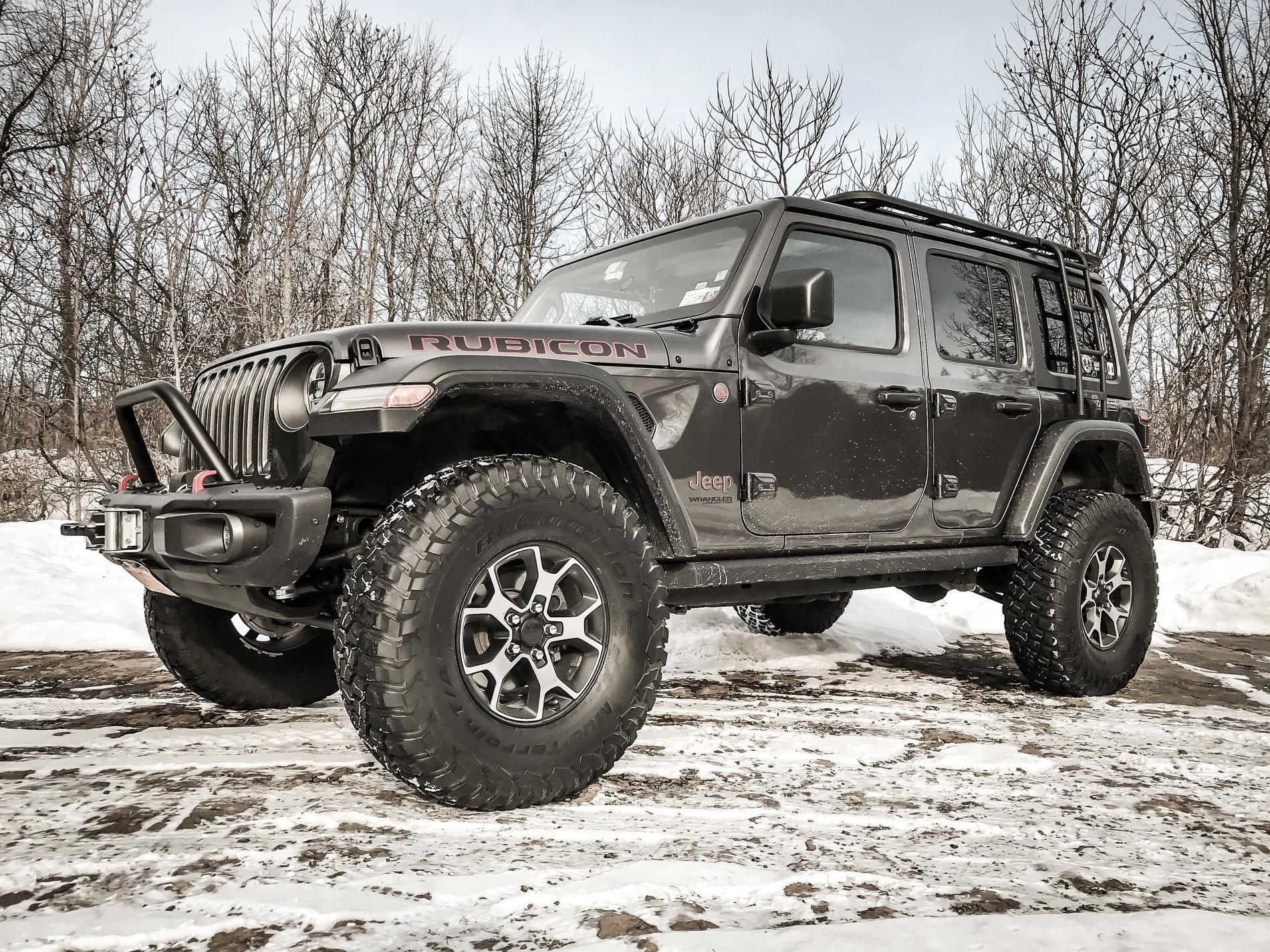

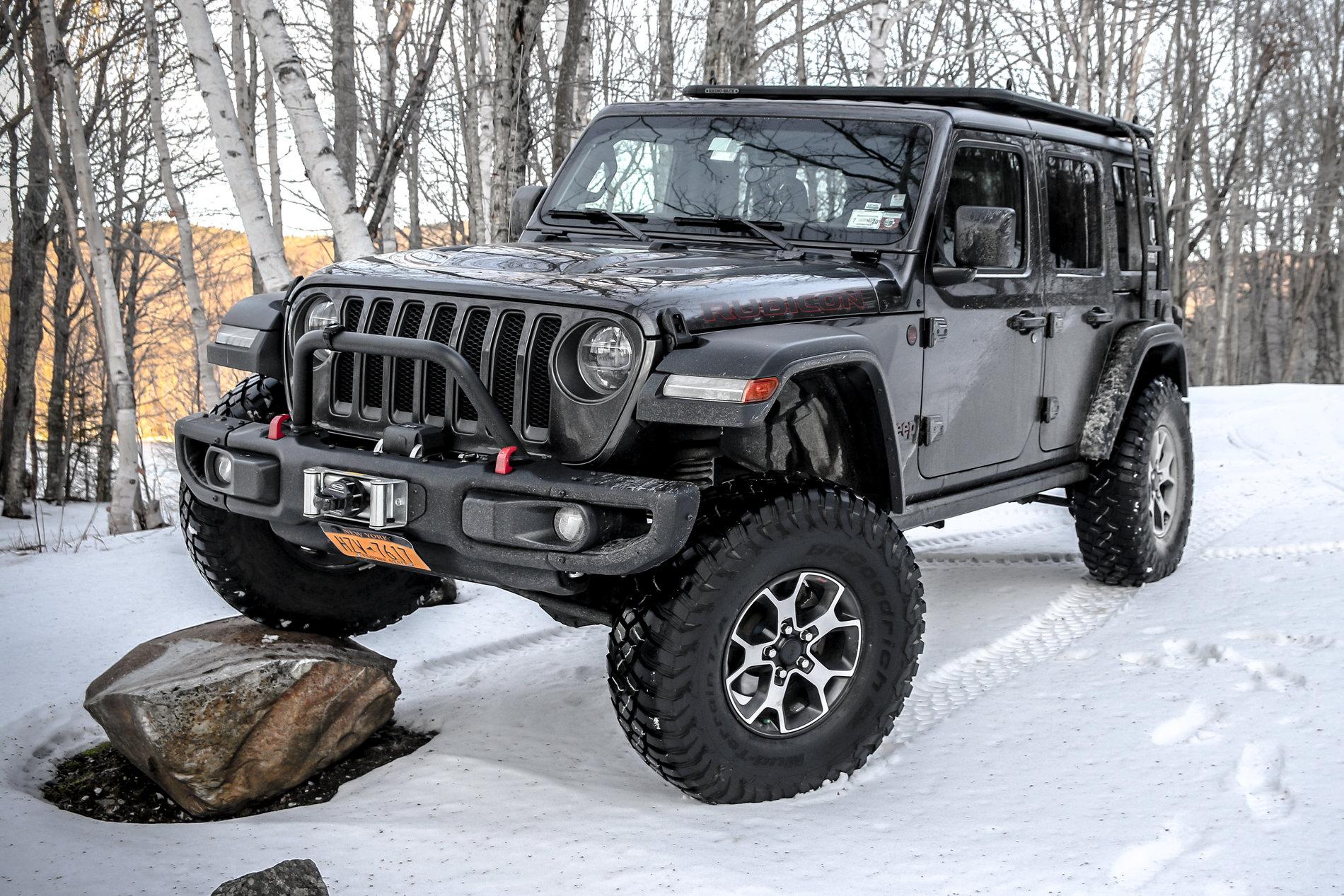

A little upstate NY snow fun. Had a light day in the OR, so hit the hills and snowshoed for a couple hours. Light was nice for some shots of ol' Coal Fire.

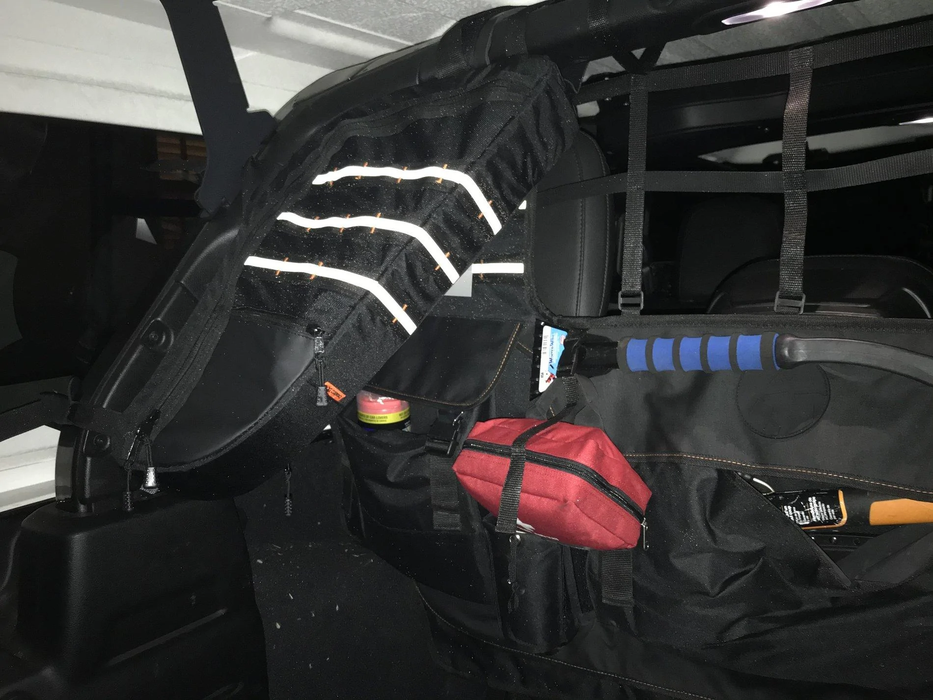

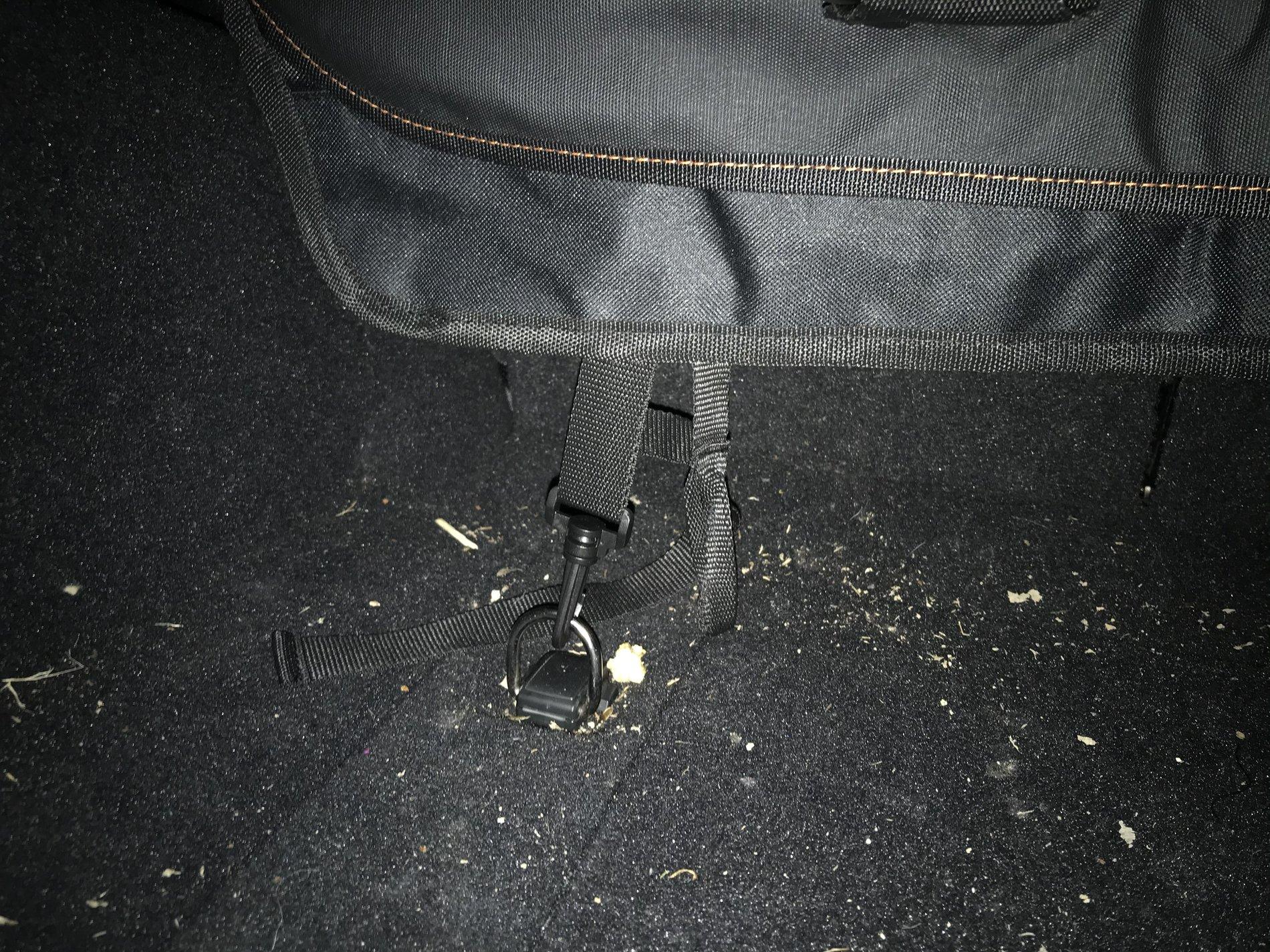

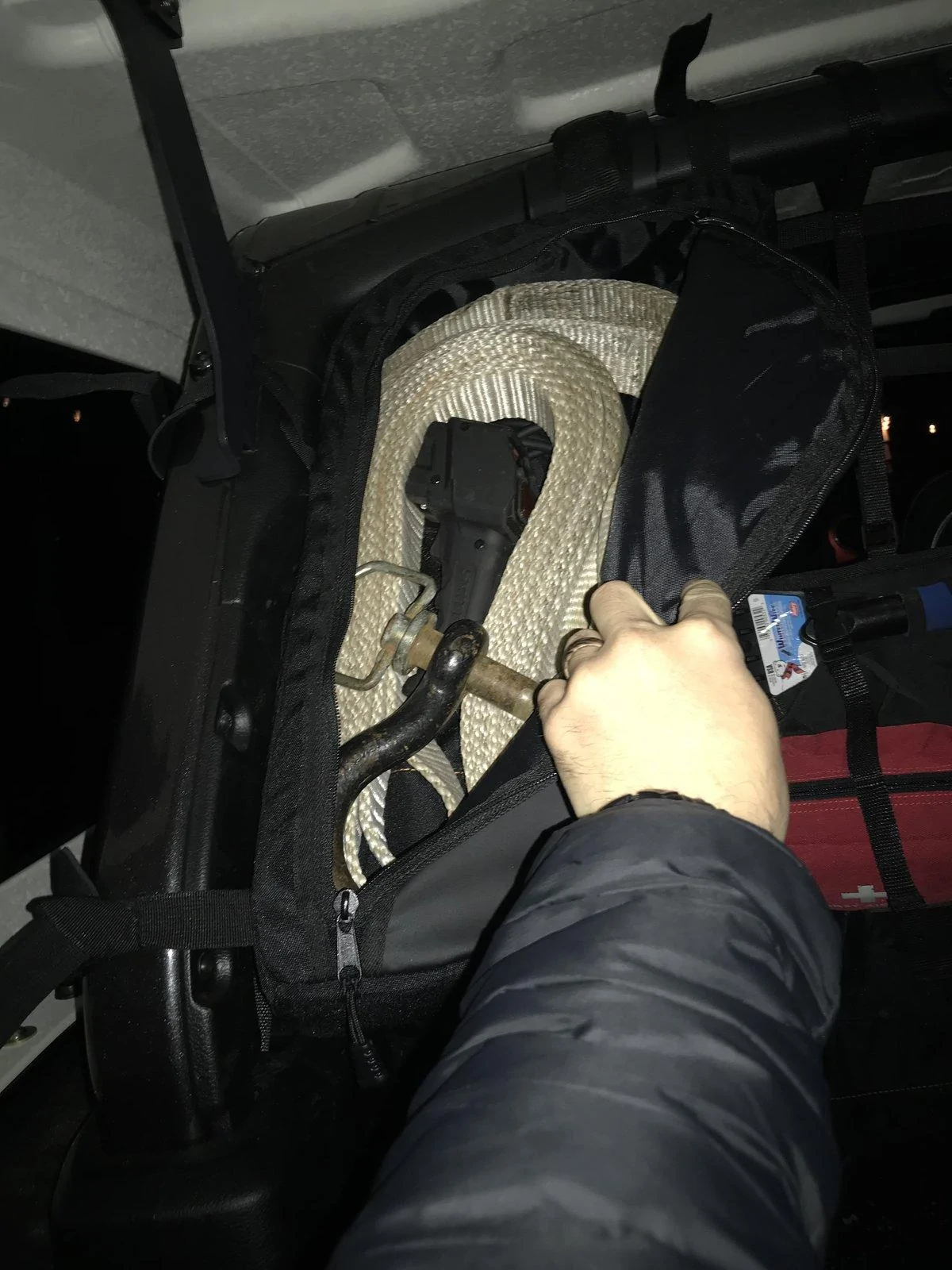

XG Cargo's sportsman behind the back seat storage is a great addition. Have my recovery and winch gear in the driver’s magellan pack, raingear in the passenger’s, first aid kit + hachet/machete + odds and ends in the seat back packs.
Very high quality, solid clasps and materials, fits great, nice tie downs. Also easy to fit around my maximus-3 roof rack mount.
