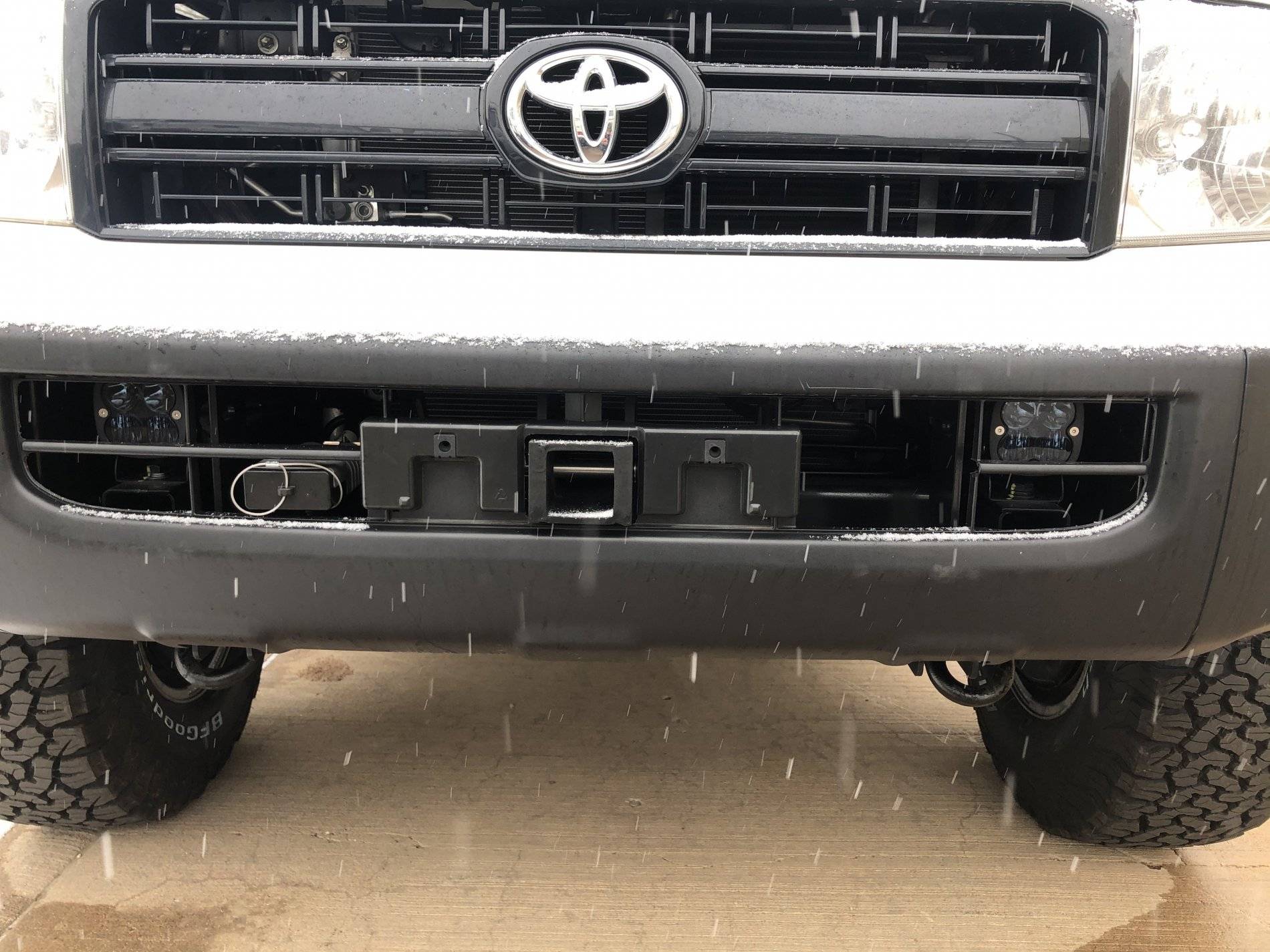

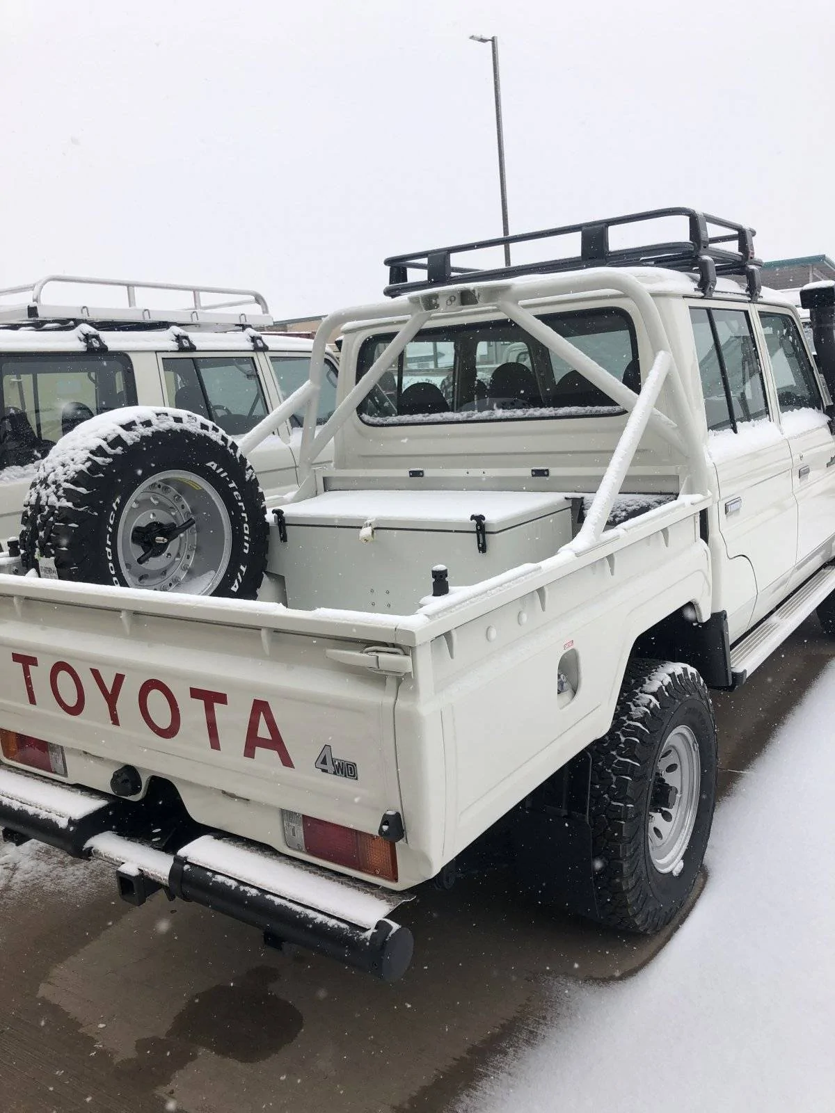

Like I said work got busy, headed up to Montana for some cold weather training as the parts started trickling in, oh and got some cool new rides in at work to start playing around with:
Jeep Wrangler JL CO Ketchup Build IMG_2448

Those are some nicely built Toyotas...and that doesn't look like work at all!
-Steven

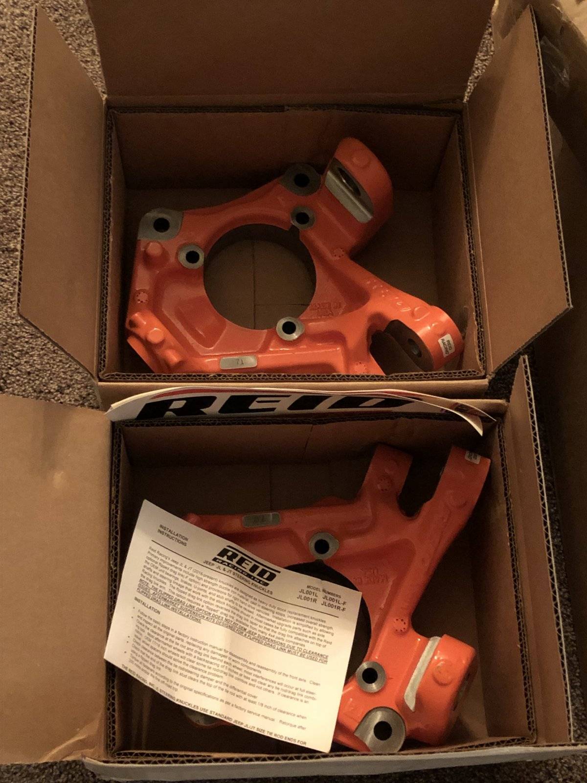

Every step of this build has had some sort of zinger attached to it....including the parts that started showing up.
Here's two different dana spicer chromoly shafts that showed up, some of the splines were damaged....I ended up calling Northridge for replacements and discussed the packaging issues. They were being drop shipped straight from Dana Spicer. I was impressed with how great Northridge handled the returns and treated me throughout the process, I have nothing but positive things to say about them!
Jeep Wrangler JL CO Ketchup Build IMG_2672

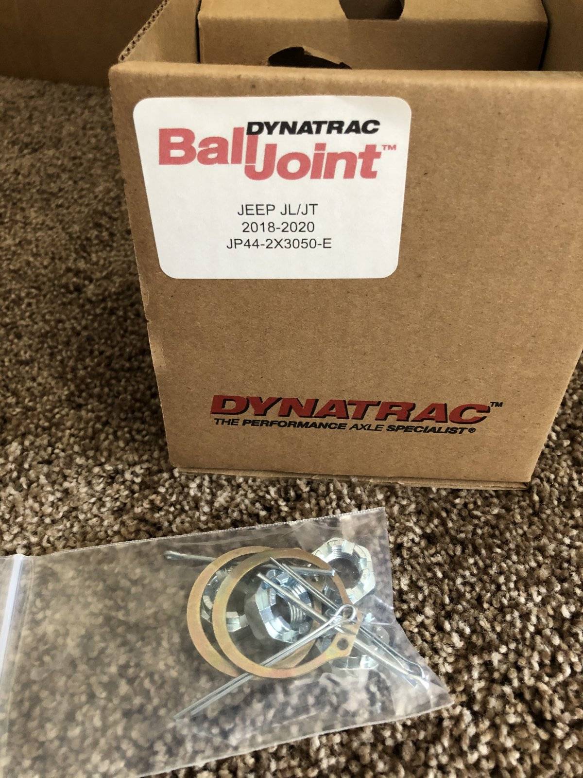

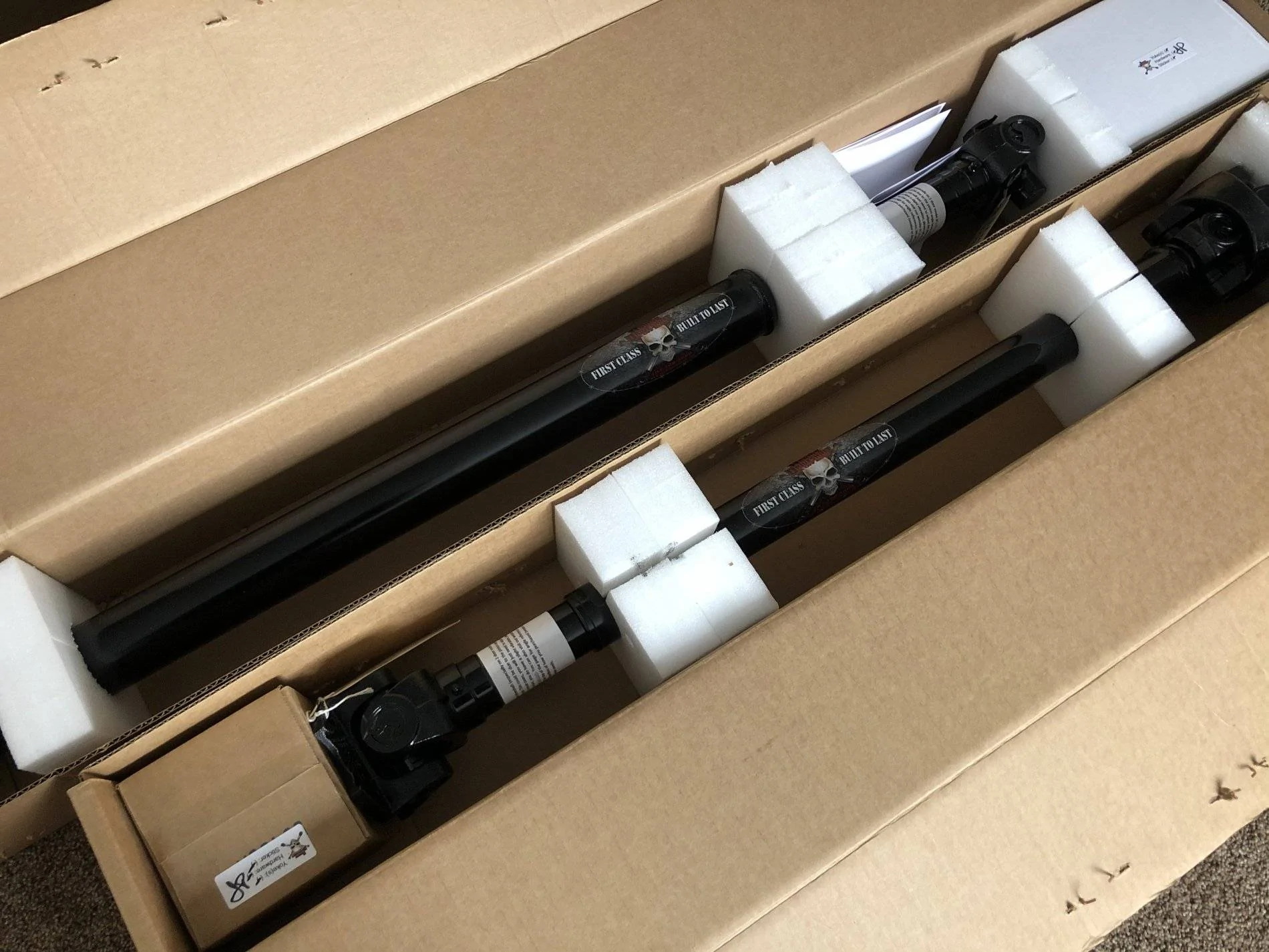

More parts:
Dynatrac HD Ball joints
Reid Knuckles
Adams F/R driveshafts with 1350s
Jeep Wrangler JL CO Ketchup Build IMG_2608
Jeep Wrangler JL CO Ketchup Build IMG_2876
Jeep Wrangler JL CO Ketchup Build IMG_2914

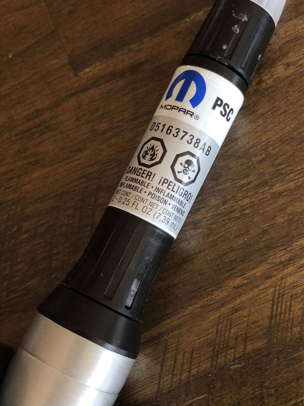

Also picked up this paint pen at the dealer for all the holes I'll be drilling for the Nemesis rocker armor, and Artec inner fender liners:

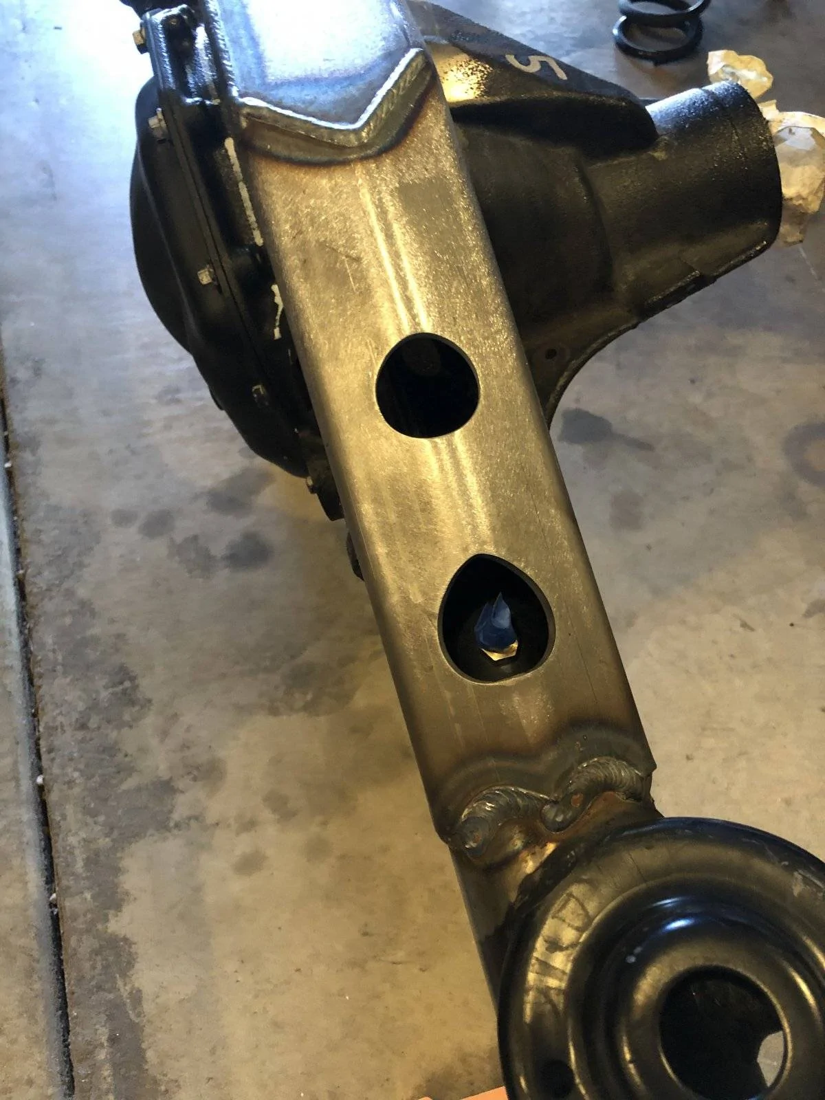

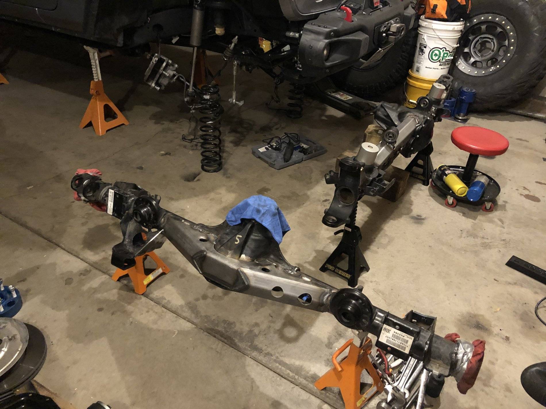

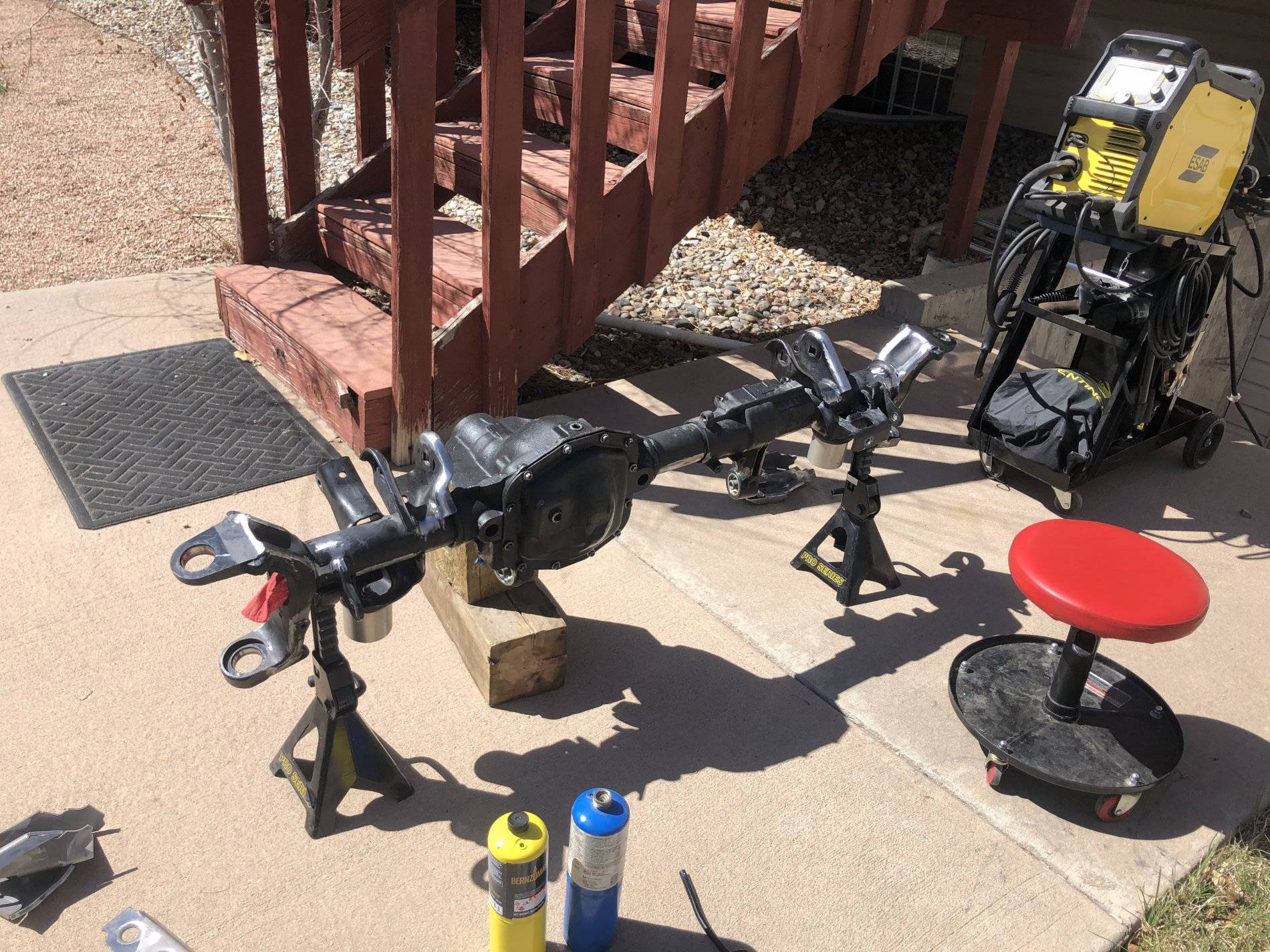

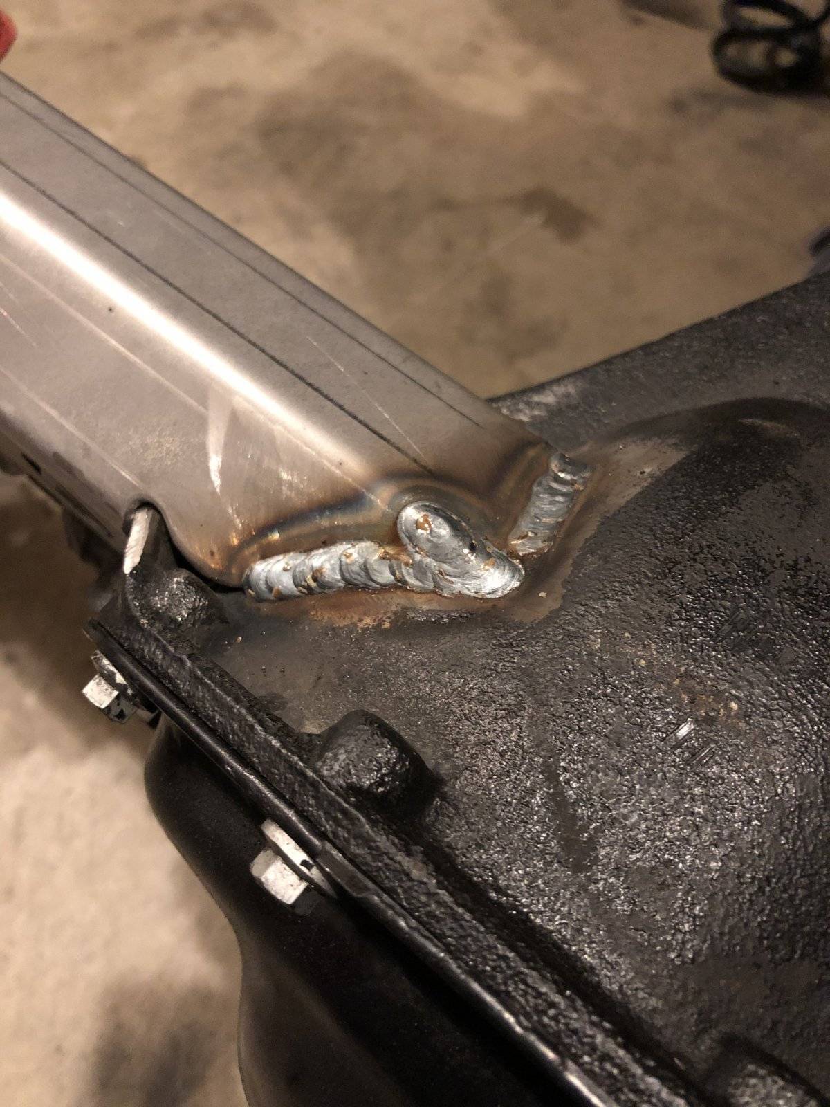

Started mocking up the Artec trusses and didn't like how the locker harness routed with the truss in the way so drilled out a 1-1/2in hole for it to snake thru. Took care of the 1/8th pieces in the garage but had to lug all my shit around back to slave off the dryer 220 outlet to do the 3/16in and 1/4in stuff....so of course the wind showed up lol. The new house I'm living in doesn't have 220 in the garage which has become a real pain in the ass. I either lug my junk over to a friends house or around back haha. Anyway, got everything trussed up and started dropping the 4.88 gears in:
Jeep Wrangler JL CO Ketchup Build IMG_2903
Jeep Wrangler JL CO Ketchup Build IMG_2949
Jeep Wrangler JL CO Ketchup Build IMG_2955
Jeep Wrangler JL CO Ketchup Build IMG_2946
Jeep Wrangler JL CO Ketchup Build IMG_2957
I forgot how to weld thin metal but it'll hold. Hit the cast steel parts and got up to temp with some MAPP gas before and after welding then continued to manage temps for another hour. I only heard one "ting" so good right?? ;)
Jeep Wrangler JL CO Ketchup Build IMG_2958

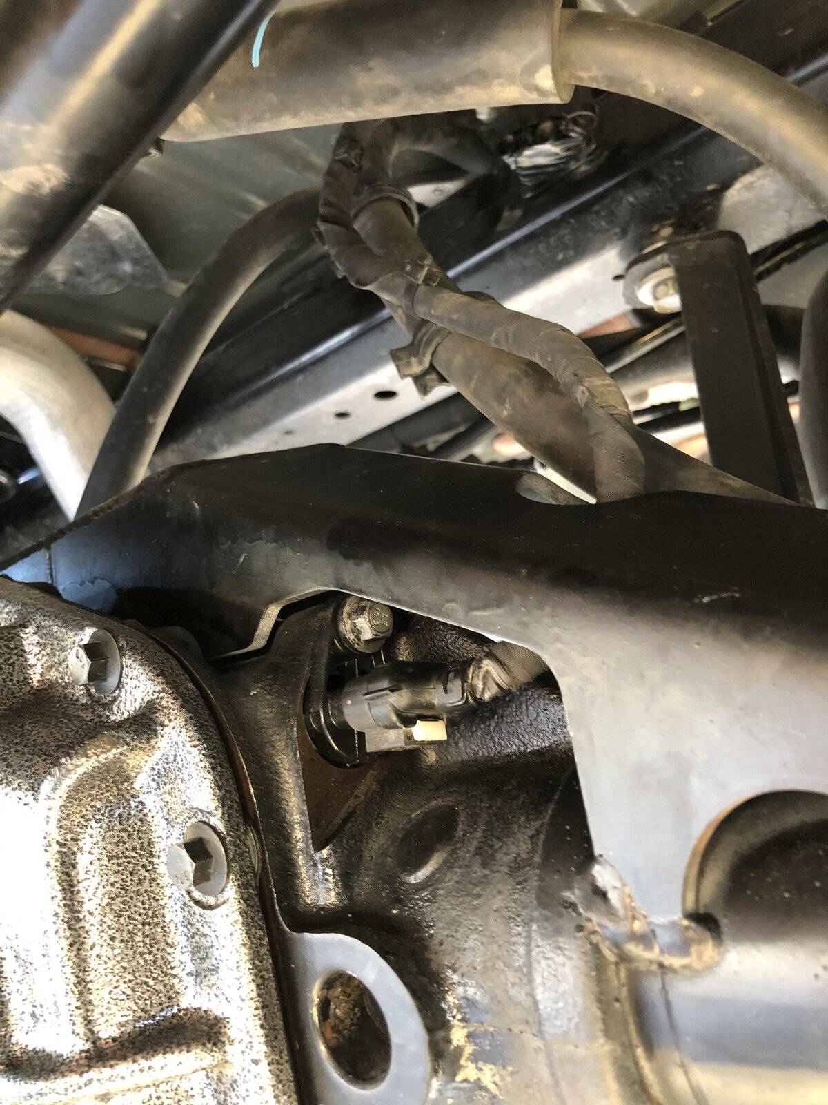

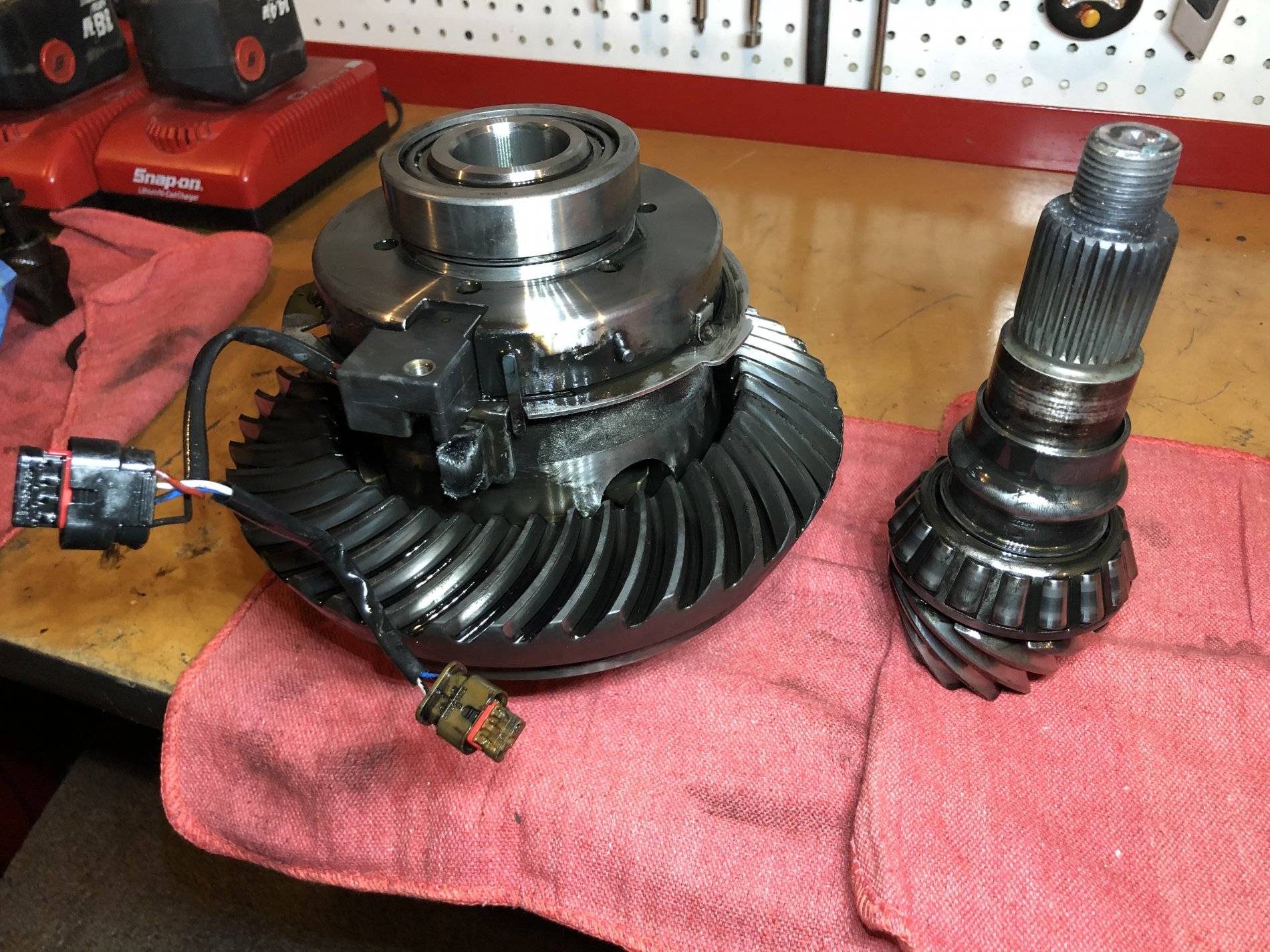

Out with the 4.10s:
Jeep Wrangler JL CO Ketchup Build IMG_2908

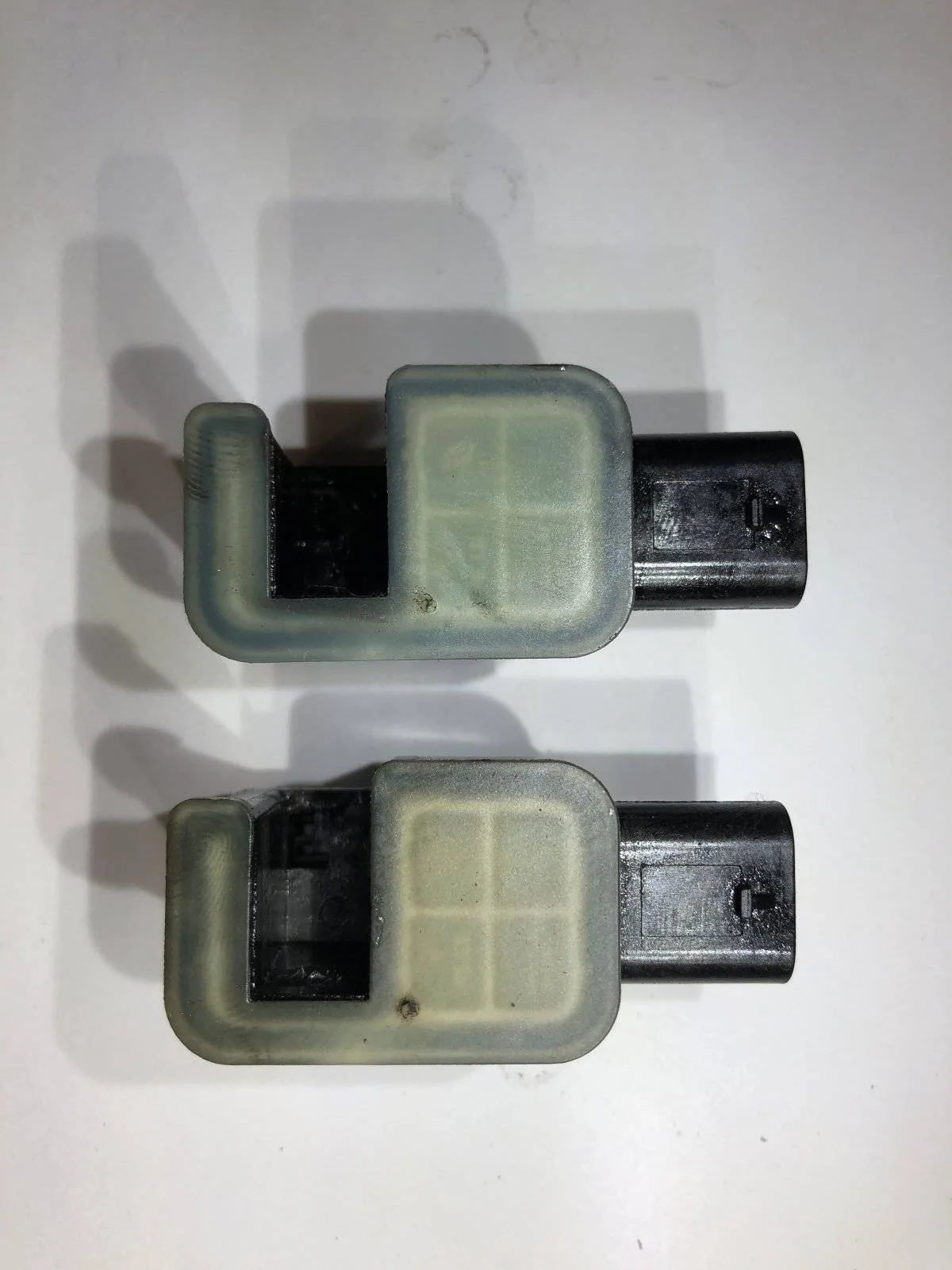

With 7k on the odometer both sensors still checked out but I potted them anyway, big thank you to @chevymitchell for the step-by-step thread!
Jeep Wrangler JL CO Ketchup Build IMG_2937

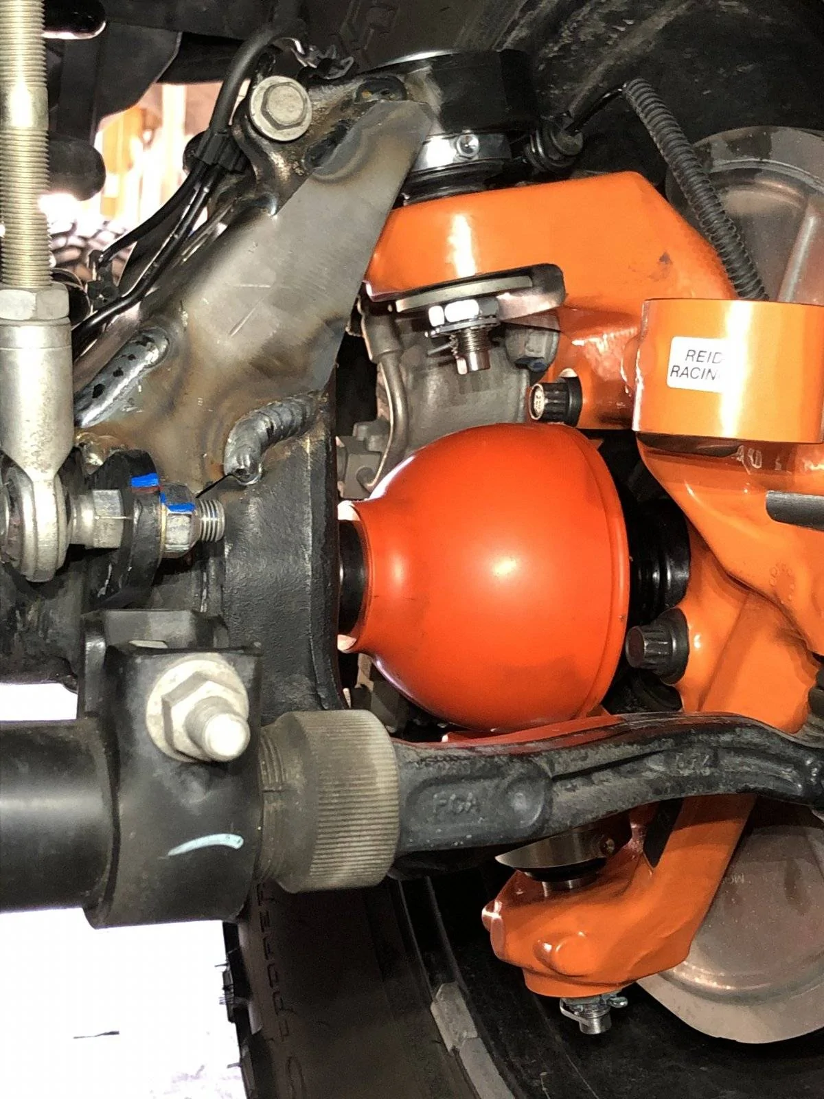

Installed the JL/JT Johnny Joint Housing Kit while I was at it, threw the Reid Knuckles on and stuffed RCVs in the front once I got the gears in:
Jeep Wrangler JL CO Ketchup Build IMG_2968
And thats how it sits right now, still have to regear the rear and then slide the axle back under the rig and it should be good to go....and paint the front with a brush most likely, it was too windy to do any of that outside so I ended up just installing it to make more room in the garage.
rohdawg
Sep 18, 2018
2,318
7,475
Long Island, New York
Merchant Marine
Love seeing a well thought out build come together.
Only one ping sounds like success to me.

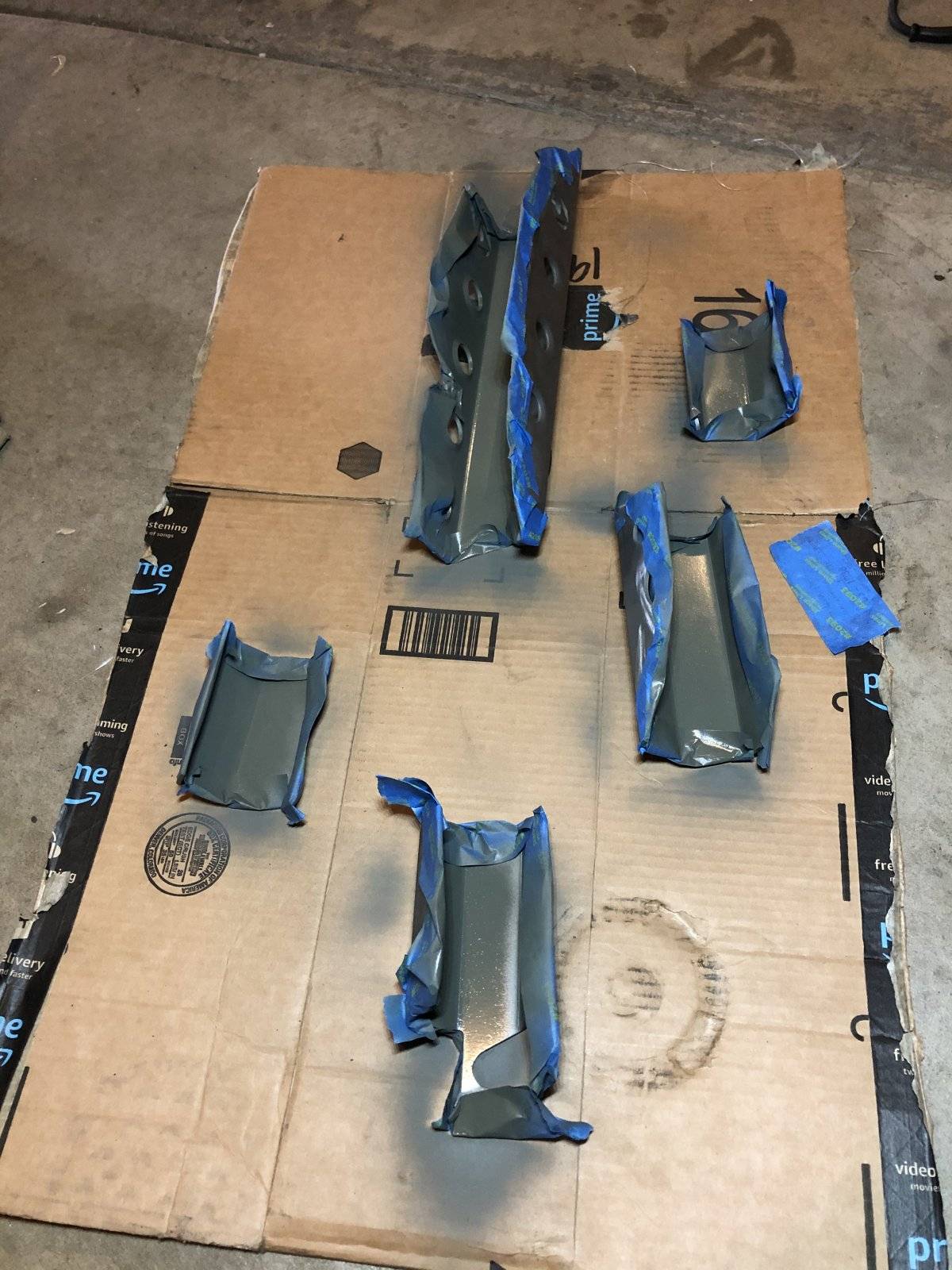

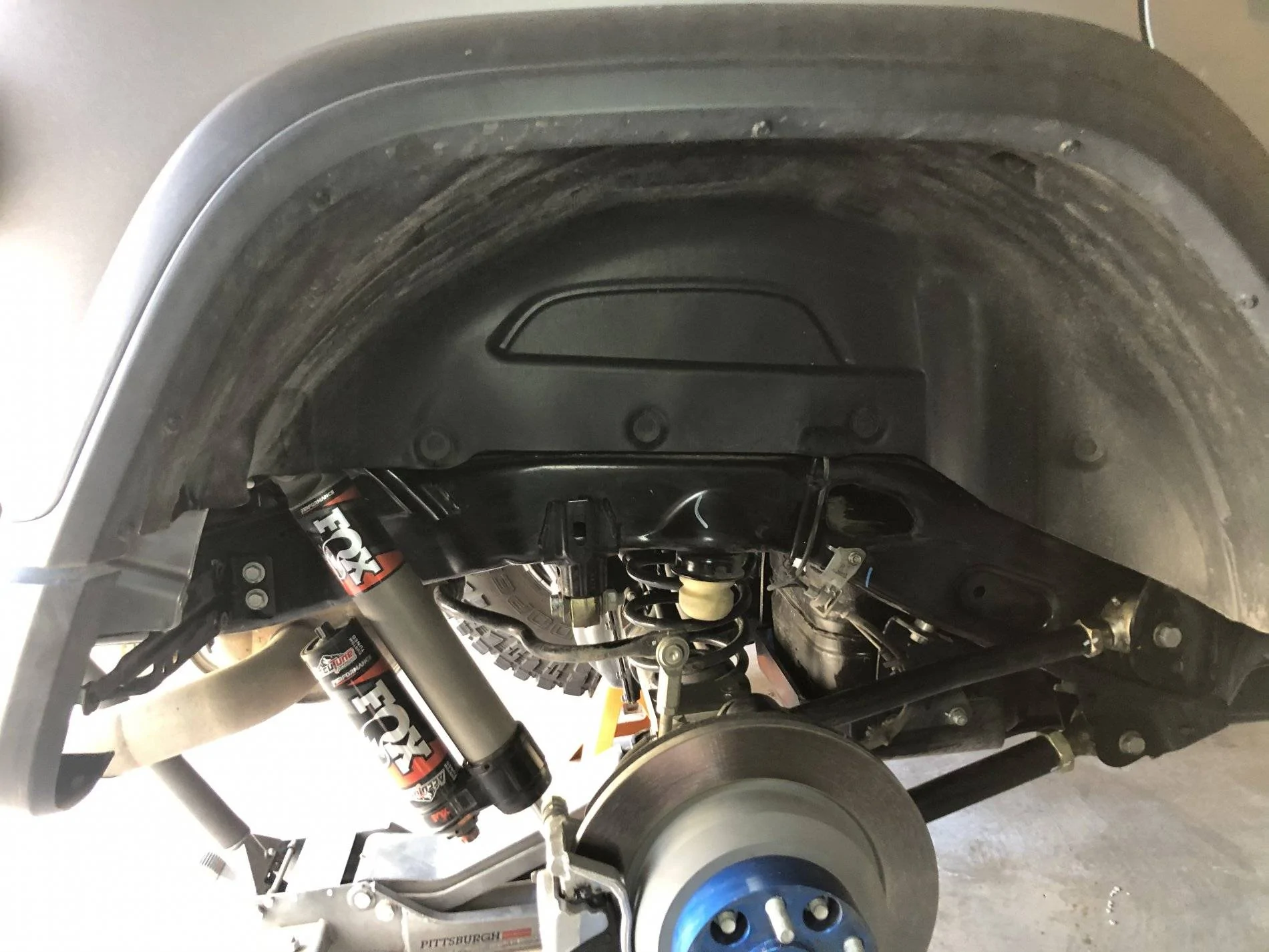

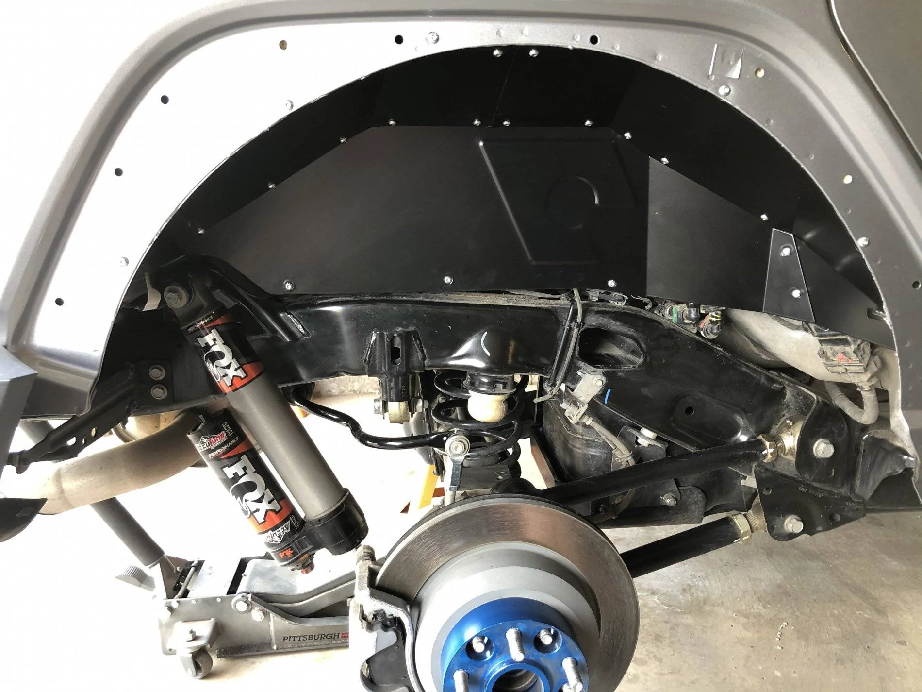

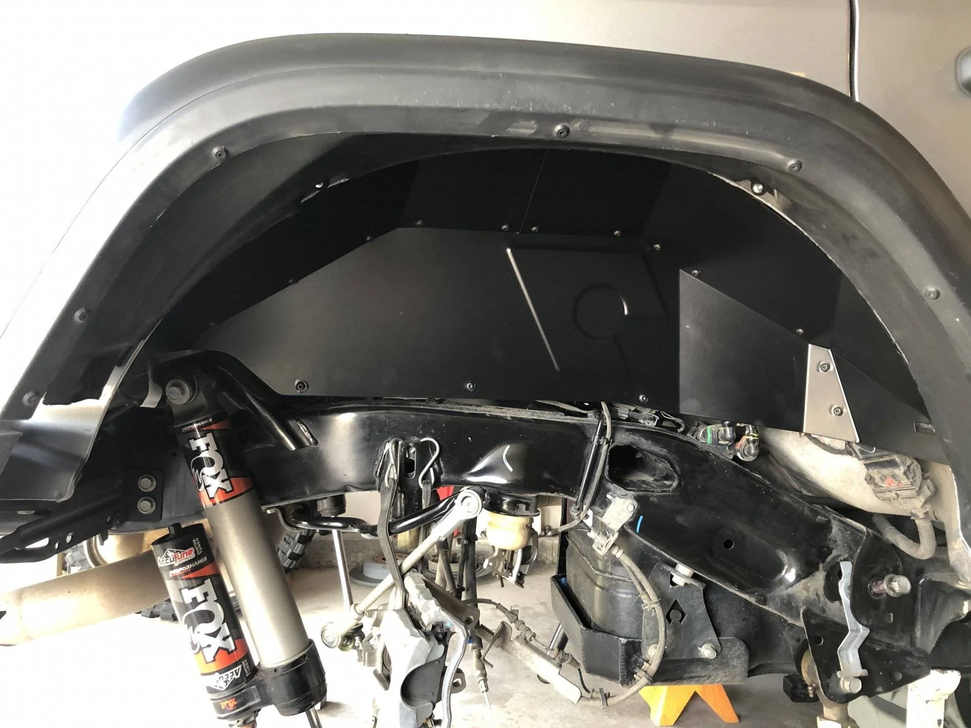

Installed the rear Artec inner fender liners due to some rubbing from the 37s. Got em powder-coated black and changed out the hardware for black fasteners. Tried to keep as much stock fender liner as I could but made a mistake and trimmed down too much on the passenger side so I pinched the fender to the body with washers, we'll see if it holds! And those white plastic clips? They all disintegrated during removal so I ordered packs of 8 thru justforjeeps.com.
Part Number: 68526185AA
Jeep Wrangler JL CO Ketchup Build IMG_2896
Jeep Wrangler JL CO Ketchup Build IMG_2898
Jeep Wrangler JL CO Ketchup Build IMG_2969

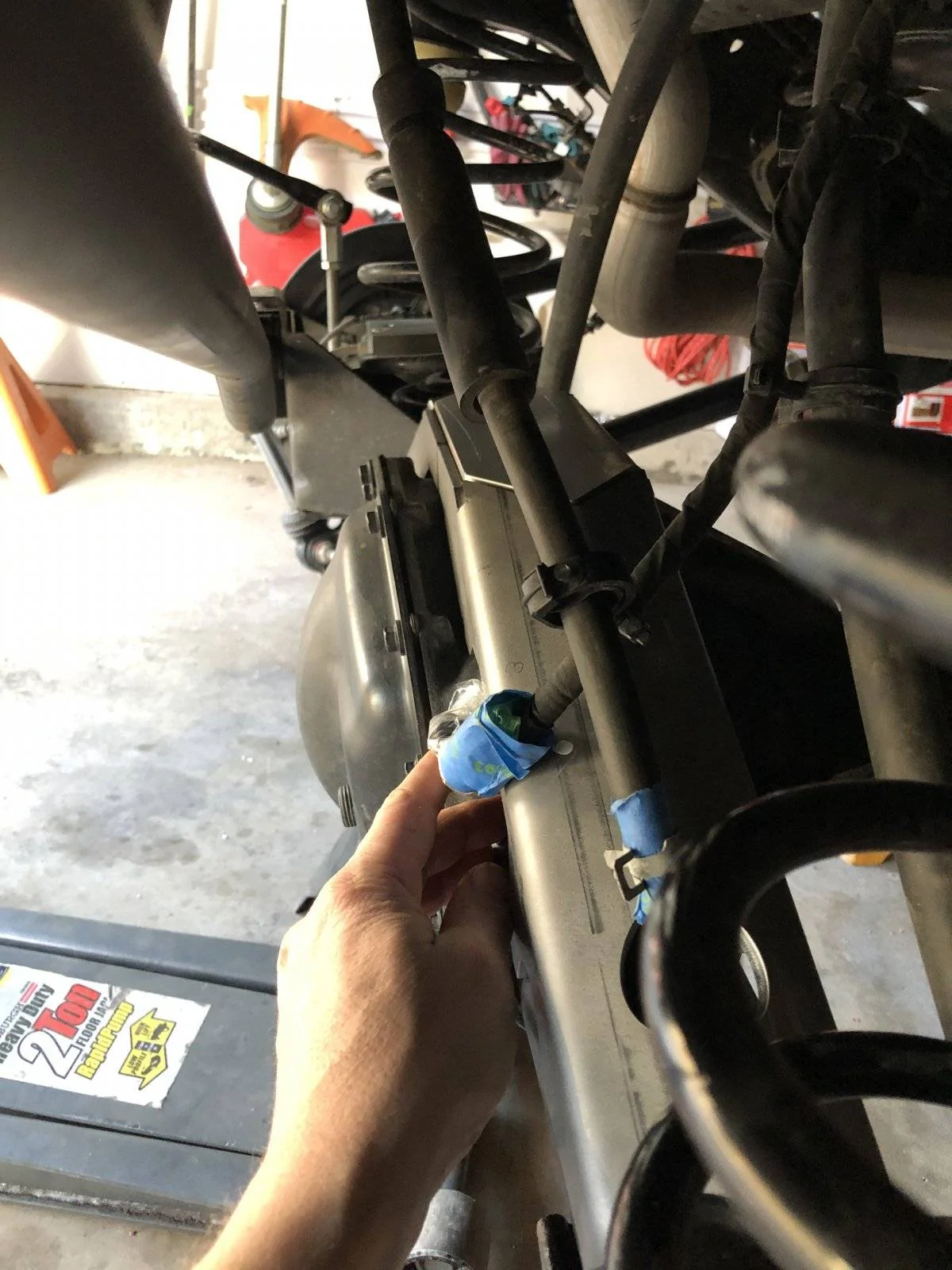

Got everything buttoned up and been driving around enjoying the 4.88s for the past 2 weeks. Shift points feel stock again and I’ve been seeing 8th gear on a regular basis. Really like how the rear locker line routing turned out all tucked in and protected now.

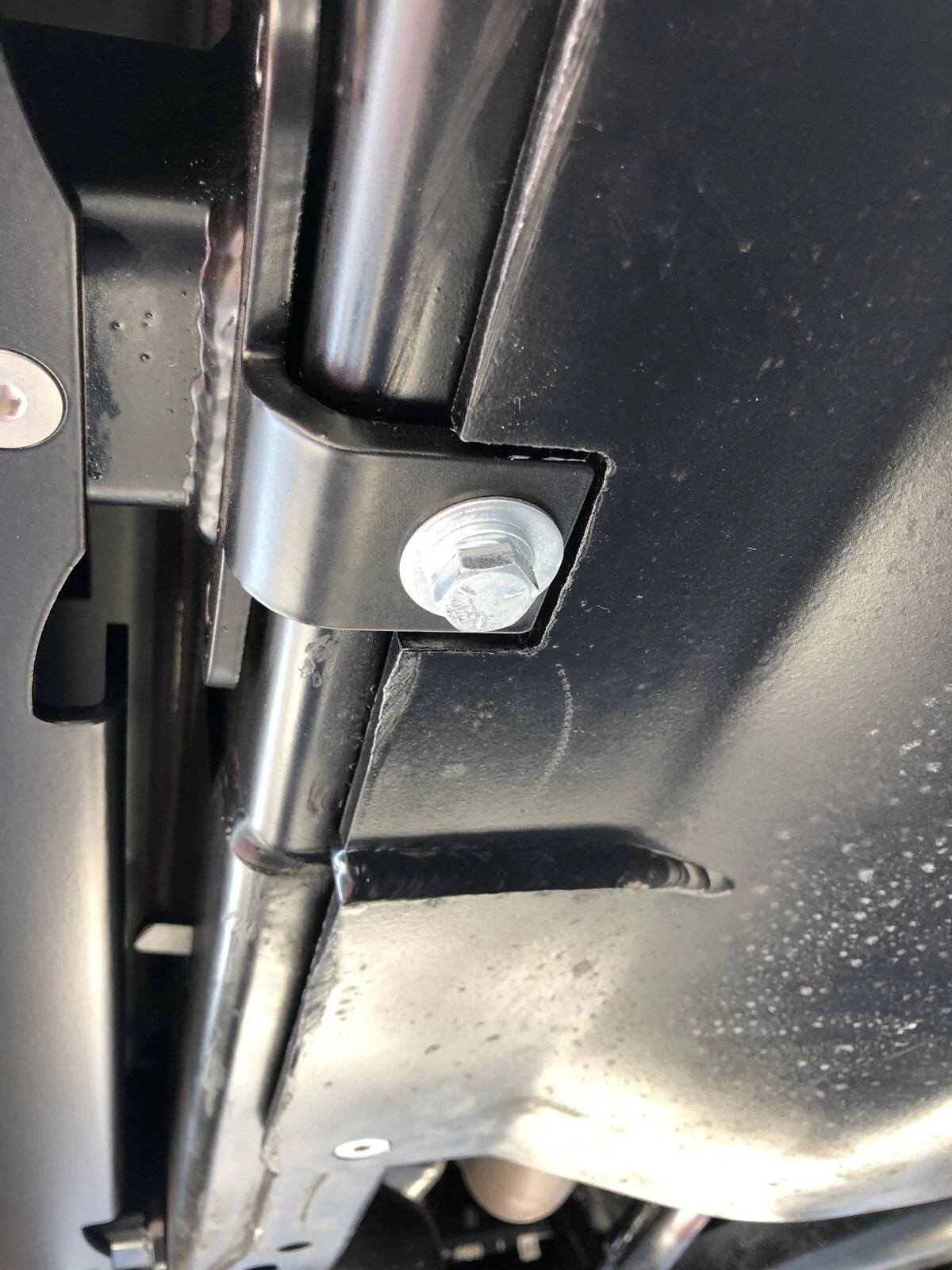

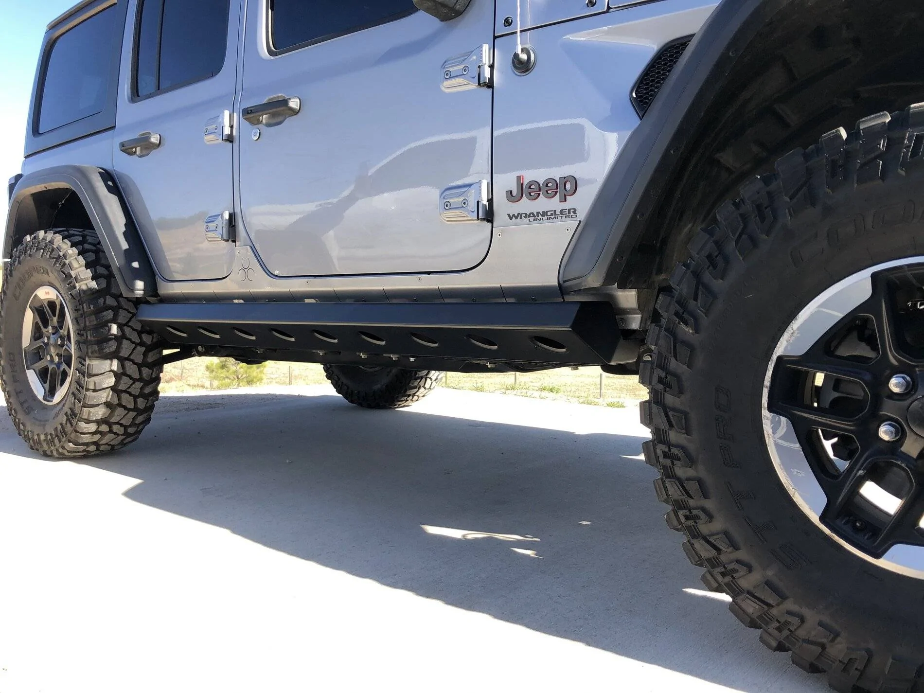

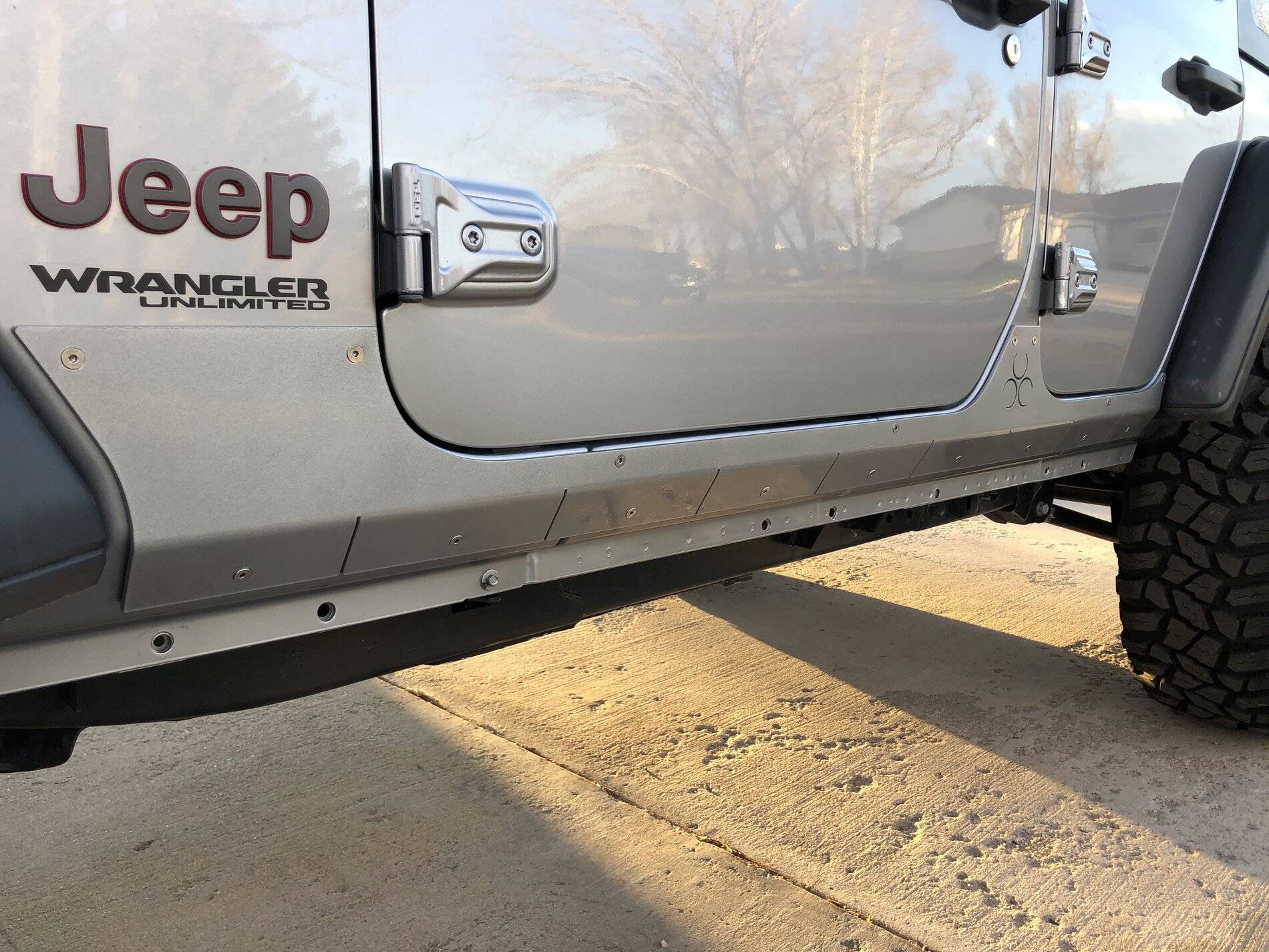

Installed the Nemesis Aluminum Titan Tub armor which I got powder coated to match the factory paint and then installed the Nemesis Billy Rockers. I ended up notching the Artec Aluminum Belly Skid in 1 spot on the driver side but already knew this was needed during the install when I drove the Jeep up to the Nemesis shop and test fitted a set back in November. The Billy Rockers rely on 3/8 rivnuts to secure to the frame rails. I was off drilling a couple holes so plan to run two 1 inch welds on the front and mid support of the subframe in the near future.
Rear Locker routed thru truss:

Nemesis Titan Tub Armor and Billy Rocker:
Jeep Wrangler JL CO Ketchup Build FD5750D9-E895-41DB-A74F-44DC339D09F9
Jeep Wrangler JL CO Ketchup Build 32F46A9D-EDC9-4364-ACEA-9FCBD8F6B471

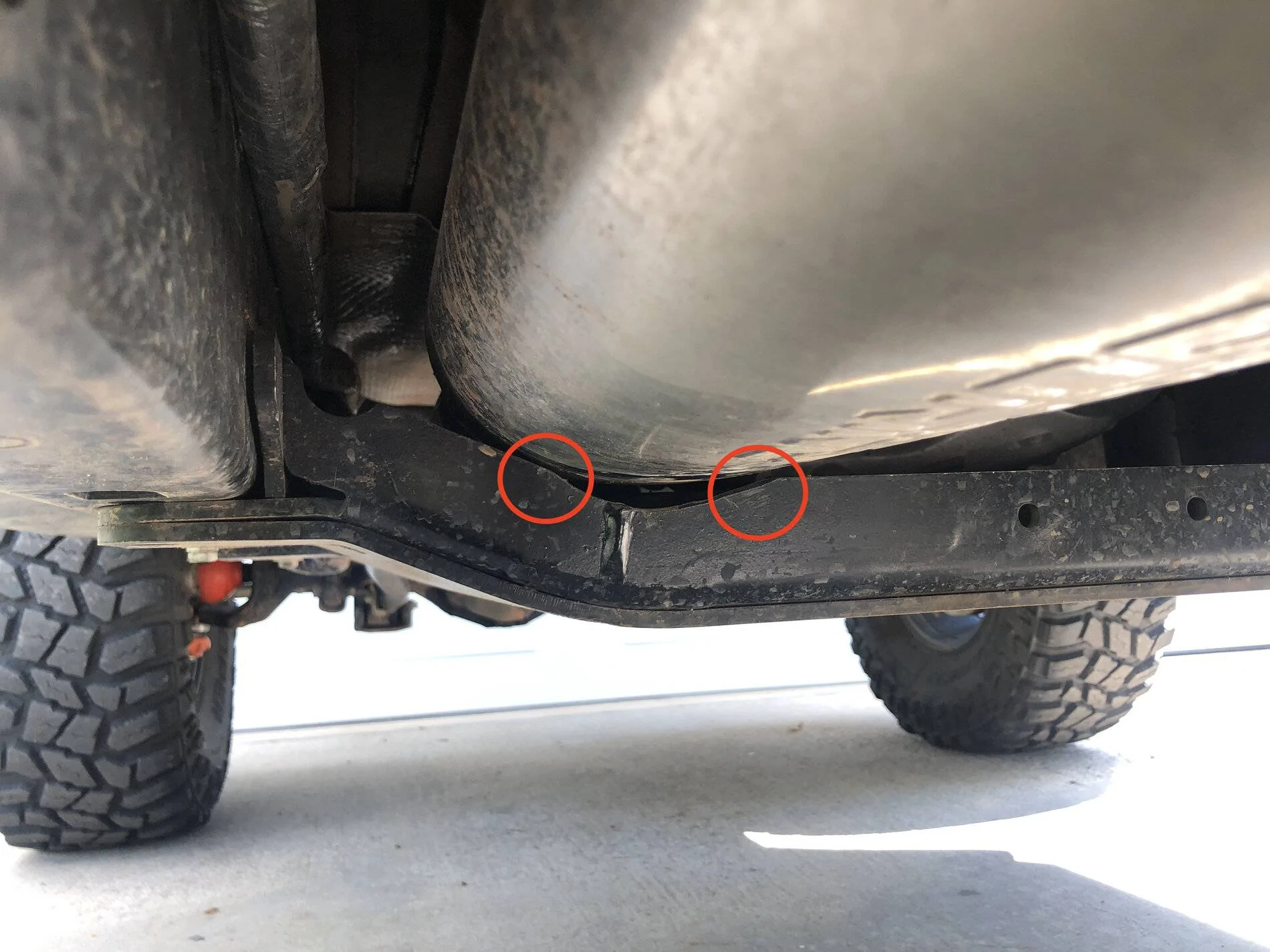

Artec Aluminum Belly Skid notched for Nemesis Billy Rocker on drivers side...I didn’t think there was enough material in that spot to counter sink the fastener for the Rocker but the more I look at it the more I think it might work. Doesn’t seem long to me before that bolt head snaps off:

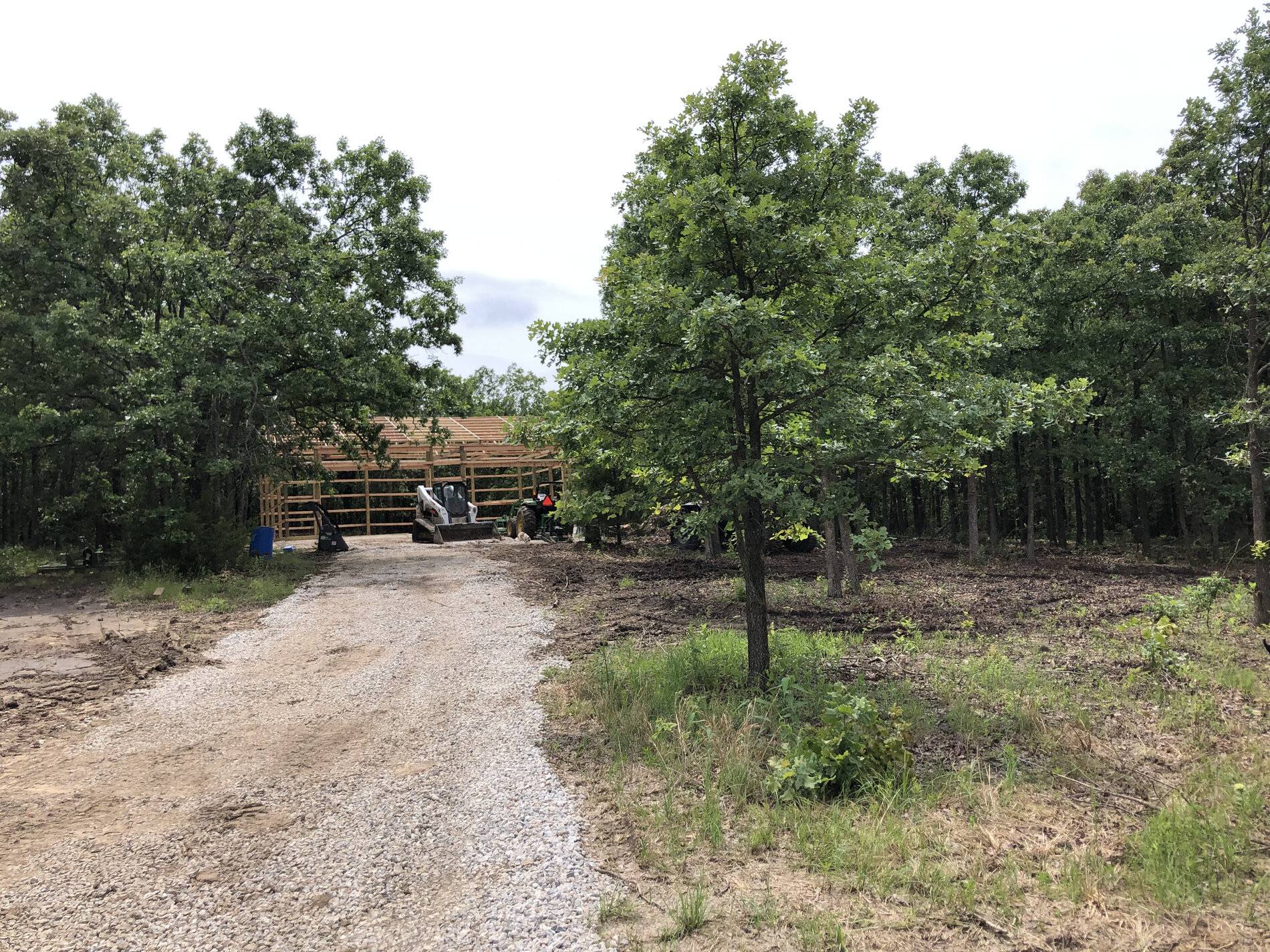

In between a few trips to Oklahoma to help one of my best friends clear out some of his land for future construction I managed to add a few upgrades to the steering and then hit some trails. Did a quickie in Moab before @SPR Pumpkin Rubi from Skinny Pedal Racing came out to Colorado. We ran Holy Cross and a few other trails together and was nice to wheel with another forum member and show him around while sharing build ideas and such.
Killing baby trees and building a tool shed for my friends heavy equipment in OK:

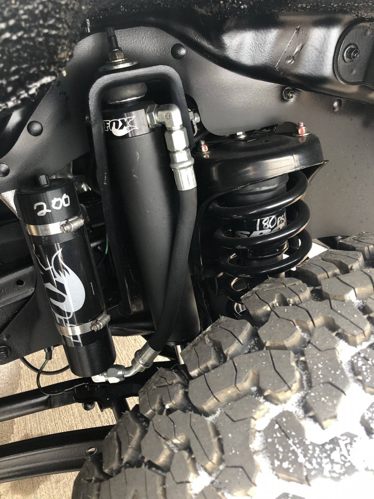

Went with the Doetsch Off-Road 2in aluminum tie rod and draglink kit. Ordered a Fox TS steering stabilizer and installed it during the tie rod install as well to get that thing up and out of the way. The stock draglink TRE didn't want to budge so when I have more time I'll pull the pitman arm and wack away at the stock TRE on the bench.
