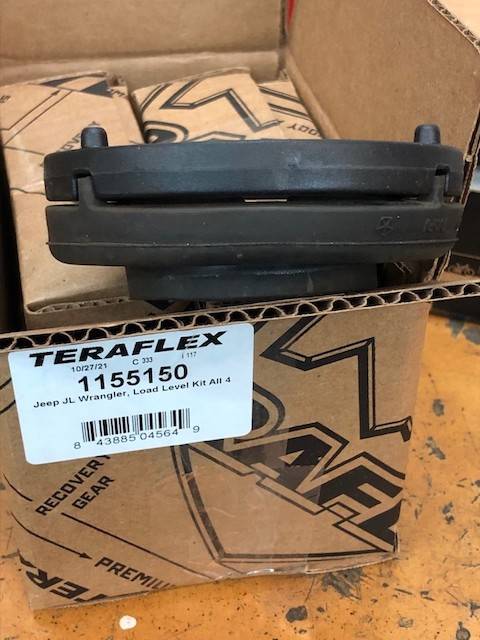

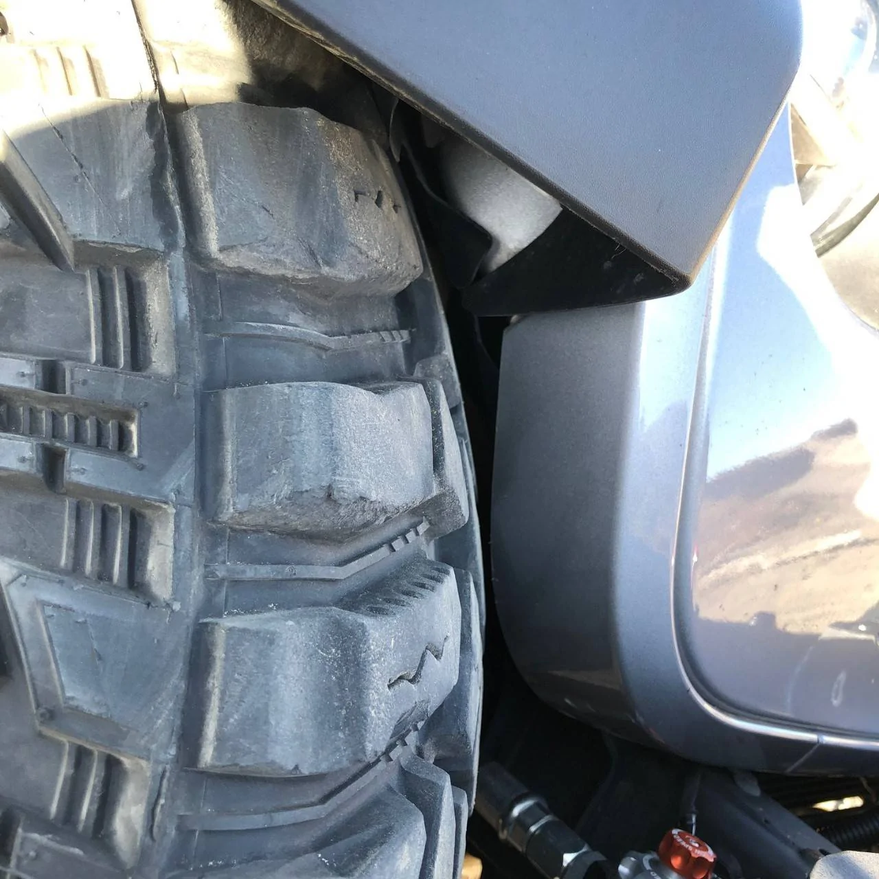

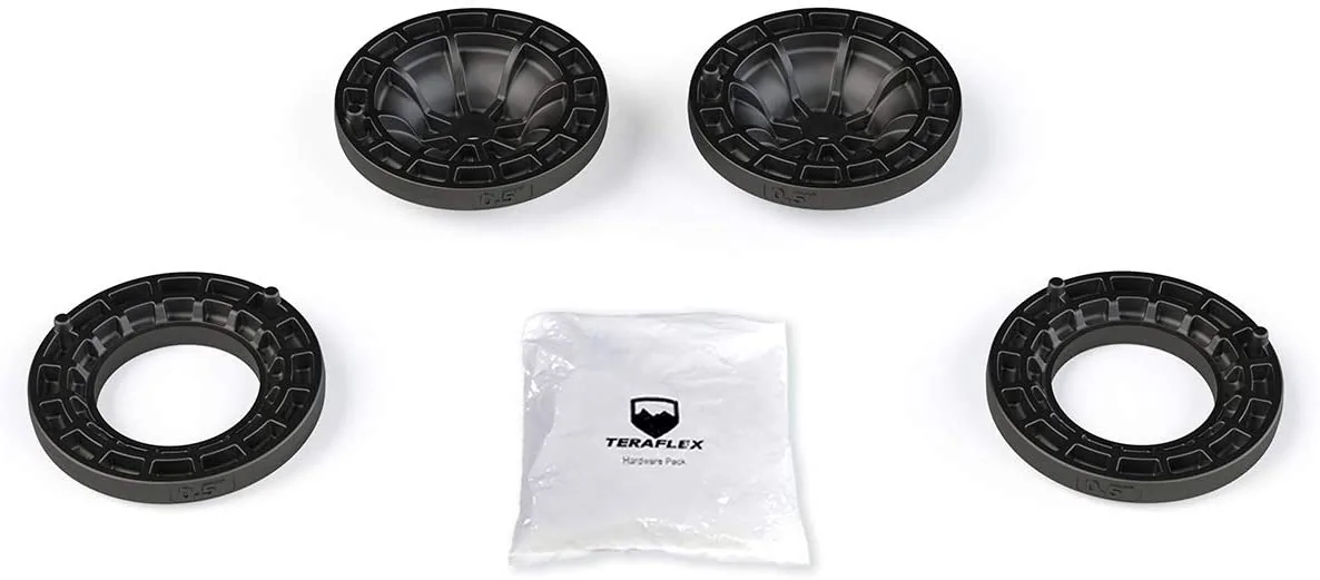

At the front, there's at least 1 inch in height difference between the driver and passenger fenders, and since driver side never rubs and the passenger side does, I ordered this Teraflex 0.5" front and rear load leveling kit off amazon to try and level things out. I ordered the complete kit with idea in mind that if I go to 38's down the road, a 0.5 spacer on all four corners and a fender trim may be all I need. But for now I'll only be installing the front passenger spacer and go from there.
Jeep Wrangler JL CO Ketchup Build teraflex load leveling kit
Teraflex 0.5 spacer stacked with passenger front upper spring isolator:

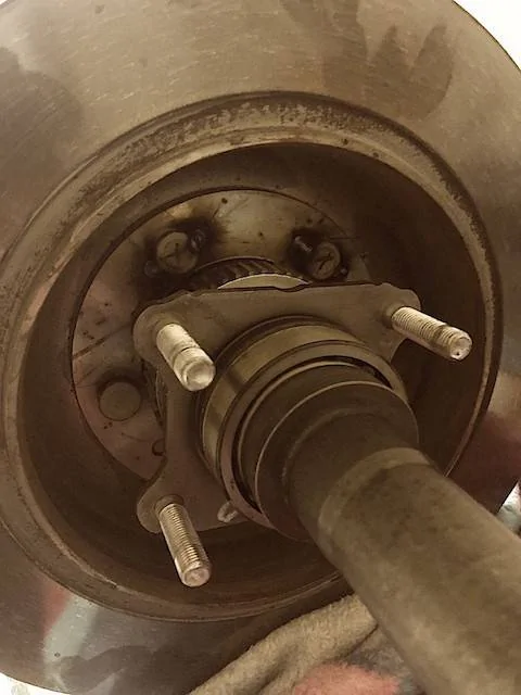

The Dana Spicer 44 AdvanTek Chromoly rear axle shafts:
I'm not impressed with the quality of Dana parts or packaging during this build and the axle shafts take the cake. Long story short I had a total of 7 wheel studs spin between the 2 axle shafts after install. Had to tack weld the backside of the studs to get the lug nuts off and disassemble:
Jeep Wrangler JL CO Ketchup Build Dana Spicer axle shafts
These were both warrantied and replaced free of charge by Dana, thru Northridge. In my experience, Northridge's customer service is top notch...but at the time everything was on backorder so I reinstalled the stock shafts and did the majority of this past years wheeling running stock. In the meantime I ordered the Yukon version and have those currently installed. The Dana replacements sit in my garage as spares but if needed, I would use my stock axles over these.

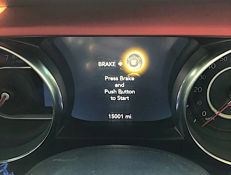

Hit 15K along the way:
Jeep Wrangler JL CO Ketchup Build Mileag

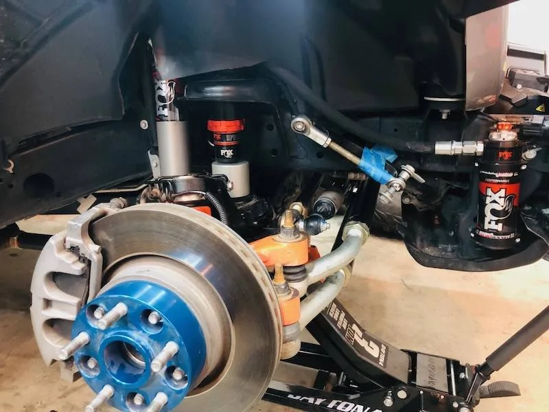

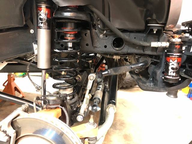

Started disassembly and mock-up on the front:
Jeep Wrangler JL CO Ketchup Build Bump Stops_03
Jeep Wrangler JL CO Ketchup Build Bump Stops_04
Jeep Wrangler JL CO Ketchup Build Bump Stops_06
Checking full bump:
Jeep Wrangler JL CO Ketchup Build Bump Stops_08
Gonna have to get those bump pads turned down, that is 1.25" of shaft still showing :
Jeep Wrangler JL CO Ketchup Build Bump Stops_07

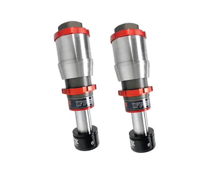

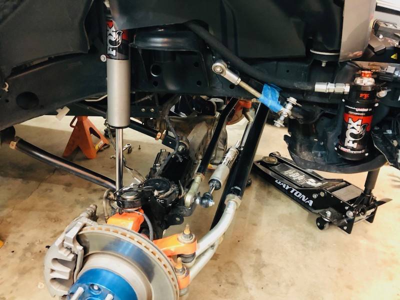

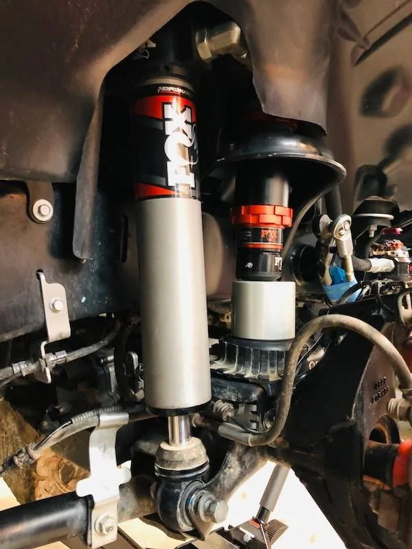

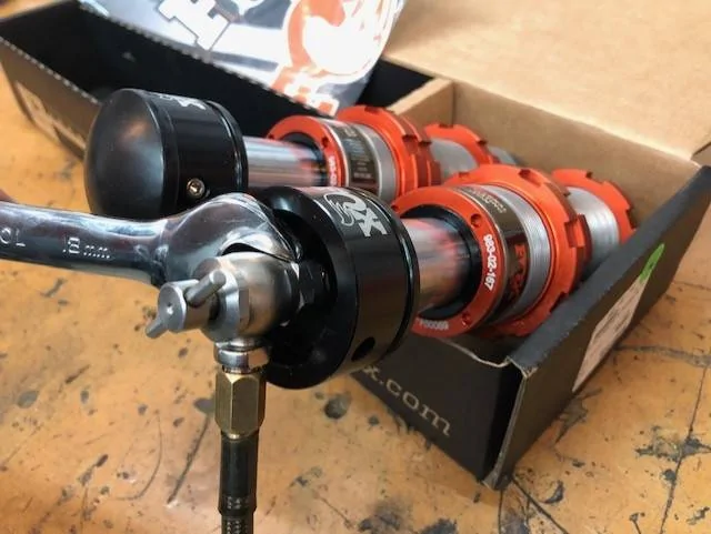

Front bumps are in and everything's back together:
Jeep Wrangler JL CO Ketchup Build fox bumps, PS view

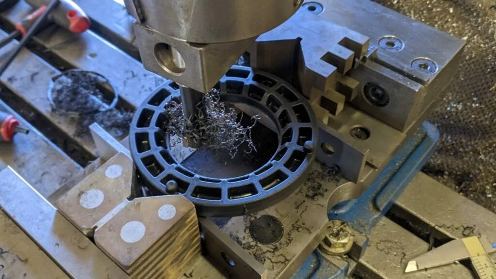

Had the aluminum bump stop spacers cut down to length at a friends fabrication shop. Also had the front Teraflex 0.5" load leveling pucks milled out so they can freely slide over the lock rings on the Fox bump stops. The rubber OEM upper coil spring isolators are fine with the help of some soapy water. Don't know if this will be a permanent thing so for ease of install/removal I went this route instead of having to remove/reinstall the 2 lower lock rings on the bump stops everytime:
Jeep Wrangler JL CO Ketchup Build spacer milling
Jeep Wrangler JL CO Ketchup Build PS spacer, lock rin

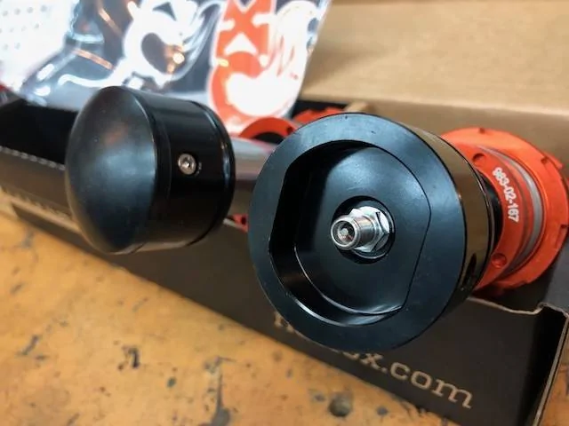

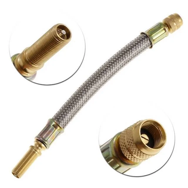

Decided to start with 150psi on the bench and go from there. These schrader valves are recessed quite a bit for nitrogen fill, I imagine it'll be even more difficult to snake the air chuck thru the coil spring if I need to add pressure so a valve stem extension is in the works for fills:
Jeep Wrangler JL CO Ketchup Build Bump Stops_02
Jeep Wrangler JL CO Ketchup Build Nitrogen fill
Jeep Wrangler JL CO Ketchup Build valve stem extension
The location of these valve stems on the Fox bump stops are a double edged sword, inconvenient for the front axle but on the rears you don't have to remove the entire bump stop to adjust pressure, simply remove the strike pad and you're good to go. Most others are still running their schrader valves on the top of the cans so you have to loosen the lock rings and thread the entire unit out.
Rear bumps are back-ordered, no ETA yet. Should give me time to get the fronts dialed in. You can see another feature I like about these bumps in the below pic. Fox has added wrench flats to the tops of their bump stop cans to help with tightening the lock rings down:
Jeep Wrangler JL CO Ketchup Build JL rear bump stops
I'll keep you guys updates once I put some miles on them.
