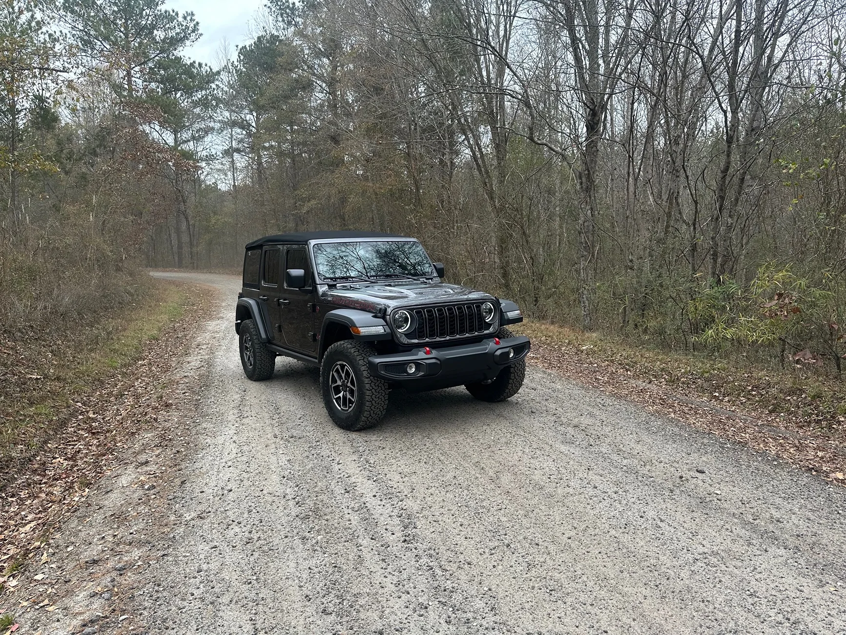

I guess I’ll go ahead and get my build thread started, I have a Teraflex ST/2 lift sitting in boxes with some Falcon 3.3 shocks to go with it. Installed today the Tazer Mini, the Barricade HD tire carrier/hinge reinforcement, and the Method 703’s. The Methods are 17x9 0 offset in bronze. Went with 35x12.5x17 Mickey Thompson Baja Boss AT’s as well.
Before, stock 2024 JLUR
Jeep Wrangler JL Corv’s slow build IMG_2467
After wheels and tires

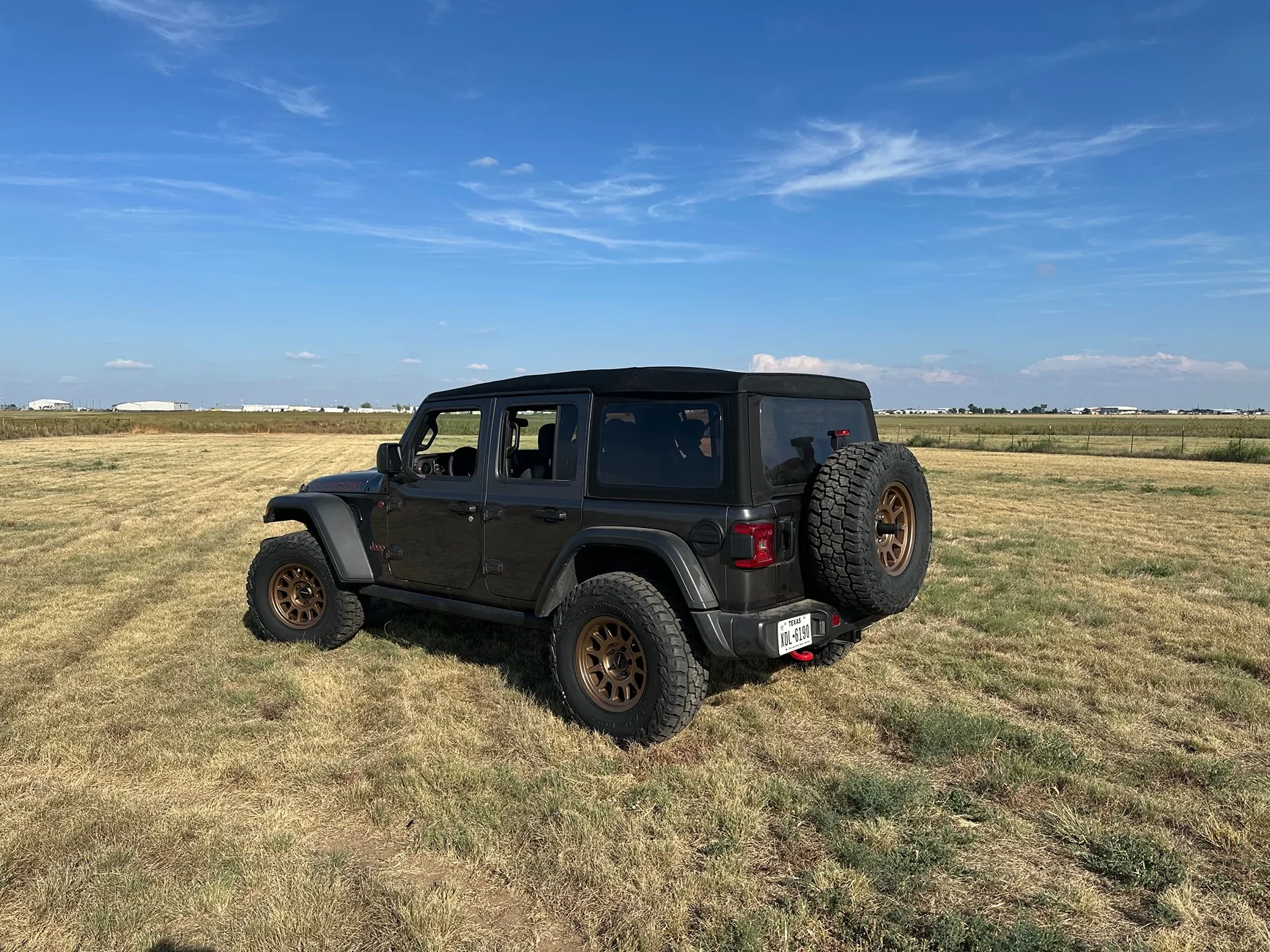

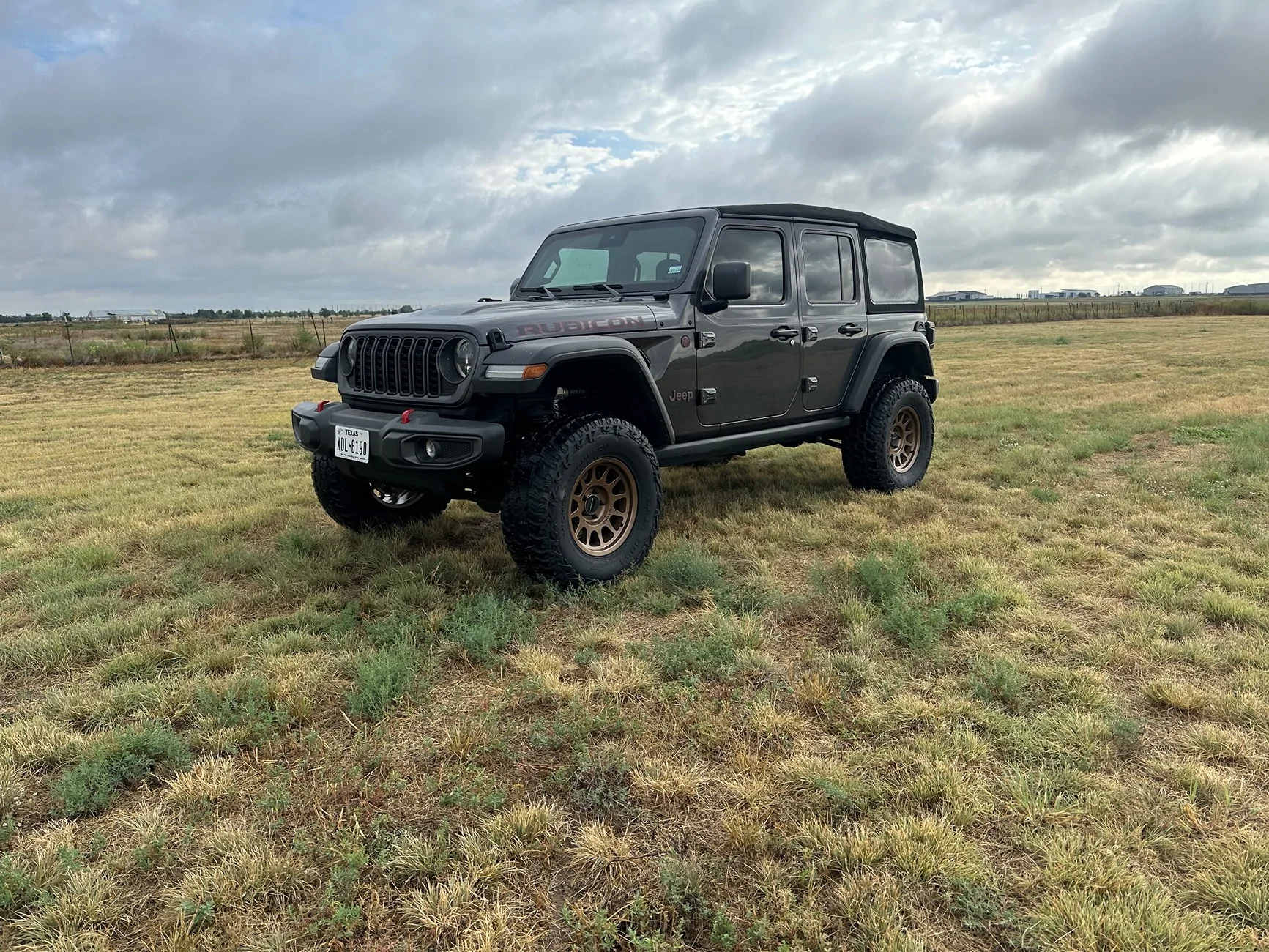

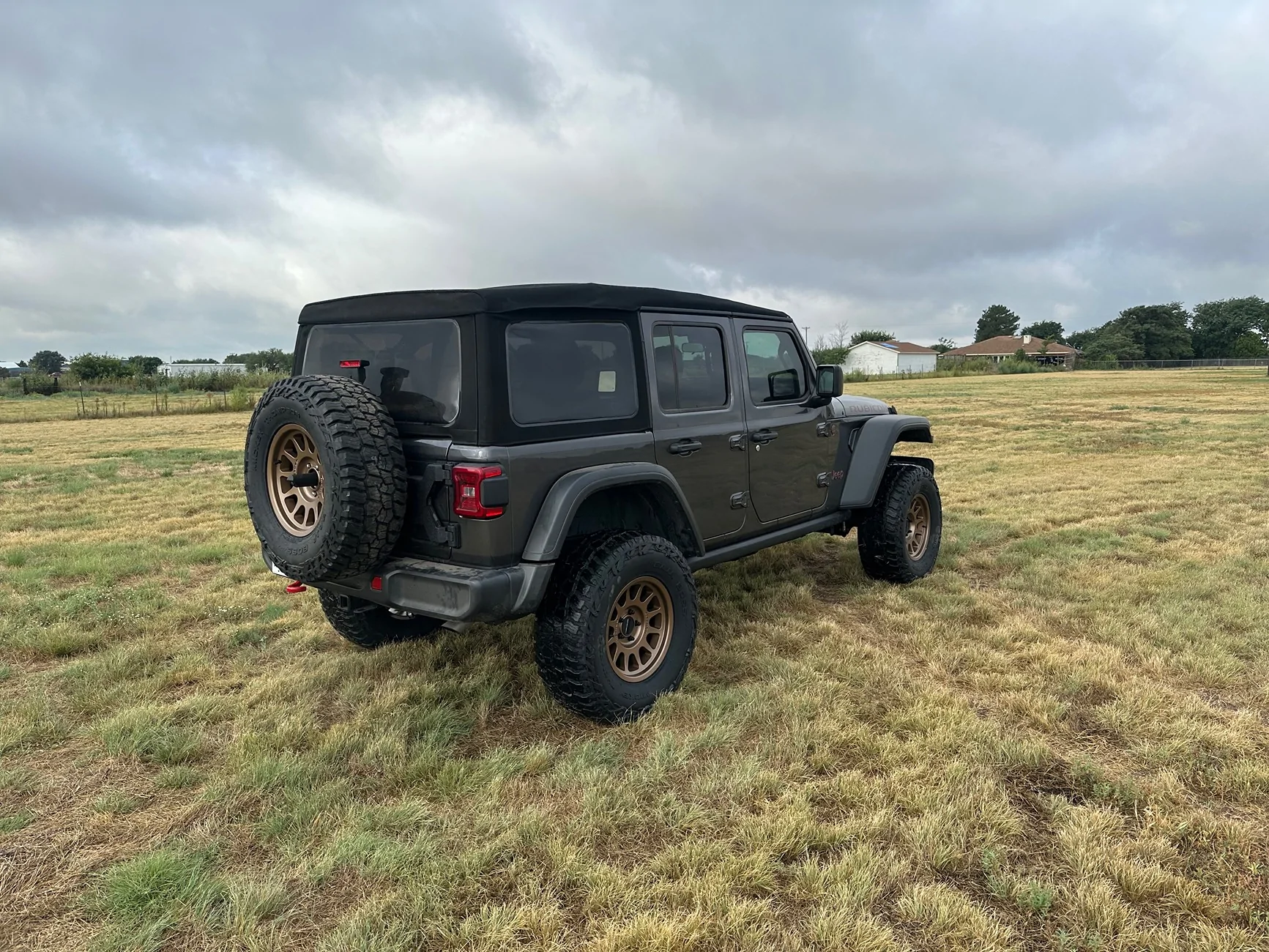

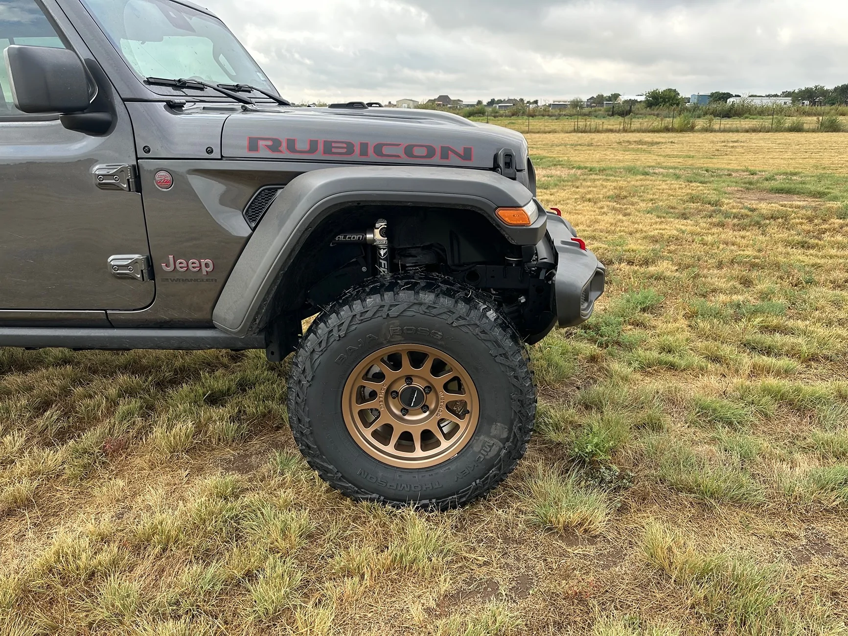

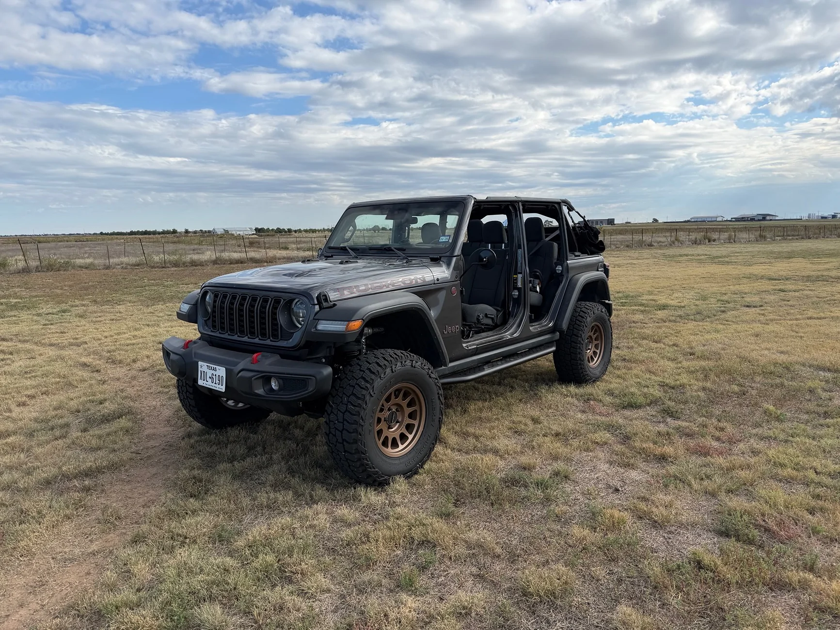

Installed the 2.5” Teraflex ST2 lift yesterday and finished buttoning up the last few this morning and went for a drive.
It honestly drives like a stock Rubicon, with the shocks on the soft setting, keep in mind these are Falcon 3.1’s and NOT 3.3’s. Overall I’m very happy with it. I didn’t measure before and after, but I’m pretty sure I got close to 3.5” of actual lift over stock with the 35’s.
Jeep Wrangler JL Corv’s slow build IMG_3205
Jeep Wrangler JL Corv’s slow build IMG_3208
Jeep Wrangler JL Corv’s slow build IMG_3207

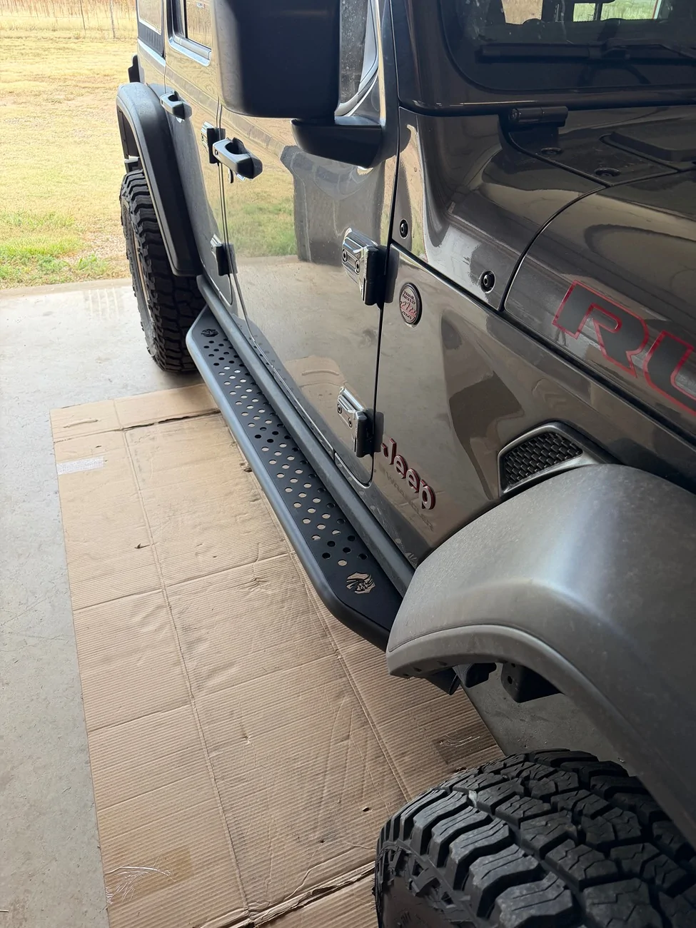

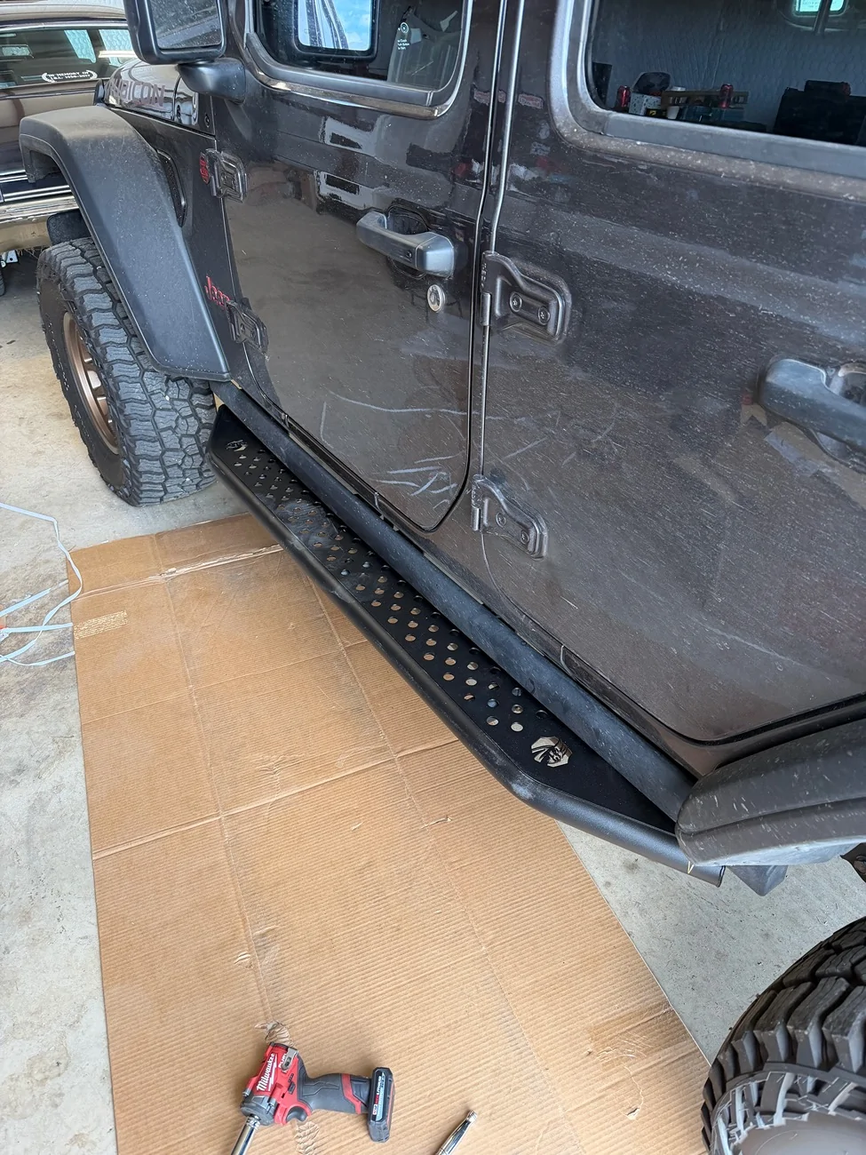

The GOAT Fabrication step/slider was delivered on Thursday. These things are super nice. The build quality couldn’t be better. I’ve read about the issues with removing the bolts for the body mounts, so I just pulled the map gas torch out, heated the bolts up and they came right out, no fight at all. Took 25 minutes in all to install them.
Jeep Wrangler JL Corv’s slow build IMG_3277
Jeep Wrangler JL Corv’s slow build IMG_3278
Jeep Wrangler JL Corv’s slow build IMG_3280
