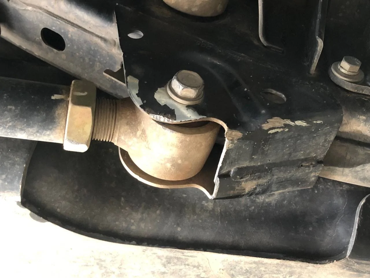

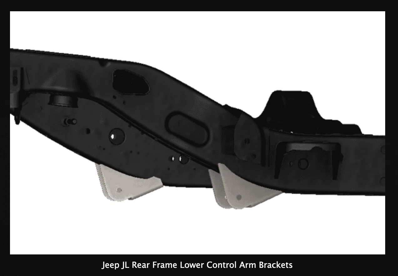

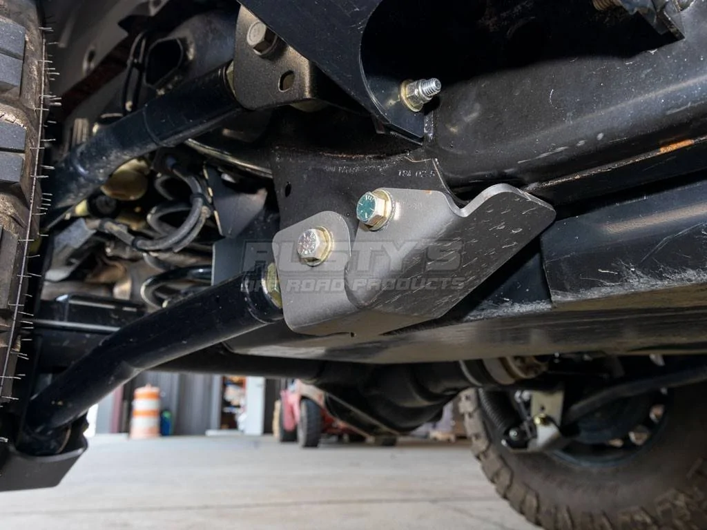

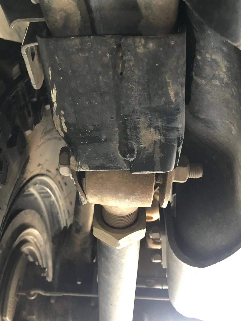

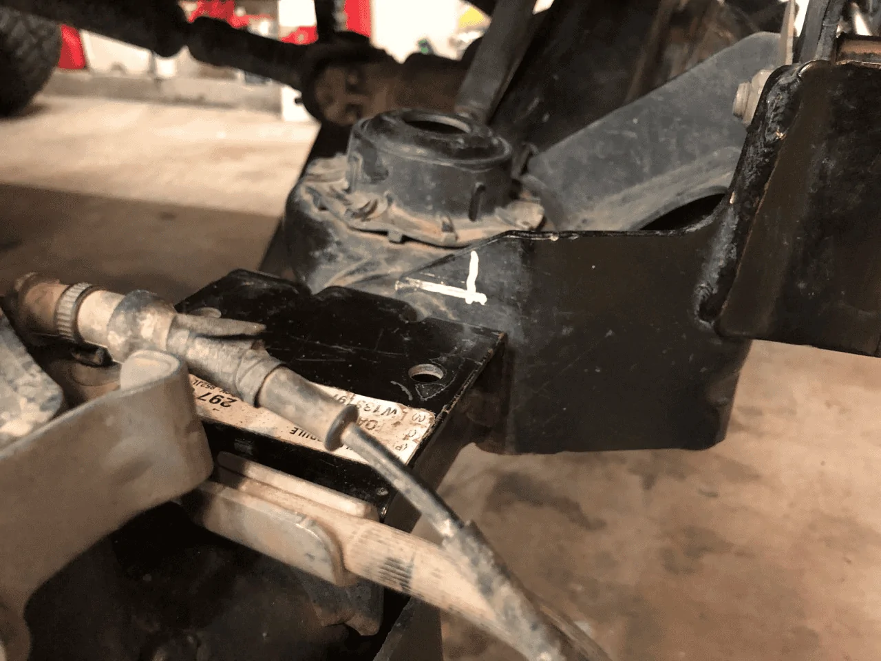

I've started to get into the Rear Lower Control Arm brackets at the frame so have some concerns there. Started looking at reinforcing that area or going with beefier brackets. Does anyone have recommendations?
Jeep Wrangler JL CO Ketchup Build Rear LCA frame brackets
Jeep Wrangler JL CO Ketchup Build Rear LCA at fram
I like the Rusty's LCA frame skids but it doesn't address the poor welds from the factory. You'd just be bolting to something that still has a chance of peeling off the frame. Also found these Barnes 4WD weld on brackets that look like they could work, 3/16 thickness versus the factory 10 gauge I think. Anyone else make a bracket out there that's application specific to the JL and handles a 2-1/2 joint? Thoughts, advice appreciated
Rusty's bolt on:
https://www.rustysoffroad.com/rustys-rear-lower-control-arm-frame-side-skid-plates-jl-wrangler.html
Jeep Wrangler JL CO Ketchup Build Rustys Rear LCA Frame Skids
Barnes 4WD weld on:
https://www.barnes4wd.com/jl-rear-frame-lower-control-arm-brackets-.html
Jeep Wrangler JL CO Ketchup Build Barnes LCA Frame sid

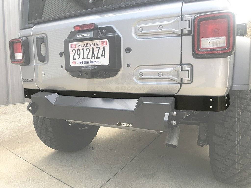

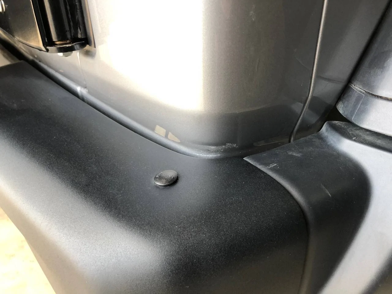

Also discovered I've now become the victim of the all too familiar stock bumper deflection into the body on the passenger side. I really want to hang onto this stock rear bumper as long as possible so Rusty's rear fascia kit looks like it fixes this problem but taking a closer look at my beauty mark, it seems like the kit doesn't cover that high? Any thoughts on how I should address this besides going the aftermarket bumper route?

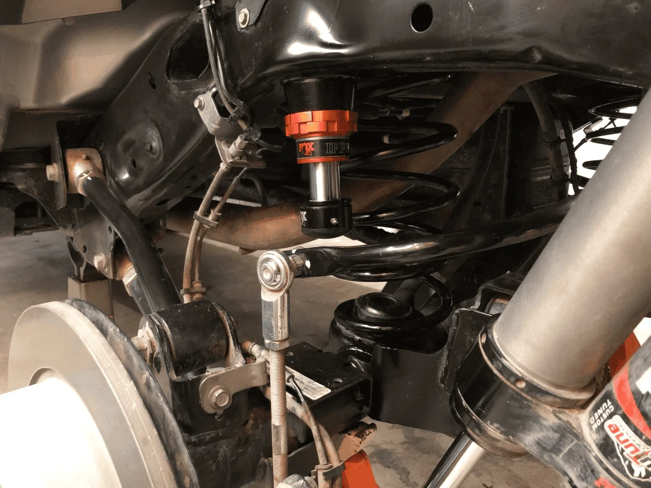

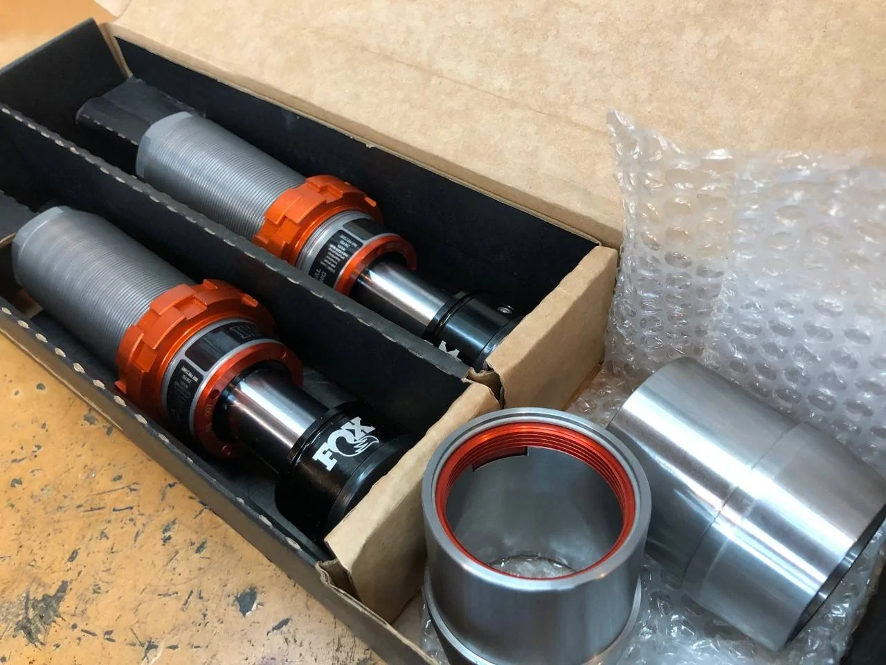

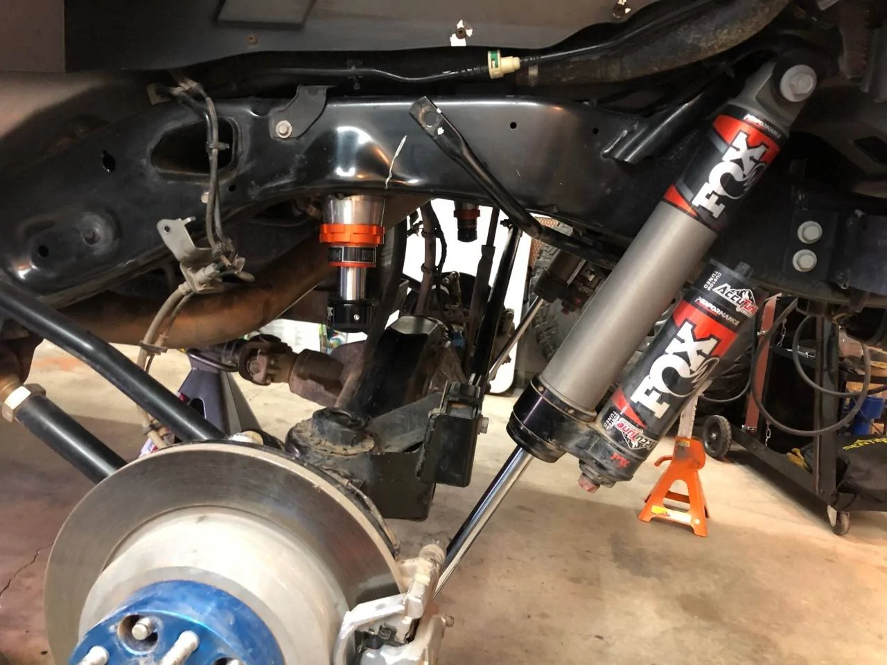

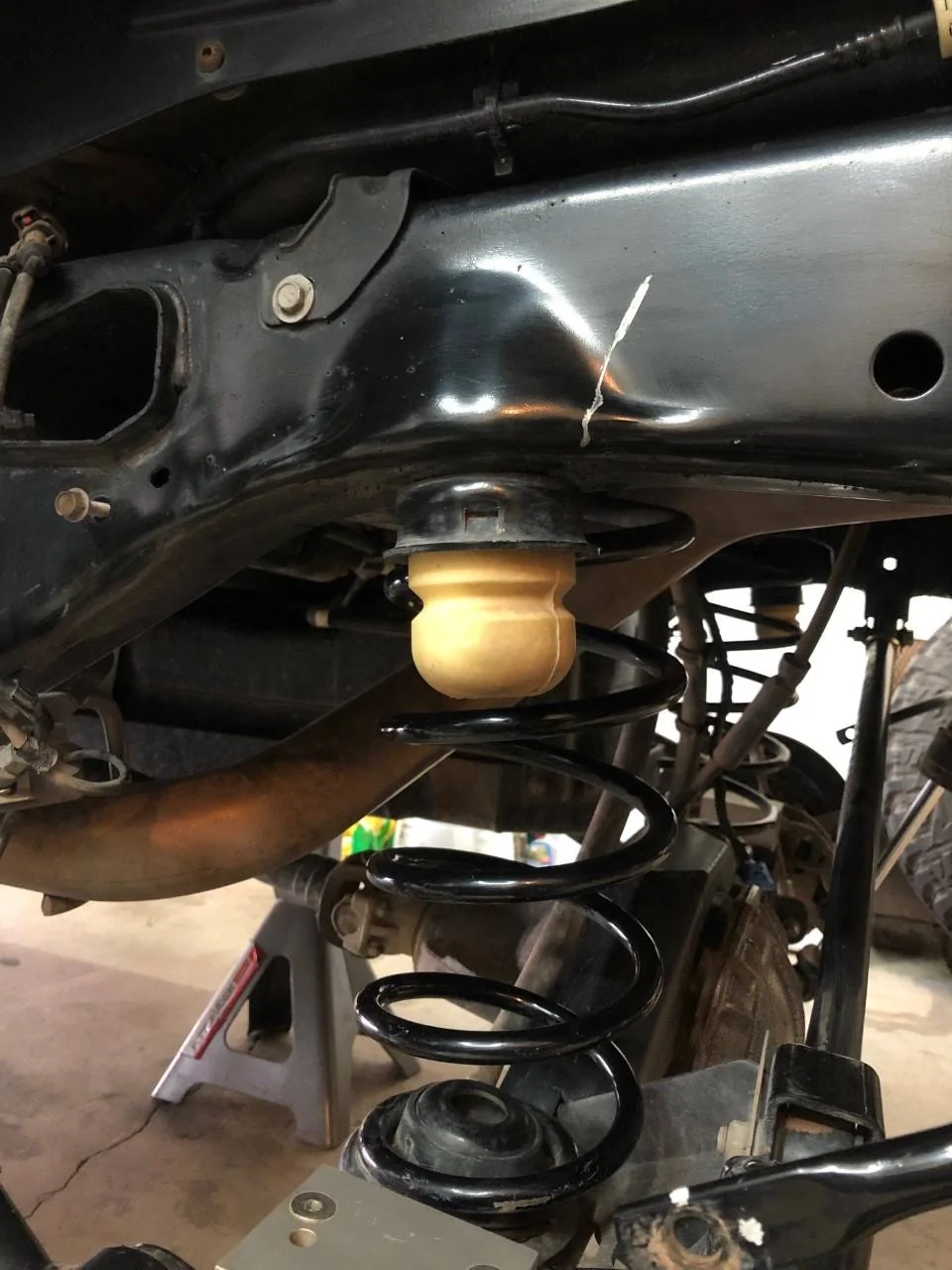

Rear bumps showed up unexpectedly this weekend. Dunno when I'll get to them since I still don't have the 220v issue in my garage addressed. It's either wait till a friends garage has an open spot for 1/2 half a days work, or get everything set up and tacked in place here, then trailer it over for a final burn in, or I may just find myself in the backyard lugging a cookie sheet around in the dirt like @Headbarcode with some warm weather on the horizon.

I was looking at the Rusty's rear fascia as well but not pulled the trigger. I was not sure if it would still fit with factory steel bumper and had not seen anyone who has tried it. Only suggestion on the LCA is from Rancho. I am not running them yet, but will get these so far from what I have seen.
Don't forget my unpadded plywood creeper. I'm shittin in tall cotton over here! ?

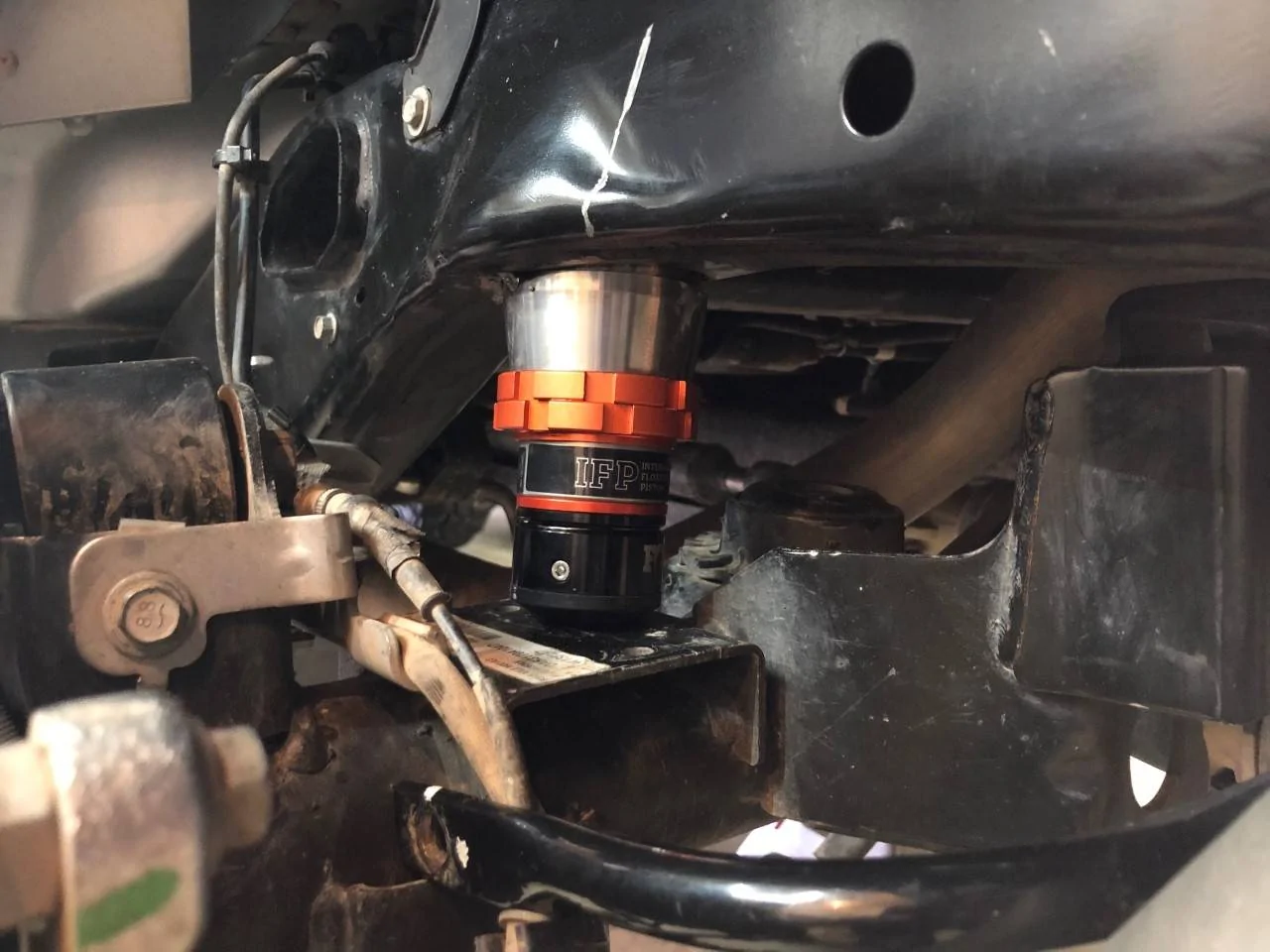

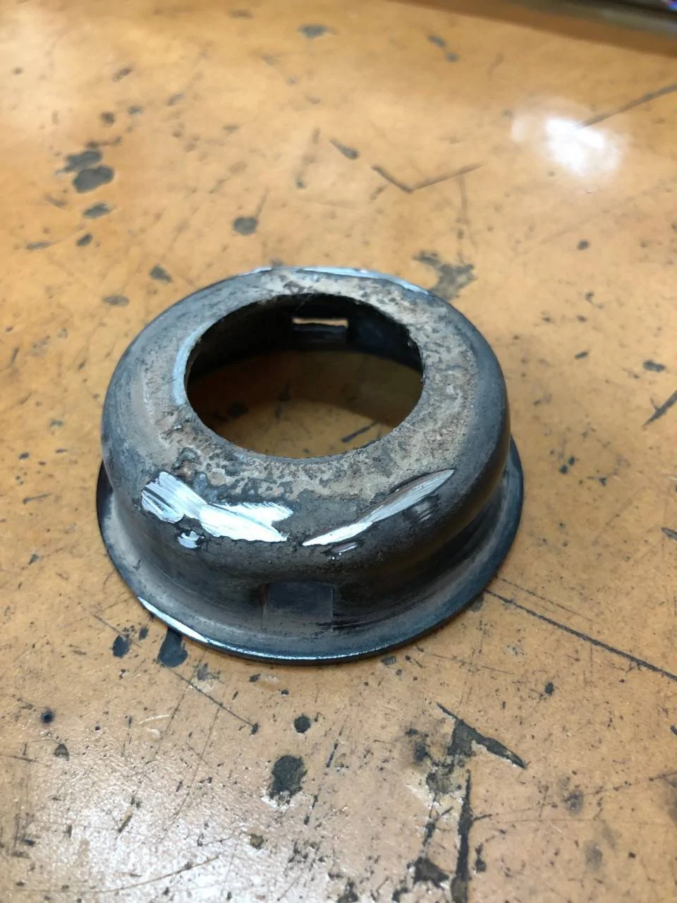

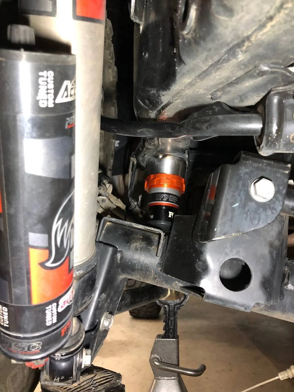

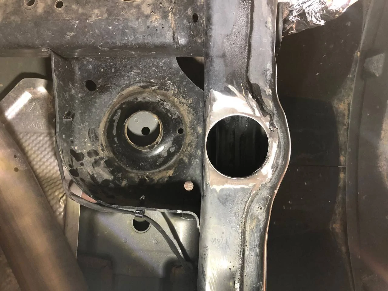

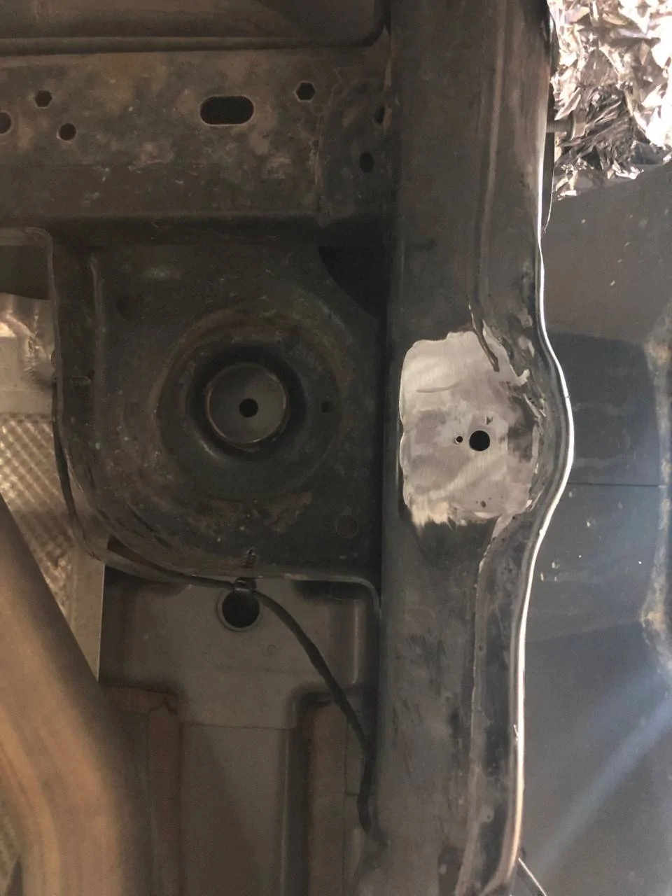

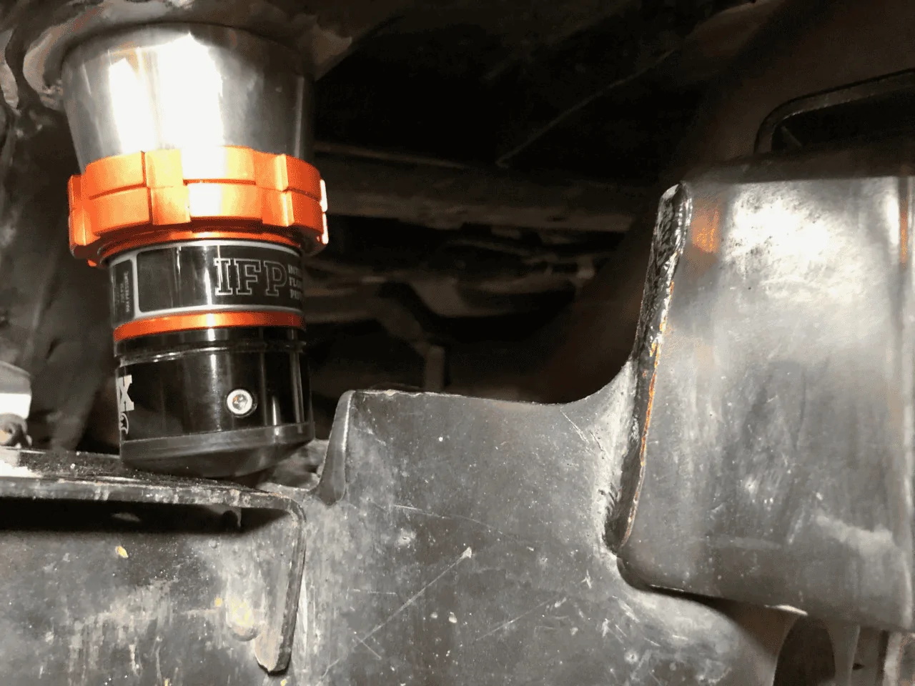

Made some progress on the rear bump install this week:
Tearing down stock configuration:
Jeep Wrangler JL CO Ketchup Build Stock bumps
OEM material removed with a cutoff wheel:
Jeep Wrangler JL CO Ketchup Build stock bump removal
Measured and drilled 1/8in pilot hole. This is located 3/8in inboard from center of large hole already present:
Jeep Wrangler JL CO Ketchup Build Pilot Hol
Continued to follow the manufactures directions and used a 2-5/8in hole saw to accept the aftermarket Fox bump can. I used the cheapest I could find at Lowes which was a Lenox brand and it had just barely enough bite to finish the second hole:
Jeep Wrangler JL CO Ketchup Build Hole Sa
Mocked up and tacked in place for clearance check:
Jeep Wrangler JL CO Ketchup Build Driver stuff, trackbar issu
Passenger side is good to go. Above you can see the issue on the drivers side with the bump getting into the trackbar mount. Rookie move forgetting trackbars prevent identical arcs with full stuff and droop of driver and passenger side...surprised Fox didn't mention this in the directions.
Ended up removing and re-tacking, canting the bump can 5 degrees outward with an angle finder, choked up as much as possible on the bump stop body, ditched the 2in aluminum bump pads that came with the 2.5" lift, and checked for clearance:
Jeep Wrangler JL CO Ketchup Build clearancing
Jeep Wrangler JL CO Ketchup Build full stuff
Jeep Wrangler JL CO Ketchup Build final mock-u
Not perfect with that inboard portion of the bump can lip not fully flush with the frame and right now I'm not fine with that because I lost 1/4" uptravel on that side. There is some room in there to elongate the hole more outboard, maybe machine down the outboard portion of the bump stop can lip to get that 1/4" back...still thinking things over before moving forward.

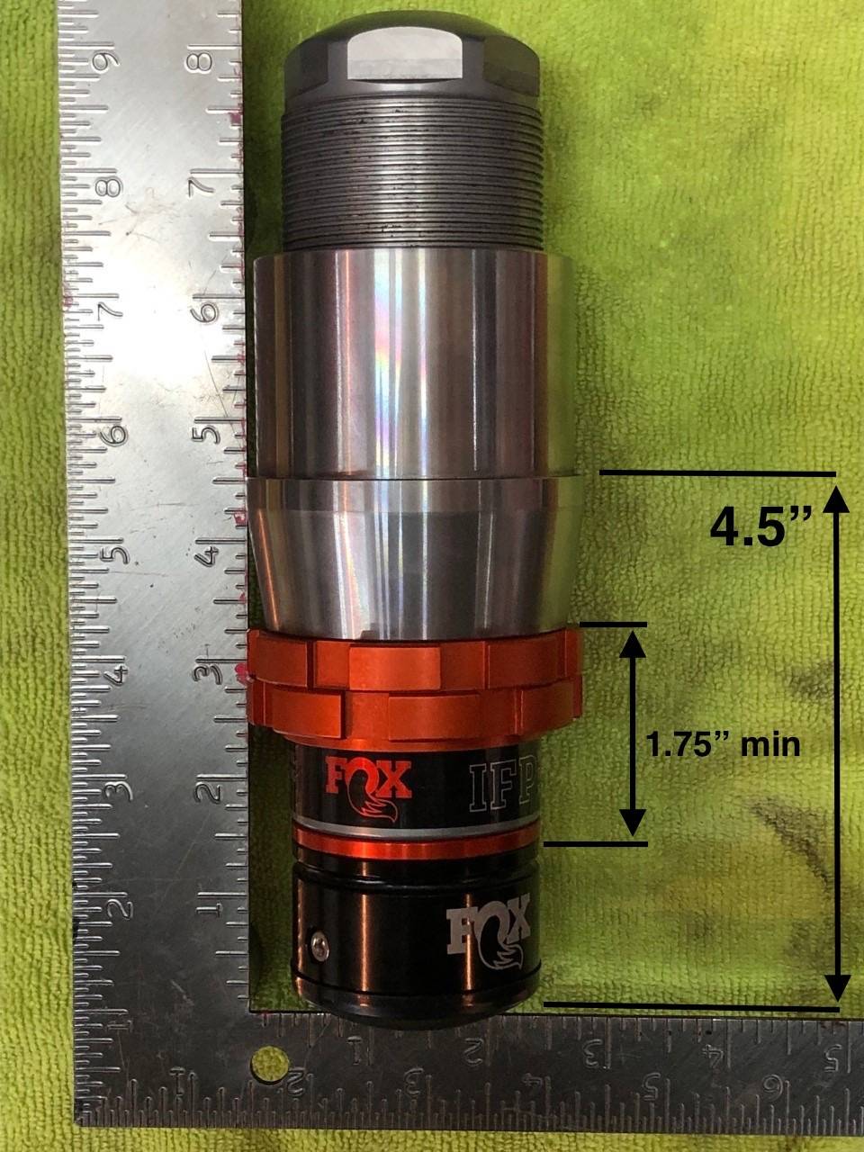

Throwing more info in here because I searched and couldn't find much on rear installs. So for those that may go this route I am running a 2.5" lift, paper says the rear was only lifted 1". The lift came with 2" bump stop pads for the rear that I have now removed. Fully compressed this product installed is 4.5" from can lip to bottom of bump stop strike pad. Add roughly another 2 inches with the bump stop fully charged (or 1.854"). Fully choked up, you need a minimum of 1.75" from the top of the highest lock ring to the bottom of the orange bump stop bearing cap. Overall, I believe the threaded body allows for at least 1" of vertical adjustment for fine tuning.
Jeep Wrangler JL CO Ketchup Build Bump Stop Dim

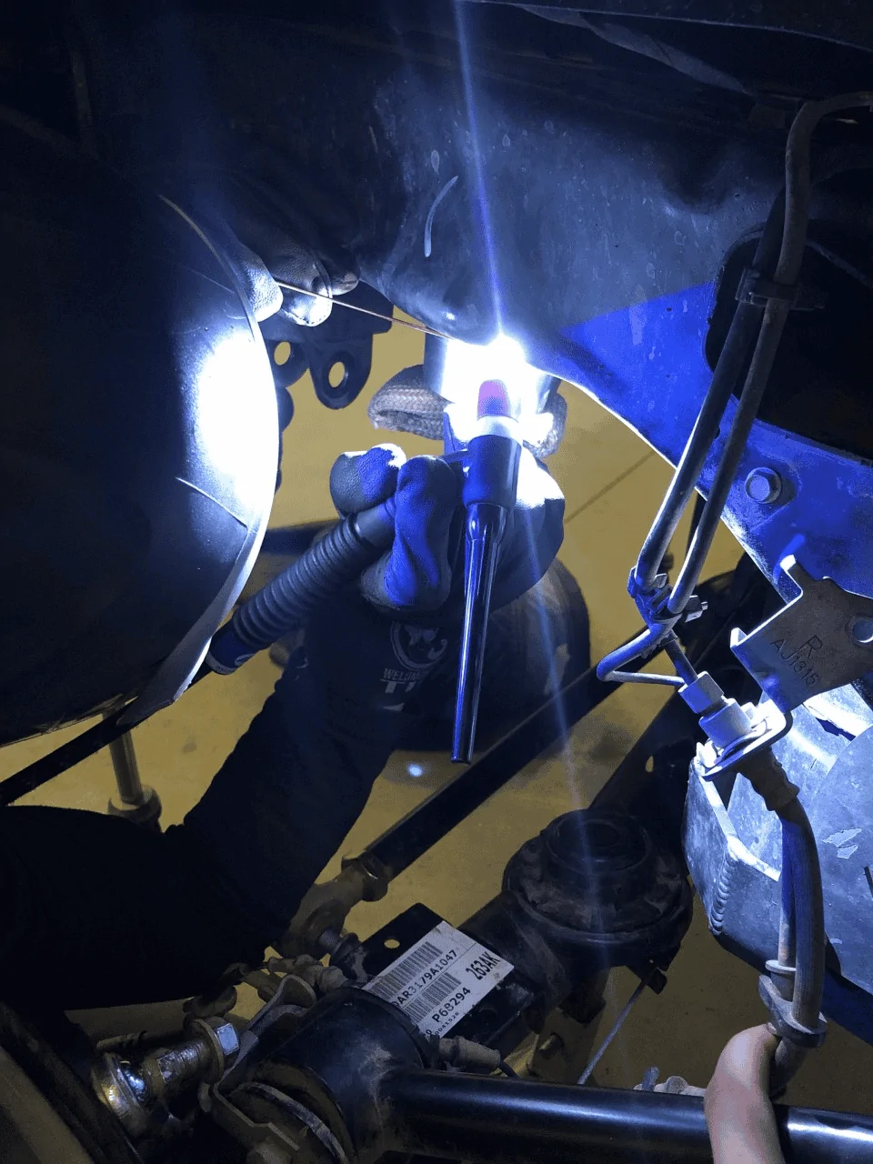

After talking to people smarter than me on this I re-adjusted the drivers side bump, taking out the 5 degree lean inboard and clocked the bump can lip flat with the frame (per instructions), then trimmed part of the track bar mount fin to help with clearance at full bump. I've been driving around like this for over a month charged ~65psi, the rig has seen some light duty trail time, everything is working fine. Am I concerned about taking a piece out of the trackbar without adding some gusseting? Certainly, but for now I'm running it as is.
I trailered the JL to a friends shop, and proceeded to blow out the frame on the first mig pass, so cleaned everything up and watched him pulse tig it. I don't think I got too carried away with a flap disc on initial mockup to justify the mig blowout....the frame is 1/8th in places so who knows.
