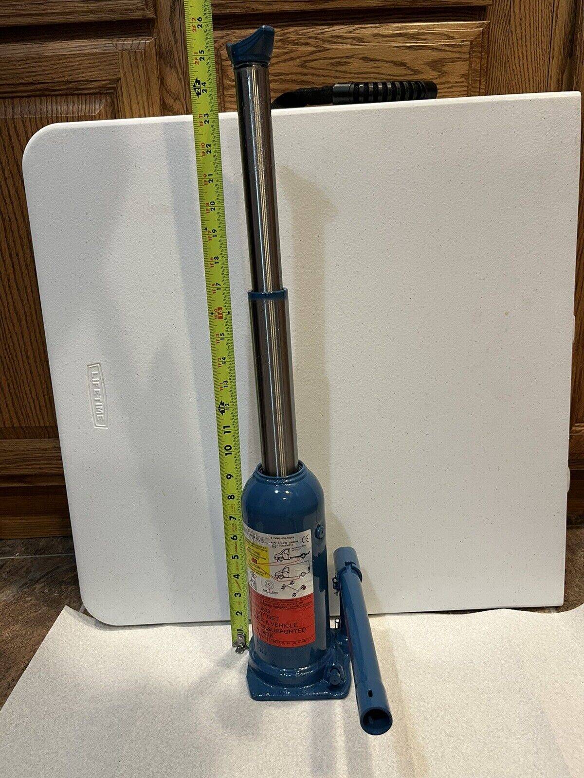

That won't lift enough to change a 38 on my JLR or a 43 on my LJR. You don't need 10 tons, the 4 ton is overkill.
EDIT
The BAOSHISHAN 12 Ton High Lift Bottle Jack 9.25" to 23.23" would provide enough lift but not require driving over a rock.

Not exactly.
When you have a flat, the axle is about 6" off the ground. You need a jack that will fit under that height or you have to dig out a hole for a taller jack to fit, or drive the flat tire up on a rock (further exposing the tire to damage). Once you get a jack under the axle of a flat tire, you have to jack it whatever height your flattened sidewall expands to with air. This is where having a low scissor jack works well and guys that bought a bottle jack using measurements under their axle when their tire was inflated, are going to be surprised when they get a flat.
I carry spacers. I've seen at least 10 youtubes on jacks and they test the jack with the tire full of air. They get surprised when they get a flat on the trail.

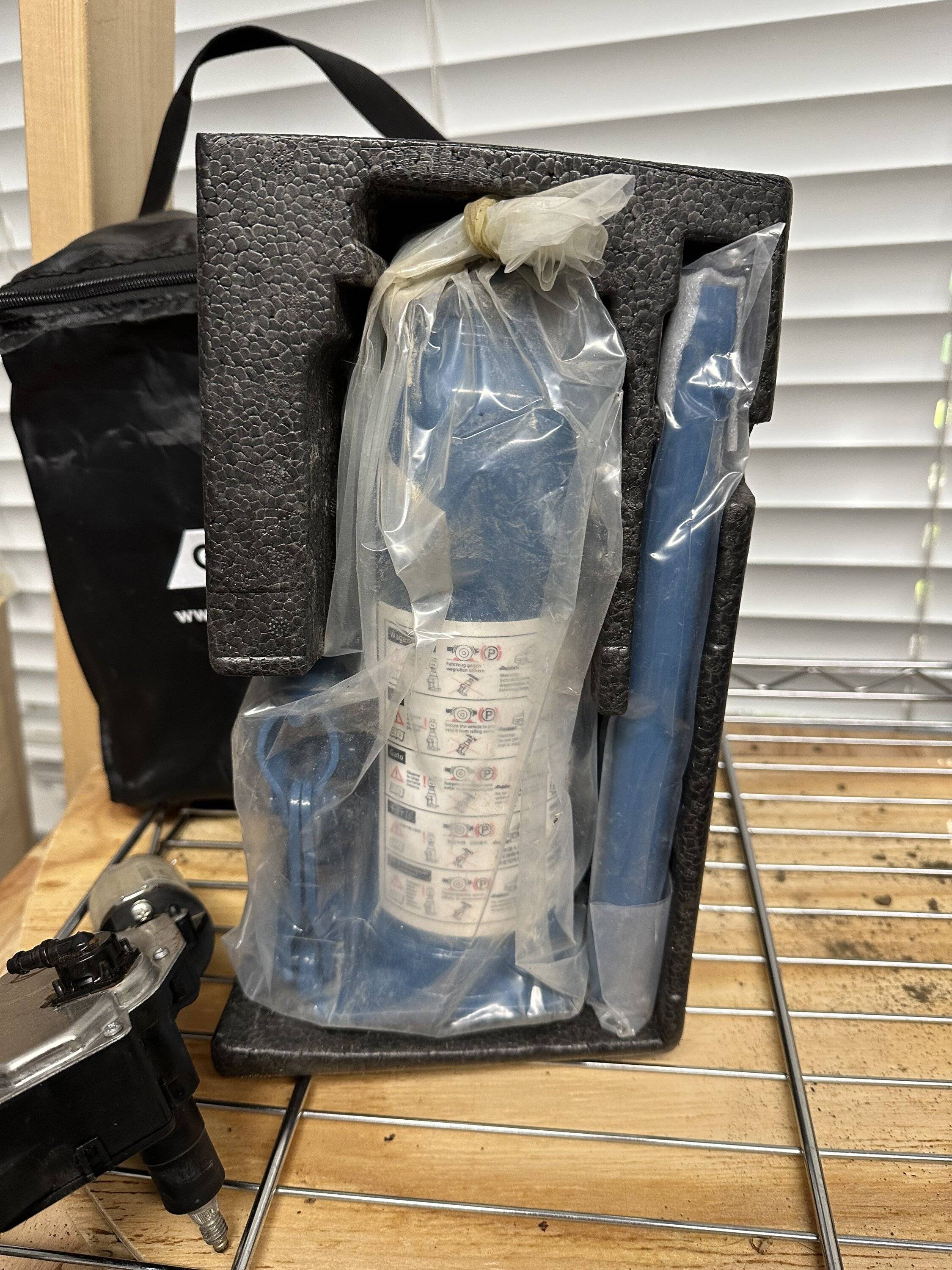

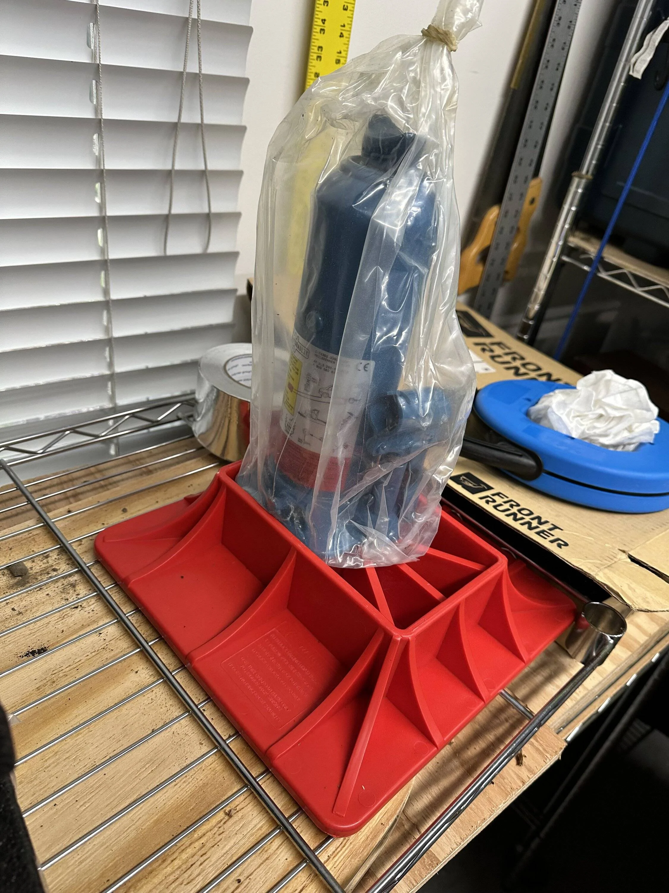

I carry the factory scissor jack, but supplemented by a Mercedes Sprinter double-ram bottle jack with 25” of lift And a high-lift jack base.
This allows for jacking of the Jeep or off-road trailer at multiple jack points, depending on failure.
PLEASE BRING WHEEL CHOCKS AS WELL. !
