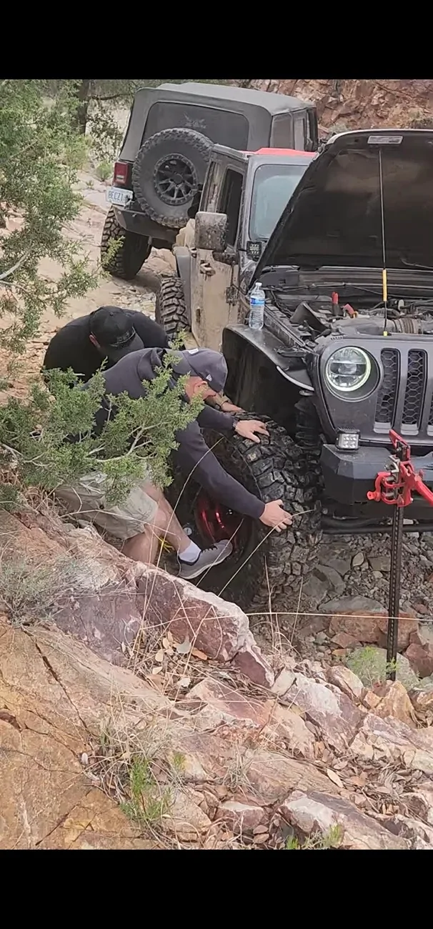

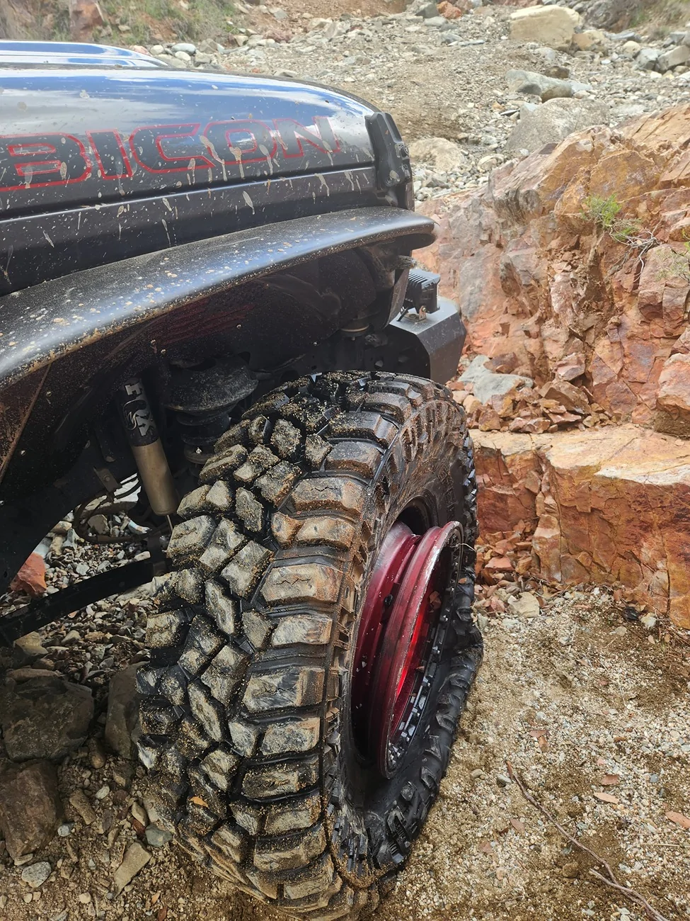

Altho I'm 100% on board regarding the safety issues with a hi lift, when I popped a bead last year mid obstacle I found myself in a situation where the hi lift was indeed the right tool for the job, strangely enough. I'm considering getting one to have just in case... but the bottle jack will always be Plan A.

Yes but in my situation it was not possible to jack the vehicle up from under the axle (pics never do it justice, I'm basically over a v-notch), and we needed to get weight off the tire so we could seat the bead to get it to pop. The front bumper happened to be sitting right over a nice flat rock, and the hi lift fit right where it needed to.
All we did was lift the jeep enough to get the bead to seat back on, threw a compressor on it, held it in place til it popped, and we were good. Well, almost. Turns out I'd sliced the valve stem, didn't have a valve stem repair kit, so I was able to drive the jeep the rest of the way up the obstacle to flat ground where we used a bottle jack to safely change the tire for the spare.
What you suggested would have replaced the compressor, but it still wouldn't have been possible to use until we got the weight off the tire.
Some people would suggest that even with the bead popped, I should have driven or winched to flat ground to do the repair. Risk of damage to the wheel or the rest of the Jeep was too high. But, if the hi lift plan hadn't worked out, or been higher risk, that would have been plan C.
