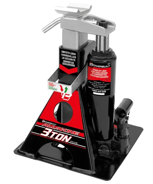

I carry one of these now, it's a bit bulky to store in the Jeep, but a safer alternative. Plus the big flat base is a plus in mud/sand/snow so your jack doesnt sink into the ground as easily. You use it to jack under your axle, works for my 37s perfectly.

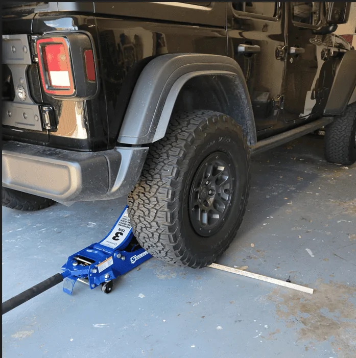

My XR jacked up, need 24" floor jack:

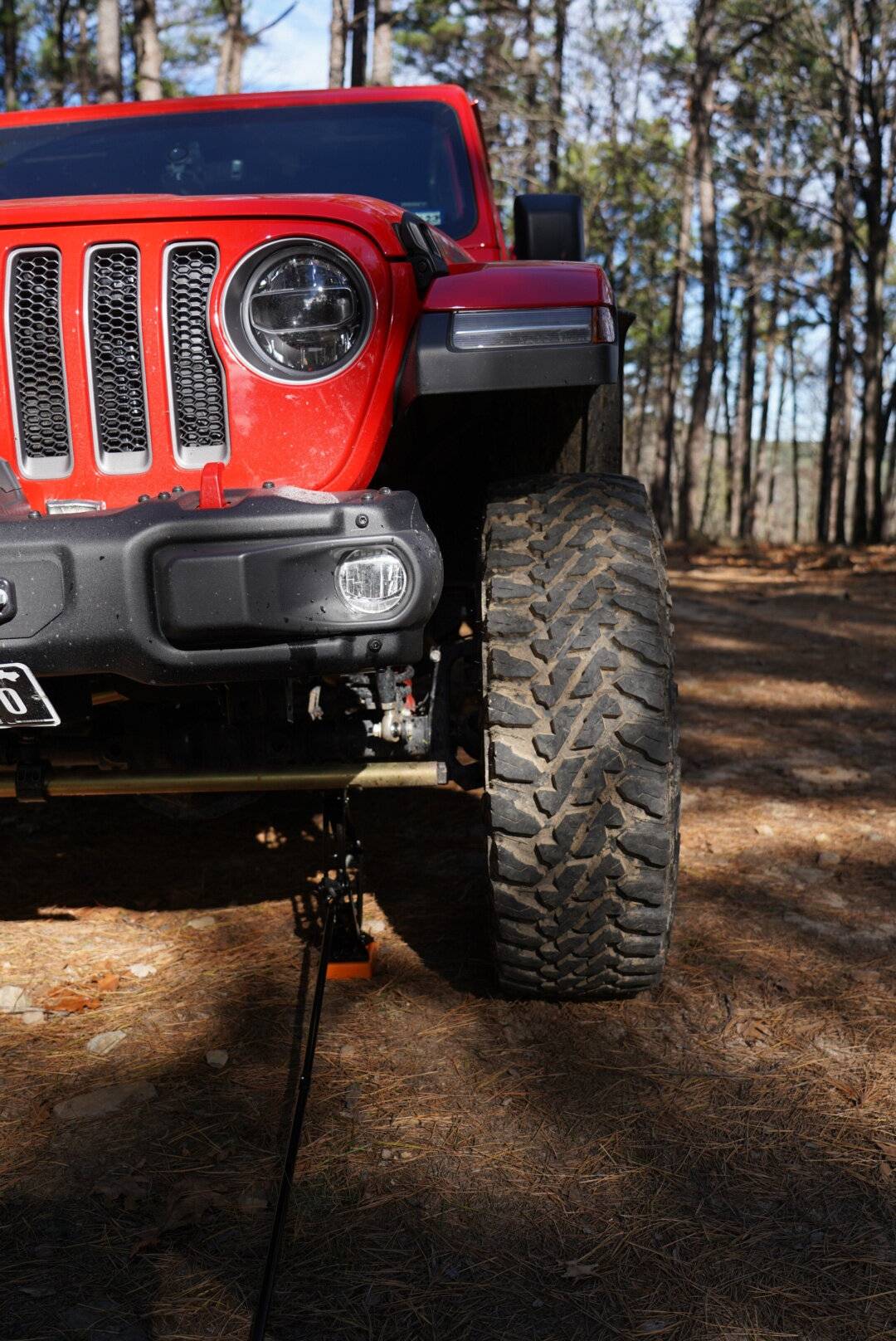

Factory Jack with XR spacer was plenty for my rig on 3.5” MC lift (doesn’t really make a difference) and 37” tires. Just lift from the axle.
Edit: Do use your head. I had the rear tire off and close by before removing the flat. Keep all your body parts out of harms way. Remove the tire and place under the frame near the Jack to catch the vehicle if something goes wrong. Zip the new tire on. It’s not the safest thing I’ve done (still better than a hi-lift IMO), but if you use your head you can keep all your appendages.
