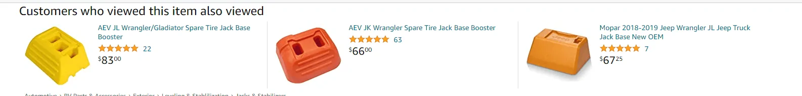

Jeep Wrangler JL Changing Tire on the Trail??? 1684445251136
The benefit to these is that they are compact and light weight. They are also fairly inexpensive compared to almost all other jack options. I have the Mopar one just in case. I carry that and a battery powered impact (with the proper socket for my spline lug nuts) not just offroad but for long highway trips. I don't relish the idea of ever being on the side of the road for long periods of time.
