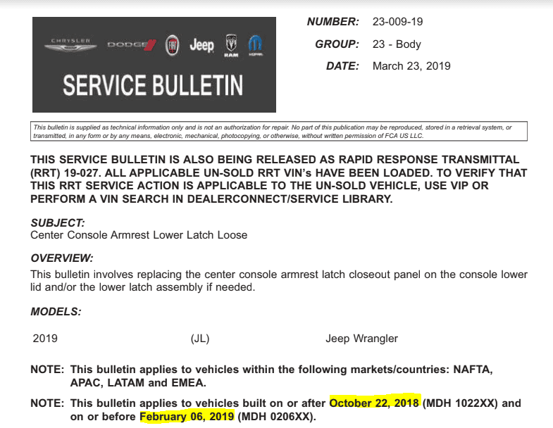

JeepCares
Feb 1, 2018
5,424
2,800
Auburn Hills, MI
JL
Hi everyone,
There is a Technical Service Bulletin (23-009-19) that appears to address concerns similar to the symptoms that you are having with your vehicles. To ensure this TSB applies, we would like to get you back into the dealer to have a qualified technician review the details of the TSB and specifics of your vehicle. Once reviewed, the technician can then perform the repair procedure that best matches the symptoms and diagnosis of your vehicle. Please send us a private message if you have any questions.
Lydia
Jeep Social Care Specialist
Jeep Wrangler JL Center Console Handle Broke upload_2019-3-22_15-31-15

Hi everyone,
Lydia
it was very nice of you to post that, thanks!
now if we could just get a TSB for the excessively loose and wandering steering :)
