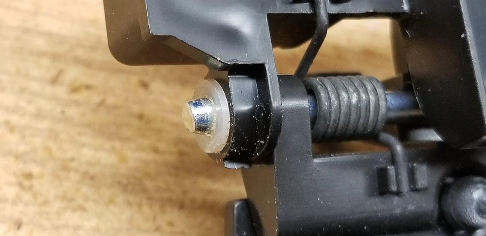

Not necessarily deserving of its own thread but I have had my JL for less than 2 weeks and have maybe only open the center console(the main larger opening) a dozen times; and the handle completely fell apart and fell off last night. No pics but hopefully this isn't foretelling the future and things to come.
Jeep Wrangler JL Center Console Handle Broke 20190217_153023
Jeep Wrangler JL Center Console Handle Broke 20190217_153042

Whoops, uploaded some pics but no words. Anyway, I got one of these #6 nylon washers to squeeze on. Had to widen the hole a touch with a drill. I couldn't get the locking washer to go on, which I beleive is a number 4.

I wonder what the original clip looked like ? , mine was not there at all.
