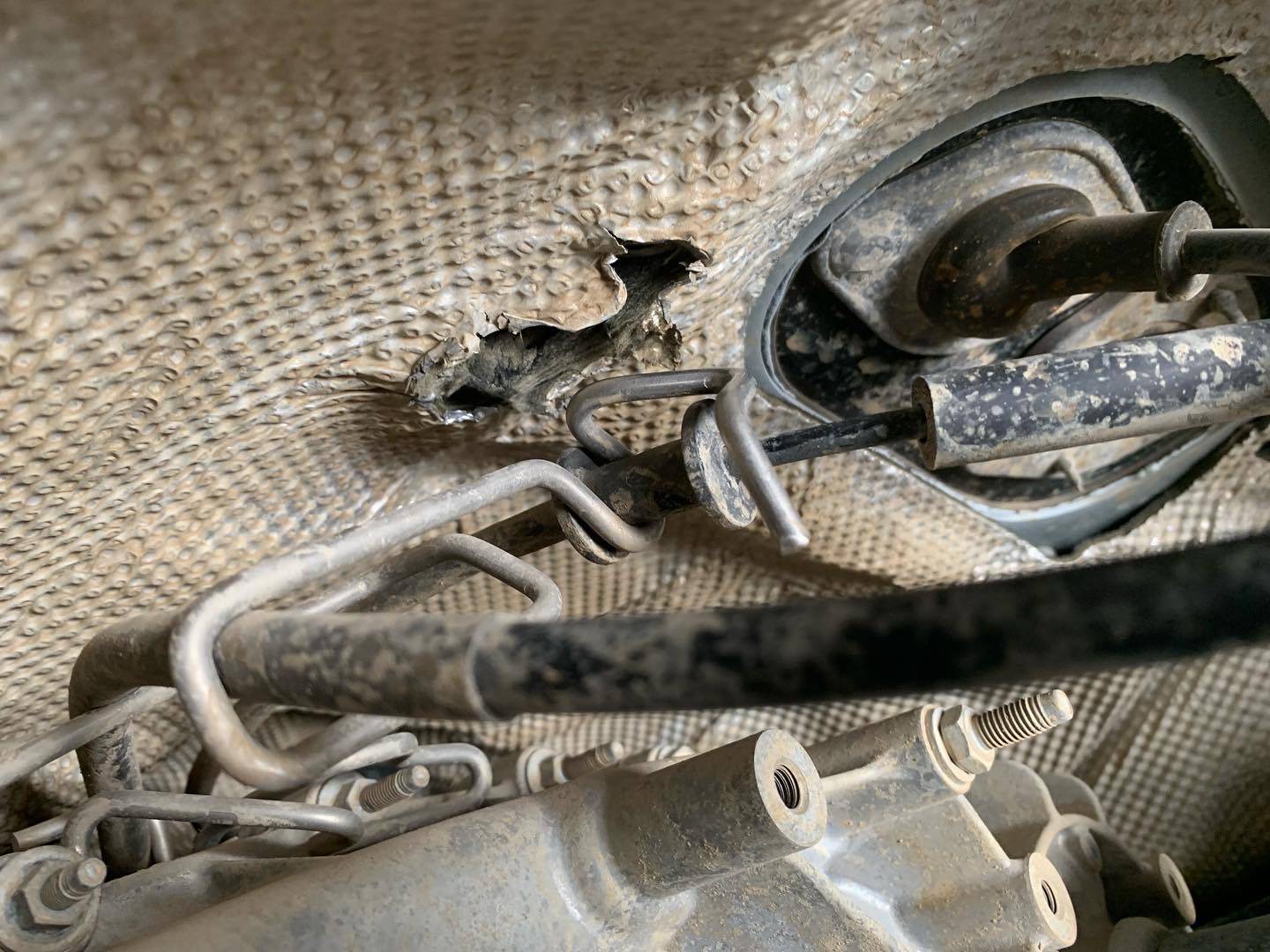

Hi members,
I have so annoying rattle noise came from center console.
Anyone has same noise as video?
When go uphills this rattle sound get louder but I cannot find exact where does it came from.
This is so annoying:(

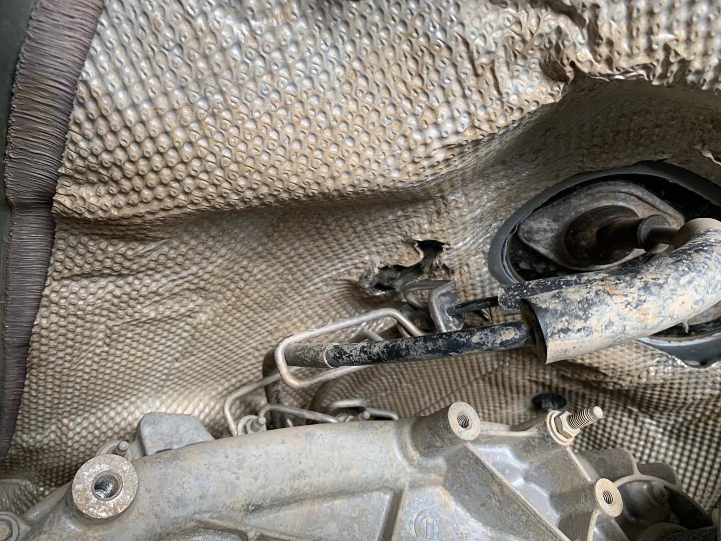

Resolved.
So weirdly the cable shifter bracket was bent into heat shield and hit the body panel!
Thanks god, it’s not a mechanical issue.
