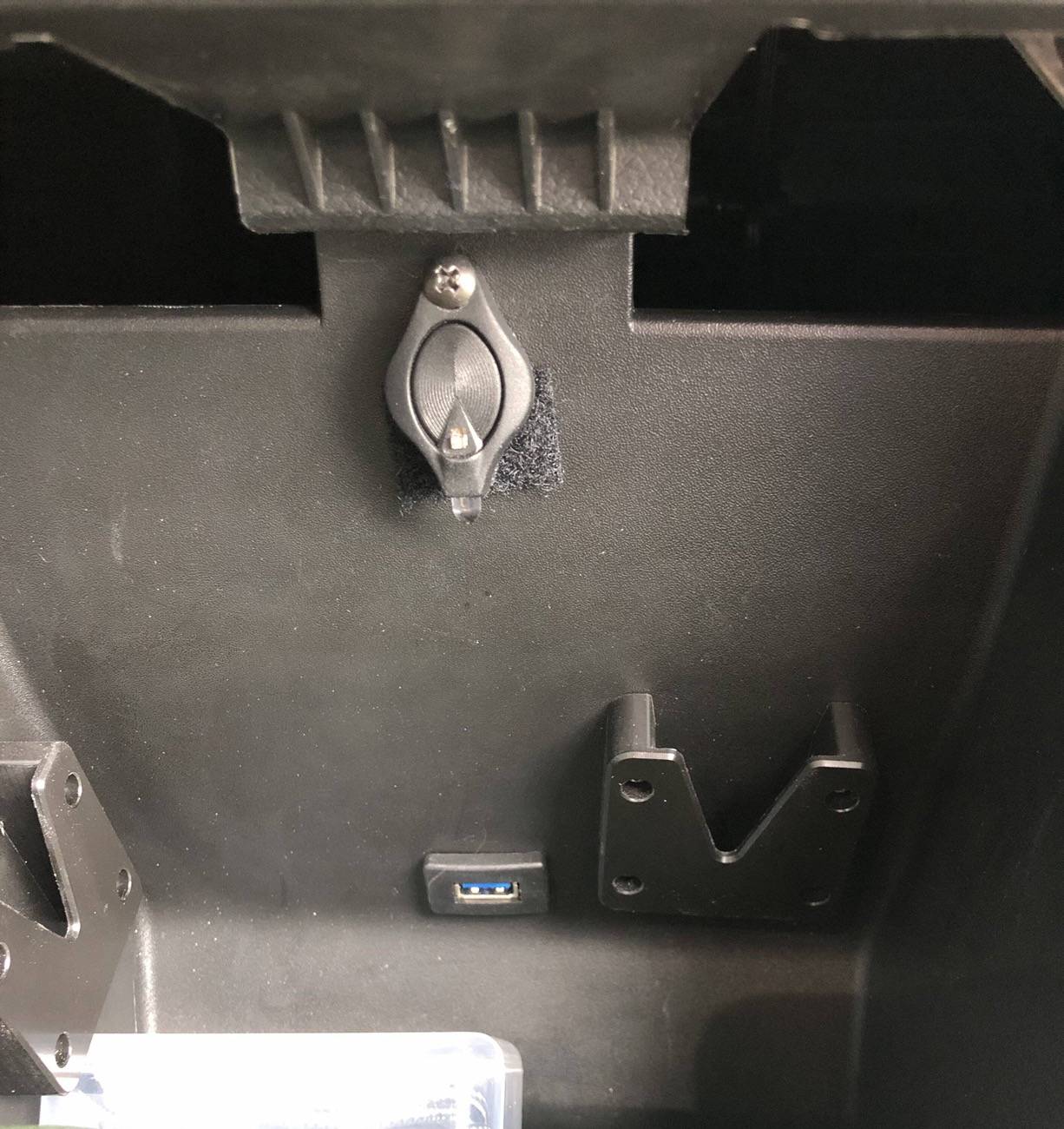

Absolutely. The challenge is to remember to keep them sufficiently charged.
i am selectively compulsive about some thIngs and have a “Jeep Checklist“ of everything I need to load up and all the rechargeable items I need to charge the day before. I also ran a charging cable off the front of the midland unit to the glovebox and have a splitter charging cable for both handhelds if it came to it. I also installed the two mounting brackets for the handhelds. But truthfully the glovebox is too full of crap that would have to emptied out. It seemed like a good idea at the time.
